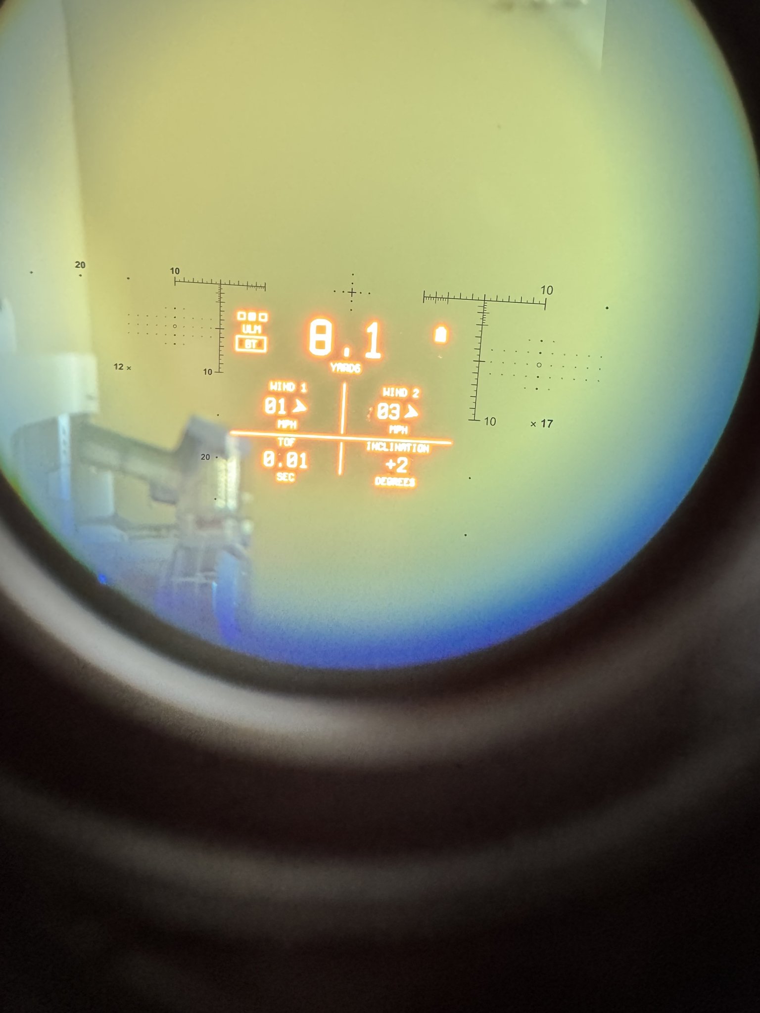

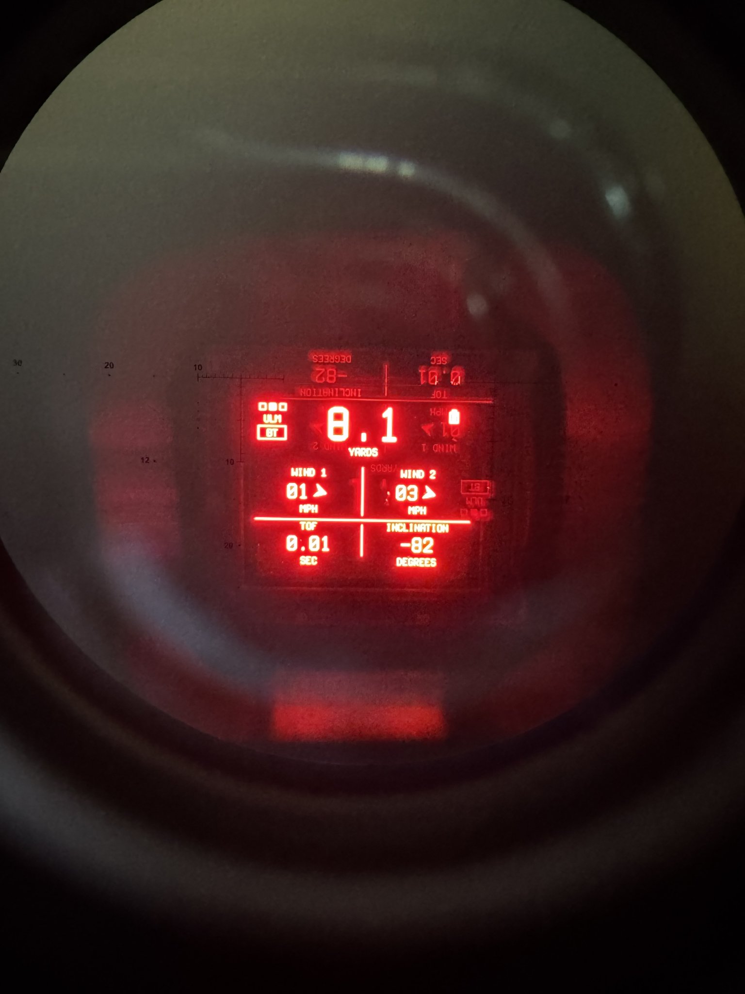

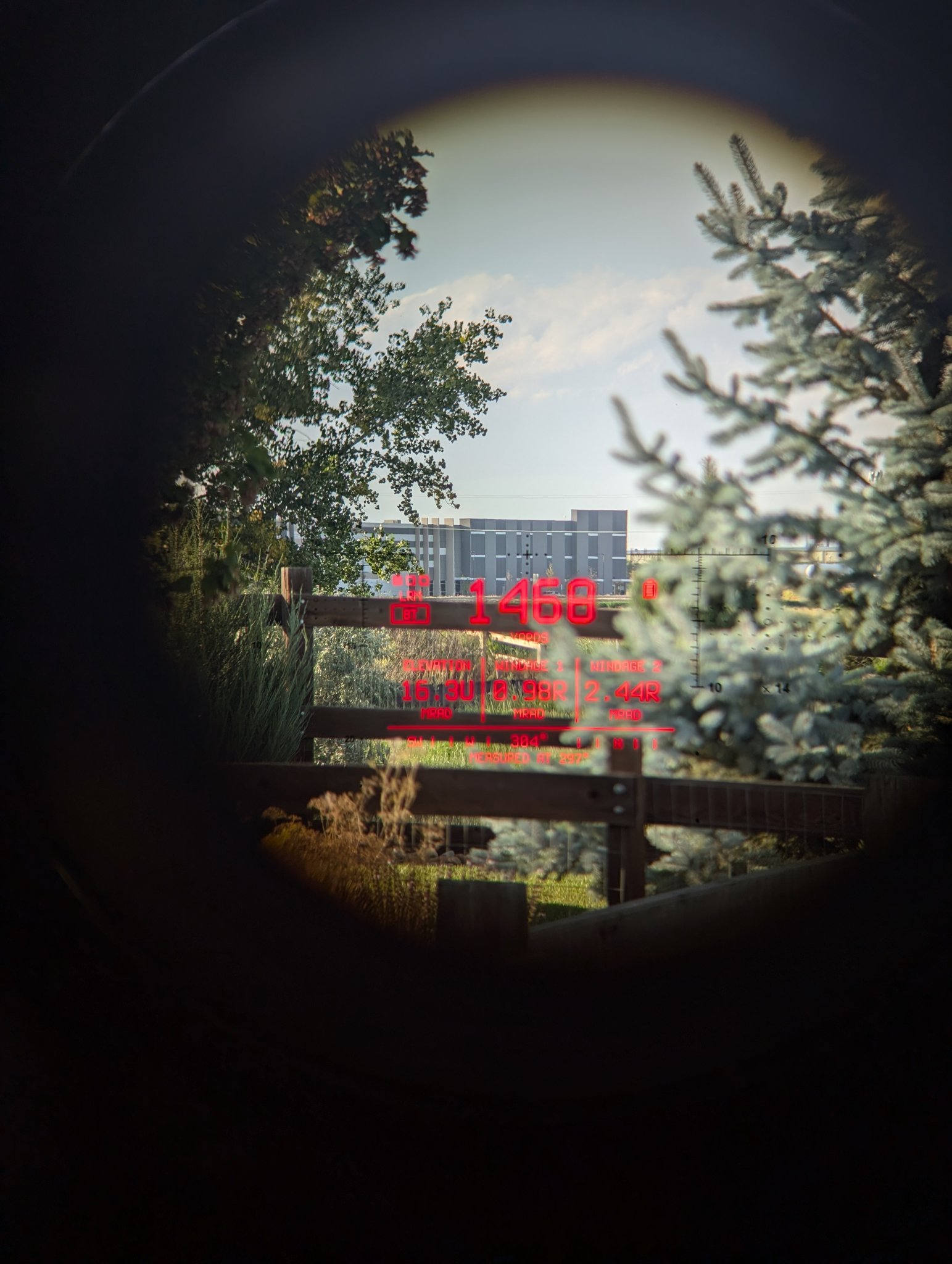

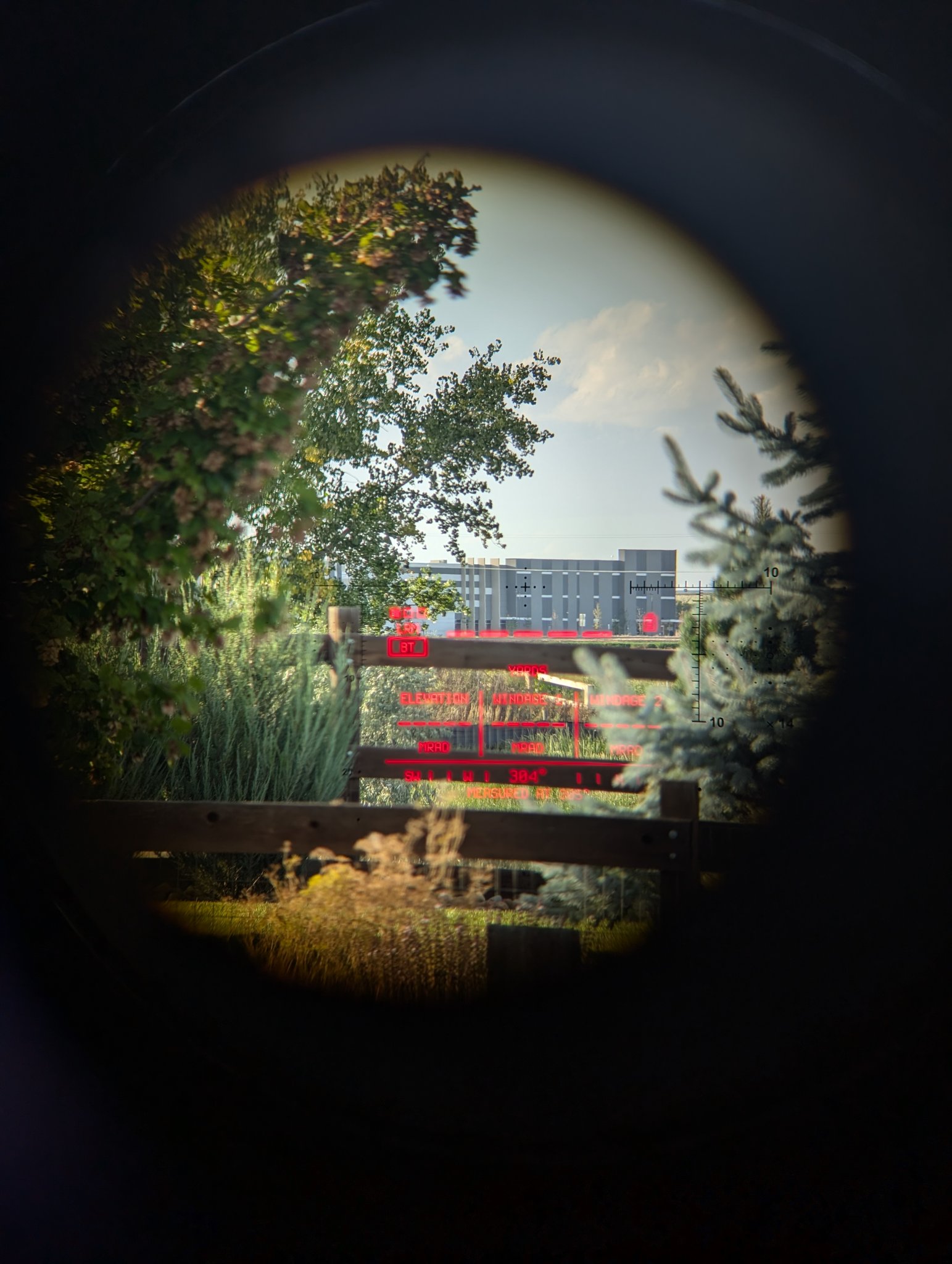

Similar somewhat surprising results this morning. The concrete building at ~1500 yards is hit or miss for my pair of Vector X, but gets picked up every time with my Geovid Pro. The building isn't perpendicular to me, probably 70° going away, so I'm sure it's a hard target to get a good reading on. There are a few pieces of the building that make a sharp corner so maybe the "looser" laser from the Geovid Pro is able to take advantage of that and get a better reading than the "tighter" laser in Vector X. Ranging steel buildings out to 2000+ yards though is not an issue at all. Getting good consistent readings from the Vector X. There isn't much wind this morning so the large flag at ~3000 yards is down and I'm unable to get a reading with either the Geovid Pro or the Vector X. We'll see if the wind picks up and I can try it later in the day.
Similar thoughts this morning for the glass though. I notice a more earth tone/brown image in the Vector X where the Geovid Pro is a more true to actual representation of color. Not that the tone in the Vector X is distracting or bothersome though, just a different hue to it vs the Geovid Pro. I honestly don't notice any of the reflective coating for the display in the Vector X so if anyone was worried about any tint from that I don't think it'll be an issue for you. Clarity, resolution and sharpness between the two though are incredibly similar and I don't think I can tell which one I prefer from that perspective.
Are you lazing handheld, or off a tripod or some rest?
Both clipped into a tripod. I played some more and it's even more strange... The building has two different shades of grey paint on it in vertical stripes. The darker grey doesn't return a reading consistently, but the lighter grey does... I never thought paint color would effect ranging capabilities of a LRF 🤣.

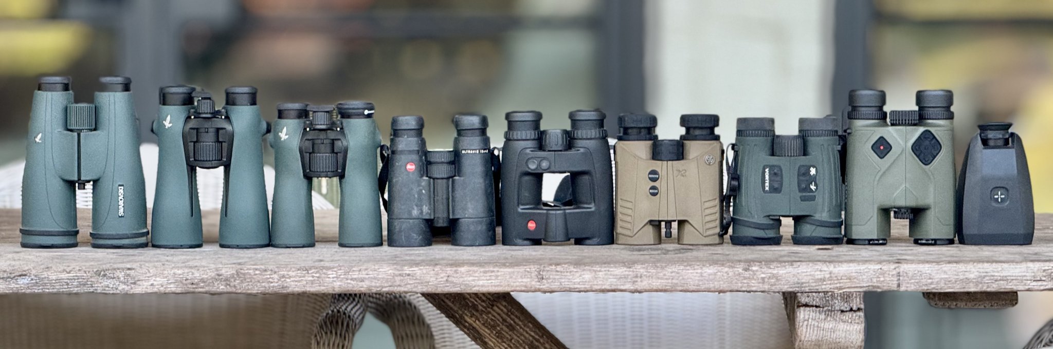

Some quick napkin thoughts after some backyard glassing.
Glass for comparison left to right above
Swaro SLC 15x56
Swaro 14x52 NL pure
Swaro 12x42 NL pure
Leica Ultravid 10x42
Leica Geovid Pro 10x32
Sig Kilo 10k
Vortex Fury HD AB 10x42
Vector X 12x42 DMR
PLRF 25c
Glass
-Pleasantly surprised. They're no NL Pure, but they'll hold their own against the Leicas. The film over any range finding bino is always going to cut clarity by some degree, but it's really minimal here. The gen I Sigs are blue blue blue...none of that here. Cutting out the straight binos and comparing RFB to RFB, they're probably the best of the bunch followed very closely by Leica to my eyes. Different day, different conditions, I may lean Leica...but for now, the Vectors seem to hold a slight edge. This is mostly driven by clarity/contrast between the two. I looked hard for some chromatic aberration with viewing white objects against a Texas sky, and didn't notice any....and I'm pretty sensitive to CA. Very happy to see this.
Feel
-Meh. They're heavy and blocky....but that's really not to be a surprise. So they're fine. With my NL Pure being my main glassing optic for the last few years, it's kind hard to pickup anything else that doesn't feel the same in the hand. Again, not a fair comparison against a non-RFB, so it is what it is. If Swaro ever releases a NL Pure line with rangefinding capability and AB, it'll be hard to pass up.
Comparing them to the Leica Geovid Pro, the Leica definitely feels better and weighs less....but my Leica's rangefinding capabilities are abysmal and the worst of the bunch.
The flip up caps to protect the objectives are nice...but I'm ready for some third party solutions that screen into the objective. For now, they just push in...which means they also pop out. I've already detached them on accident a few times.
Ranging
-To be determined. They ranged everything quickly and accurately with minimal lag....but I couldn't stretch them past about 1000 yards here. I look forward to getting them to the ranch where we can range windmills in the distance. So far, only the PLRF's have been able to range those at 6000+ yards. None of the other's I've tested in the above lineup have been able to pick them up.
The dual etched reticles are nice and the display layout is excellent. I was worried the reticles would be distracting, but they seem to disappear when glassing. My only worry here is the black etched center aiming reticle. When viewing tree trunks or other dark objects, it can be easy to miss. I worry about its visibility late at night when glassing. An option to turn on an illuminated center reticle would've been a welcome addition for those scenarios it's needed. As a hunter, I hope this isn't a problem in the real world.

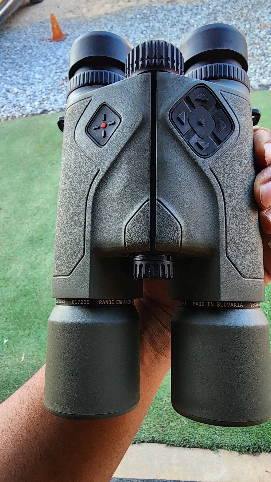

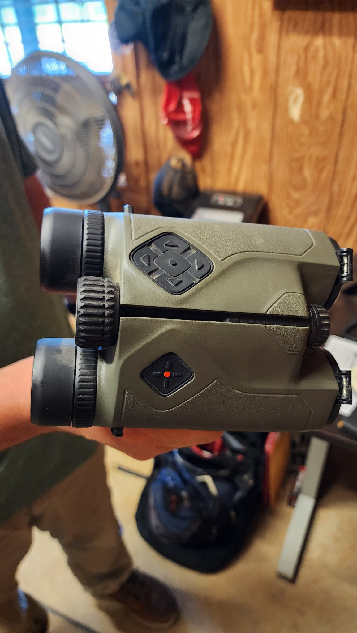

I got to fondle a pair today WITH range enhancers!! 10x DMR model. Ranging has a lag to it as stated earlier. Was only able to range trees. Owner said they ranged every target on the range past 2,000 yards. Owner will let me do a full review this weekend!! Glass is good, even with enhancers and the picture darkened just a bit. I oddly found myself adjusting the binos to fit my eyes. On my 3k's they're extended all the way out, with the Vector X I have to fold them in. Owner opted for the RRS plate, but said that the Area419 might be the better option. They look promising, but only time will tell!!!

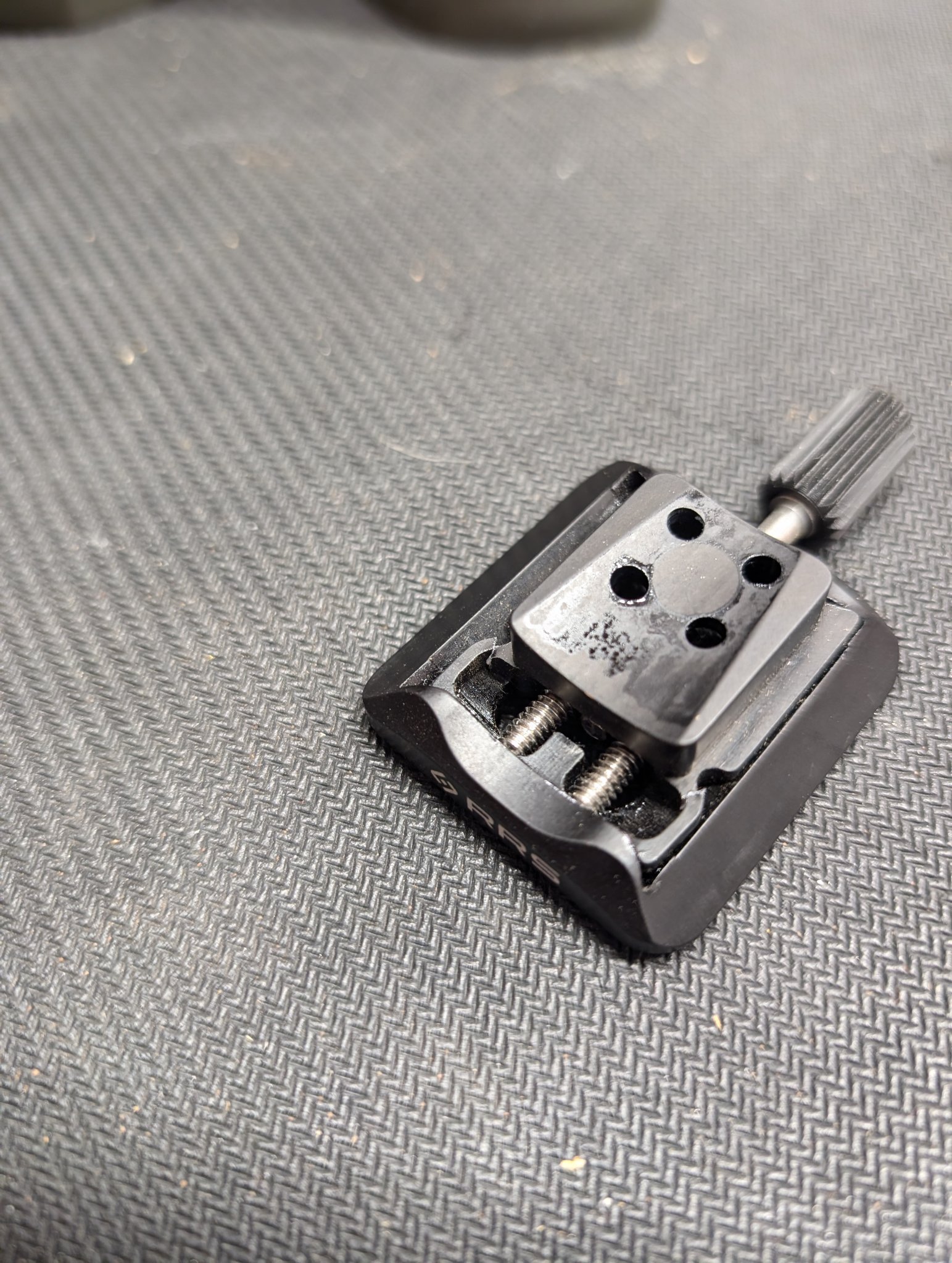

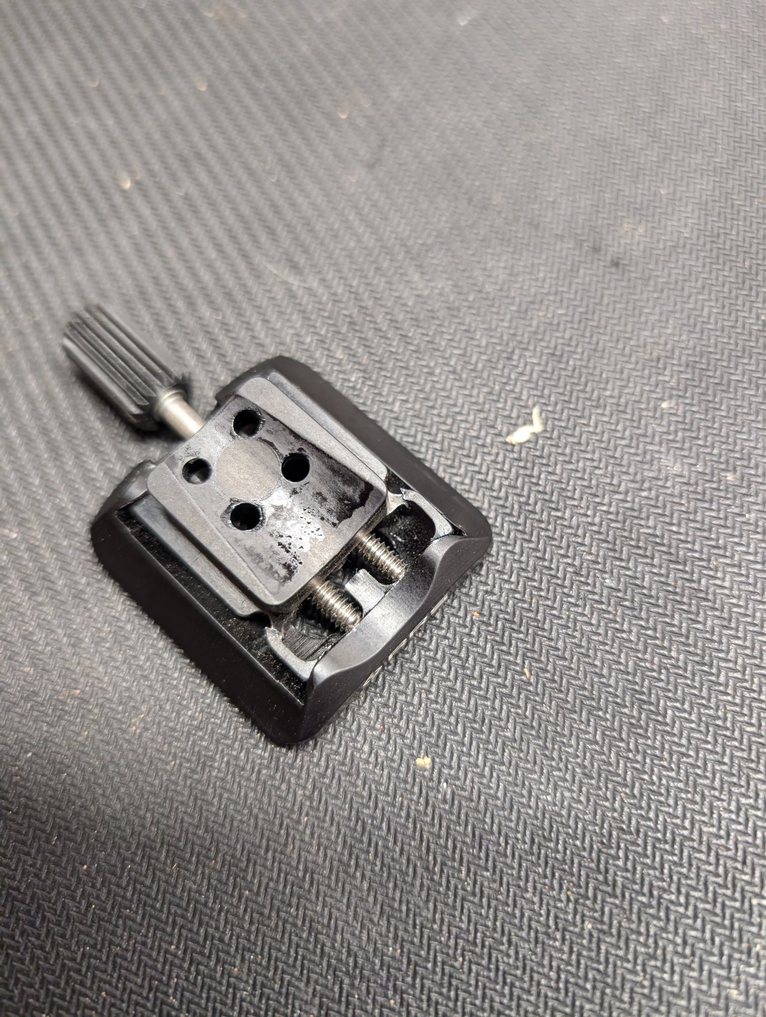

So I unintentionally got to test the durability of the Vector X and the RRS mount today at my local match... They were clipped into my tripod partially collapsed and fell over from about 3' up. The ocular cup and lense fared surprisingly well, the left cup is a little looser than the right, but other than that and a couple nicks in the rubber of the cup the binos were okay. I can't say the same for the RRS mount though. I didn't realize that the mount was two very skinny pieces of aluminum connecting the front and back half of the inner mount and both pieces broke. It was much worse right after it happened and I was able to somewhat push them back together, but I'm pretty disappointed in the durability of the mount. Even though this was 100% my fault I'm going to call RRS on Monday and let them know how easily this broke. I don't expect them to do anything for this broken piece so I'm probably going to be purchasing the 419 plate since it's just a solid chunk of aluminum and should fare much better when, not if, this happens again.
Reactions: RS14
Honestly, this might be a plus. One worry I have with the direct mount on the binocular main tube is that a lot of force could be applied between the mount and the optic and that could break the tube in a bad situation. Having a failure point in the mount might be a good thing. You have me thinking maybe I switch out the Areal 419 I'm using for the RRA to have that fail safe(r) point.
I’m using the RRS cinch and while not ideal or a real snug fit I feel like because it isn’t hard attached it might be the softest in a hard landing.
@Tshootz Honestly, I’ll just swap you out a new one for sure. As you said, just email me in the morning, [email protected]. I’ll definitely want to get it in, primarily to take care of a customer and look into the how and why of the breakage, to see if there is anything we should do.
Do you utilize/like the ability to adjust out cant? Would you rather the mount be more of a traditional/simple style that directs all impact back into the connection point on the bino, spotter, or LRF, etc? (More of a customer feedback / future customer request related question to help guide product design)
I’d rather have the adapter break than the connection on the bino.
Reactions: carbonbased
I’m reading my response again and realizing it could be interpreted as snarky or gotchya. Absolutely not intended, I truthfully want to know the response.
We make the rifle mounts as immovable as possible due to the leverage applied, we make camera plates as static as possible since tight fitment is necessary and long exposure shooters tend to understand the chance they will fall and weight down the pods prior. I have shot plenty of matches and you see daily tripod falls, so this is an important design question when it comes to optics.
Ex: We made the cinch after the center of my binos were stripped out after a fall and I lost the ability to mount my center stud due to the damage of my optic.
