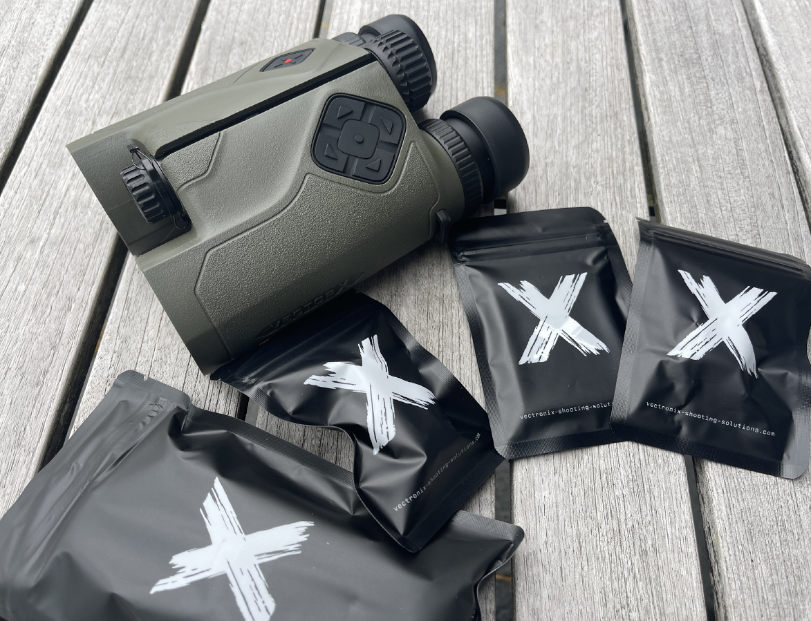

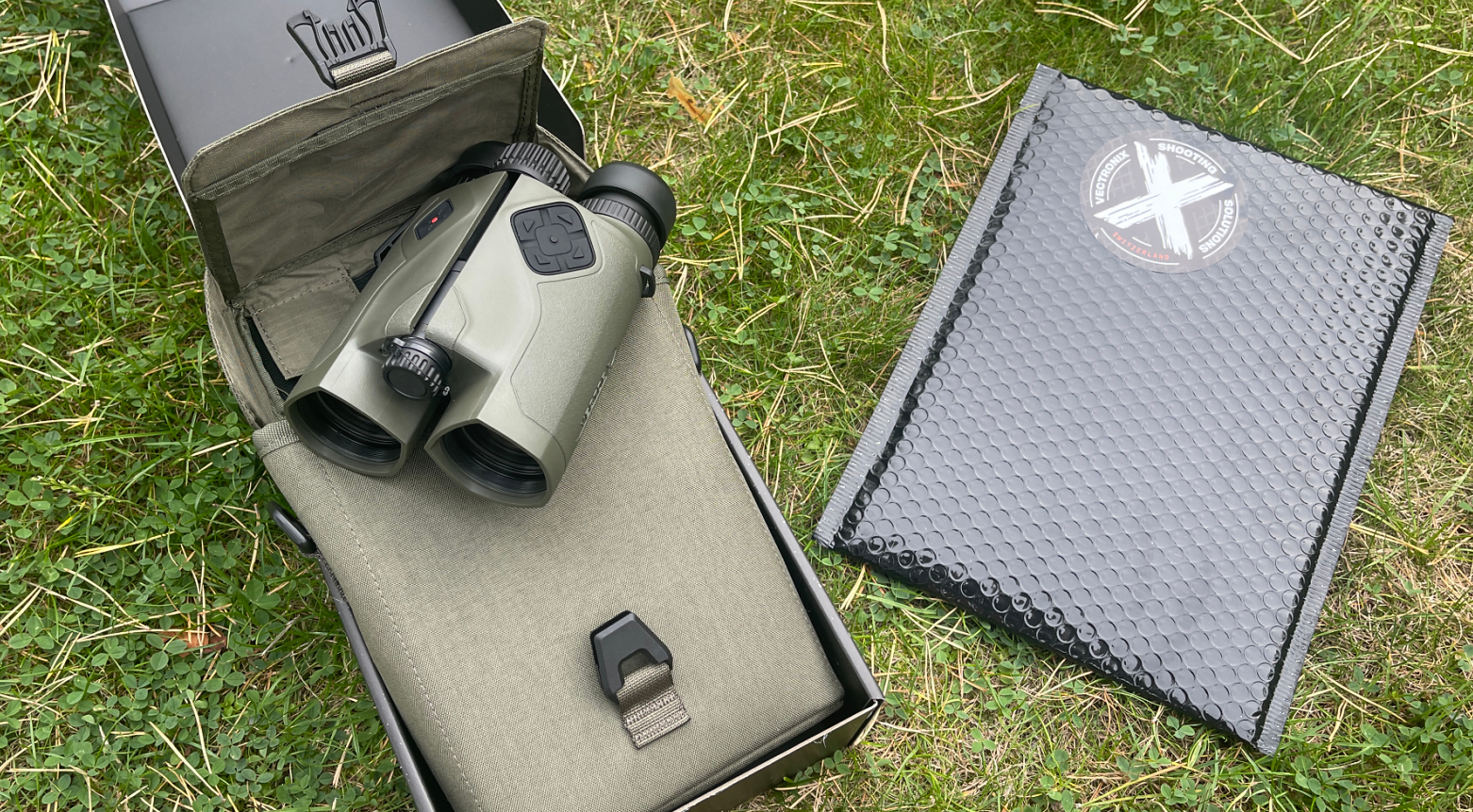

Only just got it, only came this far with the unboxing. So far everything is very Swiss and premium.
I sold my Terrapin X a while ago, and hope to be "sold" on the new one.

It's like unpacking a Rolex, everything is packed, marked and sealed. Crazy attention to detail!
So far it does not cost as much as a Rolex and this is good…how many sek or euros did you drop for that btw?

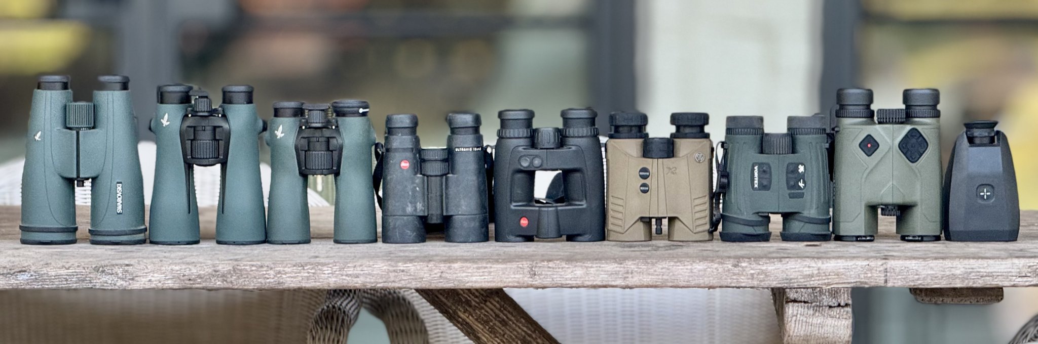

Some quick napkin thoughts after some backyard glassing.
Glass for comparison left to right above
Swaro SLC 15x56
Swaro 14x52 NL pure
Swaro 12x42 NL pure
Leica Ultravid 10x42
Leica Geovid Pro 10x32
Sig Kilo 10k
Vortex Fury HD AB 10x42
Vector X 12x42 DMR
PLRF 25c
Glass
-Pleasantly surprised. They're no NL Pure, but they'll hold their own against the Leicas. The film over any range finding bino is always going to cut clarity by some degree, but it's really minimal here. The gen I Sigs are blue blue blue...none of that here. Cutting out the straight binos and comparing RFB to RFB, they're probably the best of the bunch followed very closely by Leica to my eyes. Different day, different conditions, I may lean Leica...but for now, the Vectors seem to hold a slight edge. This is mostly driven by clarity/contrast between the two. I looked hard for some chromatic aberration with viewing white objects against a Texas sky, and didn't notice any....and I'm pretty sensitive to CA. Very happy to see this.
Feel
-Meh. They're heavy and blocky....but that's really not to be a surprise. So they're fine. With my NL Pure being my main glassing optic for the last few years, it's kind hard to pickup anything else that doesn't feel the same in the hand. Again, not a fair comparison against a non-RFB, so it is what it is. If Swaro ever releases a NL Pure line with rangefinding capability and AB, it'll be hard to pass up.
Comparing them to the Leica Geovid Pro, the Leica definitely feels better and weighs less....but my Leica's rangefinding capabilities are abysmal and the worst of the bunch.
The flip up caps to protect the objectives are nice...but I'm ready for some third party solutions that screen into the objective. For now, they just push in...which means they also pop out. I've already detached them on accident a few times.
Ranging
-To be determined. They ranged everything quickly and accurately with minimal lag....but I couldn't stretch them past about 1000 yards here. I look forward to getting them to the ranch where we can range windmills in the distance. So far, only the PLRF's have been able to range those at 6000+ yards. None of the other's I've tested in the above lineup have been able to pick them up.
The dual etched reticles are nice and the display layout is excellent. I was worried the reticles would be distracting, but they seem to disappear when glassing. My only worry here is the black etched center aiming reticle. When viewing tree trunks or other dark objects, it can be easy to miss. I worry about its visibility late at night when glassing. An option to turn on an illuminated center reticle would've been a welcome addition for those scenarios it's needed. As a hunter, I hope this isn't a problem in the real world.
Misc
-The app is well done and easy to navigate. No complaints
-The RRS adapter built into the bottom is an awesome option. Only issue here is that the thread pitch is pretty fine and feels easy to strip. I put a dab of loctite on them as I see no need to ever remove them in the future
-Compass calibration is odd. There is no menu setting to do this manually. You just have to wait for a chicken icon to appear in the viewfinder meaning it's time to calibrate. Then it's just one step to the next as laid out in the manual. There's no visual feedback on when to move to the next step...just a manual that says do each one for 2 seconds. If the chicken is gone when you look again, then you presume it worked. I would appreciate some kinda visual feedback on if it worked as this is always a finicky process with any compass calibration for optics. At least let me manually select a setting to start a calibration and then give me a success or failure notification.
Parting thoughts
Very happy with the purchase so far. I plan on taking them for a Wyoming hunt the first week in October, so we'll see how they handle some dust, drops, and long distances.
Very similar thoughts from me when comparing them. I only have the Geovid Pro 10x42 and Gen 1 10k to compare them to though.
For the glass I feel the contrast and clarity is very comparable to the Geovid Pro, but I find the color reproduction of the Geovid Pro to be better than the Vector X. To me the Vector X seemed to be a little more earth tone in image color vs the Geovid Pro being more accurate to real world.
Behind my house I have a few buildings at 1500-1900 yards and surprisingly the VectorX struggled to range the side of the building, but the Geovid Pro picked it up right away. The building isn't perpendicular to me though and I had the laser in ULM mode vs LRM so that may have resulted in the struggles of the Vector X. I also have a large American flag, like 100*50 foot flag, at ~3400 yards. Similar ranging results with the Geovid Pro picking it up right away and the Vector X struggling but eventually getting it in ULM mode. Tomorrow when the sun is out I'm going to play with them both again and see if I get similar results in LRM mode.

Similar somewhat surprising results this morning. The concrete building at ~1500 yards is hit or miss for my pair of Vector X, but gets picked up every time with my Geovid Pro. The building isn't perpendicular to me, probably 70° going away, so I'm sure it's a hard target to get a good reading on. There are a few pieces of the building that make a sharp corner so maybe the "looser" laser from the Geovid Pro is able to take advantage of that and get a better reading than the "tighter" laser in Vector X. Ranging steel buildings out to 2000+ yards though is not an issue at all. Getting good consistent readings from the Vector X. There isn't much wind this morning so the large flag at ~3000 yards is down and I'm unable to get a reading with either the Geovid Pro or the Vector X. We'll see if the wind picks up and I can try it later in the day.
Similar thoughts this morning for the glass though. I notice a more earth tone/brown image in the Vector X where the Geovid Pro is a more true to actual representation of color. Not that the tone in the Vector X is distracting or bothersome though, just a different hue to it vs the Geovid Pro. I honestly don't notice any of the reflective coating for the display in the Vector X so if anyone was worried about any tint from that I don't think it'll be an issue for you. Clarity, resolution and sharpness between the two though are incredibly similar and I don't think I can tell which one I prefer from that perspective.
