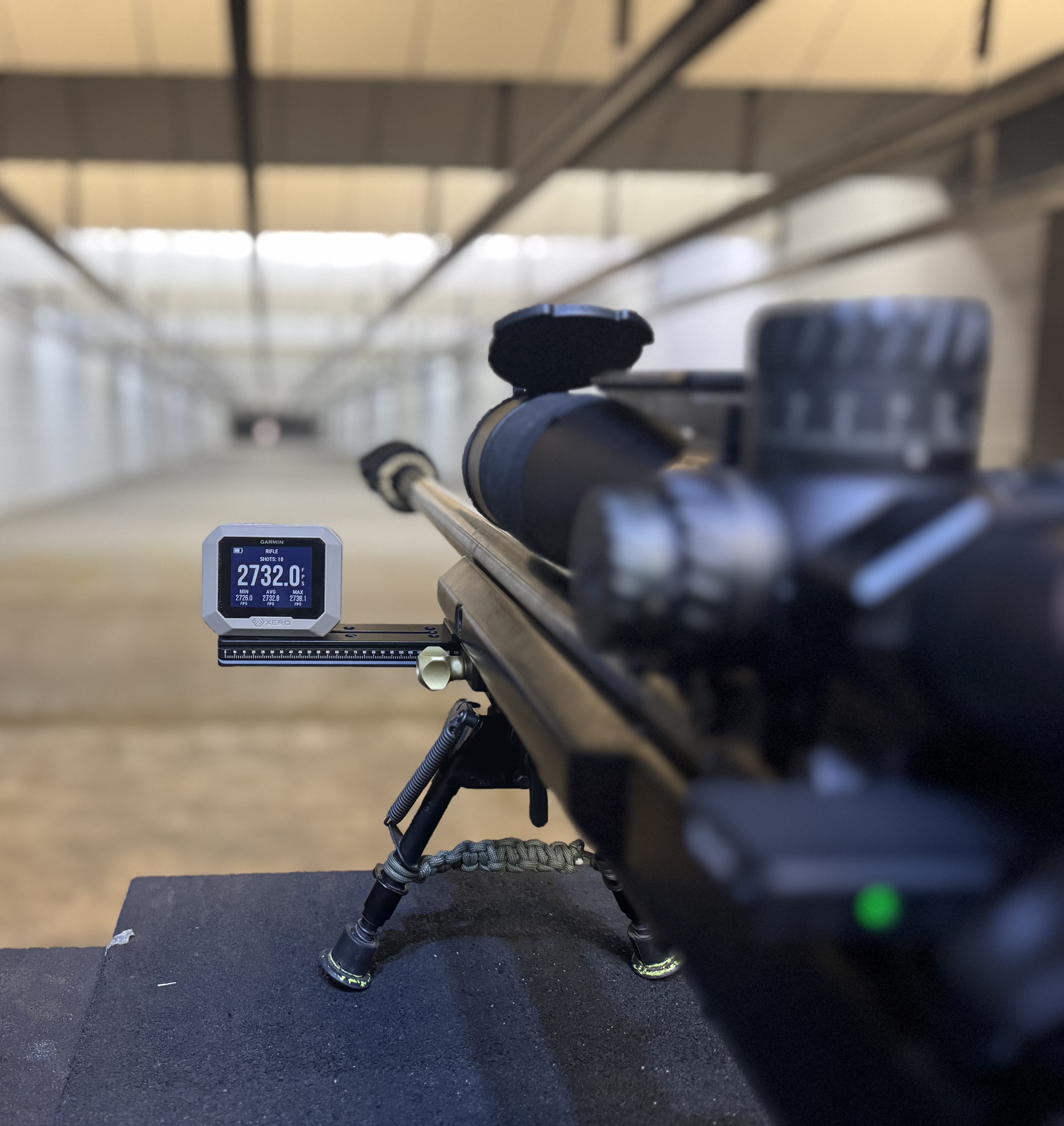

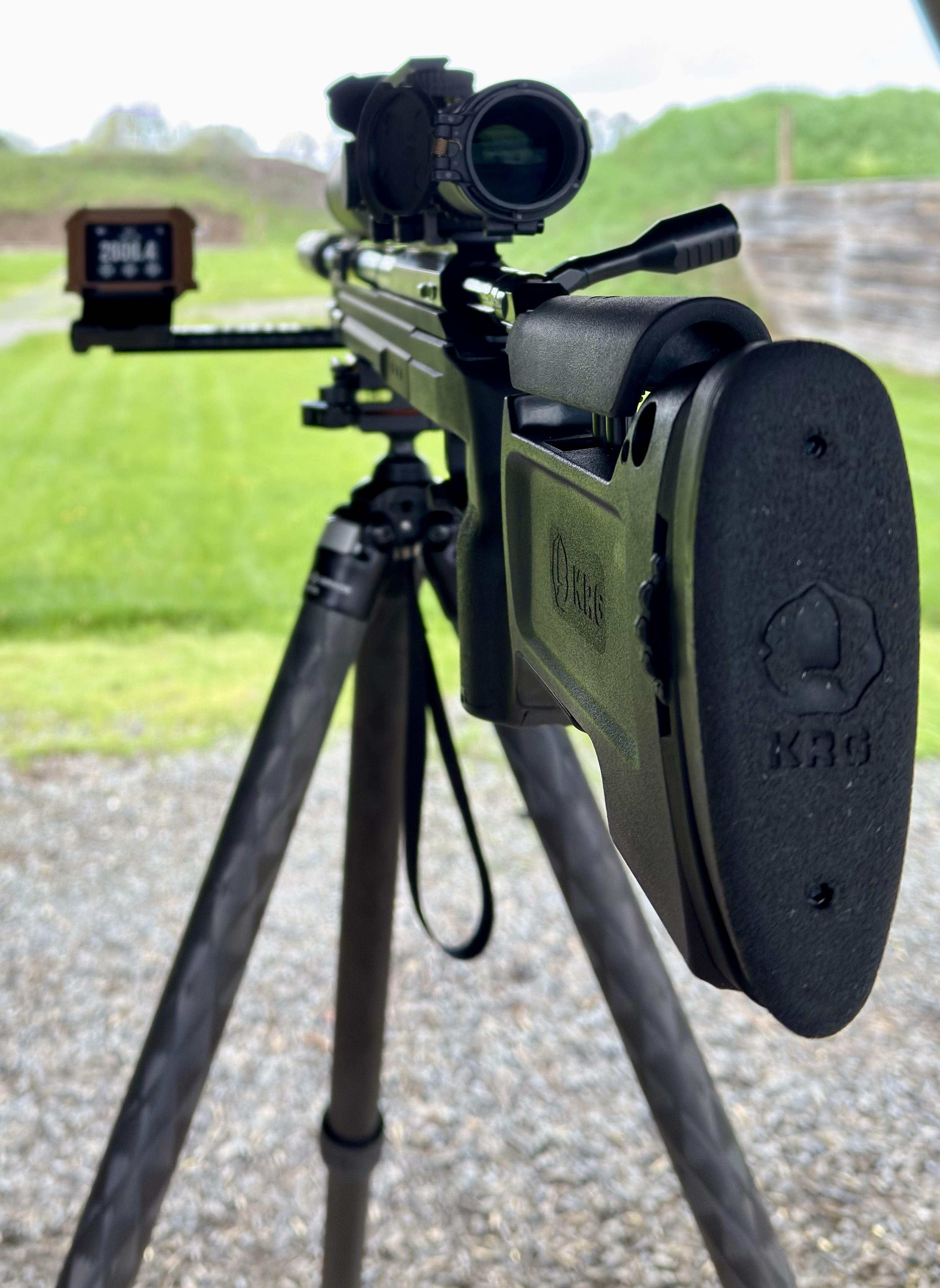

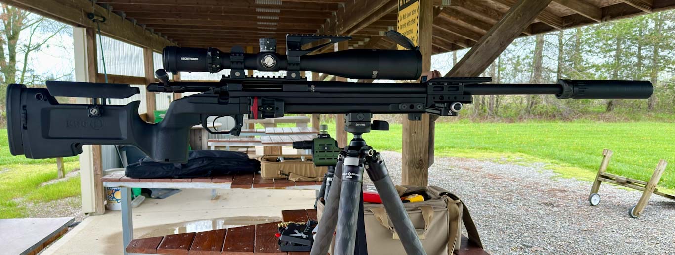

Last weekend I shot 20 rounds of 6.5 suppressed off a tripod with the Xero rifle mounted. Captured all 20 shots without issue. On version 3.32.
Pics of where the Xero is mounted and how far far back from the suppressor it was actually sitting.
Reactions: lash

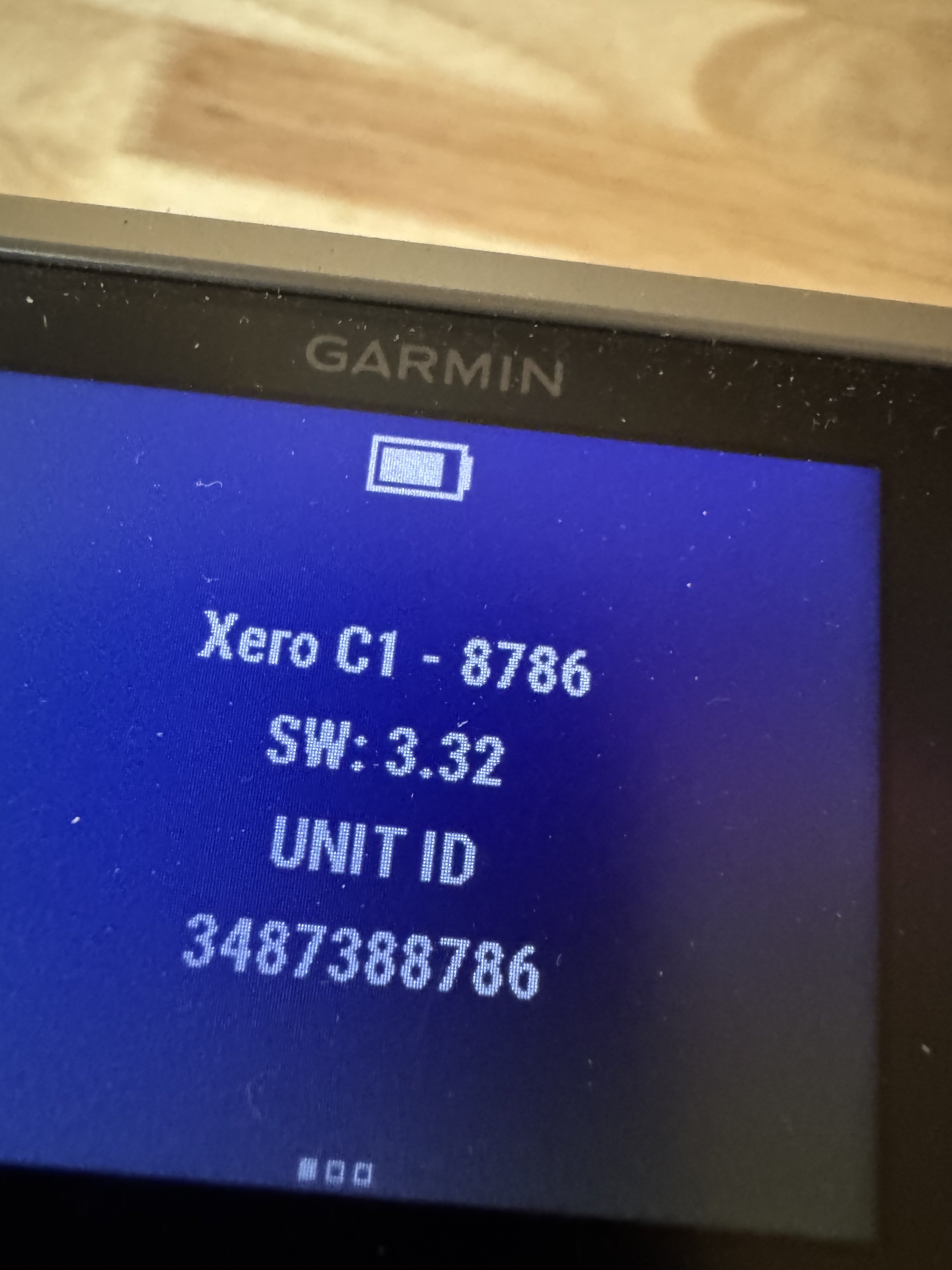

@Garmin - As follows:
- SW Version: 3.32
- Number of shots taken vs recorded: I have made several detailed reports in this discussion thread over the last month or two. Please review them. They were posted here for Garmin to read.
- Outdoor vs Indoor: Always outdoor, mostly alone on the firing line.
- Xero Placement: Early strings after software update, the unit attached to rifle with several missed shots. So transitioned to ground mounted on factory provided tripod and I still miss shots. Pictures posted in this thread previously with tape measure showing placement. So yes, it is placed within the specified distance.
- Caliber & Speed: 6.5 Creedmoor at 2835 and 300 PRC at 2900
- I will try a factory reset and report back. But I don't have my hopes up. Perhaps my unit needs warranty repair/replacement.

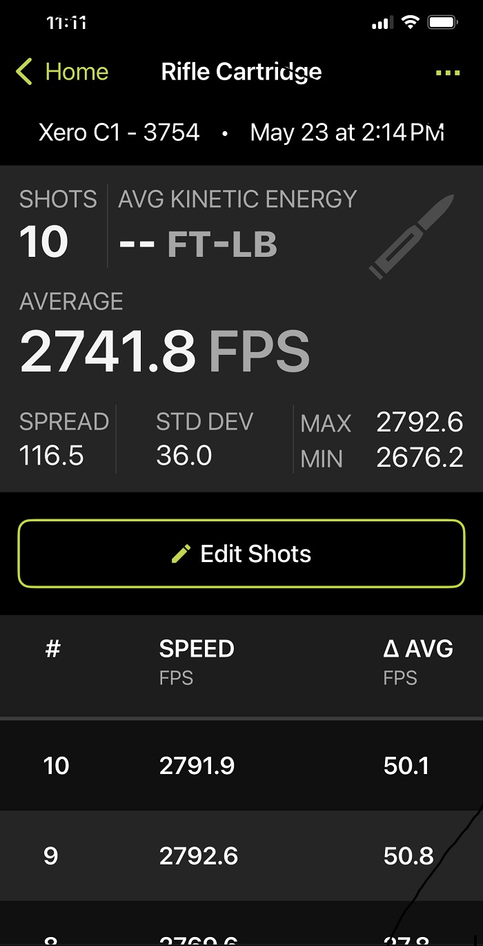

@Garmin
I had missed shots yesterday. It was frustrating because it was during load development. I did not realize that shots were missed until I was done so the session and ammo was wasted. It missed 2 out of 30 shots.
SW Version: 3.32
Number of shots taken vs recorded: 30 taken, 28 recorded
Indoor vs Outdoor: Outdoor, 78F, 72% humidity, cloudy, no wind.
Was the Xero C1 placed within the specified distance behind the muzzle and laterally from the barrel?: Yes, attached via a solid base to the Arca rail so the position was the same for every shot.
Caliber and rough expected speed: 6.5 Creedmoor, ~2765 fps (Berger 144gr HLRT bullets, target at 100 yards, flat terrain)
Are you willing to do a factory reset on the device? If yes, does that resolve the issue? Sync to the app first to avoid losing any saved sessions:: Yes, willing to try a factory reset and report but I will not be able to get to the range for two weeks.
EDIT: One more odd thing--shots 19 and 20 report identical speeds. So do shots 21 and 22. Duplicates?? I have never seen duplicates before.
Putting them in as spreadsheet and aligning similar speeds under a charge (while keeping the recorded values in order), it looks like shots 17 and 27 were missed.

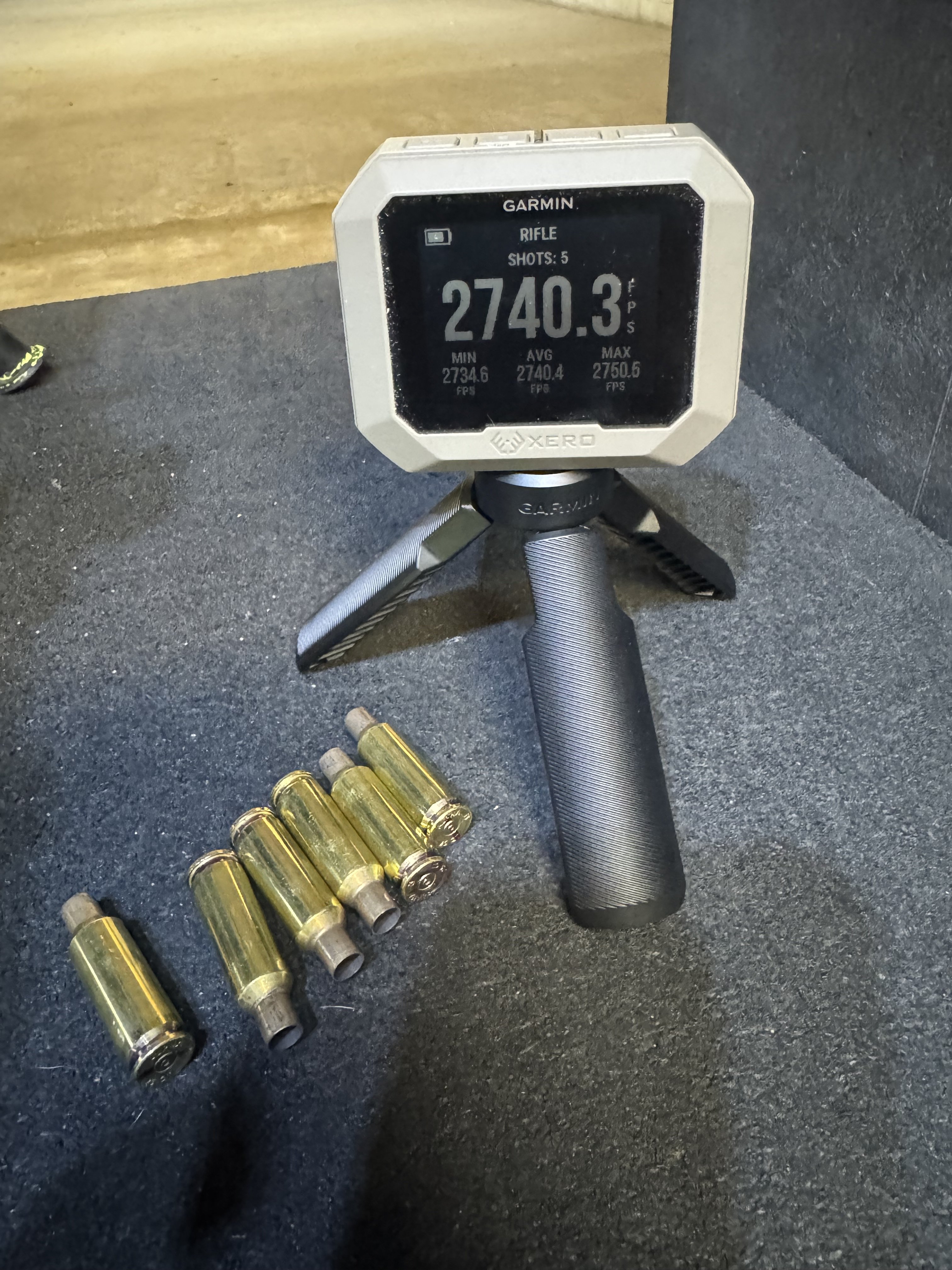

@Garmin,
I went to same indoor range I’ve been going to in other tests, before and after the newest update. Decided to try off rifle on provided tripod and didn’t experience the erratic “analyzing shot” without firing a shot as I did before. It did however miss one shot.
My placement I assumed was the issue. So I moved it right next to where my bipod is and given the limited space of the bench I was shooting off of it MAY have been a real estate issue. Nonetheless I tried to get it within the recommended distances. From there on out I never missed a shot for the remaining 25 test rounds.

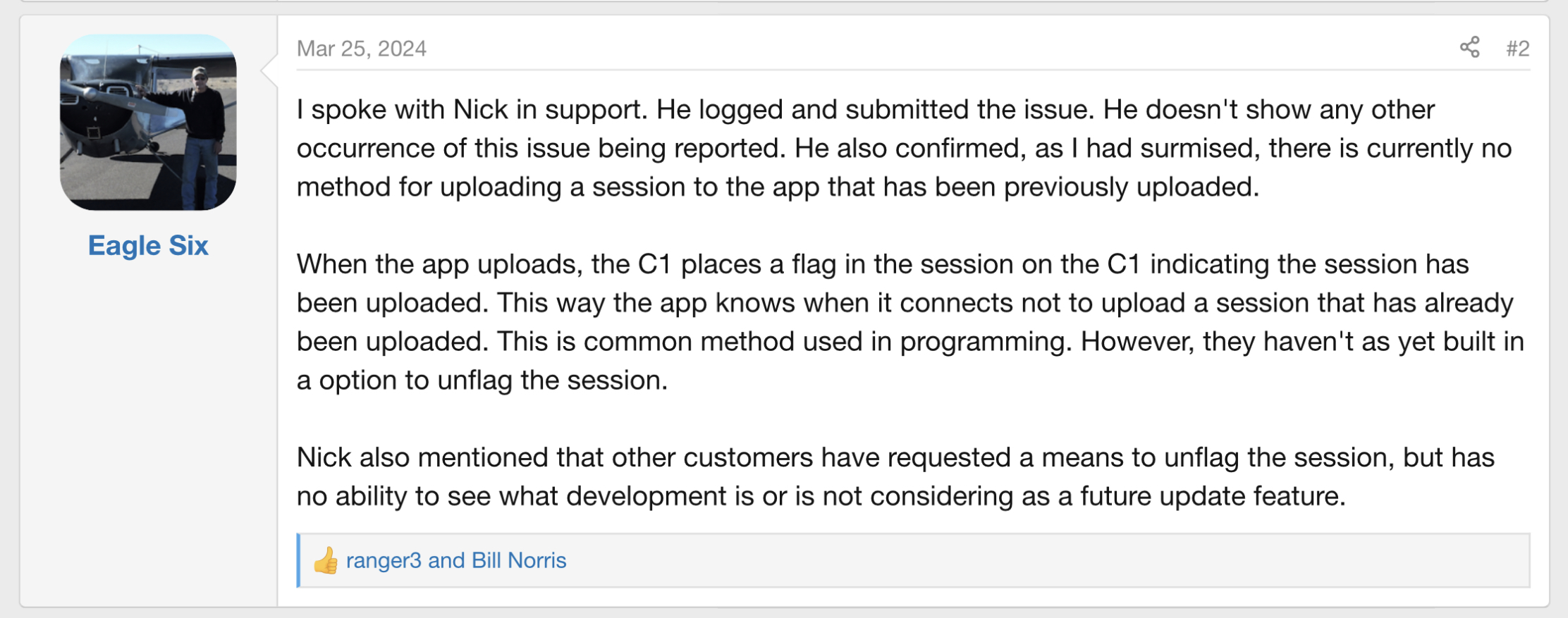

@Garmin
Has the issue with being unable to sync all sessions to the iPhone / iPad been rectified?
Can’t download all of the sessions to my device, and as a result I can't email them to myself for editing in MS Excel.

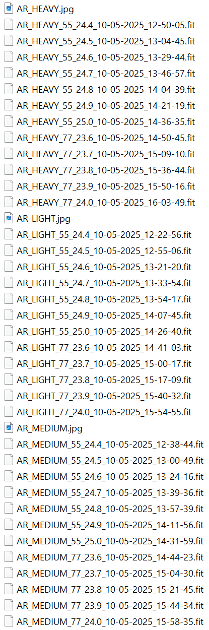

Wonder if there’s some cache-like transfer limit you’re hitting…hmmmm
My Xero behaved similarly in the past, when I had something like six or so Shot Sessions in the queue.
It started getting troublesome when I started having ten Shot Sessions, requiring multiple reconnections.
My last outing, which had thirty, was just impossible.
Tried everything - rebooting devices, forgetting and pairing Bletooth connections, deleting and reinstalling the app, etc.
Very interesting. I have never had 30 sessions on one day. I wonder if it had some next level glitch related to a high number of sessions on the same day to add to the normal difficulty it has transferring a number of sessions all at one time. I did have all 50 possible sessions populated the first time I plugged it in but that was a lot of different days worth of sessions. It took an absurd number off connections and re-connections for all those to transfer just a couple at a time. The software certainly seems to handle transferring a bunch of sessions at the same time very poorly in general though. Bummer that some of your sessions just plain refuse to transfer.
