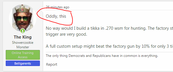

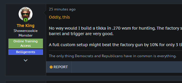

Why?
I'm not arguing so much as trying to understand the reason(s) behind your position.
Like he said just now, he would buy, not build. Get it for 800 out the door instead of 600 for a donor plus the barrel and work and everything else as added on cost.
Unfortunately some forum styles (the one nice default one that doesnt bother my eyes) dont show hyperlinks so many probably overlooked that it was a link to a factory option that he shared. Its why I now underline the hyperlinks now.
