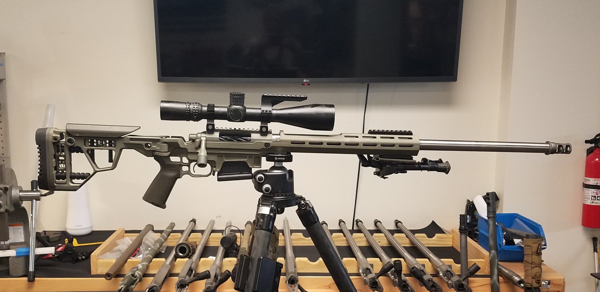

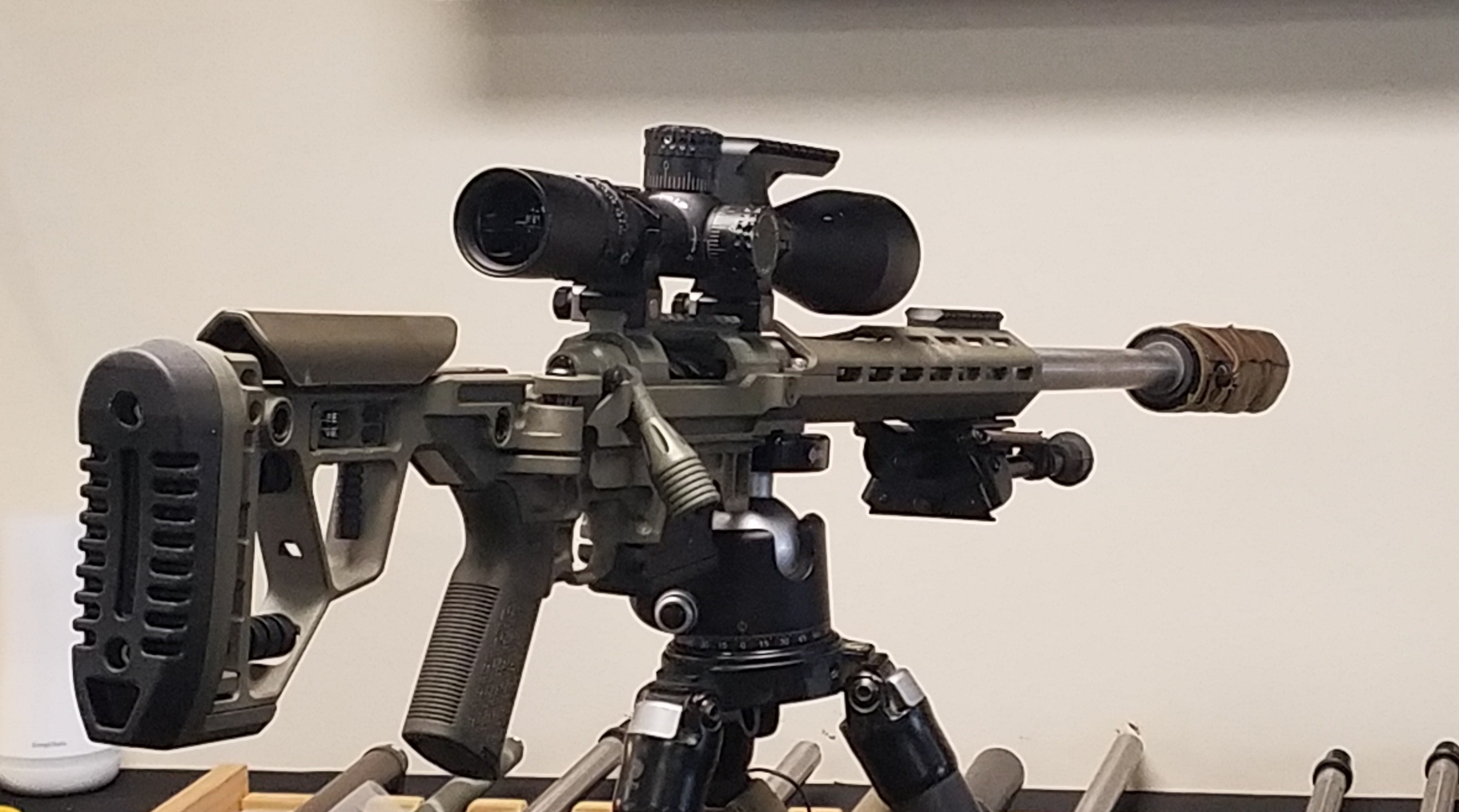

KMW’s Zealot - LE rifle chassis was shown in the wild for the first time at the 2021 Precision Rifle Expo in Blakely, Georgia this weekend.
This chassis design reflects the same philosophies that I embodied in the very successful SENTINEL Combat Stock plus a few more that I could not execute in a fiberglass stock.
The Zealot places your barreled action lower in the stock than any other chassis while delivering totally new design features that no other existing chassis or conventional stock has.
FEATURES:
Z-Latch
TM locking hardware - Totally new locking system for LOP and Cheek Rest adjustments. No tools needed. No loose and rattling components. Nothing sticking out to snag on gear. Nothing to loosen. Will not accidentally disengage during movement or while on the gun.
Captv-MagTM – This integrally machined feature is the same already proven feature in the new KMW DBM bottom metal. The Captv-MagTM system prevents AICS style magazines from over-traveling into the bolt path and binding the gun.
New Split Hemisphere forend design provides a totally enclosed handguard easy installation and removal of your barreled action into chassis while retaining the lowest CG of any chassis on the market.
I wanted to avoid any proprietary accessory attachment requirements so I chose to include the proven M-LokTM slot standard to allow you to configure as needed from the huge selection of M-Lok accessories on the market.
Main chassis body is one piece/monolithic to maximize rigidity and strength while avoiding a bunch of fasteners to hold the forend in place like others.
The forend is wider and blended to be more friendly to your hands while also sitting in and riding through bags.
A lot of chassis on the market look like the pistol grip was simply stuck there as an afterthought by leaving a lot of square edges and lines that are very unfriendly to your gun handling and comfort if you are on the gun for extended periods.
A good bit of thought and work went into the area where the grip merges with the Zealot chassis to insure your best hand position and comfort even if you add another aftermarket grip*.
*Accepts any M4/AR pistol grip including the excellent MDT vertical adjustable grip.
Accepts all Accuracy International AICS style magazines and AICS clones.
*Will also accept AW style magazines
Short Integral ARCA rail just in front of magazine well fits RRS Anvil and similar clamps.
I purposefully avoided an integral ARCA extending down the bottom of the forend. Future "competition" version may include one.
5 flush cup locations on back half of stock that feature GrovTec’s proven limited rotation, stainless material and black oxide finish. Much better long term wear than flush cup points machined into an aluminum chassis body. Two MagPul flush cup mount points with M-Lok anchors allow you to place front positions where you want.

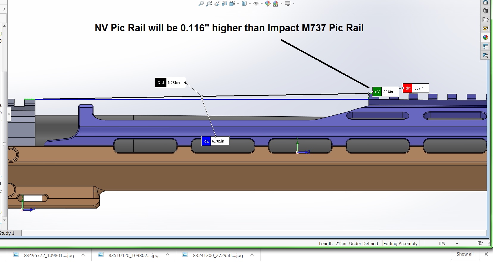

looks like the night vision rail is higher than the scope rail?
The NV rail is higher than the Pic rail on Defiance/Impact 737/Surgeon 591 Pic rails but still lower than the Accuracy International AX AICS NV rail compared to the same actions.
The rifle sits so low in the Zealot that most users will use a higher ring/mount combo similar to the A.I.s.
There was no way to get the NV mount options lower to the bore and still allow the bigger barrel contours to be an option.
