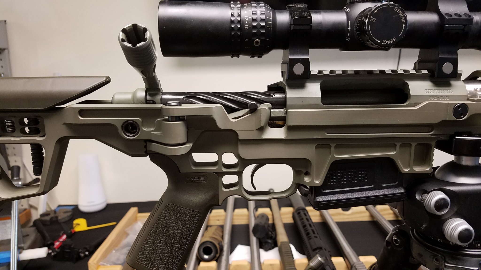

Once the Zealot-L.E. starts shipping, the default grip will be the MagPul MOE grip as shown in the already posted images of this chassis.
While I like this grip for general use, I acknowledge that many will want to substitute a different grip that offers a more vertical orientation, etc.

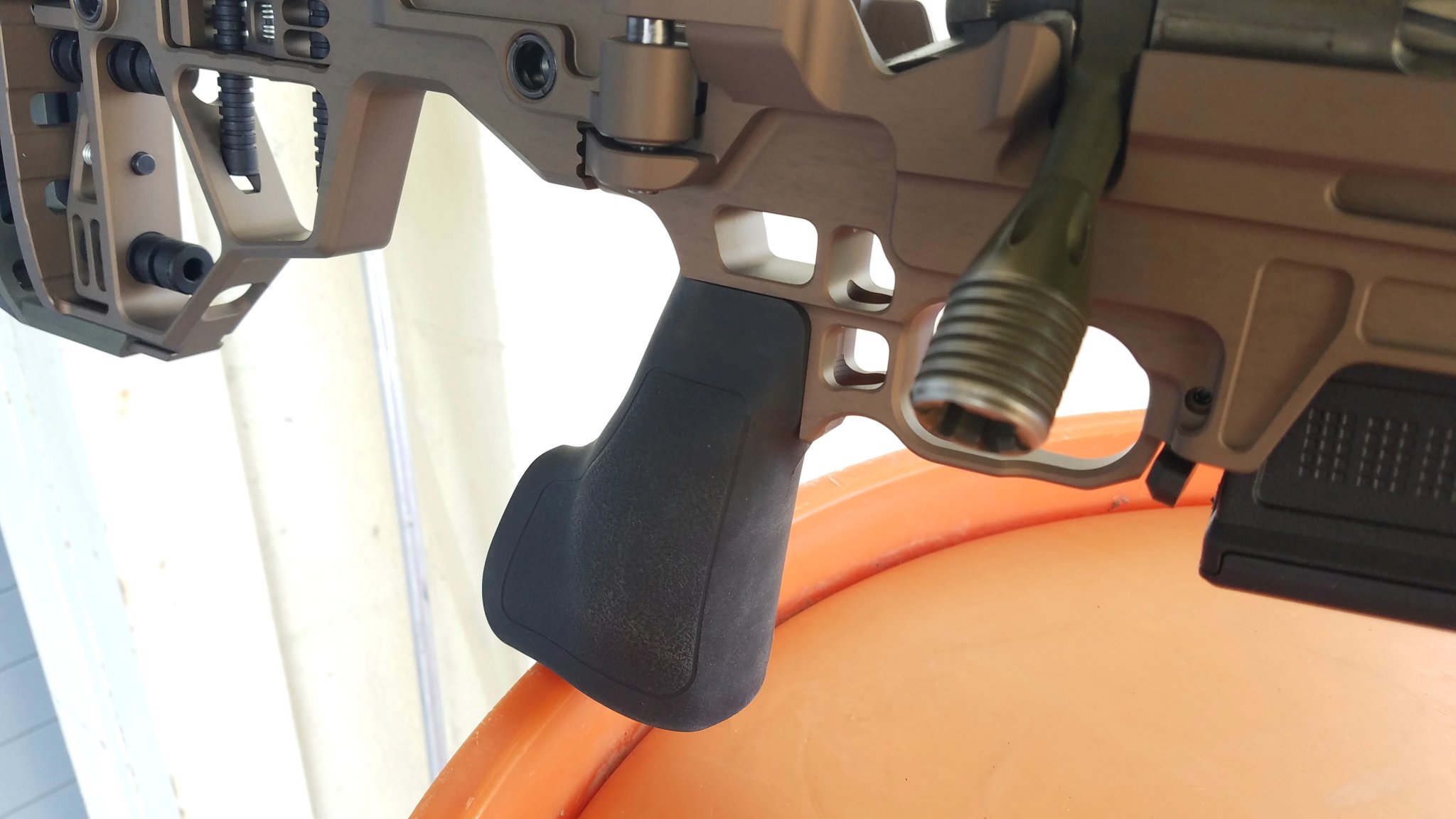

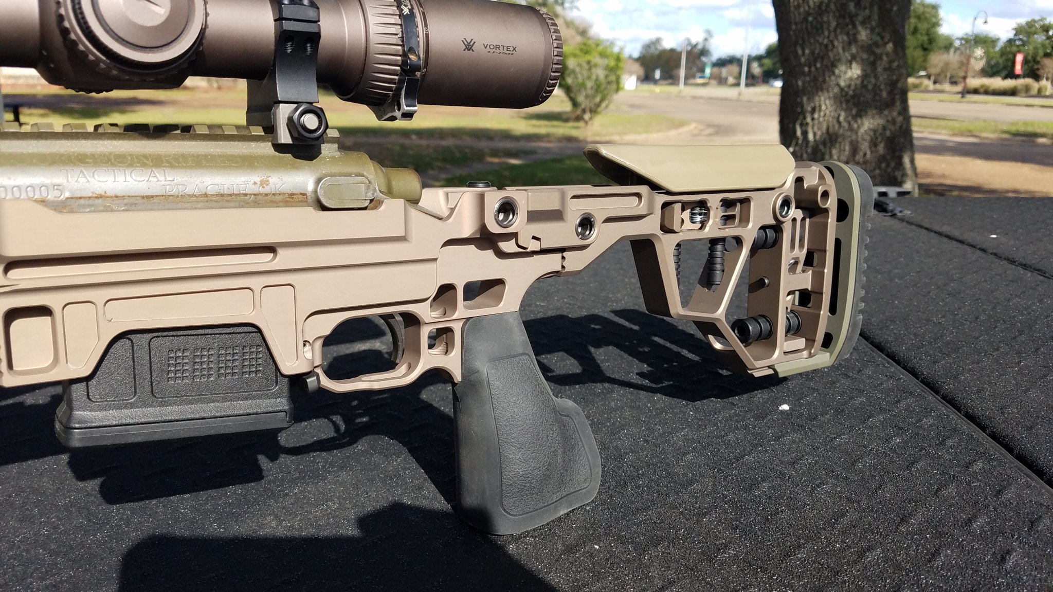

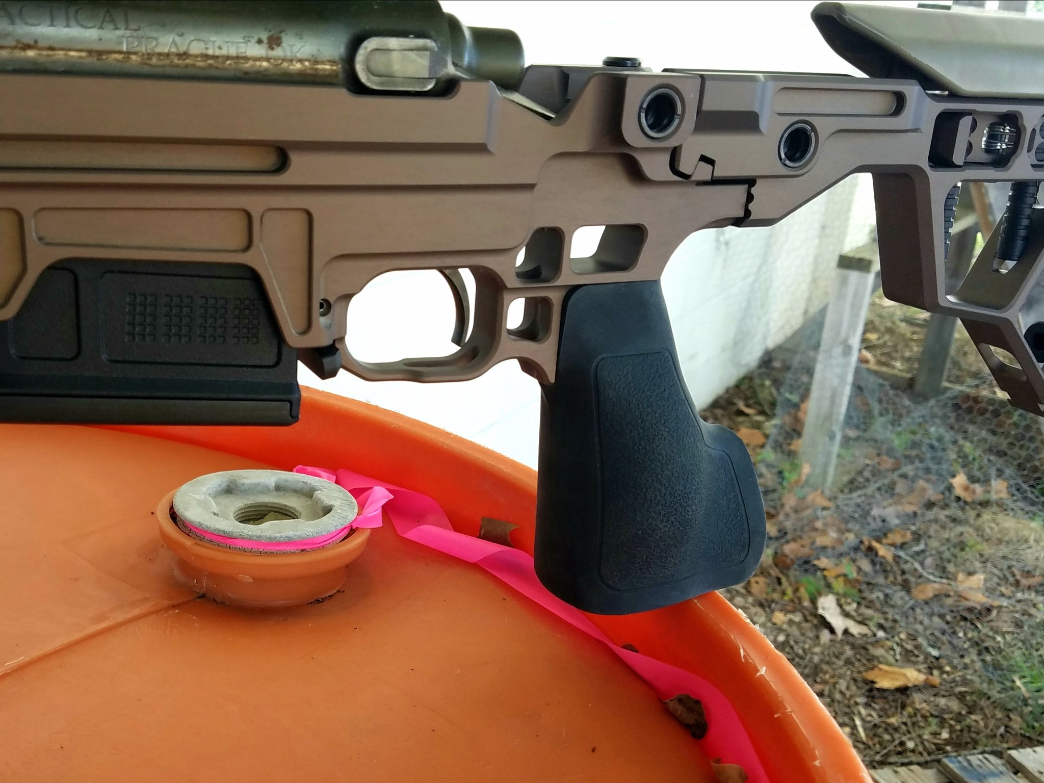

One of the ones that I was able to access and check was the excellent TLCGrip that Mr. Troy Lawton designed.
The TLCGrip fit perfectly onto the Zealot chassis with no issues. It mounted up tight with zero play and no gaps. Everything felt very nice when my hands are in shooting position. This is an "ambi" grip with identical sides so no bias toward LH or RH. Very nice overmold surface design is non-slip and friendly to the touch.
Here are some quick phone camera images I was able to get during lunch.
These grips are compatible with most other chassis besides the Zealot and most gas guns out there.
Link to the TLCGrips web page is : https://tlcgrips.com/
I will try to get images and info of other grips as time and access permits.

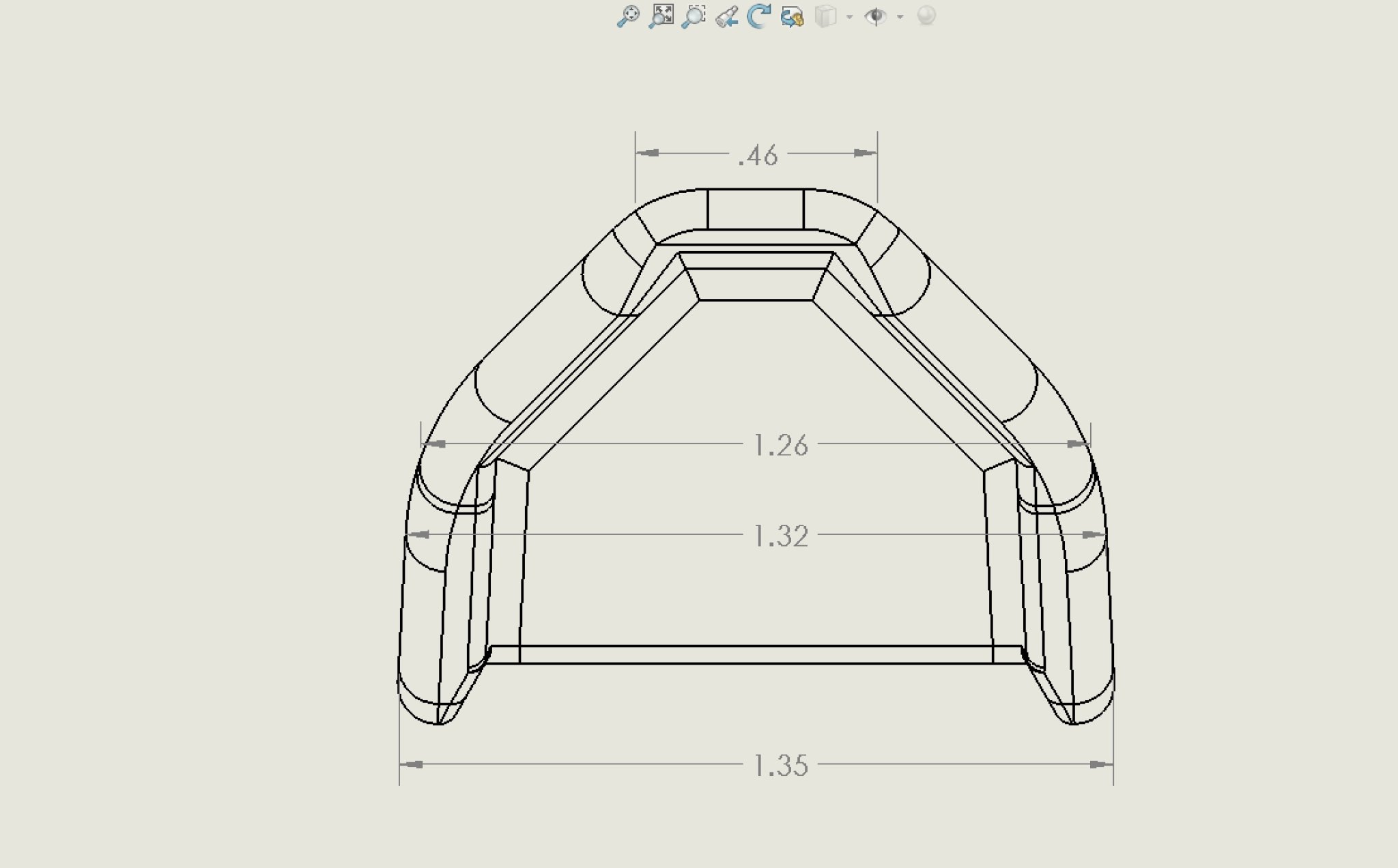

Speaking of the stock, how wide is the cheek piece?
You hit a home run with the position and height on the Sentinel. I think a lot of stocks have the cheek piece too far to the rear or are to wide and push your face away from the center of the optic.
Thank you.
My personal opinion is that almost all glass, CF and composite stocks out there have cheek pieces that are far too large and have too much mass.
The Gen II mold of the SENTINEL reflects my thinking on this in that the CP is much smaller and shaped to help get most eyes into the scope's exit pupil without requiring a lot of head roll-over.
I kept the cheek piece of the Zealot as narrow as possible and still function the way I needed (back of bolt shroud passing under the front of CP on the magnum version as well as nesting down low over the top of the buttstock frame when all the way down.
After 3D printing a number of cross section shapes for the CP, I kept circling back to something close to the Gen II SENTINEL CP. Most face and cheek structures seem to be reasonably comfortable against this profile.
If your stock's cheek piece is too wide, it will always force your head laterally away from the exit pupil regardless of the height setting. This in turn forces excessive head rollover (when we would like to have that as close to zero as possible).
So my thinking is that the user can always add more width with the usual grunt materials but it is usually damned hard to make the width less than delivered.
Here is a cross section with your widths at different locations working.

Terry, I love the cheekpiece hardware, it looks beefy and secure- like it won't move under heavy use... Is that Loggerhead based?
Many cheekpieces on stocks and chassis only have one vertical support, and/or friction only for locking in the adjustment, and they just look cheesy.
Thank you.
The cheekpiece as well as the length of pull adjustments are not LoggerHead based. Not even close.
Both use a totally new Z-LatchTM that I designed about 10yrs ago but was never able to find time and funds to execute it into the chassis project until now.
The system is totally tool-less.
There are zero knobs or throw levers hanging out.
There are no threads in the Z-Latch systems, so we don't have to worry about them eating themselves or jamming up when grit and sand enter.
There are no additional set-screws needed to keep rattle out or to keep the adjustments from slipping.
There are no protrusions on the latches that could accidently release or move when moving with the rifle or when in shooting positions.
The user can actually adjust Cheek Rest height and/or LOP while in shooting position without getting out of the scope.
The Z-Latch on the LOP columns can handle 3 x the shear load of a 16# pound rifle dropping 4.5 feet butt plate first (with recoil pad removed) on concrete.
As far as I know, there are no latch/lock systems out there like this.
It was a total gamble to see if the idea would stand on its own in the real world. So far, I am super pleased, especially with things working so well right out of the gate with Ver. 1.0.
There were many new ideas on this chassis that could fail to function once built so to see them succeed has been a proud parent moment.
