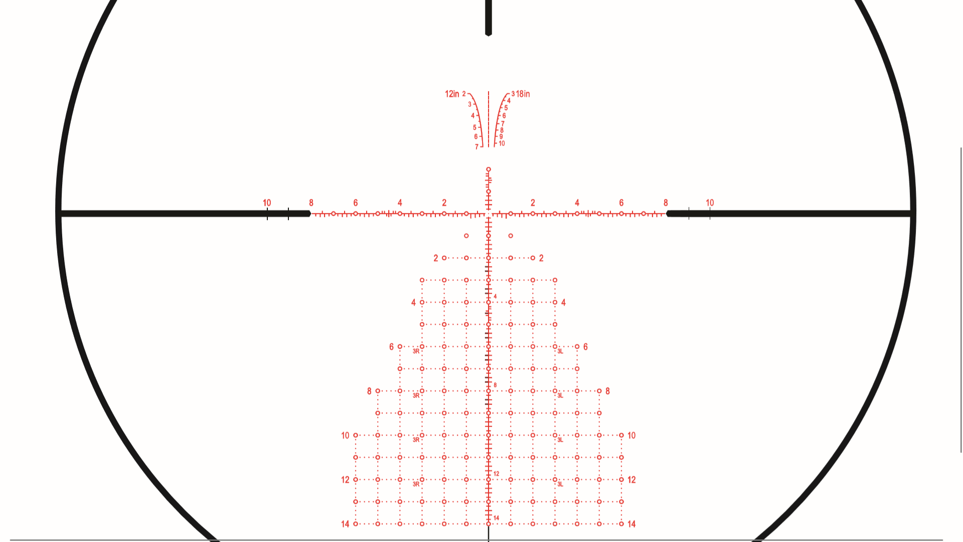

    ZERO COMPROMISE OPTIC is excited to announce a new reticle to our already highly popular MPCT line. The MPCT3 reticle takes several steps forward in reticle design with newly developed features by ZCO.
    Please check out the MPCT3 reticle at SHOT Show, booth number 3562.
    We have heard the request from numerous shooters across the world for a tree style reticle option utilizing dots instead of solid lines. The dot design has several advantages with less image obstruction being the biggest advantage. Shooters using our MPCT line of reticles have also requested some other modifications which the MPCT3 has incorporated.
    Advancements in reticle design include the Fatal Funnel quick ranging concept that was developed over two years ago by our staff. Our quick ranging Fatal Funnel design is the most comprehensive design on the market by being able to provide a direct range readout on four different sized target widths with only one system. These target widths encompass 100% IPSC, 66% IPSC, 50% IPSC, and any other targets with 18, 12, 9, or 6-inch widths.
    Other advancements reside in the tree portion of the reticle where we utilize a series of open circles at the whole-mil locations thus speeding discrimination of reticle hold points but keeping the reticle as “open” as possible. No longer are marginally different sized dots the distinguishing factor which can be a strain to the shooters eye.
    We have also integrated engraved wind hold values for both 3 mils right and left throughout the tree. These tree reticle designs provide the most advantage when holding for both elevation and wind. By incorporating an engraved 3R and 3L indicating a 3 mil hold either Right or Left, counting dots has nearly become obsolete for a proper wind hold, especially at increased elevation holds. Making an accurate wind hold just became so much faster.
    Of course, we have retained all other design parameters from the MPCT line such as the center section and maintaining an uncluttered view down to two mils below center. The all new MPCT3 reticle enhances the ZCO reticle portfolio significantly with enhancements on our current reticle designs and newly developed concepts to make operator usage much easier and faster in the field.
    Thank you ZCO for incorporating dots, but is there a better image of the reticle, those tiny images make it hard to discern, at first glance the reticle actually looks busier than the MPCT2 which I was hoping to get away from, almost looks more HORUS like or GR2ID which I'm not a huge fan of.

    some resemblance to the Kahles AMR? initial impression, don't see me buying it, but i'm sure others will like it. I am in line to get the 2
    Doesn't seem to extend down and to the side as much as the AMR reticle.
    IMO, the AMR reticle is the best ELR reticle out there.
    Not sure how I feel about the circles on the MPCT3 reticle. Would have to get behind one and shoot with it to have any opinions about it.
    Looks like the Mil4+ and AMR had a baby. Imho the rings make the 0.2 subtensions harder to read. But with these kinds of reticles you always have to see it through the scope to truly judge it.

    Greetings everyone! I wanted to wait a few hours for people to see it, get some initial impressions, and make comments before I posted anything else.
    These are just the drawings and we all know that the reticle drawings always look different than the actual view through the scope. I can honestly tell you that the image is significantly less obstructed with the new MPCT3 than it is with the MPCT2 due to the dots and the size of them.
    Our goal with the MPCT3 was to increase speed and efficiency for holding while opening up the image. Not much point in designing a new reticle if it doesn't give an advantage, so that was our goal, and I believe the MPCT3 does that. Let me explain.
    We utilized open circles at the whole mil points throughout the reticle. There leaves absolutely no doubt where the whole mil is, your eye finds it super fast. End users also wanted dots for the tree, for good reason, they are less obtrusive. So implementing open circles at whole mils with dots at the 0.2 points keeps things very symmetric to the eye. You also aren't looking for a fatter dot or some other design for the whole mils. So back to speed and efficiency, you aren't spending as much time locating your hold point.
    As customers have already noticed with our MPCT2, since the tree doesn't start until 2 mils down, your eye doesn't even notice the tree unless you need it. We kept the same concept here. The beginning of the tree starts at 2 mils down but some customers still wanted some reference point within the first mil, so instead of having a single dot at some value, to keep consistency, we used an open circles at the whole mil.
    The rest of the full dot matrix starts at 3 mils down. This reticle is designed for holding both elevation and wind when needed, but be highly functional to dialing as well, so that is why we put the whole matrix at 3 mils down. Incorporating both horizontal as well as vertical 0.2 mil spaced dots greatly aids precise holds especially when holding for lots of wind. We didn't include a dot at the 1/2 mil locations as we didn't feel it added any benefit but would only add clutter.
    When I had our first prototype MPCT3 right next to the MPCT2, seriously, the total image obstruction was quite a bit less with this new reticle. IMO, if you like having a tree for only a few shots but dial the majority of the time, your eye will dig this reticle once you see it through the scope and use it.
    Regarding the Fatal Funnel, it is also positioned at 3 mils up, so will be completely out of the way if you don't need it. But it is still available if you need a rapid ranging function for milling a target. And it's functionality is much higher than any other rapid ranging feature from any other manufacturer that I'm aware of. Most of those are some form of stair step arrangements along the horizontal crosshair.
    If you are coming to SHOT, please stop by and see the MPCT3 in person. I know you'll actually be very pleased with the usability and feel of the image.

    @gebhardt02 I'll say that based on the images, I prefer the MPCT2. However, if the MPCT2 had the "reference points" that the MPCT3 has at the -1 MIL mark, it would make it just about perfect. I like doing holdovers to save time on stages where the elevation is only 1 or 2 mils different between targets, so not having the tree start at all until -2 MILS is a drawback for my style of shooting.
    I actually like the stadia line better than any of their reticles to date. Having all of the .2's stay on one side of the line and the .5 on the opposite side is far more natural and faster for my eyes/mind than previous options. The mil-dots definitely draw my eyes to them, which I like. Would need to look through the actual scope at targets to see if the dots become obtrusive and block out too much of the target or not. Was a mixed bag way back when mil-dots were common.
    The part I don't like is the tree starting at 1 mil. Those two dots are the first thing my eye is drawn to and that's certainly not where I want my eyes drawn. Maybe through the scope would be different than the photo, but initial impression is I wish they would go away and just start the tree at 2 mils as that part doesn't draw my eye unless I want to be looking there. The rest of the tree is well thought out and will work very fast. Though, I will still prefer to dial whenever time permits.
    Funnel on top is... well... I'm sure someone somewhere will like and use it. I'm not that guy.

    I am nicknaming this the geyser reticle because it looks like a diagram of a geyser ;)
    Like Nick mentioned, we have to wait to see it in person, but just looking at this diagram I am not liking the plethora of vertical dots connecting each horizontal tree line. Not sure I agree that the circles are easier to identify than thicker dots, I have had no issues with the MR4 reticle and the thicker dots at the full mil points. I suppose my hope for the MPCT3 was that it would be as unobtrusive as the MR4 and Gen III XR, all the circles in the tree seem distracting and all the vertical dots give it a very busy look. This "looks" a lot busier than the MPCT2 and I do not like it based on the design but I will try my best to reserve conclusions until I see it.

    This new reticle is certainly serviceable. I can see how it would be less obstructive. Personally never liked the AMR squares.
    Personally would go with the MPCT-2 over this in any application I can personally think of.
    Not to say this won't work, I just know I wouldn't buy it.

    In principle I like it and I will probably like it more than MPCT2. I liked S&B's GR2ID reticle, but it is conceptually a very different design ideal for different kind of shooting.
    The grid is around the center there for quick reticle corrections. That is closer to the way I like to shoot. I do not dial everything. I use the reticle around the center a lot, but I very seldom use the part of the tree that is more than 4-5 mrad away from center.
    That having been said, Nick's explanation makes sense to me and I think this will prove their most popular reticle over time.
    I have used this kind of a tree pattern in Kahles' AMR, March's FML-T1 and S&B's GR2ID and it has really grown on me over time.

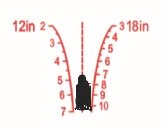

    So if this IPSC below was 12in it'd be 475yds away, if it was 18in it'd be 700 yds away? (Approx)?
    I don't think so, I think it's not centered but off the centerline, so in the below image, I would estimate a full 100% IPSC at 18" wide on the right side would be 500 yards based on this image, and the 66% IPSC is showing on the left at about 650 yards. For 50% IPSC you would double the yardage on the right, and for 6" target you would double the yardage on the left. Nick, please verify if I understood this and displayed it correctly.
    Edit: removed image to avoid confusion
