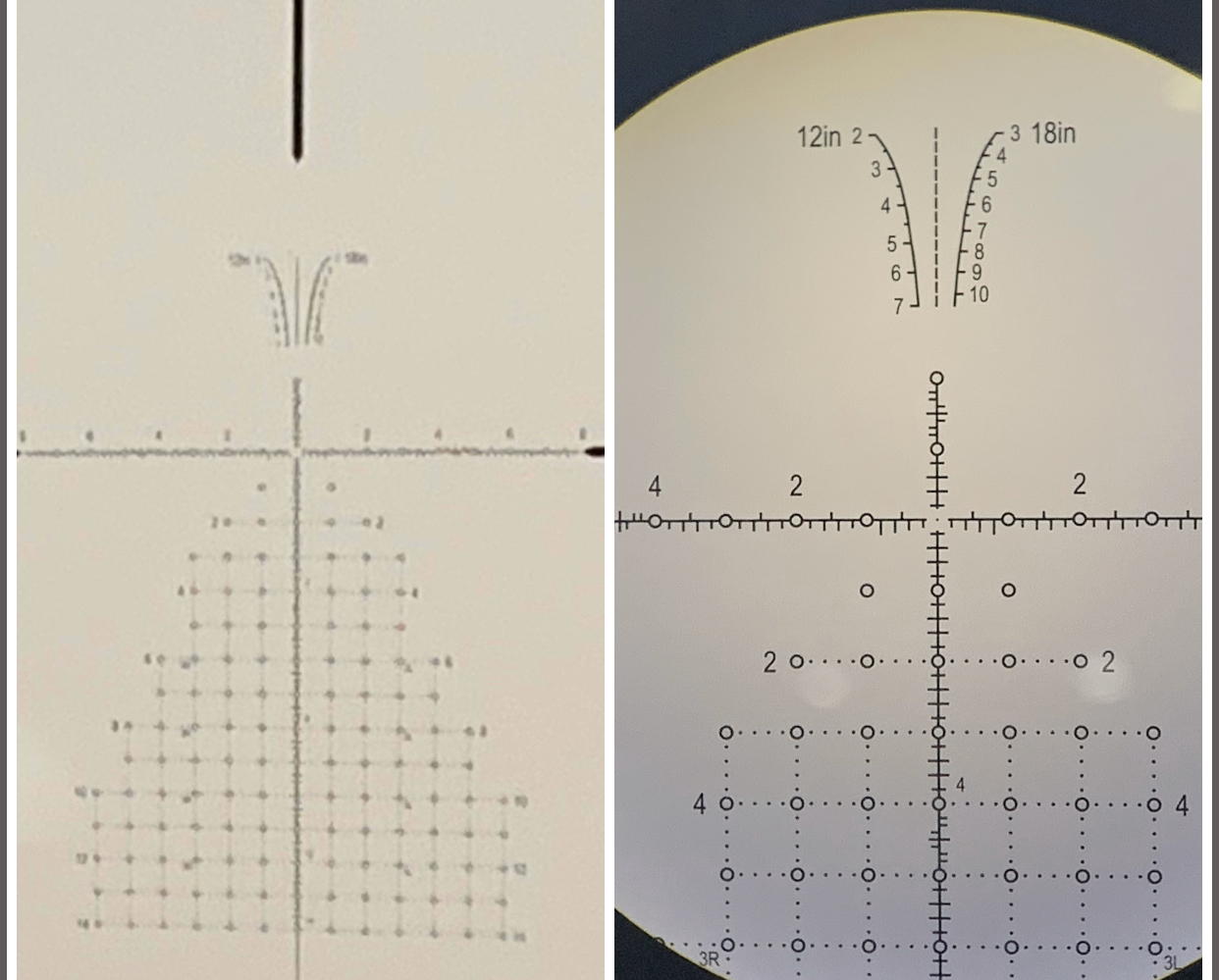

I’ll write up a bit more on Sunday or so. Besides the obvious circles/dots/grid and ranging lady parts, here’s a pic of the two differences in main windage from mpct1 and mpct2.
While the windage still includes the first .2 mil hash each way, the open area around the dot has increased a little.
Once past the first mil mark each way, the .2 hashes are still same size for .2 and .8 and then the same for .4 and .6, they no longer extend north of the horizontal. .5 hashes have been added throughout which will be on the top of the horizontal.

It definitely is a reticle people need to see in person. Night and day difference from paper.
I’ll be ordering one as soon as they are officially available.
Although I could only look at it indoors, it did feel like you could “see through” the Xmas tree area of the reticle. Not that it was too thin to see, but your eye wasn’t drawn to it as much as it appears in photos.
I’ve been using a G2 Razor EBR2C for 4 years, so my eye is used to the more open center and larger Xmas tree composed of dots.

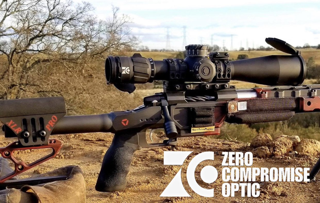

ZERO COMPROMISE OPTIC is excited to announce a new reticle to our already highly popular MPCT line. The MPCT3 reticle takes several steps forward in reticle design with newly developed features by ZCO.
Please check out the MPCT3 reticle at SHOT Show, booth number 3562.
We have heard the request from numerous shooters across the world for a tree style reticle option utilizing dots instead of solid lines. The dot design has several advantages with less image obstruction being the biggest advantage. Shooters using our MPCT line of reticles have also requested some other modifications which the MPCT3 has incorporated.
Advancements in reticle design include the Fatal Funnel quick ranging concept that was developed over two years ago by our staff. Our quick ranging Fatal Funnel design is the most comprehensive design on the market by being able to provide a direct range readout on four different sized target widths with only one system. These target widths encompass 100% IPSC, 66% IPSC, 50% IPSC, and any other targets with 18, 12, 9, or 6-inch widths.
Other advancements reside in the tree portion of the reticle where we utilize a series of open circles at the whole-mil locations thus speeding discrimination of reticle hold points but keeping the reticle as “open” as possible. No longer are marginally different sized dots the distinguishing factor which can be a strain to the shooters eye.
We have also integrated engraved wind hold values for both 3 mils right and left throughout the tree. These tree reticle designs provide the most advantage when holding for both elevation and wind. By incorporating an engraved 3R and 3L indicating a 3 mil hold either Right or Left, counting dots has nearly become obsolete for a proper wind hold, especially at increased elevation holds. Making an accurate wind hold just became so much faster.
Of course, we have retained all other design parameters from the MPCT line such as the center section and maintaining an uncluttered view down to two mils below center. The all new MPCT3 reticle enhances the ZCO reticle portfolio significantly with enhancements on our current reticle designs and newly developed concepts to make operator usage much easier and faster in the field.
We are taking pre-orders for all models of Zero Compromise Optics right now including deposits for the MPCT3, call us at 916-670-1103 or follow the link here: https://www.cstactical.com/Zero-Compromise-Optic

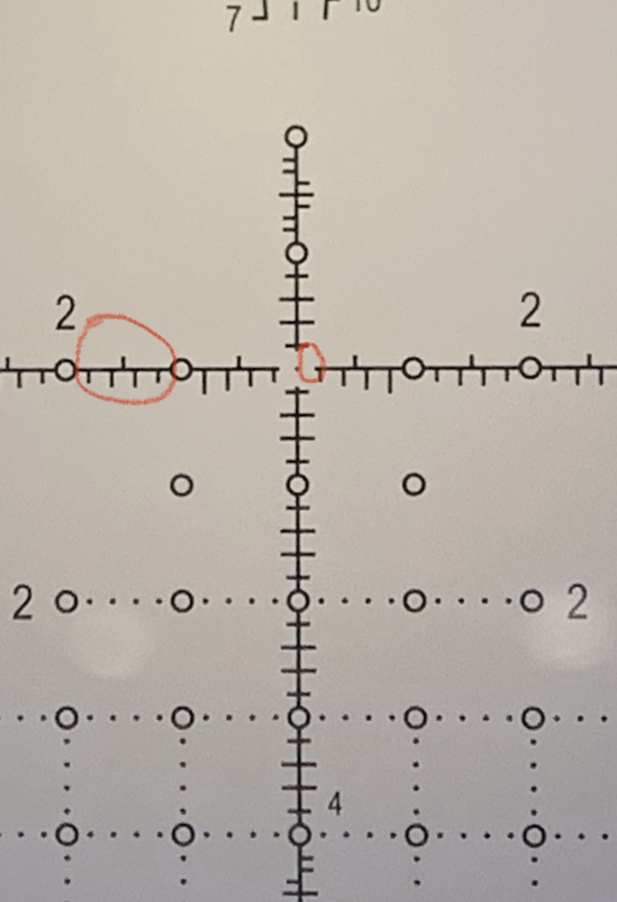

Thanks, appreciate the feedback. I liked what I saw at shot, but looking at a wall 50yds away isn't usually the best indicator lol
I still wish it had another 1 to 2 mils of marked vertical stadia, since I like to utilize hold-unders when it makes sense to me. But as long as the funnel doesn't get in the way of seeing trace, I think it's a winner.
@gebhardt02 at SHOT you and I talked about integrating mil marks into the center dashed line of the funnel. Was that considered or implemented into the final design of the MPCT3? The only pictures I've seen so far have the vertical stadia going to 2.0 mils, then the funnel center line starting at 3.0 mils. Thanks!
Those marks didn't, but because we wanted to maintain uniformity throughout the reticle. We had a quite lengthy discussion on how to best implement some of these ideas, new sketches drawn, etc. In the end, we felt minimal changes to increase visibility through it was the best option. Also, anything more would have been enough to pull it from where it already was for getting production reticles, and that would have just led to further wait times that we didn't think we're worthwhile. Sorry.

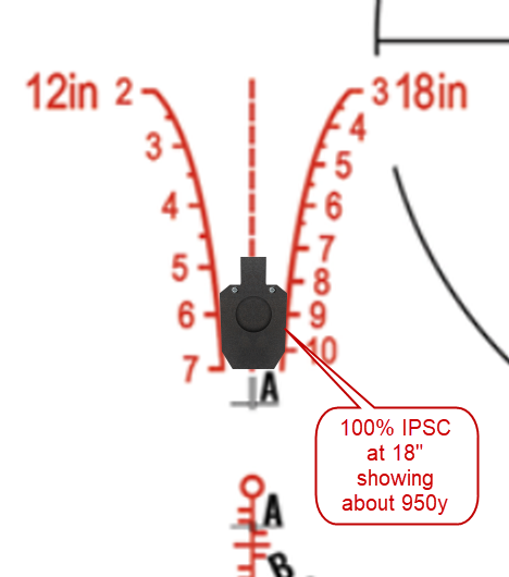

That pic isn't really a great example, the image of the target is laid over the reticle image. But, the measurement is from the very inner edge of the funnel lines. So right where the edge of the target touches the inner edges on both sides.
