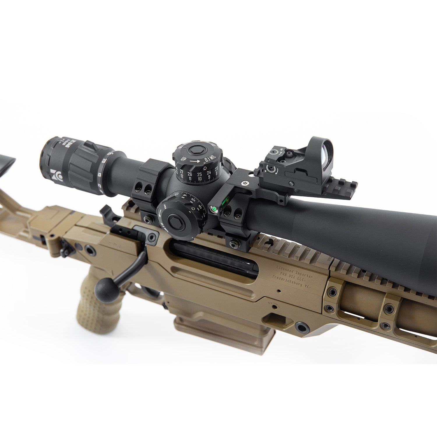

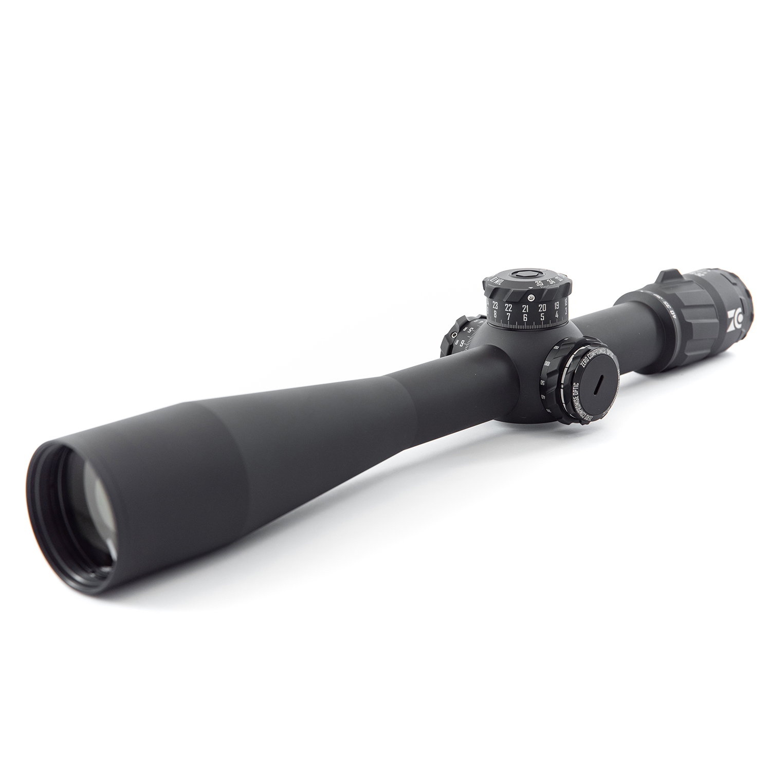

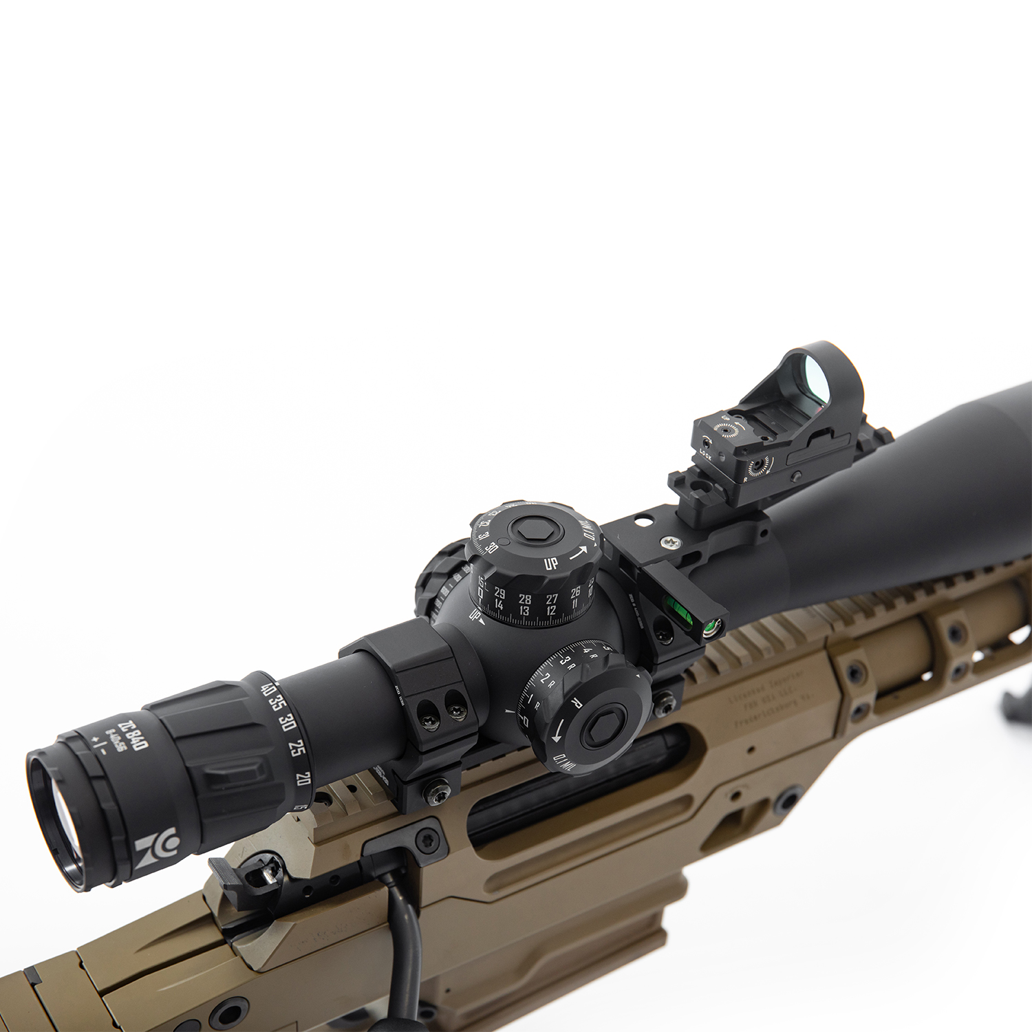

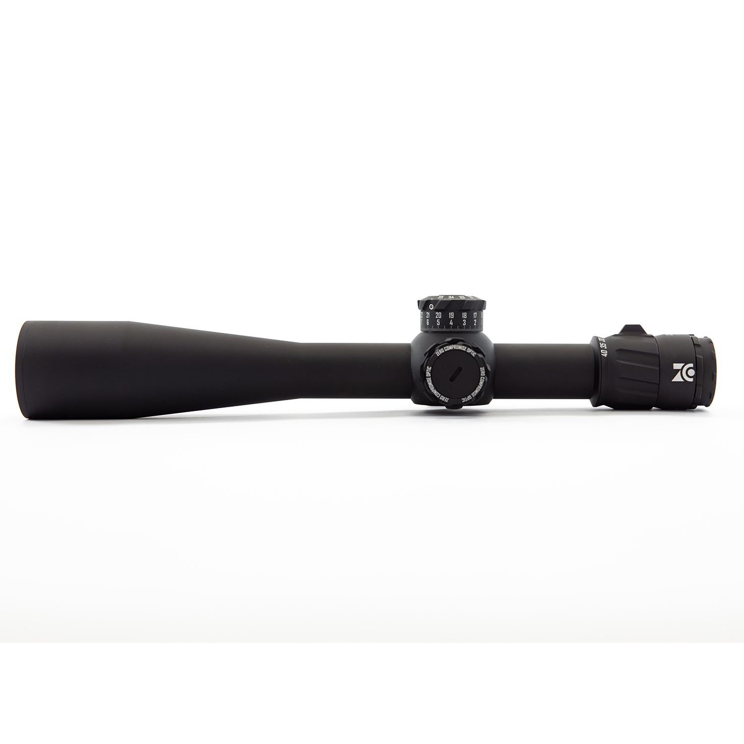

Zero Compromise ZC840 8-40x56 starting to ship to CS Tactical!
I'm glad I've held off on my 3rd ZCO this long! The price compared to the new current norm for the 5-27 is pretty competitive to me, at least relatively speaking. A few things I am curious about:
1. Is there an increase in FOV with the 8-40 over the 5-27 at equivalent powers?
2. Will the reticle thickness be thinner than the 5-27 at equivalent power?
3. Really curious if there will be a slight optical advantage when comparing the 8-40 and 5-27 at typical powers (say 12-20) since that seems to have been noted with other scopes that have 5-25 and 7-35 or similar versions.
ETA: I just noticed the 15m parallax. Super cool! That nice treat for rimfire, especially if DOF is as awesome at typical of ZCO
All that information will be released in the future when ZCO has a chance, the public release was a little rushed since the ZC840 was accidentally leaked on their website. 🤯
As for the 28 mils on elevation, that is just about what I would expect for scaling up the magnification given the existing ZCO designs. As mentioned in the EDC podcast, ZCO initially went with a larger 36mm tube on their 5-27 power in order to both get the 35mils elevation they desired and still have the size erector lenses they also desired for the excellent optical performance they were looking to get. In an internally adjusted scope, there isn't really a work around for this three pronged dilemma. Going with higher magnification in a design decreases your elevation, going with a smaller erector lens system increases your elevation but decreases your optical performance, going with a bigger tube gives you more room but has it's limitations as being off center on the lens system still degrades optical performance. This ZC840 appears in line with other high magnification internally adjusted scopes in elevation to me based on the manufacturers published specifications.
Not trying to start a fight, just trying to learn. If this ZCO is constrained by its size as far as amounts of adjustment are concerned, how does the March 5-42 fit so much more adjustment? They advertise (I don't have one, just reading) 40 mils of elevation, wider mag range, less weight, shorter body, and more FOV even at the higher elevation with a 34mm tube. Are the ZCO internals just that much more beefy? Where is the compromise (pun intended)?
From what I've been told, the closer you get to the extents of the erector cell (and magnification range), the more the optical quality can suffer. You can see this with a lot of economical scopes where the image gets flat and washed out when you're fully zoomed in or elevation is dialed way up. Some would just set the limits to where the optical quality is maintained or they do some better engineering and manufacturing to prevent image degradation.

Interesting that the elevation adjustment is 7 mils less on a higher power scope that is presumably designed for ELR applications which would require a larger elevation and windage adjustment capability.
Any comments on why that is?
Probably the same reason the mk5 3-18 has more elevation available then their 5-25 and 7-35 counterparts
That reason I'm not completely clear of but I'm sure someone with a better understanding then me can explain it

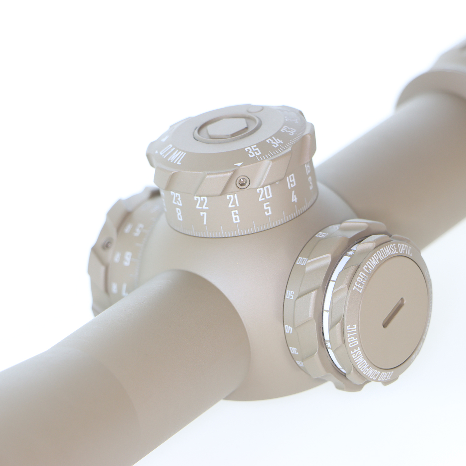

It either needs to be a 2nd focal plane MOA reticle to appeal to the F-Class guys, or it needs to be an ELR 1st focal plane MIL scope with a lot of elevation. This is like some kind of hybrid that I honestly don't know who it is going to appeal to.
With a 36mm Main tube, the only reason I can see them not giving it 35+ mils of elevation is because they needed to keep the reticle optically centered because once it moves too far to either edge, the clarity and eye box go to shit.
I'd love to hear from ZCO why it only has 28mils and who this scope is designed for.

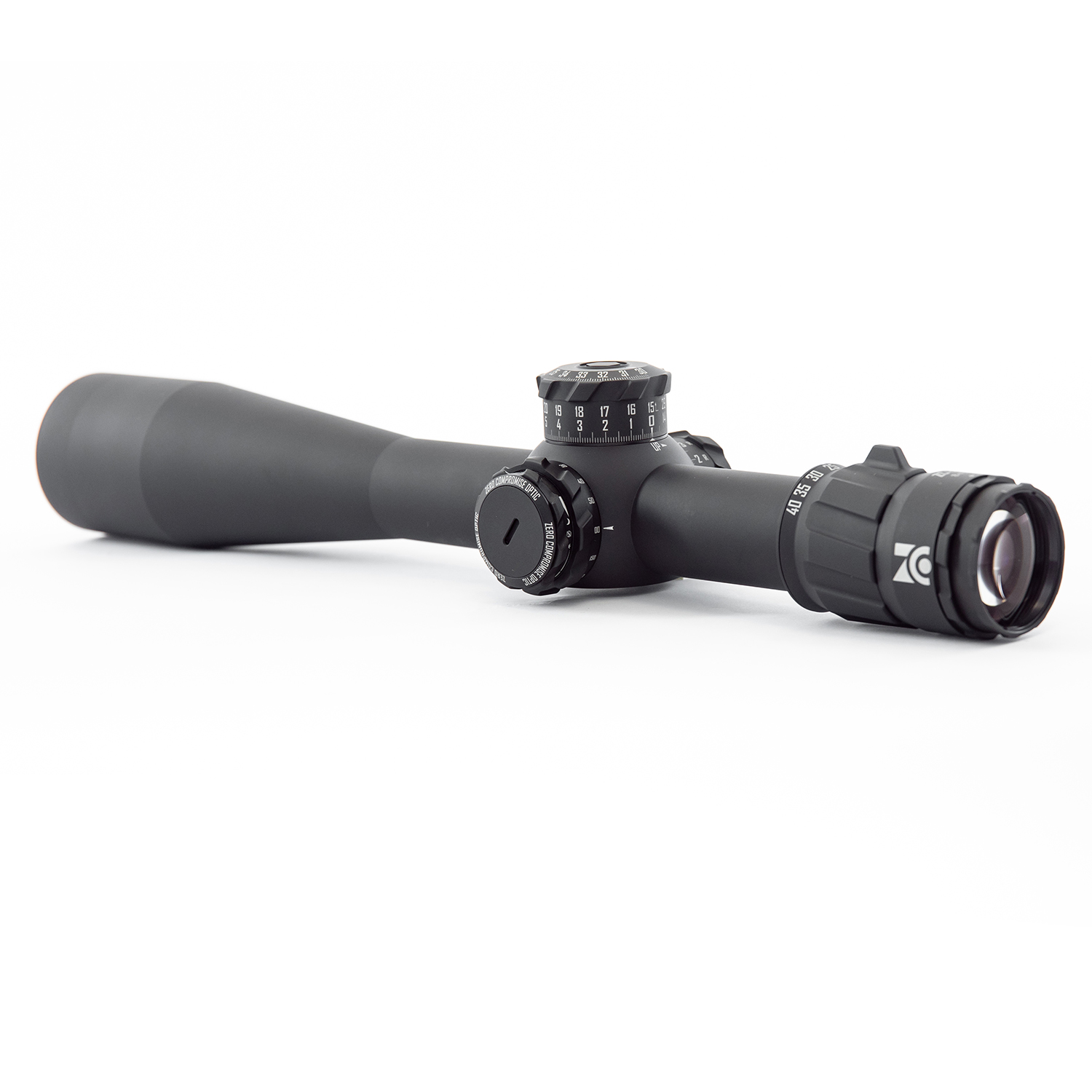

When comparing the field of view in dis-similar powered scopes multiply the field of view by the power as such:
ZC840
low power 8 x 14.8 = 110.4
high power 40 x 3 =120
ZC527
low power 5 x 21 = 105
high power 27 x 4.5 = 121.5
ZC420
low power 4 x 28 = 112
high power 20x 6 = 120
These numbers, which are a good bit like the field numbers in microscopy, provide a good basis for comparing the fields of view for scopes that aren't quite the same power. I have noticed it is typical for the high power number to be a bit higher than the low power one though I am not sure why this is. It does mean that you have to do both the high and low numbers for each scope and compare high to high and low to low. In the case of the ZCO line, the numbers are quite close across the whole of the ZCO series which I would expect as these probably all use the same, or very close eyepieces. Based on this you can expect very close numbers on the FOV of the ZC840 to the ZC527 when they are in overlapping power ranges.
