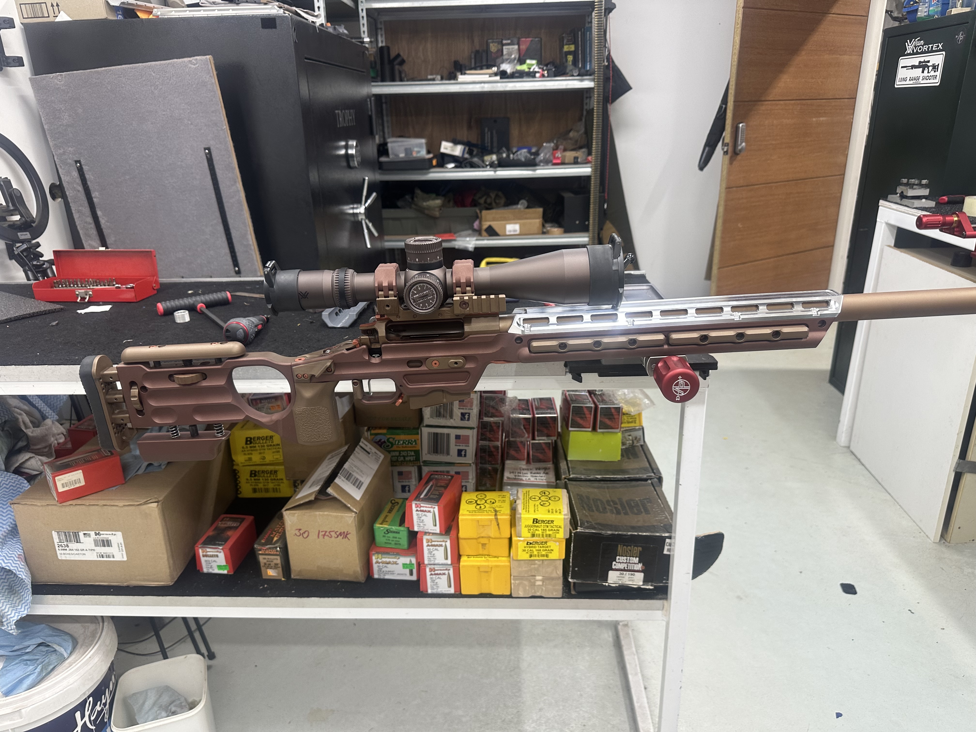

Another happy customer with his 6 ARC build! - Richard
Call or text me to get in line and for the best combo deals at 916-628-3490 - Richard
Also contact us to build you a complete ZCO package with accessories. FDE flip caps are also now available!
