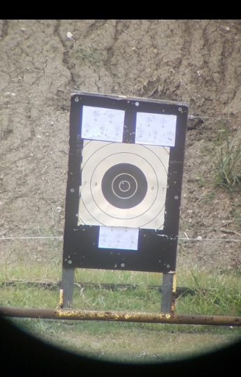

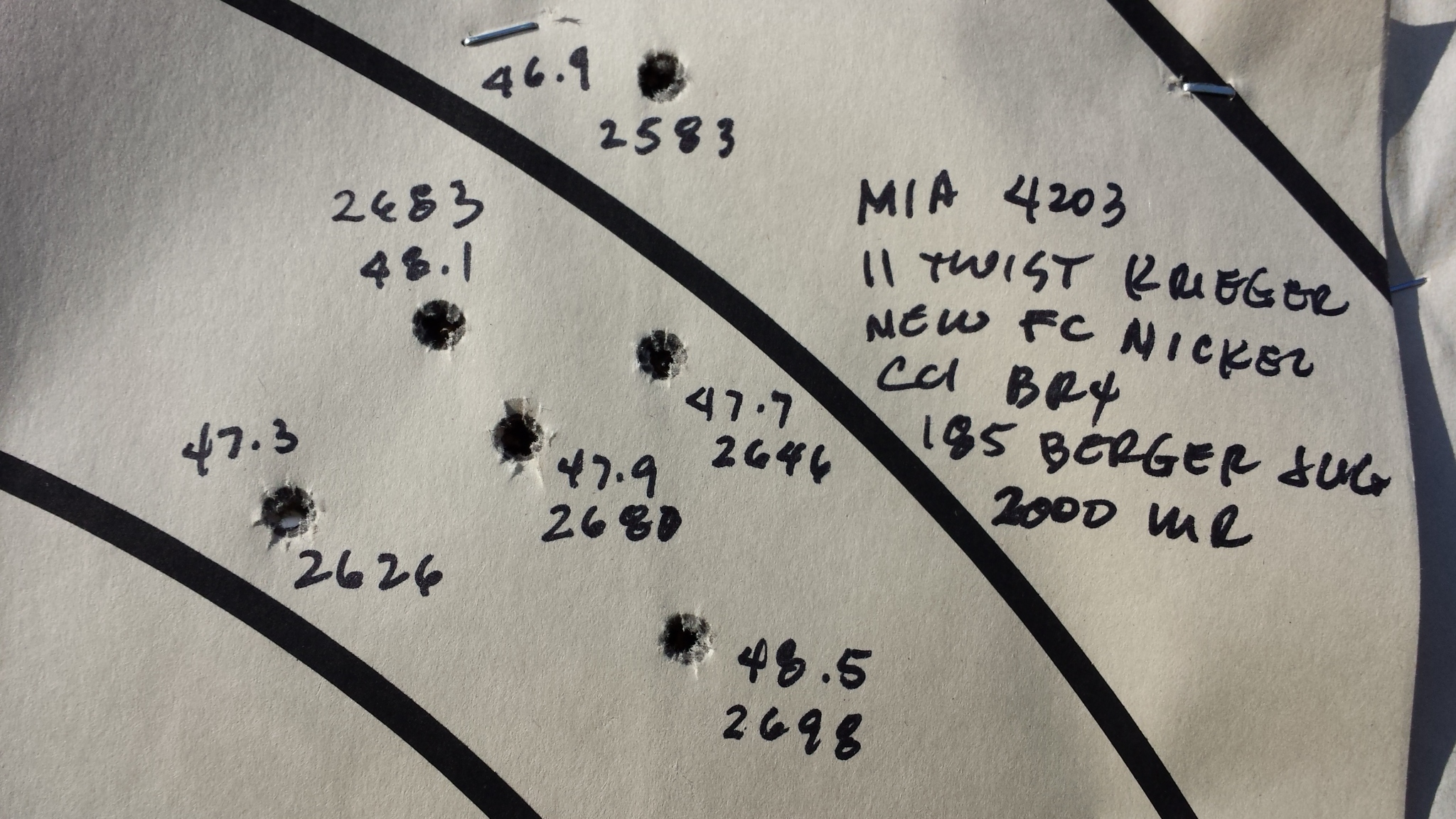

Here is a sample. I did a short ladder from the bench at 200 yards, this is with irons. Load work was with 0.4 increment. When I saw the two that were close elevation wise I loaded one in between the two powder charges. When it landed at almost the same elevation, I cranked down on the sight and loaded 10 rounds with that center load, 47.9 grains and shot a 5 shot group. Satisfied I cranked 2 minutes left and fired 1 round, cranked another minute and fired 1 round, another minute and fired 3.
With that load and with that number of rounds I took it to a 1000 yard match and won it.
BTW, primers were not BR4s
Here is another one, an AR this time . New barrel same 600 yard load from a previous barrel, fired 2 rounds after bore sighting, 4 o'clock, cranked up to see if it follows, 2 rounds it did, adjusted for center 3 rounds, clustered. 200 yards with irons. I was done, won or placed in many matches at 600 yards, prone and sling.
Another one, in Scotland while on a business trip, borrowed rifle from a friend there 10 rounds. Why do I need 20-40 rounds? Guess what, after days of shooting I was awarded a British NRA medal in the match that followed up in Blair Athol where we shot up to 1000 yards.

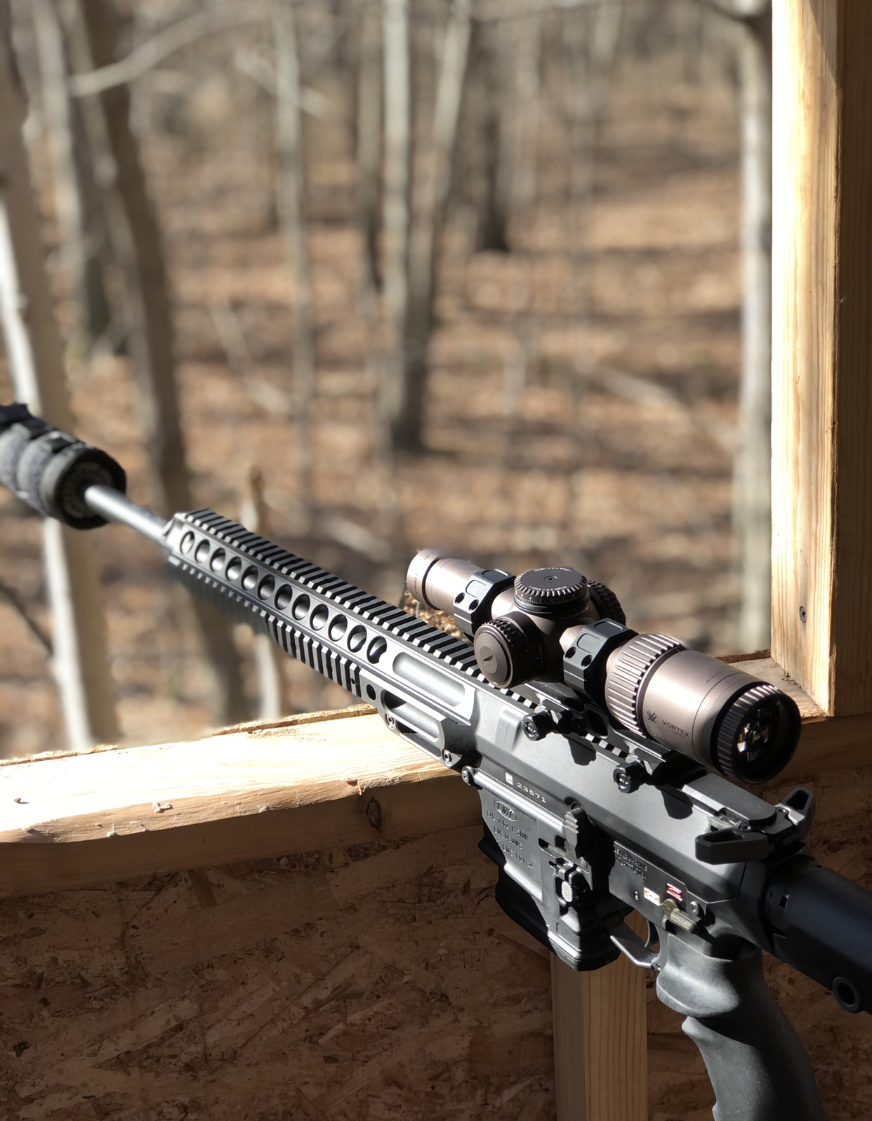

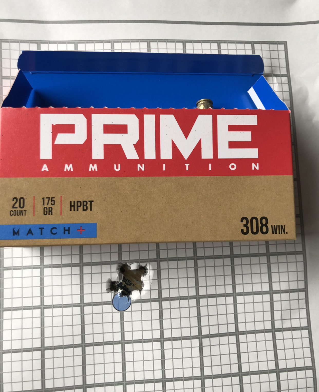

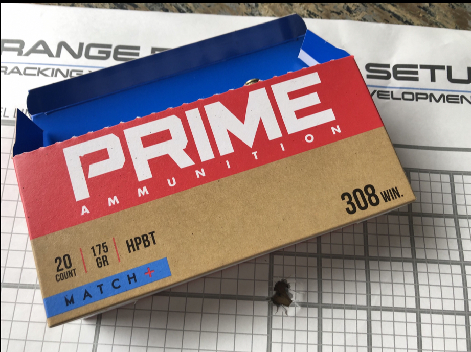

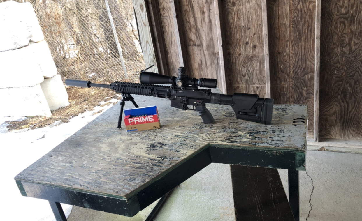

Sure, attached are my a few groups of less than one MOA strings with the following setup:
LMT MWS 20" barrel, stock buffer tube/spring/buffer (used rifle, I am not the first owner)
Geissele SSA-E trigger
SiCo Omega 300
PRIME .308 ammo - FACTORY AMMO
paper was at 100m on a bat shit cold Wisconsin day
Scope while shooting was a 5-25x56 BEAST
To answer the OP's intial question...Yes.
I'm not sure what the goal of this thread is after reading all the posts, sub-moa, accurate and precise AR10s / large frame semi-autos exist. To me my pictured groups don't prove much, except that I now know the rifle's capabilities at 100m(with some left on the table too) and trust the rifle. I'm no sniper, I just trust my training, apply fundamentals and frickin love shooting, wish I could do it more but the semi auto is a known can opener for excuses. I really believe most modern day ar platforms are sub moa rifles, but the shooter is not. I've owned Seekins Sp10, JP LRP-07, multiple LMT MWS, LWRC REPR all shot very well with the LMT shooting the best when group sizes were compared.
These groups were from the first day of having the rifle, first 12 shots ever with the rifle after installing the new barrel that day. The smaller group is a 5 shot group when shooting slow and for group size, the star shaped group is a 7 shot group in a "rapid fire" style where it was quick cadence of: bang, trigger reset, bang, trigger reset, bang and so on 7 times.
These groups are not conversation pieces or framed on my wall, they're what I start with when I get a new rifle. Does it group well when I apply my skillset yes/no, if yes I move on to the next shooting string/distance/position/training agenda item, I don't dwell on it at and spend a ton of time at 100m. If no, I try to diagnose: was it me, is everything torqued down correctly, did things stay torqued down, etc.
This rifle is extremely accurate, at least for me, when deer season comes along like it did a few weeks ago, I throw the razor 1-6 on it and it gets the job done.
End of the day sure some rifles have manufacturer issues that effect accuracy but I believe there are many "sub-moa" semi-autos out there but probably fewer "sub-moa" semi-auto shooters.
Just because you have a V16 Cadillac doesn't mean you'll win the race, you have to be able to drive it too.

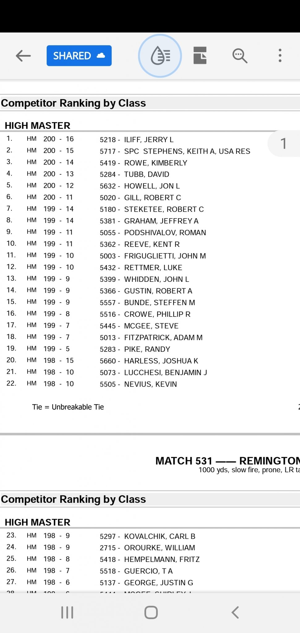

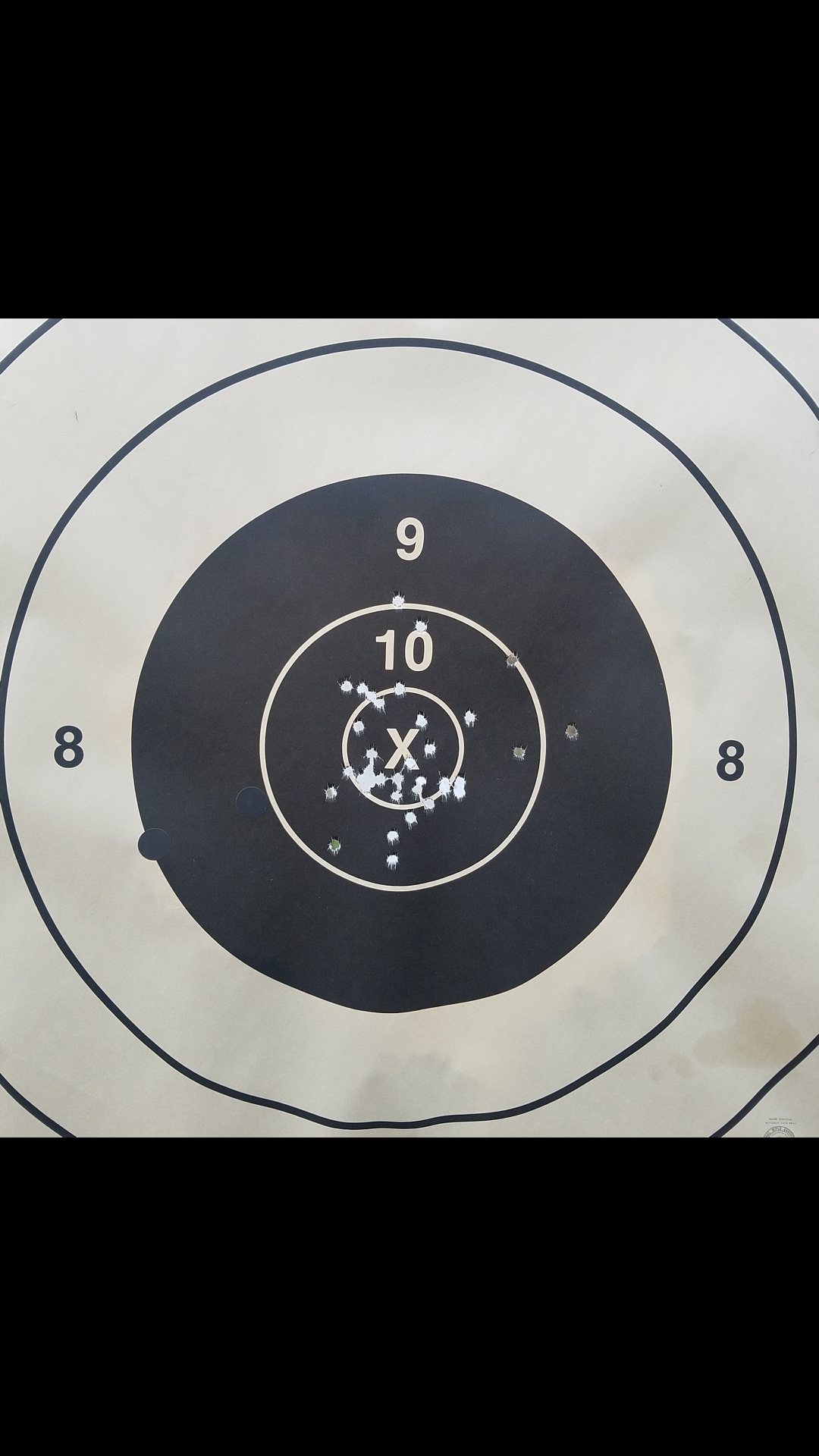

This is the best 20 shots I've seen with an AR10, 200-15 at 1000 yards. Just barely larger than 1 MOA. This shooter and the one I showed with the 200-18 at 600 both shot for the state. I did shoot with them after my stint with the state team cut short by my 4 year expat to China.
Keith won the President's Hundred in 2016 with the barrel we spun up in my garage shop. The following year the Reserves recruited him.
This match was at Atterbury in 2018. He was the only gas gunner among the top prone shooters in the country.
