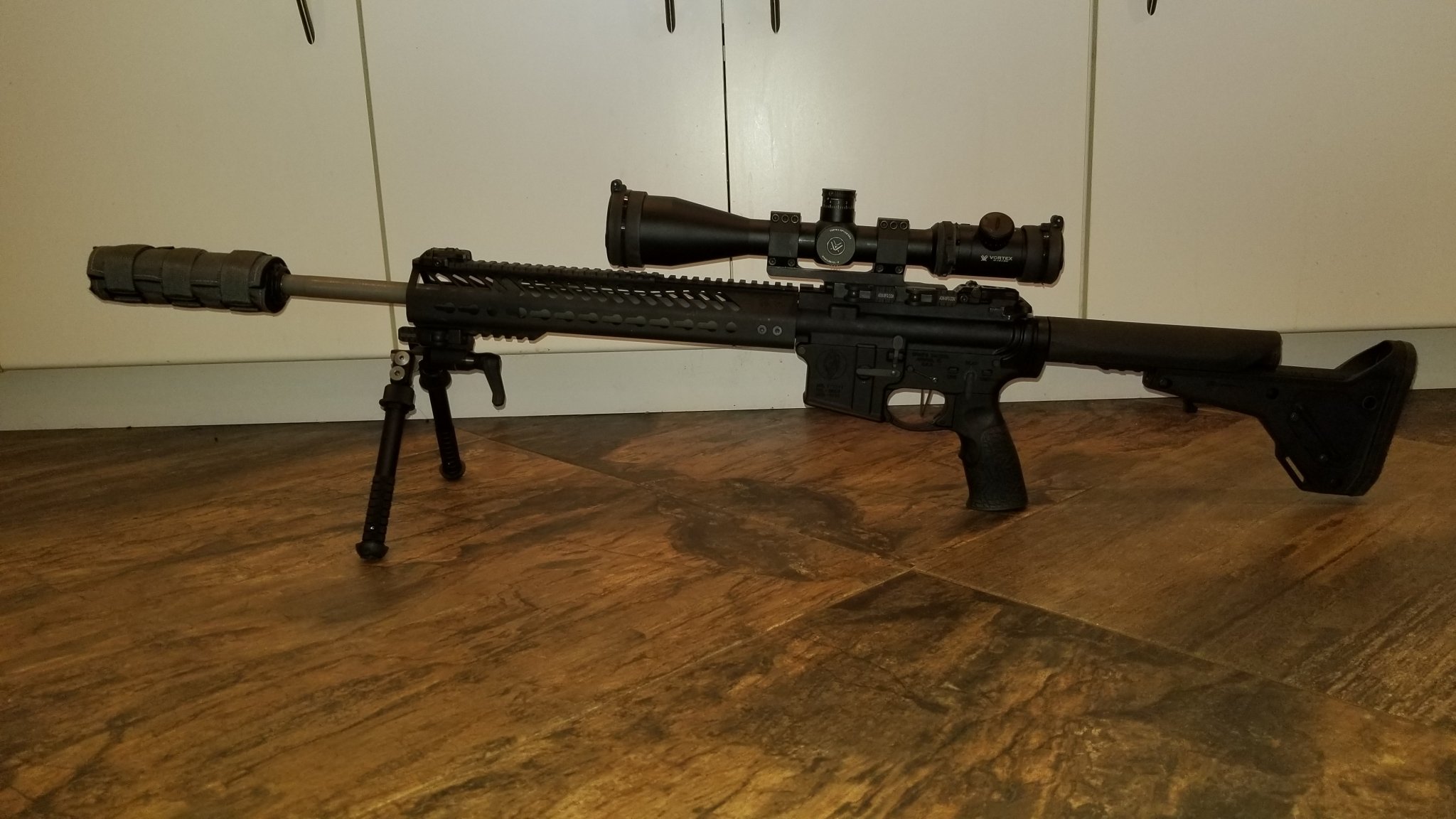

“Precision” AR accuracy expectations?

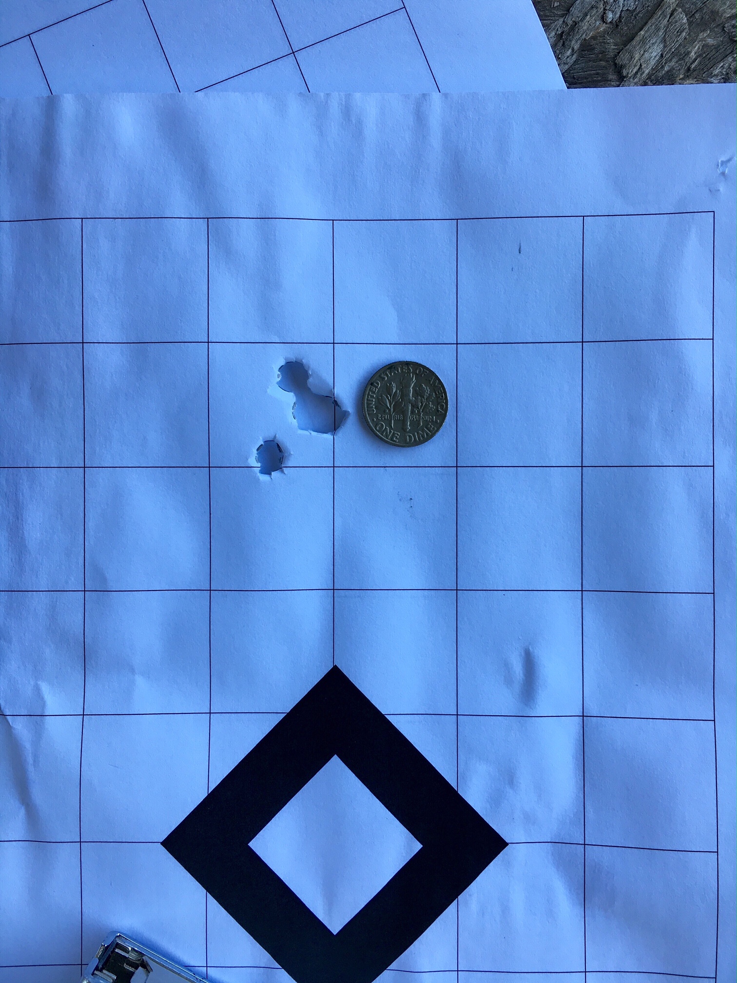

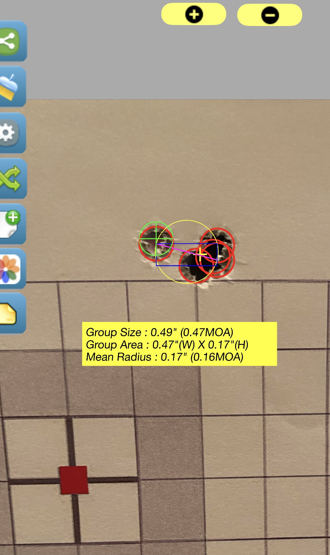

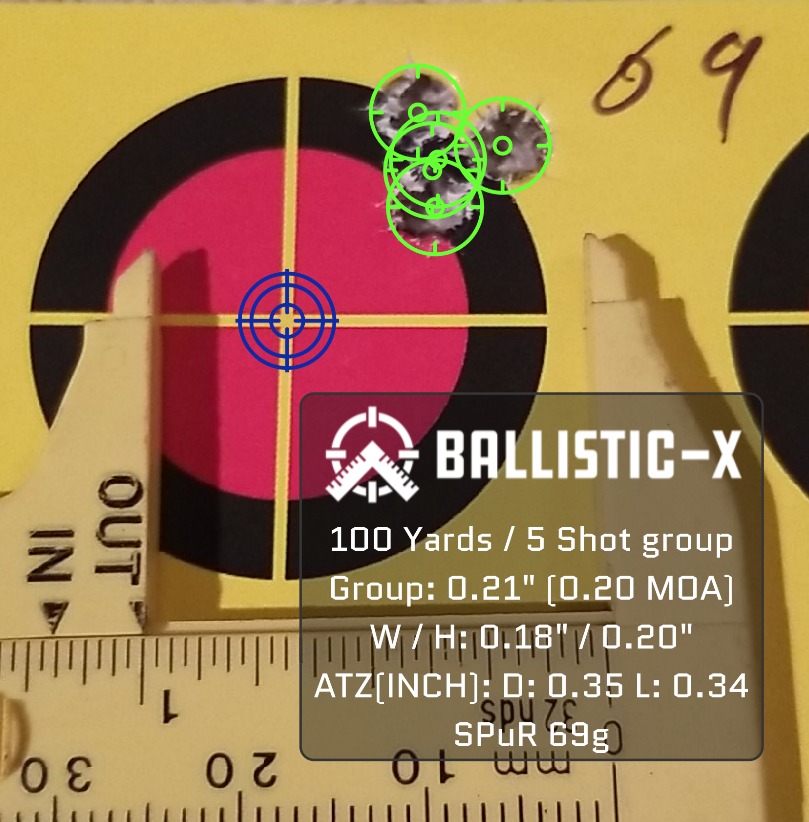

I probably should have stopped after the 4th group, when I had the magical 20rds. Group 4, bottom right was 140eld handloads. All others were Hornady AG 140’s, with group 5 being in the center. I did experience a feed issue during the final group, but I think switching the bullet/powder combo may have impacted more. Either way, this is what I expect from a gas gun, sans the final group.
Shot using a bipod and a small rear squeeze bag.
Sighter group with handloads since I swapped scopes to this rifle. I only adjusted down 2mils, so the L/R point of impact remained the same as the other handload group.

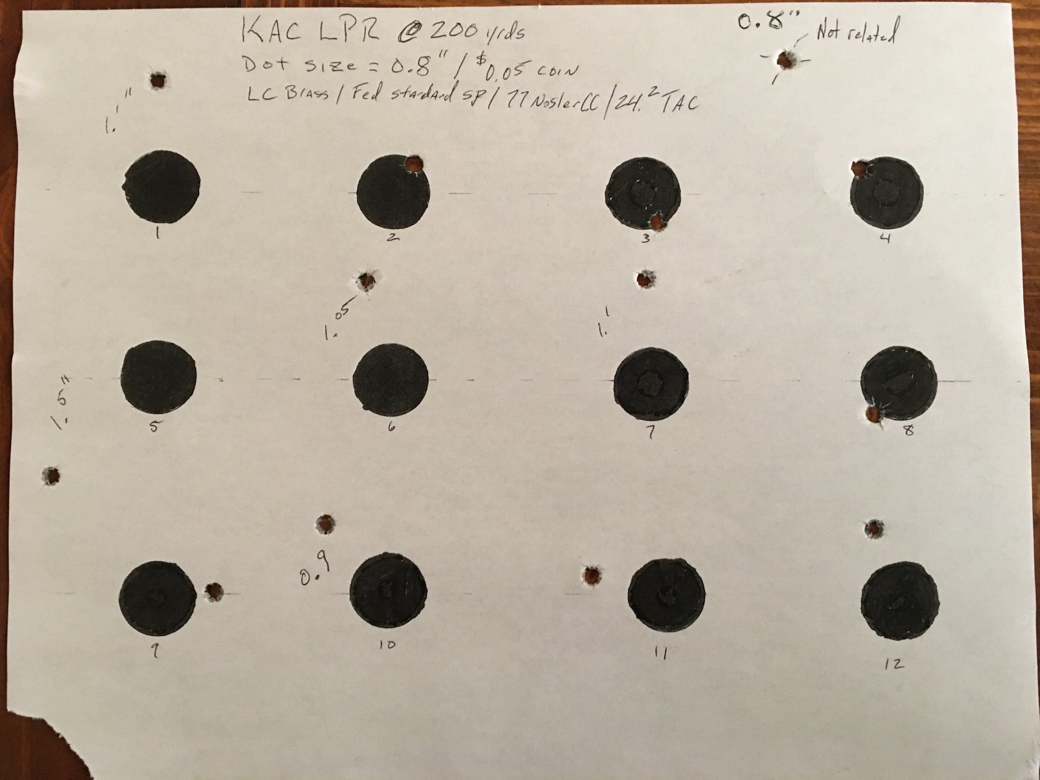

Prove it, please.
20 shots, no scope adjustment, one piece of paper, either at individual dots, 7x 3 shots, 4x 5 shots or a single group. I don't care. Just don't adjust the scope over the 20 shots so we can put them into a composite group and either you show us the light or I'll show you. If you get 20 shots sub 1/4 MOA on the same piece of paper I'll find a way to get you some replacement ammo/components. ;)
It's a no brainer if you're serious about ethical hunting. The true dispersion pattern of you and your rifle is what matters, not what you've convinced yourself it is. When you take a shot at an animal you don't know if you're going to get the shot that's dead nuts center, or if you happen to get the shot that lands the farthest away from MPOI. You should know what the limit is on those shots fathest away from MPOI to get a good basis for how far away you should be shooting at those animals' vitals.
I'm not saying your rifle won't shoot 1/4 MOA. I just want to see it. Theoretically a guy that says his rifle is 1/4 MOA and bases his hit probability or otherwise convinces himself of its capabilities in order to judge max effective range on that assessment is going to be the one that has a bunch of unexplained failure with what turns out to be a 1-1.5 MOA rifle.

AR's can certainly be very accurate. I've built and shot precision AR's and am selling one right now. If you have great technique (which I don't) then you can get close to bolt gun accuracy. That said, 1/4 MOA groups are pretty strong shooting I don't care what you are shooting, and especially so for an AR. I've not ever been able to do that kind of shooting with any consistency. 1/2 moa maybe, but not under that. Even a 1/2 moa shooting consistently is absolutely fantastic shooting.
Prove it, please.

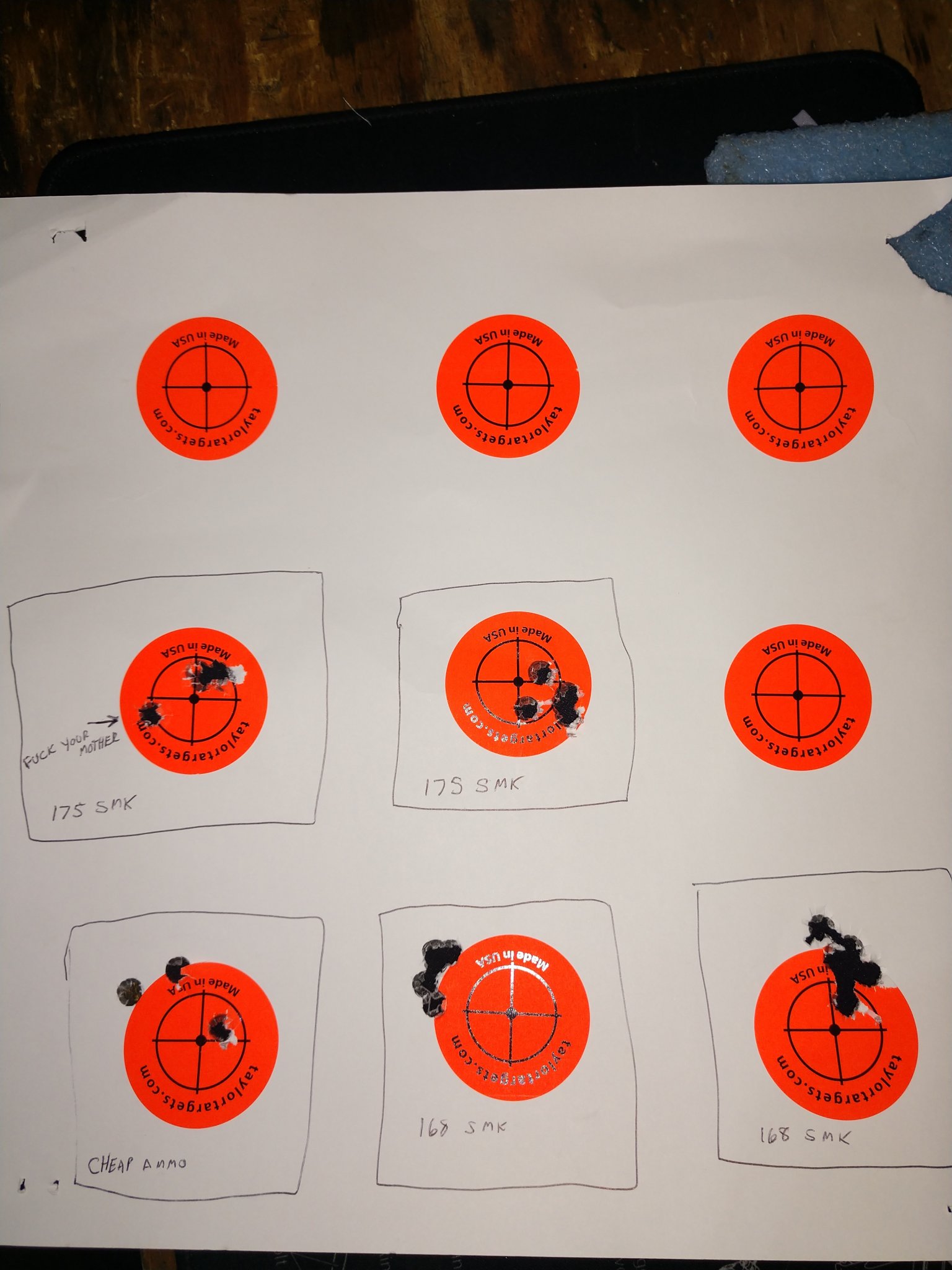

Recently swapped to a new scope, so I'm probably going to the range weekend after next. You want 100yd or 200yd? I'll do 4x5 at one or 2x5 at both. Don't like 3 shot groups and not trying to waste more precious primers than I have to right now.
And at no point did I extrapolate 1/4 moa to max effective range. While this gun will hold tight out to 600 if I'm in the zone, I will still take my creedmoor for longer range--still on an ar platform and still nearly as accurate as my 6.5 bolt gun.

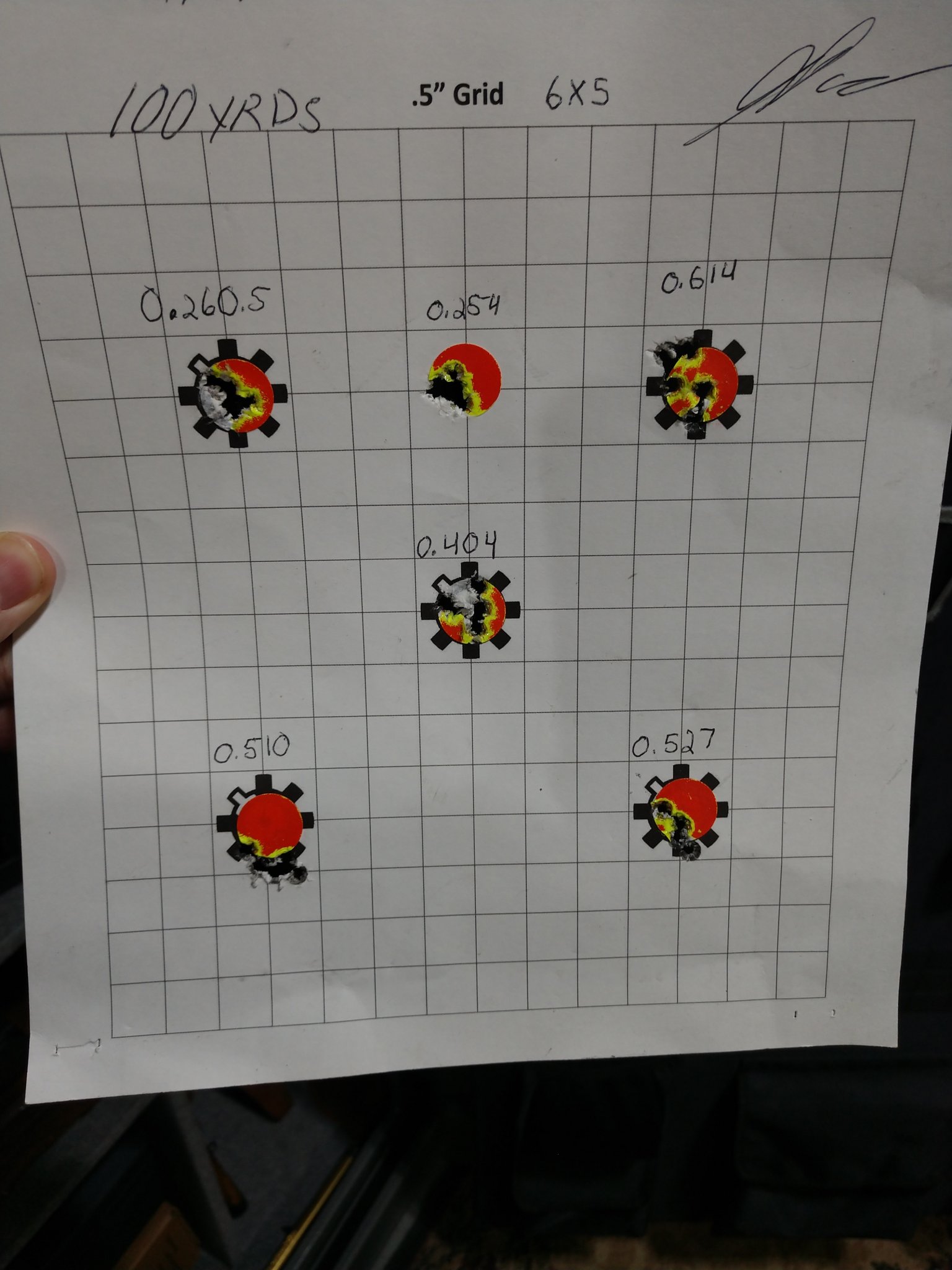

If you can shoot 5 consecutive five shot groups at 100 yards and get those groups to average .25" I will bow down before you. Hell, if you can average twice that I'll be impressed. I average about .5-6." with two of my bolt guns, but even then my best groups are rarely sub .3".
And with my AR's on a good day with the most accurate of my half dozen AR's I'm happy if I can average a little over 1 MOA (although I will concede that some of that inaccuracy is on me).

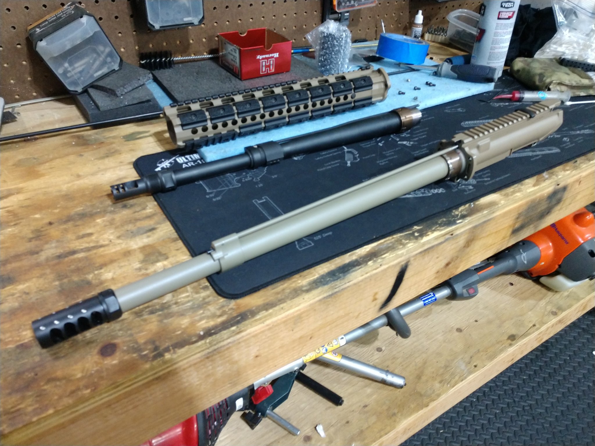

So my question is what do you mean by unremovable? Are you using some kind of aircraft epoxy to bond the barrel to the upper receiver?
How is that any better than a barrel maker like Craddock that the last barrel I got from him I had to literally press the barrel into a Mega upper.
I guess my point is if you can get a really tight fit such as a .000 to .001+- to where you have to either heat up the upper receiver or literally press the barrel into the upper then torque a barrel nut on how is that any different then the mechanical bond of say a Remington 700 barrel threaded and torqued onto a receiver. I’m just asking because I’m trying to understand where the advantage is gained especially if you cannot remove a barrel when having to remove a barrel is a primary concern on many shooters that want utmost accuracy but go through barrels every few years?
Nah, not truly unremovable. Just enough of a pain to buy a new upper. I shim the barrel extension until it has to be hammered in when the barrel is frozen and the upper is heated, then when I get it started about 1/3 inch, I coat the remaining exposed extension/shimstock with red loctite 272 or green loctite 648. Hard to say if this is the magic, but I think it helps as I crank out accurate uppers and this is one of the things I do on absolutely every one. The benefit of pairing the loctite with the tight fit is the loctite is also expanding and filling out any gaps that might exist between the barrel extension and the upper. The reason its best to just buy a new upper when you want to replace a barrel is because yanking that barrel out, even when you fry the loctite, is a nightmare and I don't really trust the upper anymore after I work that shimmed/thermofit barrel out.
I agree with you about the mechanical bond being similar to a Rem 700. There is no doubt that a threaded fit on a rem700 with loctite has less possible wiggle by virtue of the threads (and the AR's barrel nut is different in this regard, because those threads are just providing tension and fitment with the nut, and the barrel extension is still free to make very miniscule movements on the introduction of high pressure--not really the case with a rem700 barrel), but with a thermofit and loctited barrel on an AR you are cutting this free movement down to nearly nothing anyway. If you are using a craddock cut barrel and you have to press it in, I would say you are damn close to the bonding of a rem700. Pair that with a mega upper (which I think has super strong, reinforced material at the front of the receiver to eliminate poi shift from loading a bipod, etc. on the handguard), your only remaining mechanical precision concerns are the gas tube and the slop of the BCG.
Also, out of curiosity, what you mean you had to press the craddock barrel in? Like machine press it in? If so, that's pretty damn awesome fitment, so long as you are able to machine press it without messing up the crown. I use a rubber mallet, freeze the barrel in the freezer, and cook the upper to about 350. Mind me asking what machine you use? If I find a way that makes me comfortable (re: the crown), I would love to do that and it would let me use slightly thicker shimstock.
So what uppers are you using and what BCG have you found that have the tightest tolerances? I’ve used Mega almost exclusively for the past 5 years and Noveske before that but with Megas merger and the supply drying up and the long lead times of Noveske I’m looking for another manufacturer. I did try Zev recently and while ok I prefer a beefier receiver.
I heated the upper(Mega MML) to about 300 and froze the barrel. Using anti seize on the barrel I used a vertical hydraulic press like most auto shops have. The barrel was threaded so I installed a brake to protect the crown and used a couple of pennys to protect the brake. I supported the upper with a piece of pine wood. It did not require any effort in the press and I could have easily used a mallet to tap the barrel on but I usually run into alignment problems with the indexing pin. By using a press I can control movement and pressure.
On a second note it wasn’t only the craddock barrel that was tight. I removed that barrel and sold it (224 Valkyrie that I won’t get in to) and put a 223 rainier match barrel on and it was also very tight, difference being I got it on by hand using heat/freeze method.
Most Mega receivers I’ve had were tight but this particular one was definitely tighter for whatever reason.
I might add to that,
It was enough pressure the first time I was a little concerned about splitting the upper receiver. If you were to use vertical press I’d be very careful about how much shim your adding. While there are plenty of methods of protecting the barrel and receiver if you were to add too much material I would worry about splitting an upper receiver. I was almost thinking of removing the anodizing on the upper but I got it to go without.

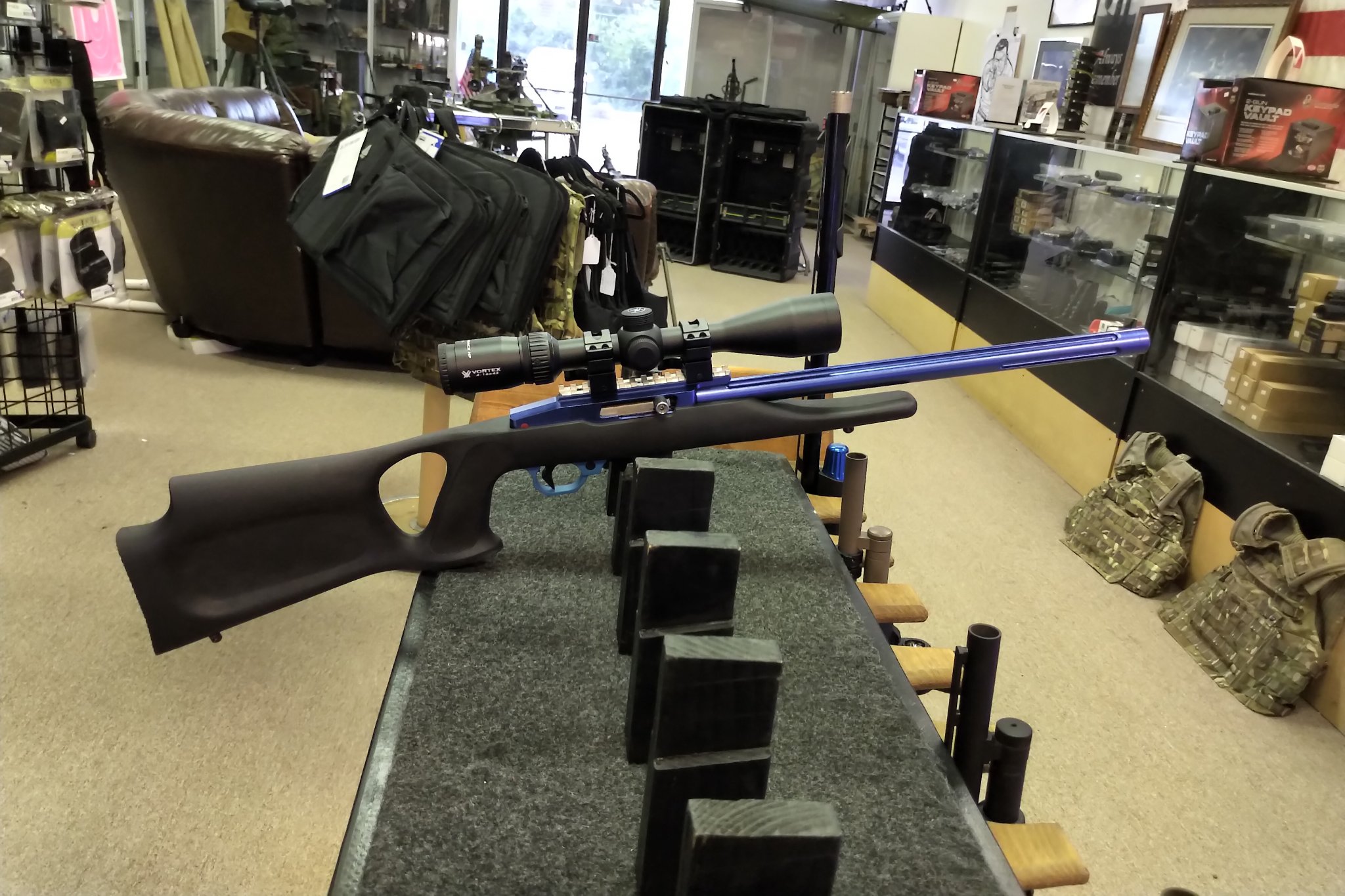

That's how I fit my 10/22 barrel in. I have to say, it's solid as hell! It's an exceptionally good way to do it. There she is at my buddies gun store after getting a little touch up from an unfortunate accident involving her hit the driveway. Didn't budge POI either
That is a strangely cool looking rig. What trigger is that?

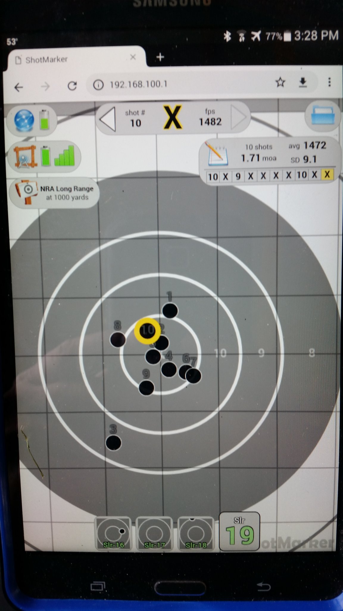

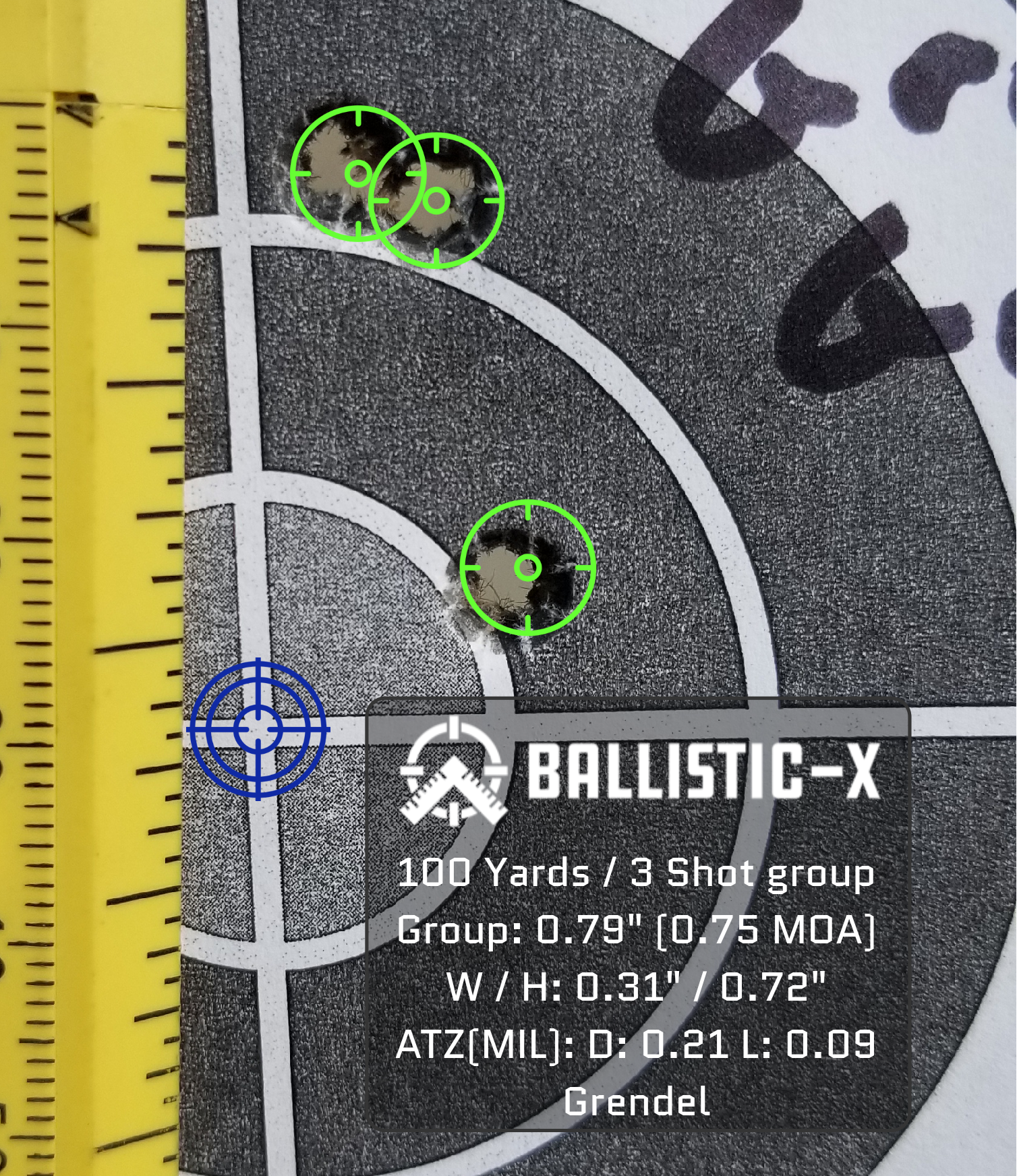

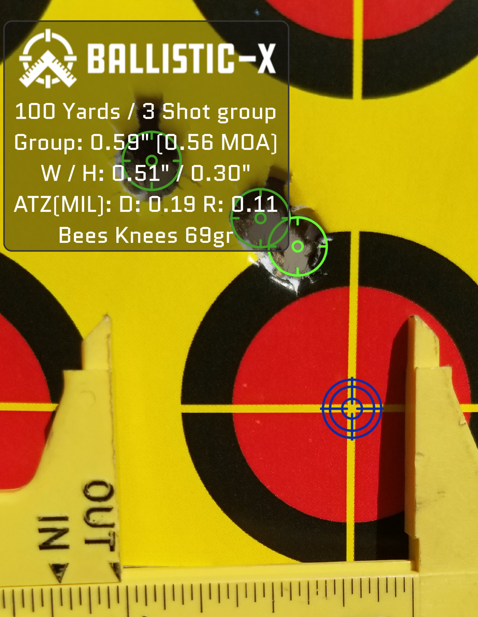

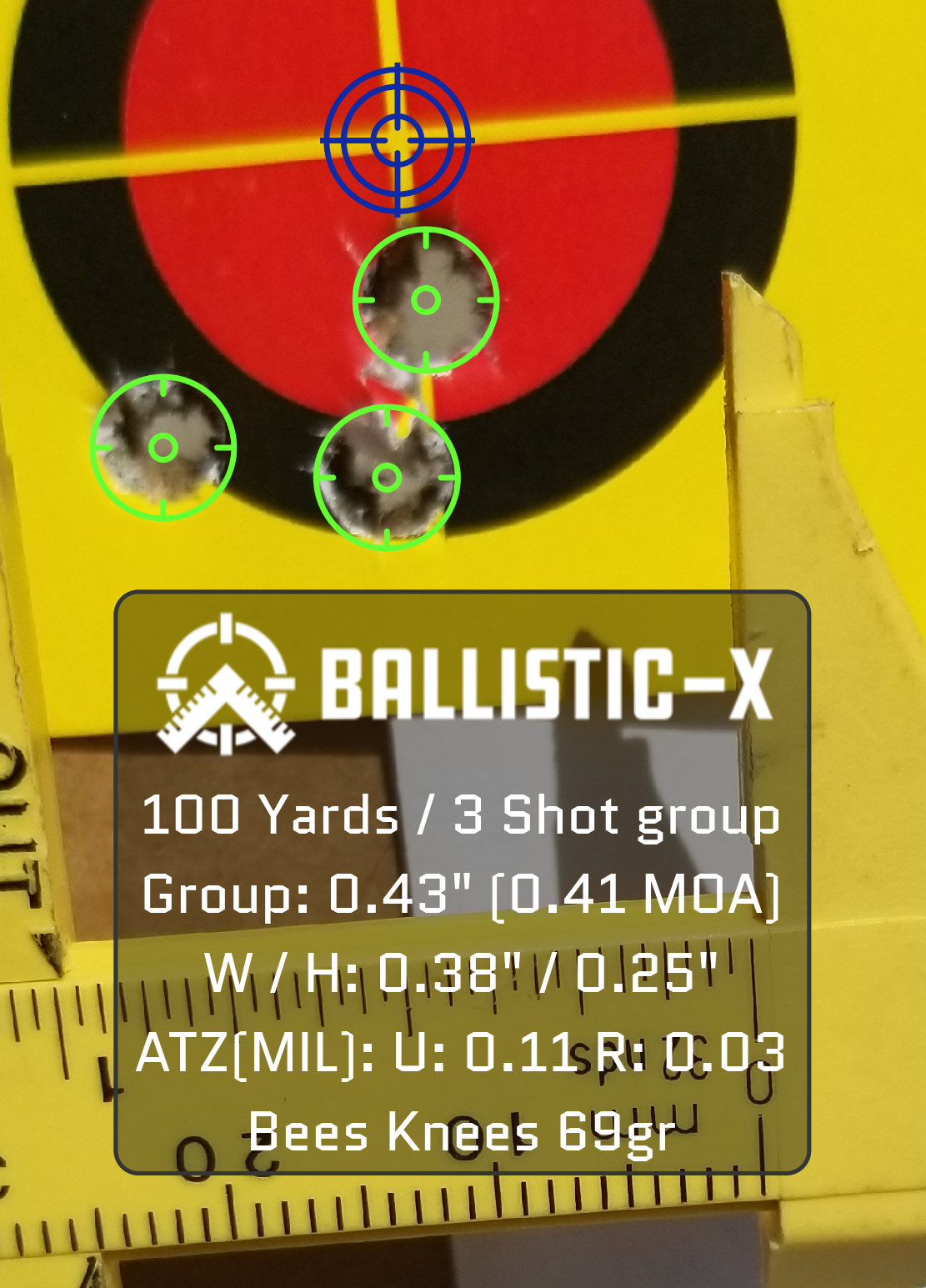

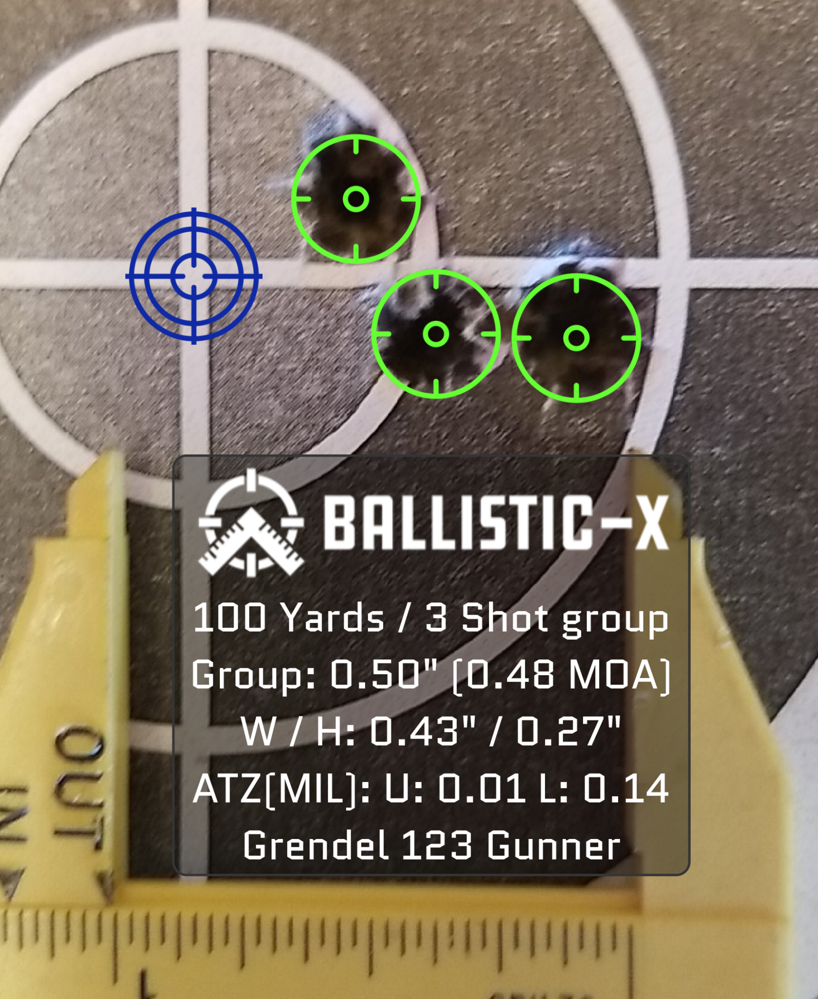

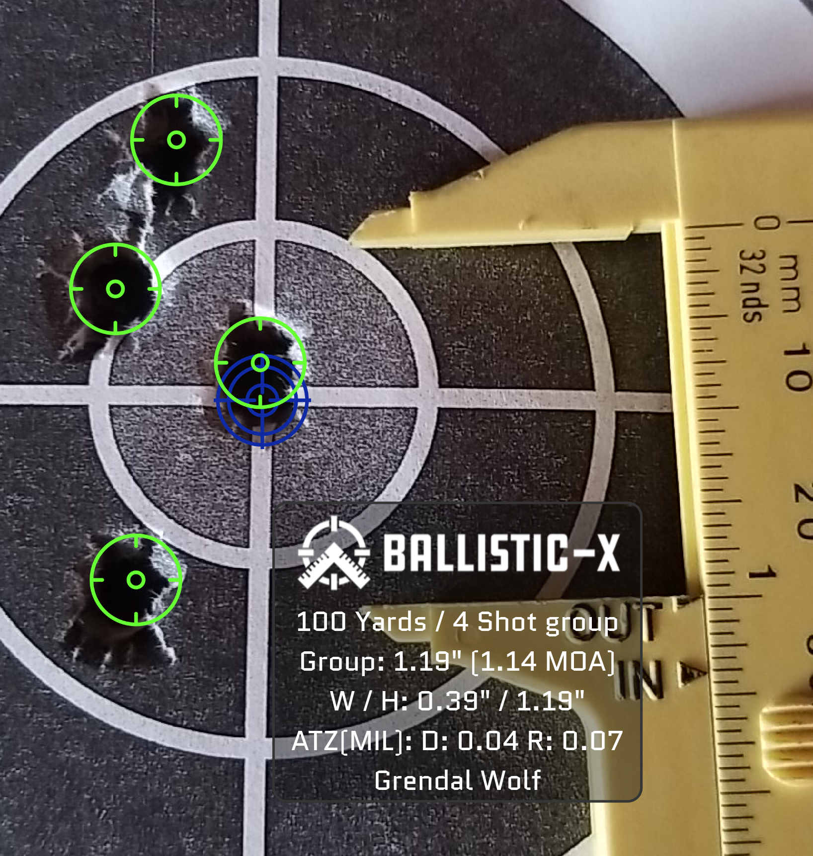

I've posted this before. It is 1000 yard 10 shot group with my factory 6.5 Creedmoor JP-lrp07 shooting Prime factory 130grain norma bullet/brass prone with bipod, rear bag. It was raining so I blame rain in my eyes/on scope glass for pulling the flyer. The real credit goes to the personal instruction of Frank G. (Lowlight) during the 2 day class.
Reactions: RS14

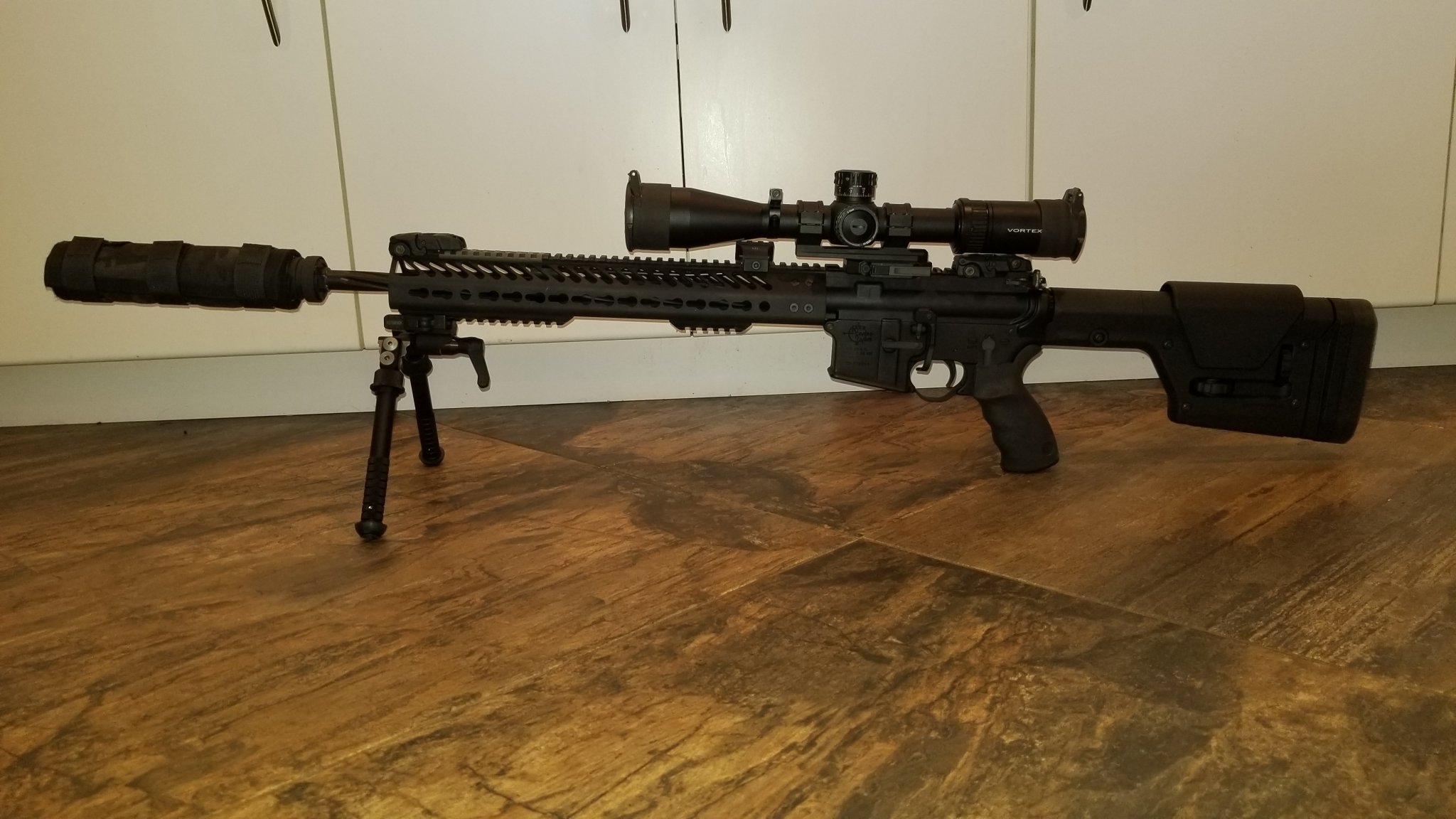

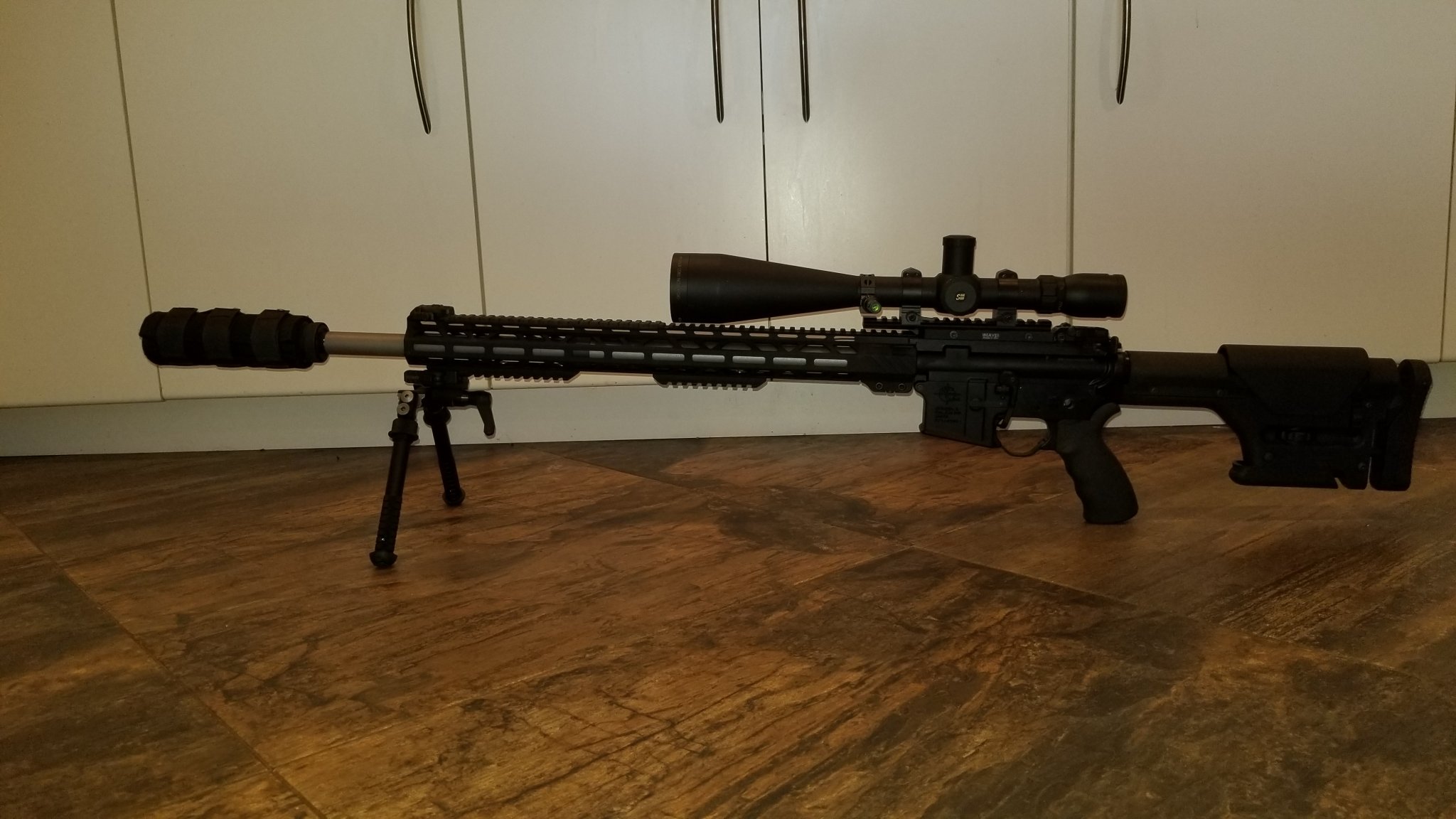

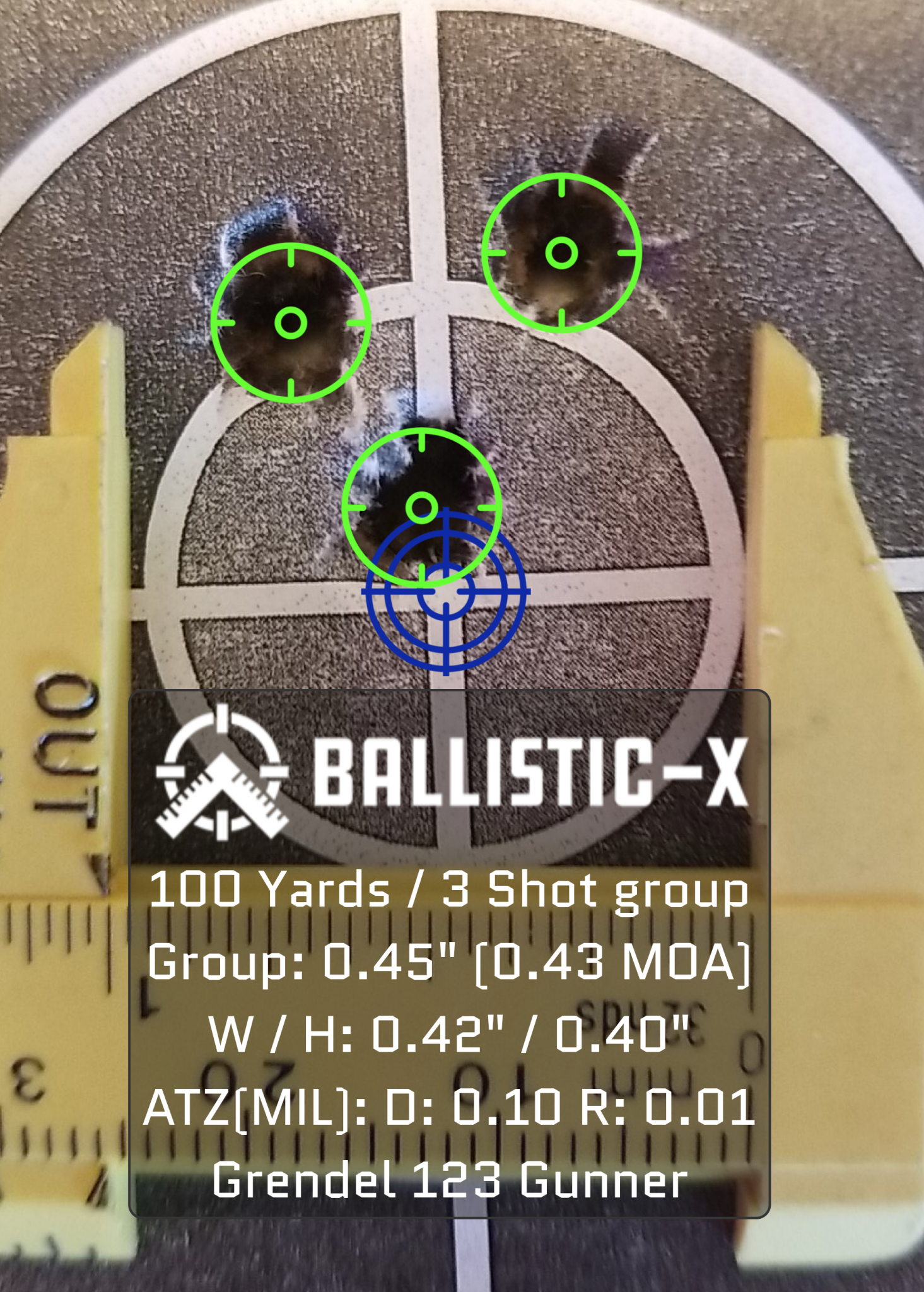

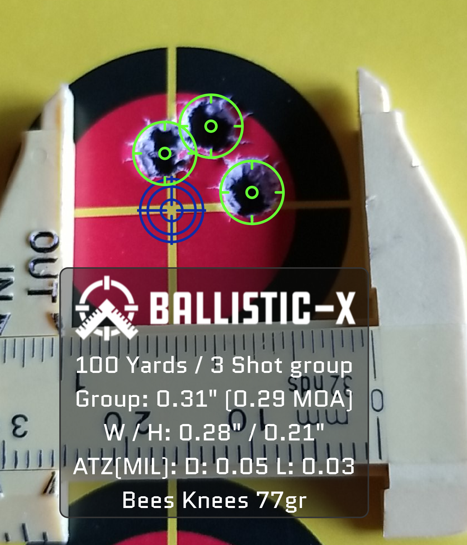

Would you mind posting a breakdown? I’m curious as I haven’t built one.

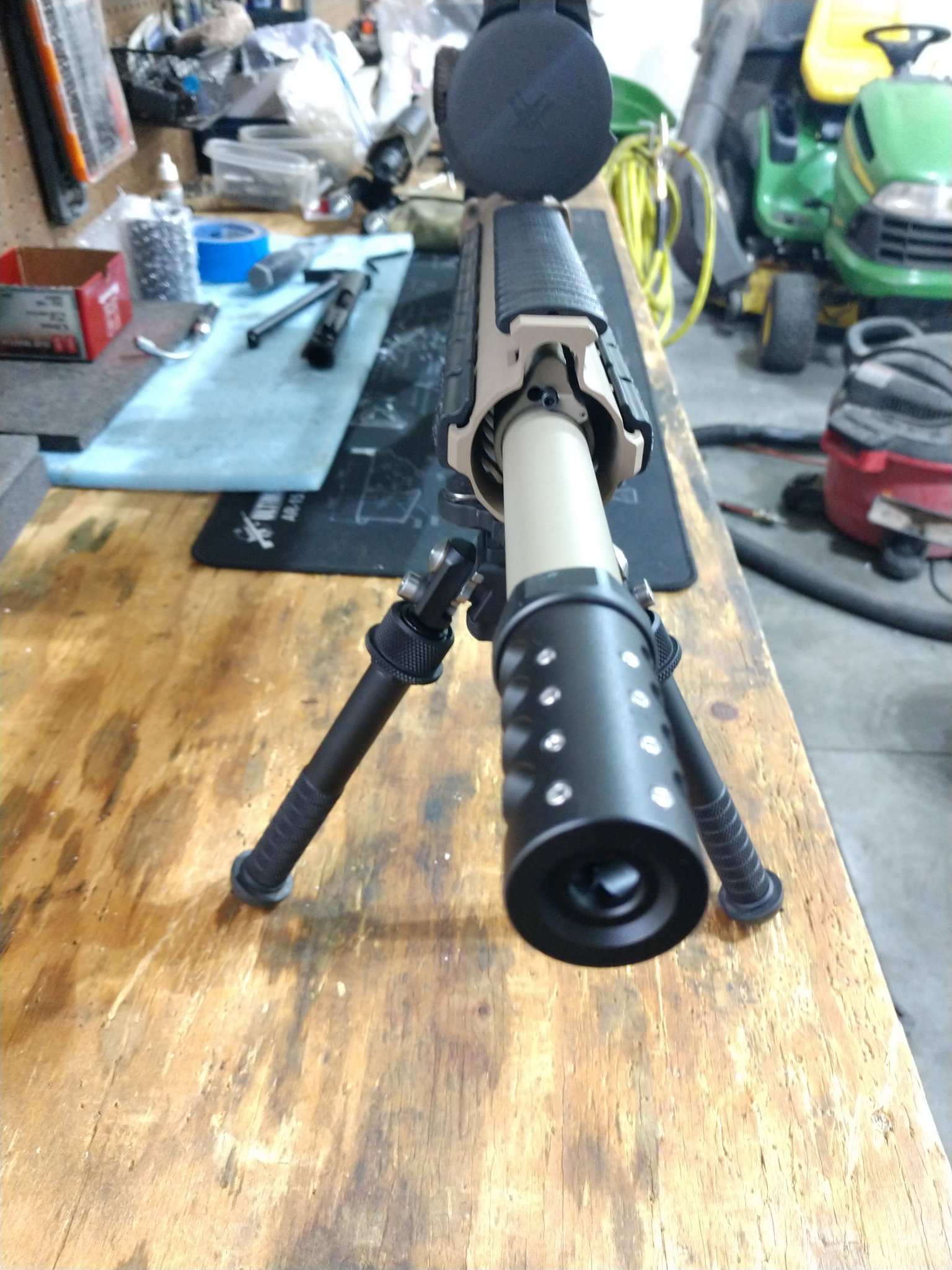

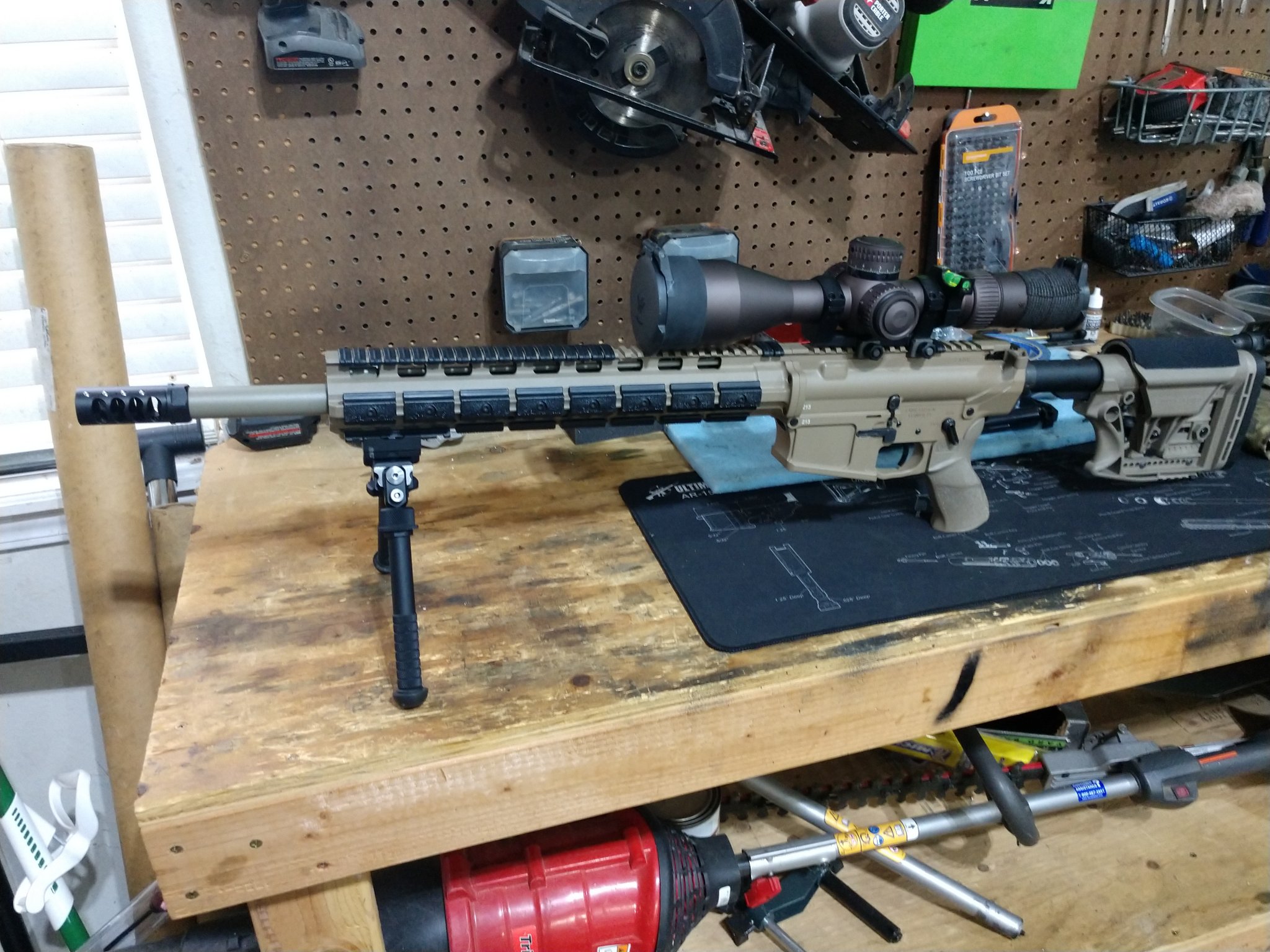

I have a RRA varmint upper (nice Cryo 1:8 Stainless barrel 24"), RRA lower, Magpul PRS stock, JP silent capture spring, Elftman Match trigger Sightron SIII 10-50x60mm target dot scope and Specwar 5.56 suppressor.
This rifle is still breaking in, barrel has about 200 rounds through it.

This one started as RRA ATH upper but it's been stripped, adjustable gas block, new handguards, etc. (nice Cryo 1:8 Stainless barrel 18"), Spikes lower, Magpul URB stock, JP silent capture spring, Elftman 3-Gun trigger, Vortex Viper PST 4-×6x50mm scope and GA RECCE 5 suppressor. Typical groups are .4-.5moa, I only have these pics handy.
  • Ballistic-X-Export-2020-09-13 16:37:34.280130.png

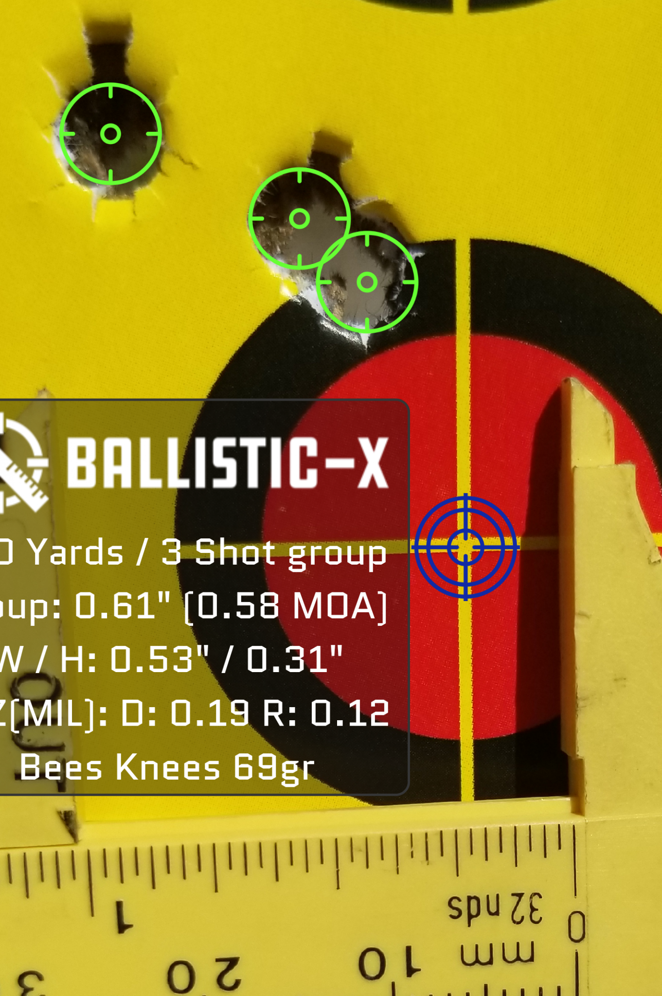

  • Ballistic-X-Export-2020-09-13 16:28:35.204404.png

Built this one on a RRA upper (ARP 4150CMV 1:8.5" 6.5 Grendel barrel 18"), RRA lower, Magpul PRS stock, standard buffer, Geissele SSA-E trigger, Vortex Viper G2, 3-15x44mm scope and Specwar 7.62 suppressor.

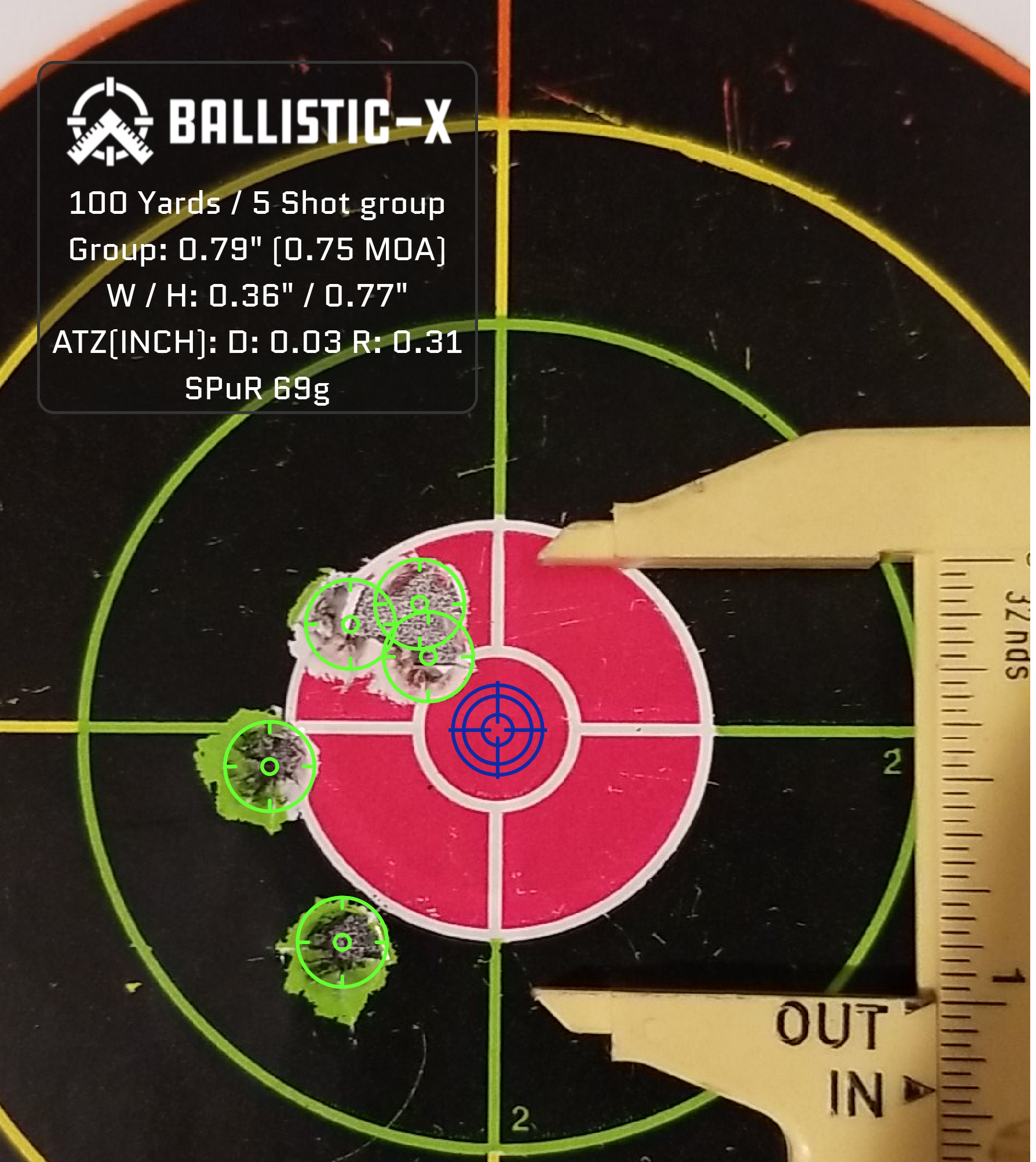

  • Ballistic-X-Export-2021-01-02 11:23:31.219461.png
  • Ballistic-X-Export-2021-01-02 11:20:36.121136.png
  • Ballistic-X-Export-2020-11-14 15:43:57.170383.png

This is out of a compass lake barrel 18" Bartlein 1-7.7 Twist .223 CLE Match Chamber.
I've just started reloading for a .308 Bartlein from Compass lake and it's already shooting 168 and 175 SMK FGMM at SUB 1/2 MOA.
These groups are the first rounds out of the Bartlein barrel while I was doing barrel break in, gas block adjustment and zeroing the scope. Shot at °38 in high winds with FGMM.
