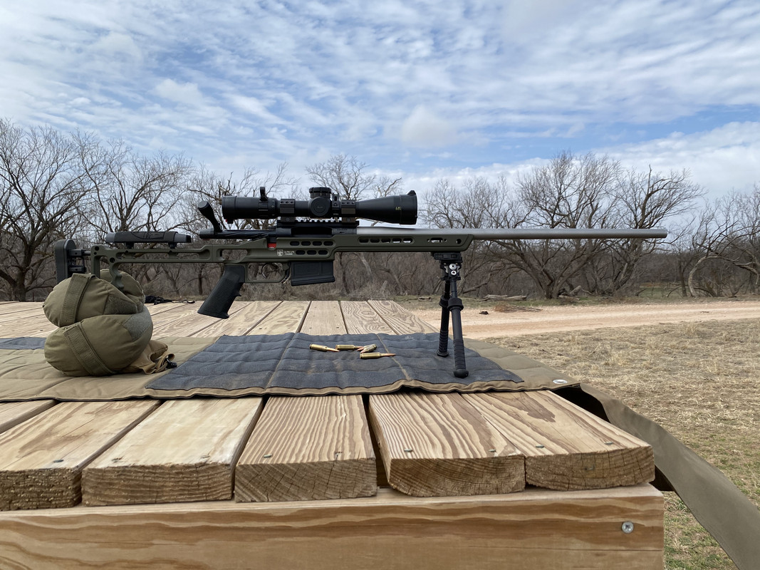

Tried the 145gr Match Burners at 500 yards today. They are showing some promise...
John
Pic above is from 8” twist 6.5 Creedmoor.

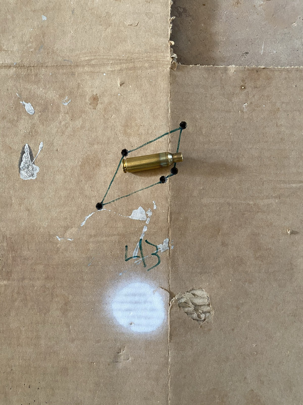

Doing some QC testing the other night at work, shooting a 10 shot group from the 6.5x47. Nine shots went .3 and the 10th opened the group to .4". I used them in the 6.5x47 last week in New Mexico for the NRL Hunter match. The rifle and bullets were hammering the steel. Took a Brux barrel certificate off the prize table. New 6.5x47 barrel in my future.

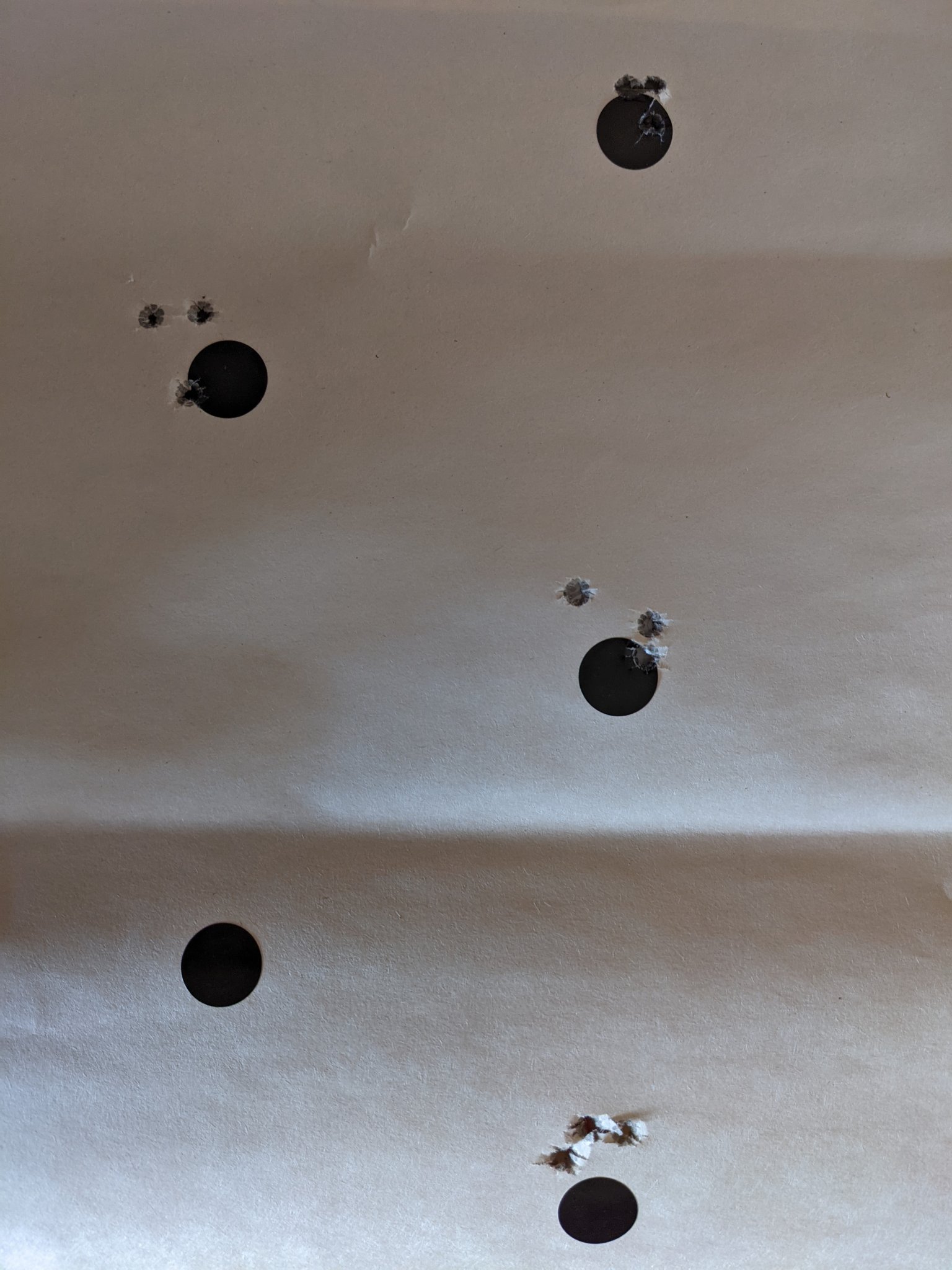

I shot a few this past weekend, fireforming new brass, unfortunately 2 of the groups in wind and rain.
6.5 max, 62-65 grains 8133, 3.07 coal @ 200 yards. Top right was 62 grains.
