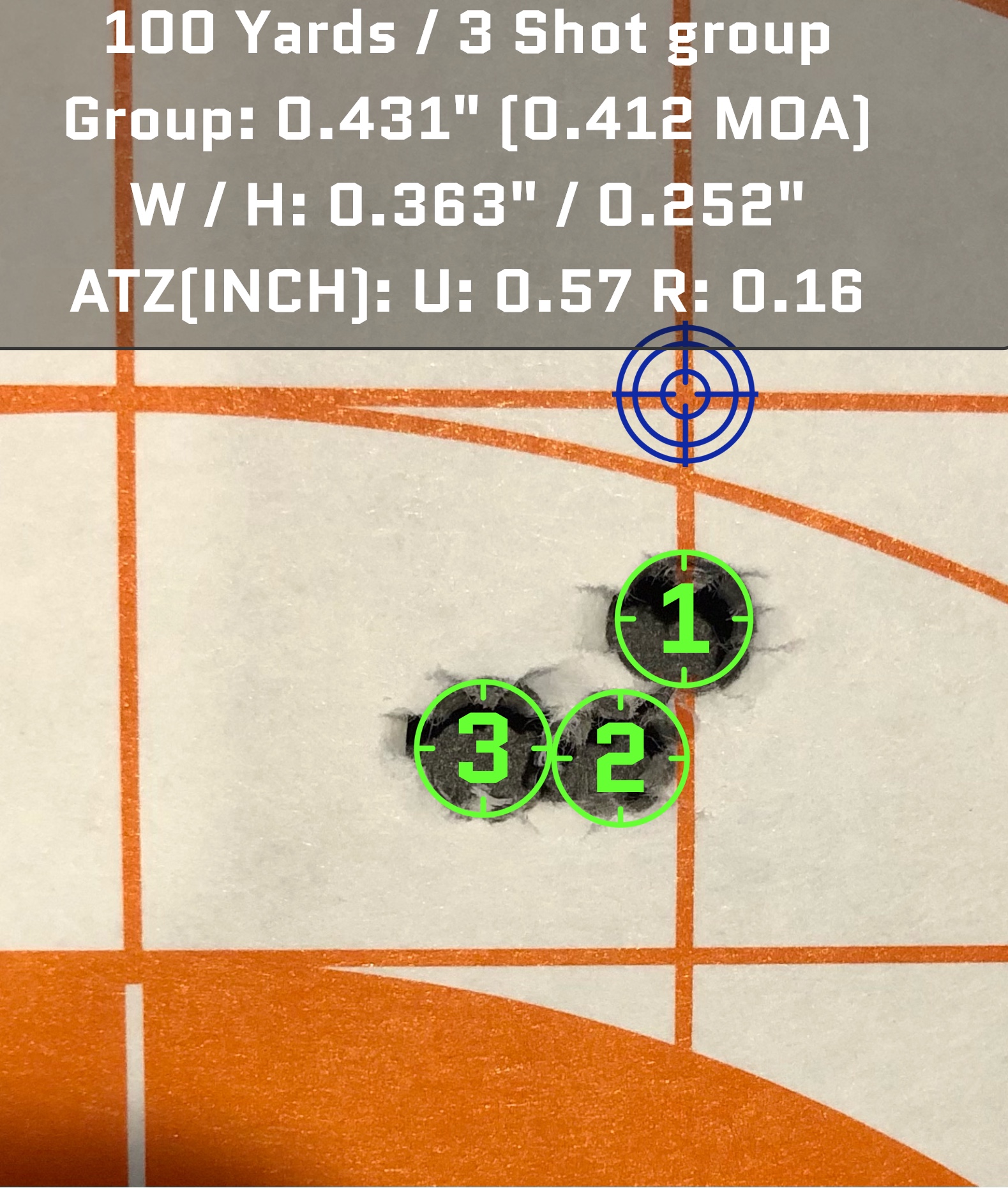

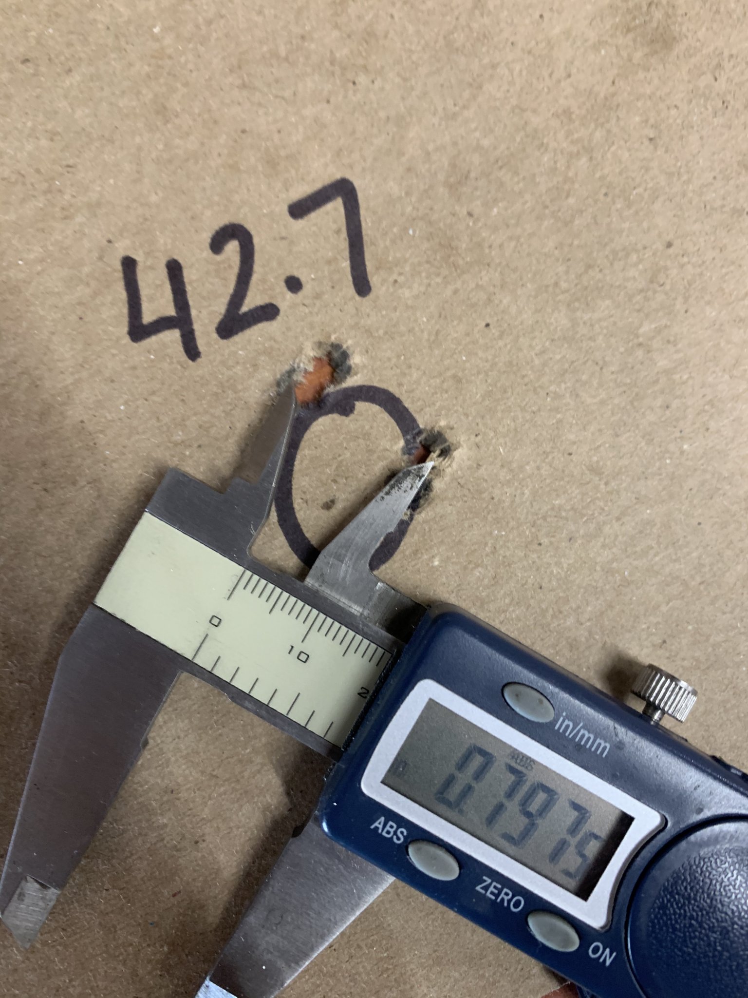

Had some success today with the 145 match burners in my 6.5 creedmoor. Looks like 42.7 grains will be a good place to start messing with seating depth.
load data
Prime once fired brass
145 matchburner seated at 2.950
42.7 grain of h4350
Cci200 primer
Velocity was 2730 with a sd of 4 and Es of 10.
This was shot of out my Seekins havak bravo at 100 yards.

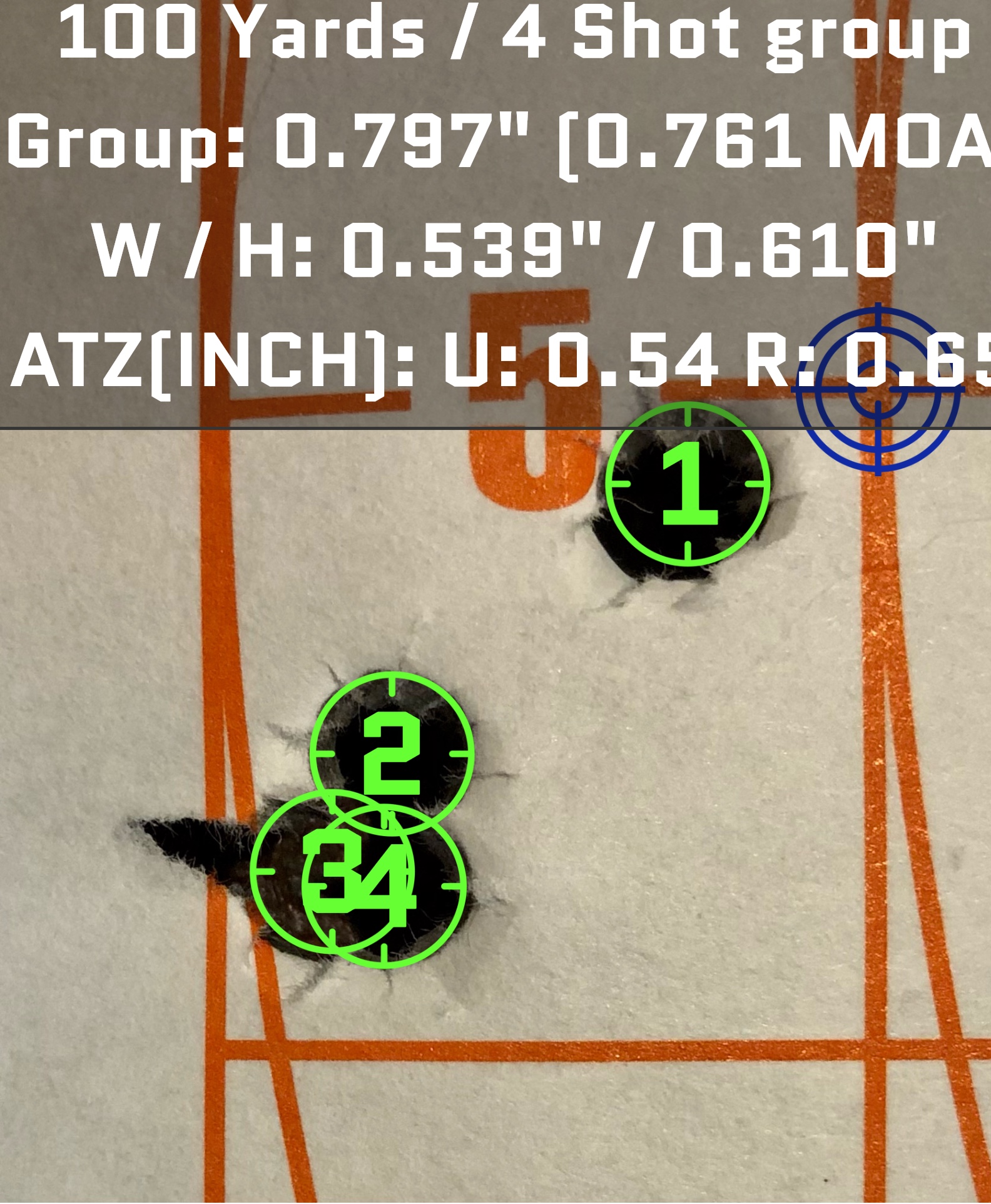

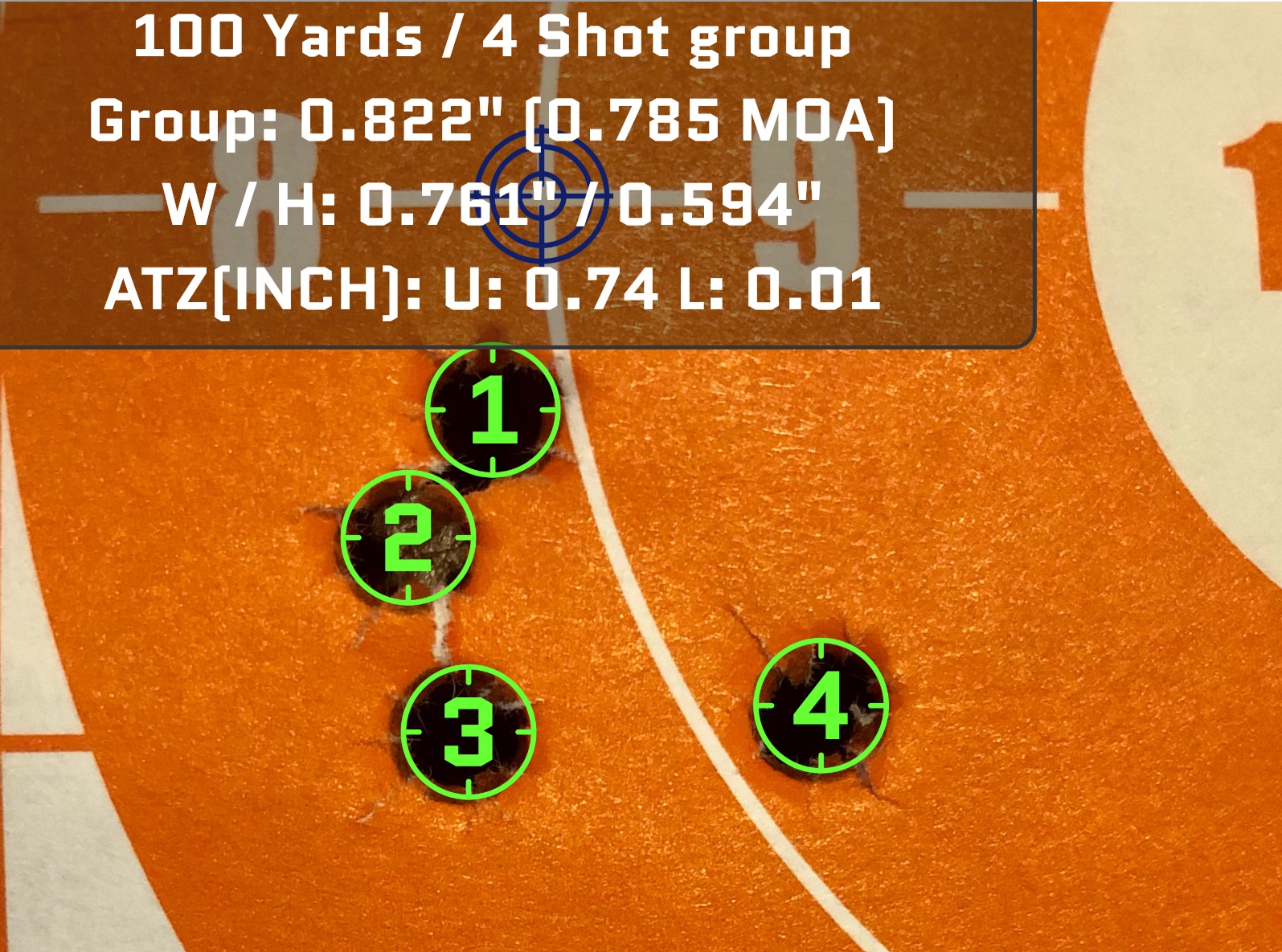

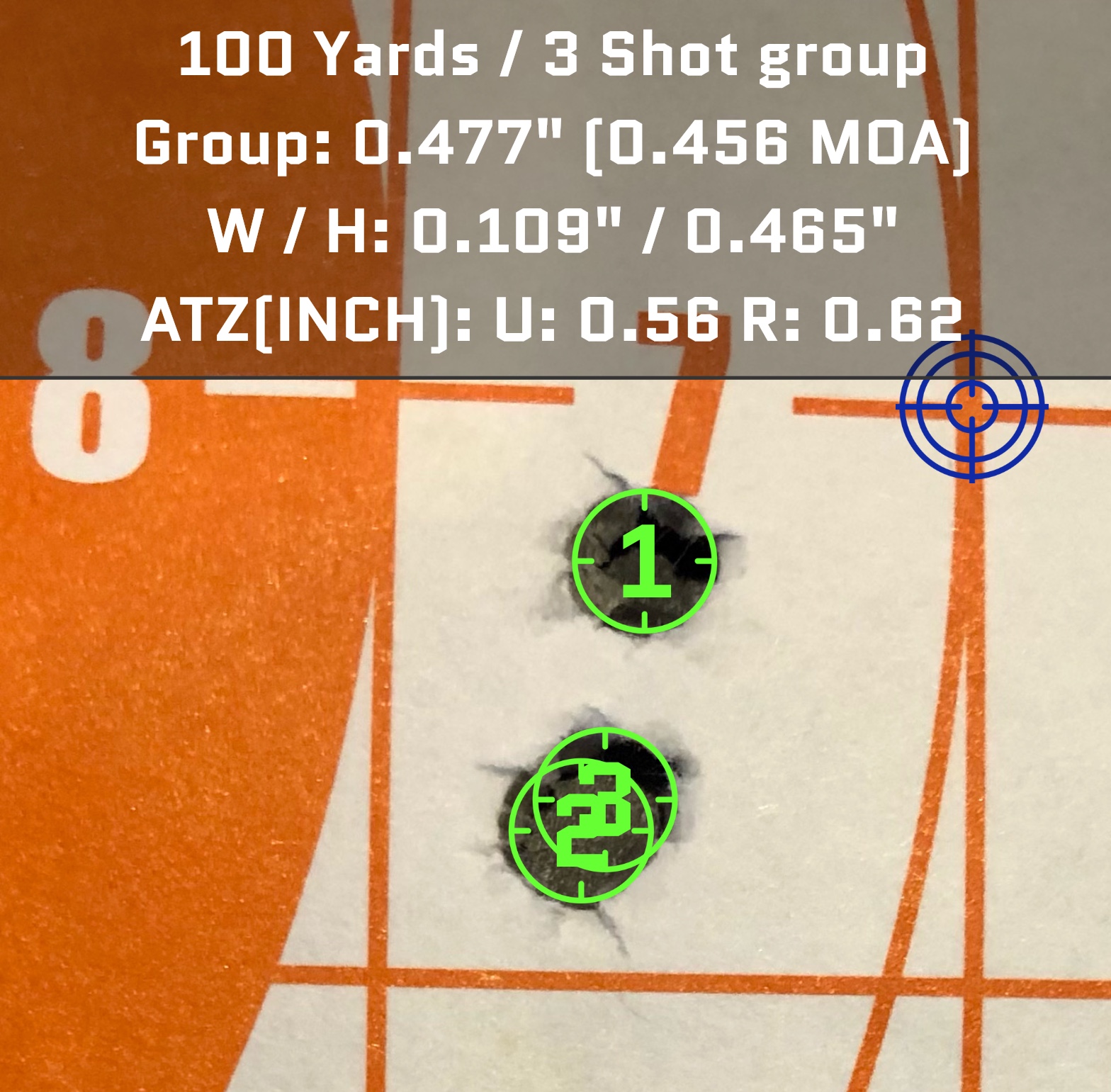

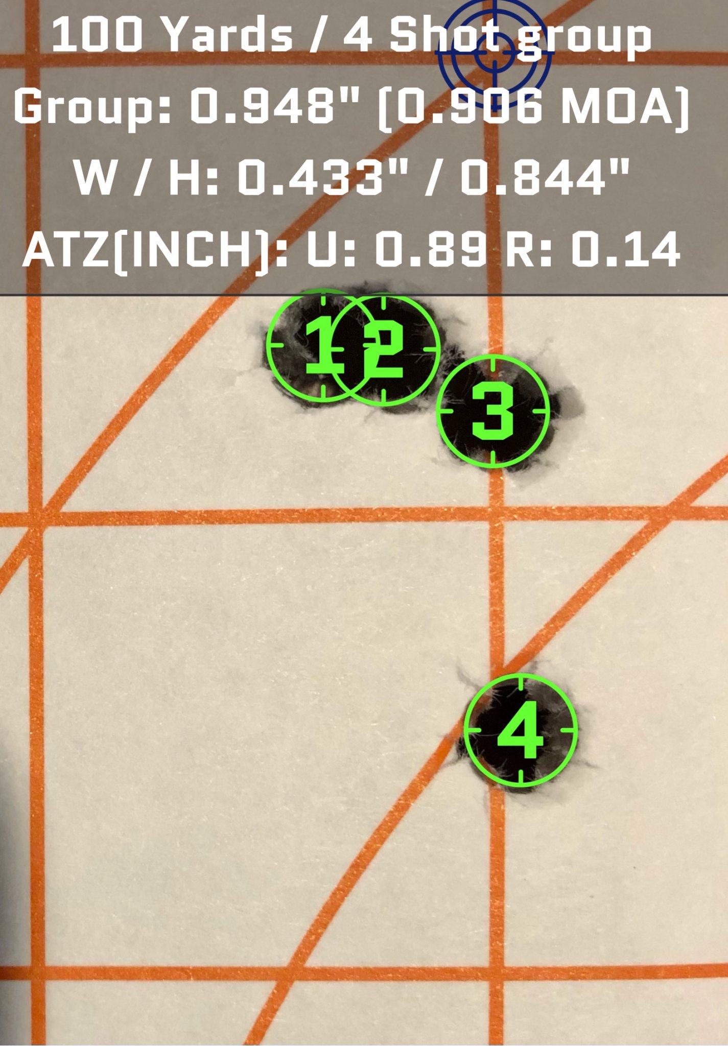

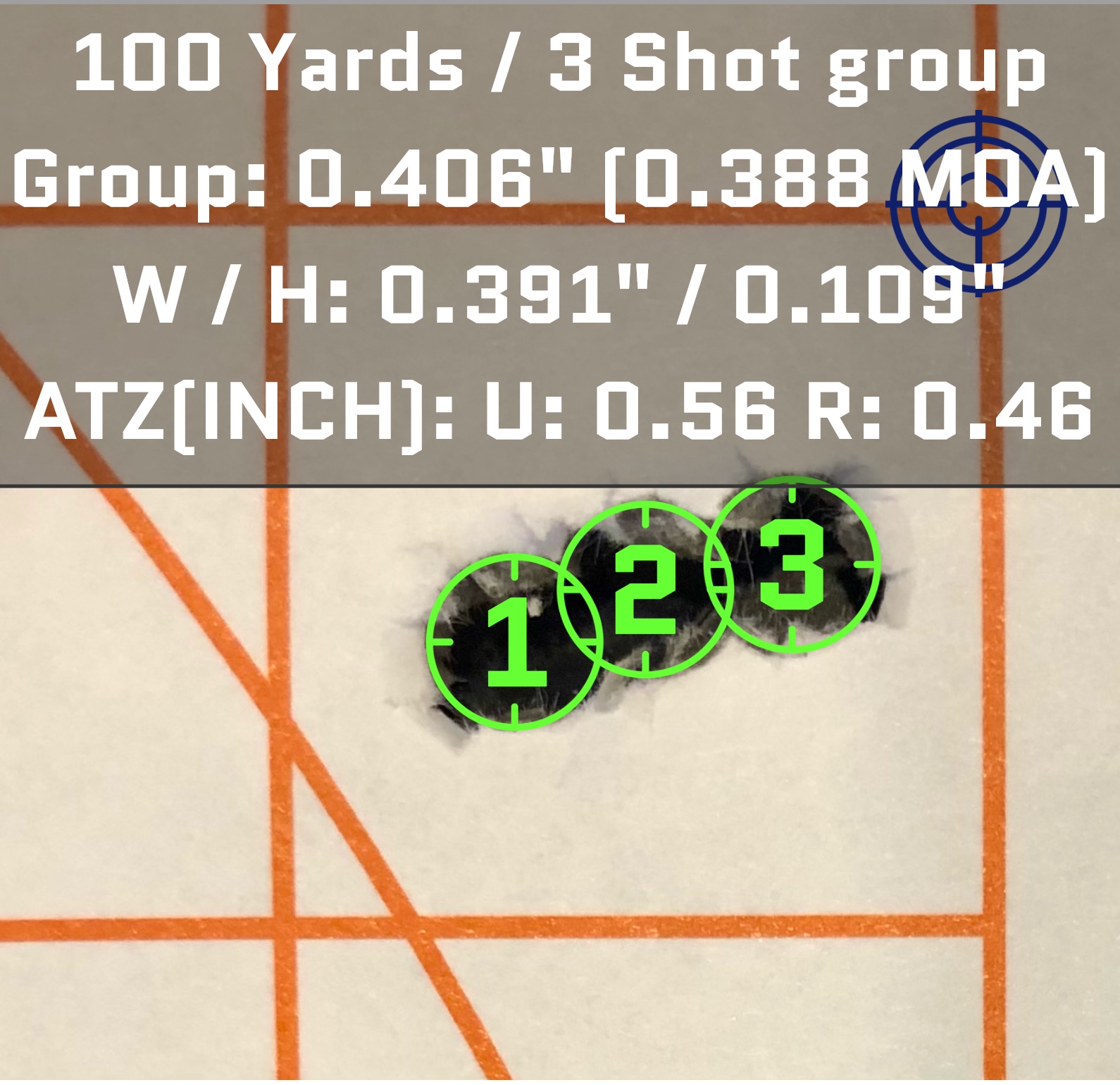

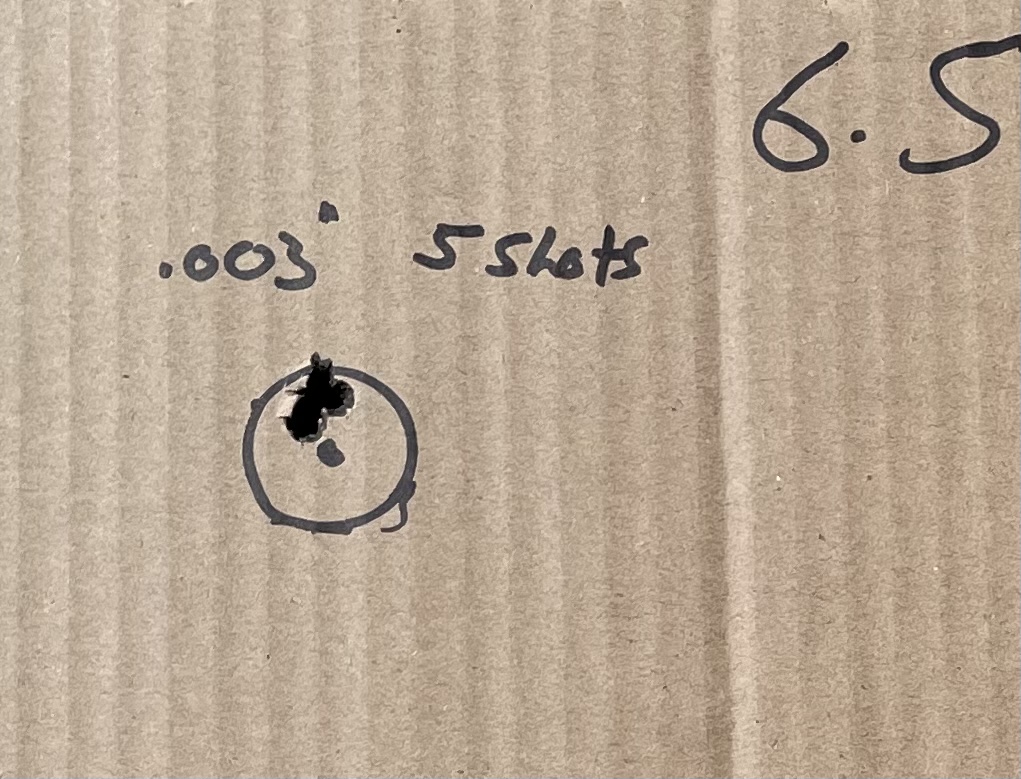

Got a semi finished 145 MB load that shot well enough. Posted some pics in the 6.5 Creedmoor thread. Group size varied mostly from 0.4” to 0.75”, but most were around 0.5”. Good enough.
Many four and five shot groups would have 3 or 4 touching and another one or two would impact 0.5” away. Had some bipod issues, so might not be the load. Might still be able to improve the load with additional tweaking.
I know from experience that this rifle will shoot 135 Atips and 140/144 Berger Hybrids into 0.2-0.35” groups, but cannot find these bullets anywhere - except on Gunbroker, where they go up for auction, and often fetch around 85 cents per bullet.
Groups ordered from ‘good’ to not-so-great:

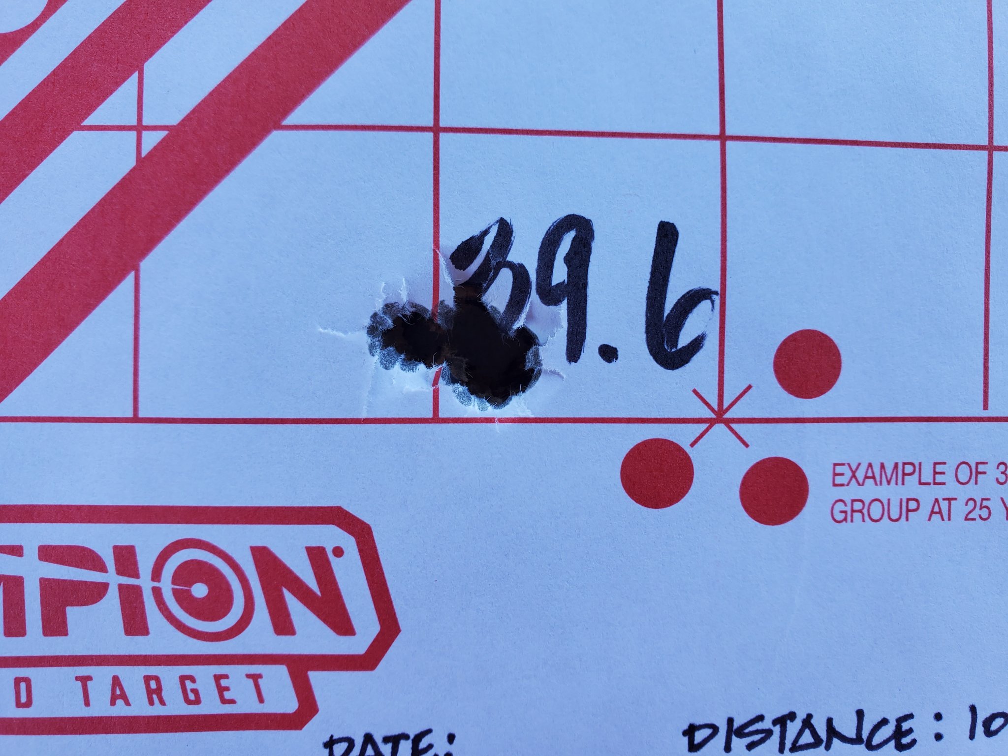

I loaded some test rounds, 46gr rl26 in lapua brass, br2 primers, seated 8k, 28k,48k, 68k, 88k, and 108k off lands. Speeds close lands was 2910, way off lands 2880, accuracy was near half moa @ 200y from 8k to 68k off lands, the 88 and 108k were moa. I have since loaded 57.7-60.3gr in 0.1gr steps at 28k off lands as it was the tightest group just under half moa and was in the middle of vertical impact nodes. This is in a 26" barrel Christensen MPR. I have to get my feed ramp cut for the longer rounds(2.93 coal). It was designed for using a short pmag.
Sounds like you are getting close to a final load. I got pretty good results with a 0.020” jump, and group size was quite similar to yours, 0.4 to 0.6”.

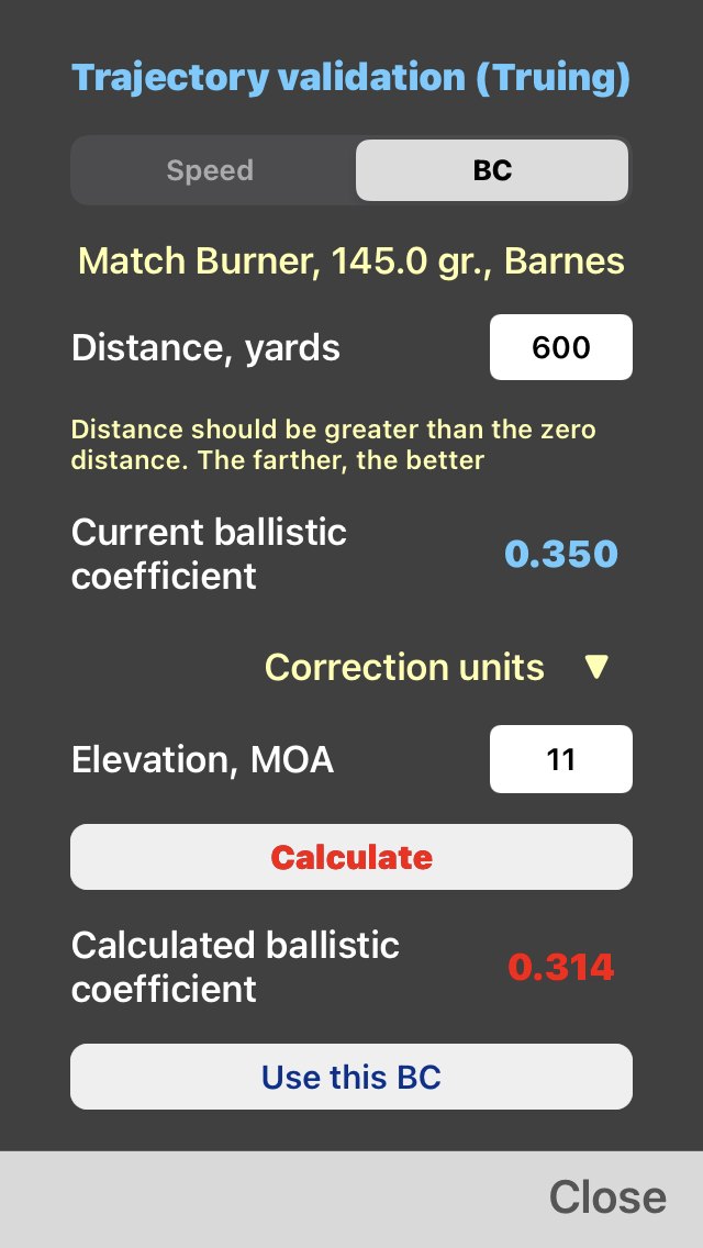

Also interested in what G7 BC you guys get from truing based on drop data at 400 yards plus. I did a quick check some time ago at 600, but my zero was off, need to redo it. I must have bumped the scope.
OK, after posting this question, decided to rush and load up 20 rounds, and drive over to the range, which is only 15 minutes away. Had the zero rechecked on Friday, it shot 0.7” below my zero stop. At 600 yards (might be off by 5 yards), i needed between 11.0 and 11.25 MOA of elevation, after correcting for the 3 clicks of zero offset. Have not done a tall target test for this scope yet, so that might contribute another 2% error. Moderate mirage is another possible source of error. Berm behind the target is at least 60 feet tall, and with the 6-14 mph wind blowing almost straight towards the berm, it will lift the bullet an inch or so.
So with all those disclaimers in place: Strelok Pro gave this result for the G7 BC:
True G7 BC result may be somewhere between 0.30 and 0.33. Not claiming my estimate is perfect, but at least some indication.
