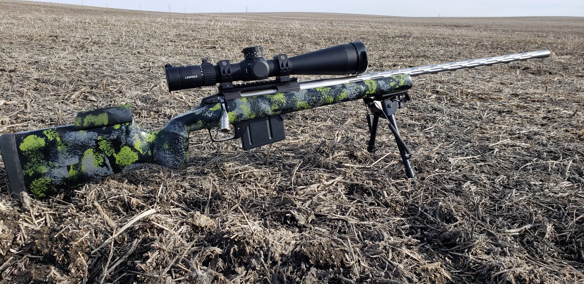

My bullets finally showed up today. It was windy as hell today so I just loaded up some rounds to check velocity and pressure. I'm running adg brass, rl26 210 primers with a 27" 7.5 twist K&P barrel.
Appears there is a few nodes to chase.

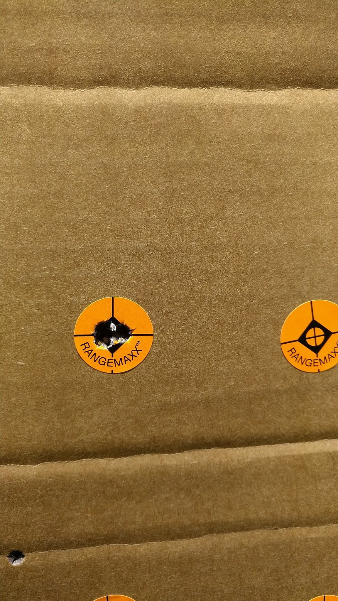

6.5 SAUM 145gr MB and H1000 at 100yds. Shot some a 5 shot that was .5" then corrected to zero the rifle and shot this 3 round on a 1" target. Only shot to 550yds but the .350 g7 was good to go.

Nice shooting how far off the land did you end up? I never did get much time with them but nothing under .4" I was using RL26
