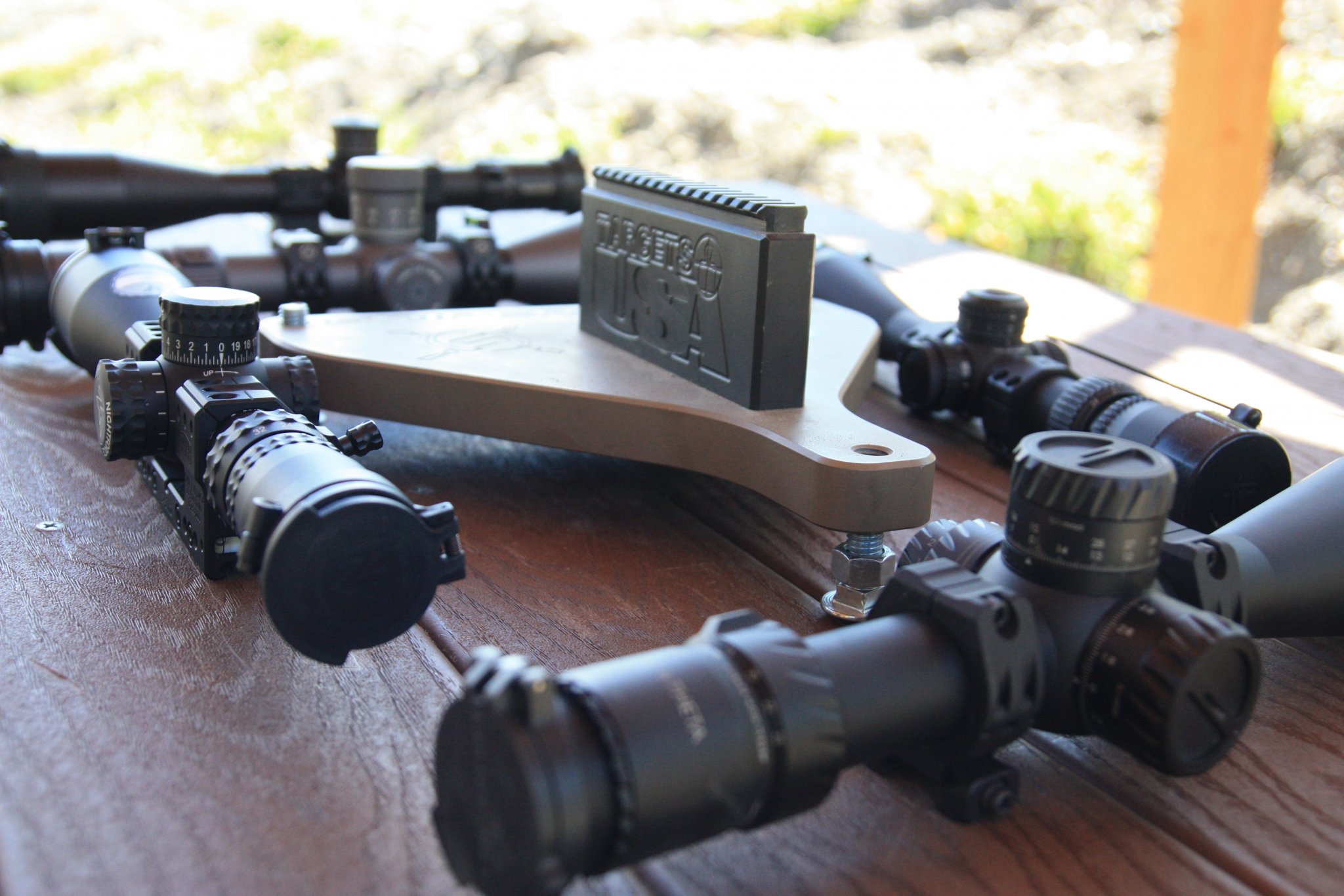

    As many shooters have read in the Sniper’s Hide Forum, or have heard on the Everyday Sniper Podcast, during our precision rifle classes we removed and test scopes for tracking. The genesis behind this was twofold, first, we used to only accomplish this in our PR 2 class, and second, it solves a rifle set up the problem we often observe. Today we do it in all our basic Marc & Frank PR Classes.
    When we dope a rifle at distance the data needed to hit the target is that value. In other words, if you dial 8.5 Mils to hit a target, that is all you need, unless the environmental conditions changed enough. Under these same conditions, 8.5 is my answer. If you are looking to predict a solution in software, you want to give the software all the variables that may influence the accuracy of the prediction. So, if your scope tracks at 98% of actual, you want to tell the software to correct for the variation. Instead of reading .1 Mils it would be .098. That is why we tall target test, it is one of the variables. This also gives you a baseline for that particular optic. If something is amiss down the road, you now have a model to use where you repeat it and attempt to identify the problem.

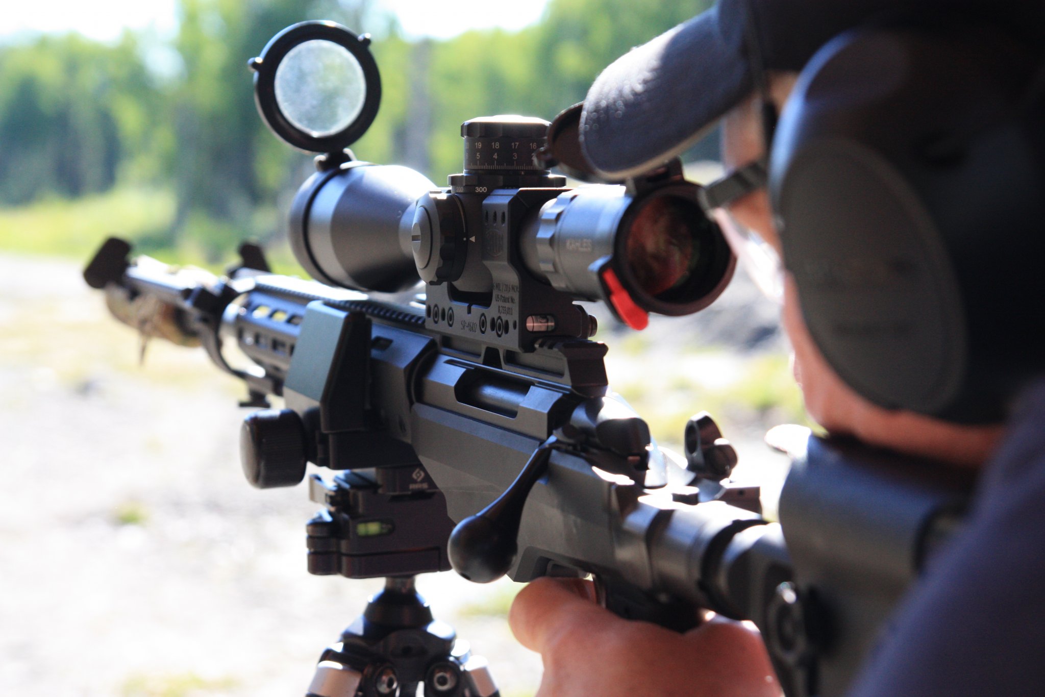

    The more we started to remove scopes from students' rifles the more variations we began to see. These included scopes that were improperly mounted in the rings and levels that were not in the correct agreement with the reticle. Since the Target is level, as is the fixture, we can test both tracking and look at the plumb of the reticle. To relate this to those reading this, we see about 1/3 of scopes in a 12 -16 Person Class is not level and about another 3rd which are not correctly aligned to the bubble level or the level has been knocked off.
    Pulling a scope gives us more than one training opportunity during basic class. We can point out the issues above, also we can demonstrate parallax using their optic and after testing is completed, we can help with the rifle set up. The line goes from Marc testing all the Optics to Me assisting the student with set up, mounting, and initial re-zeroing. Each step is controlled, each task is done by the same people. If we do see an error, we put several eyes on it and come to an agreement as to what we are looking at. Many of these variations are minor, top, or bottom of the reference or minor gaps between the reticle and target.

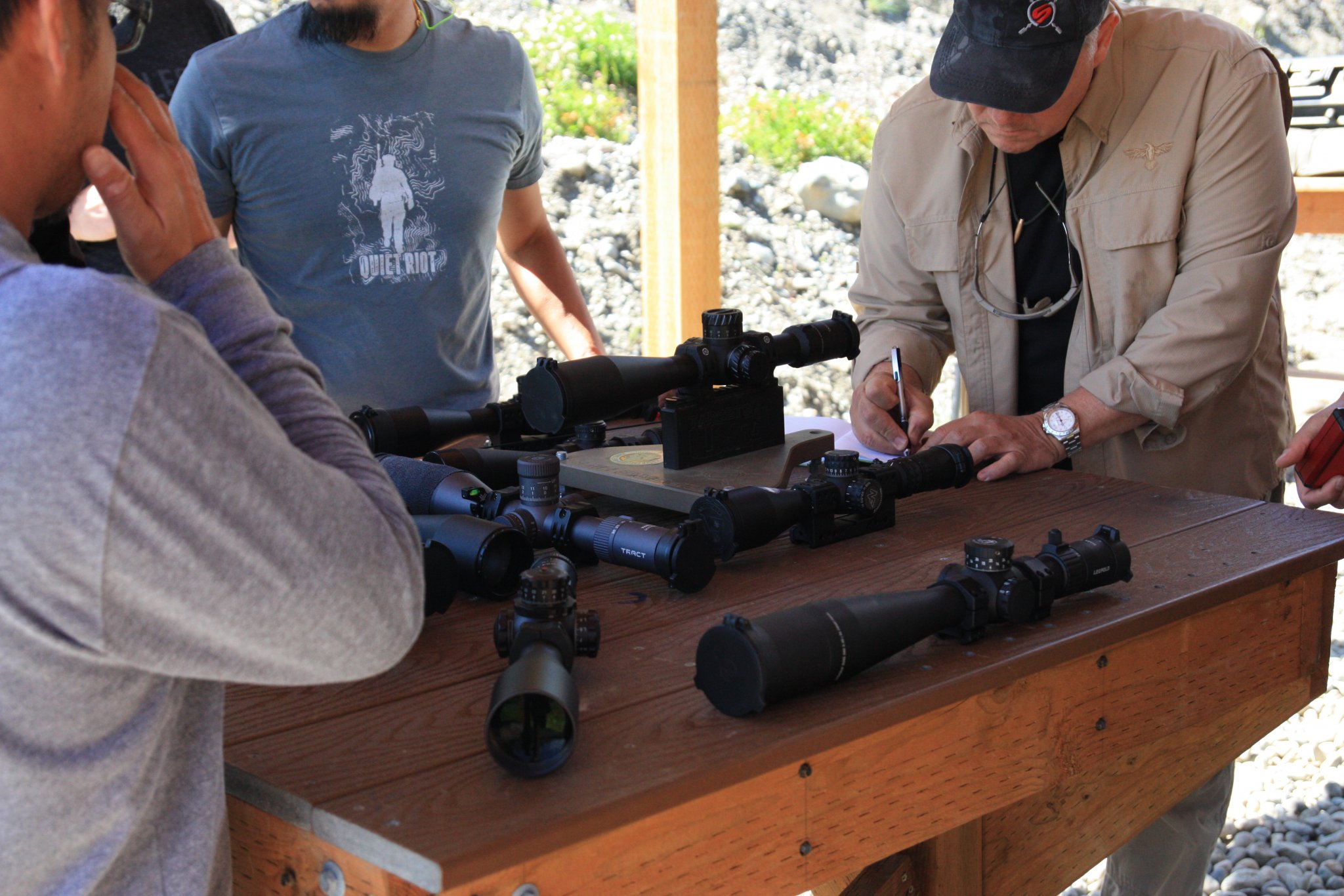

    We conduct our Test at 100 yards, mainly because that is universal for the ranges we use. But also, because we are shooting alongside the testing, so setting everything up at 100 is easy. With most of the modern scopes we use, seeing is not an issue, but it can be.
    We do not choose the scopes that are tested.
    Any scope on the list was a student’s scope. There are a few I brought to class with me as part of a review, so it might be included, but all scopes were brought to the course by a student.
    All testing is done with the students as a learning exercise, and If any variation is noted it is double-checked by more than one person.
    Our biggest point of variation is atmosphere and parallax. This is the reason we have the same person to check the scopes. Same pair of eyes every time with multiple layers of back up. Seeing the chart is not a big deal and early on, we had someone downrange to confirm on the ruler up close what the tester was seeing back at the line. Today we have a better easier to read chart and as noted we always triple check a variation.
    • 100-yard tracking of the Shooter Personal Optic giving us a baseline.
    • Identifying Variations that can be used to correct Ballistic Software
    • Reticle Plumb as well as adjusting external Levels to the Reticle.
    • Parallax Demonstration

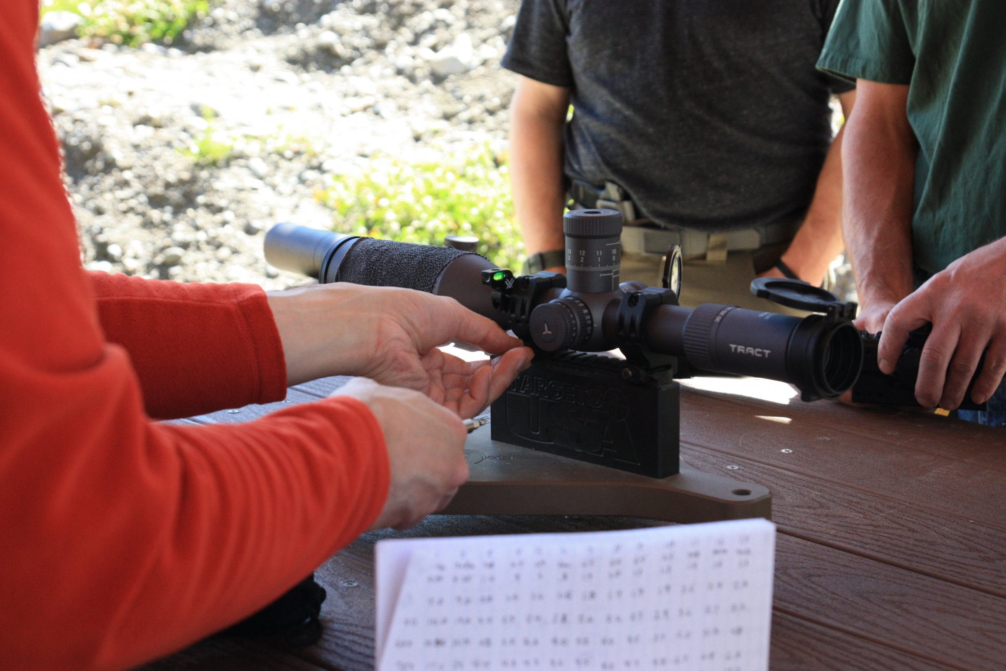

    We see this test as a field method and consider 2% of 100% to within spec. If we are dialing 10 Mils of elevation, or 36 MOA, being .2 Mils off or .75MOA is an acceptable amount of variation for us. It’s less than 1 MOA at 10 Mils or 36MOA. Today that puts most shooters beyond 1000 yards.

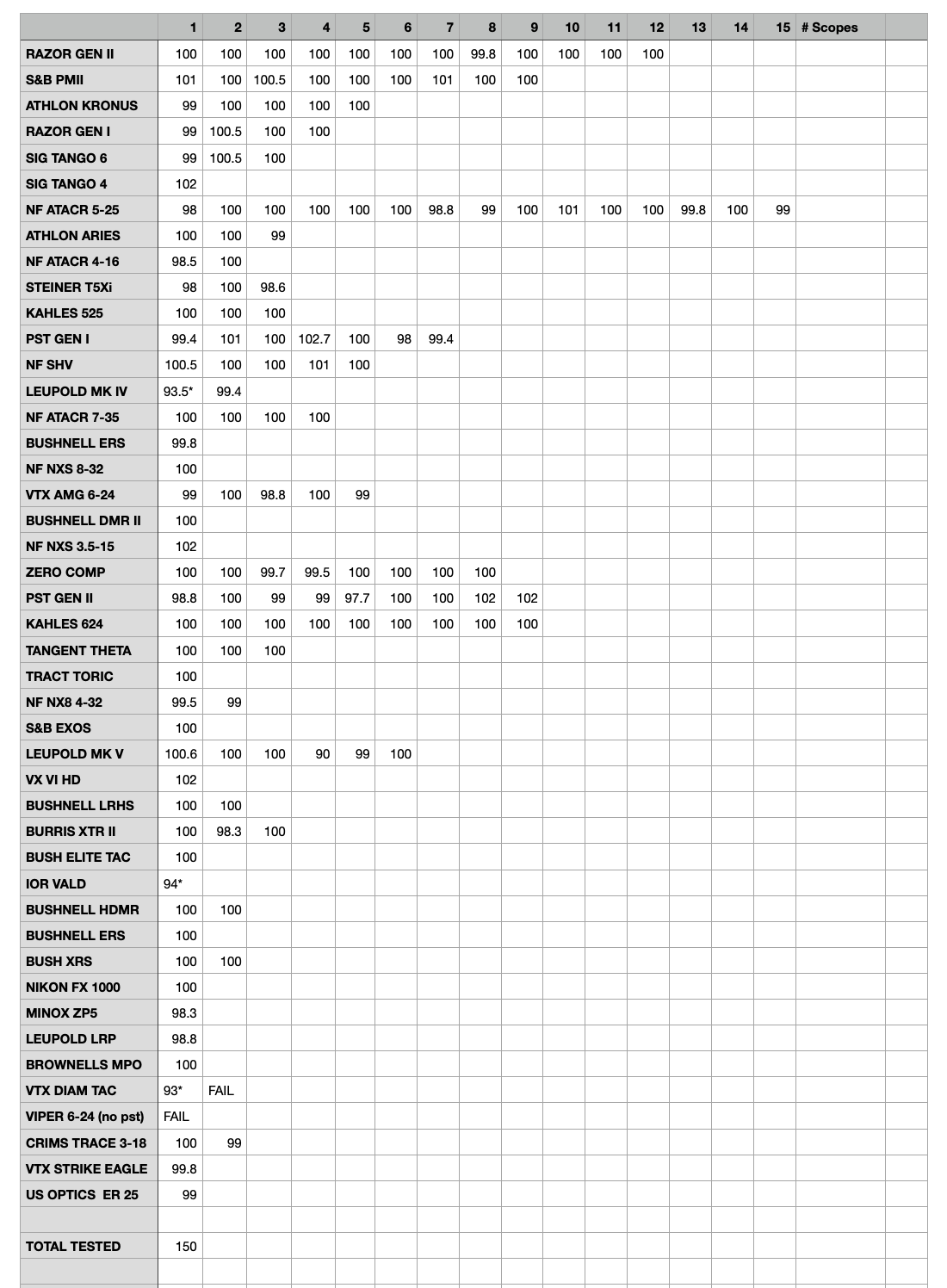

    How to read the Chart
    Percentage of 100
    The chart is rewritten in a percentage of 100. A scope that tracked 99% moved the reticle 9.9 Mils when the optic was dialed to 10 Mils. A scope that tracks 101% moved the reticle 10.1 Mils when 10 Mils was dialed on. Scopes can vary in both directions.
    Fail
    If the scope failed, and you see “FAIL” it never made it to the line. The scope was replaced with a spare that we carry. If you see an Asterisk the scope failed but was not replaced on the line.
    It’s not really a pass or fails exercise unless there is a problem with the optic. If the scope was listed as FAIL, it did not complete the test or track well enough to get a measurement. As an example, we had a scope marked as fail where you dialed 48 MOA on the turret and the reticle moved 29 MOA. That was considered a FAIL and replaced on the line.
    The purpose is to give you a baseline and establish the value for your ballistic software. If we identify a bigger problem, we are saving time as normally the scope is replaced and sent back. We have had very positive customer service results with all the optics that needed service.
    We have been testing scopes for several years, however, we have only been recording the data in our God Book for the last few. That is why the sample set is 150 scopes vs a higher number.

    Because of the math, the number might read to the second decimal place, but our scopes cannot adjust down that far. If the error was less than 1%, odds are the math worked out that way and it was a case of the reticle showing air around the line. Resolving the line that far at 100 can be an issue. So, take those numbers for what they are, the thickness of the reticles we are using, and minor inconsequential numbers. A .03 error is a blink of the eye, it’s a rounding error that should be taken into the context of the scopes ability to dial or hit a target which might be 2 MOA inside.

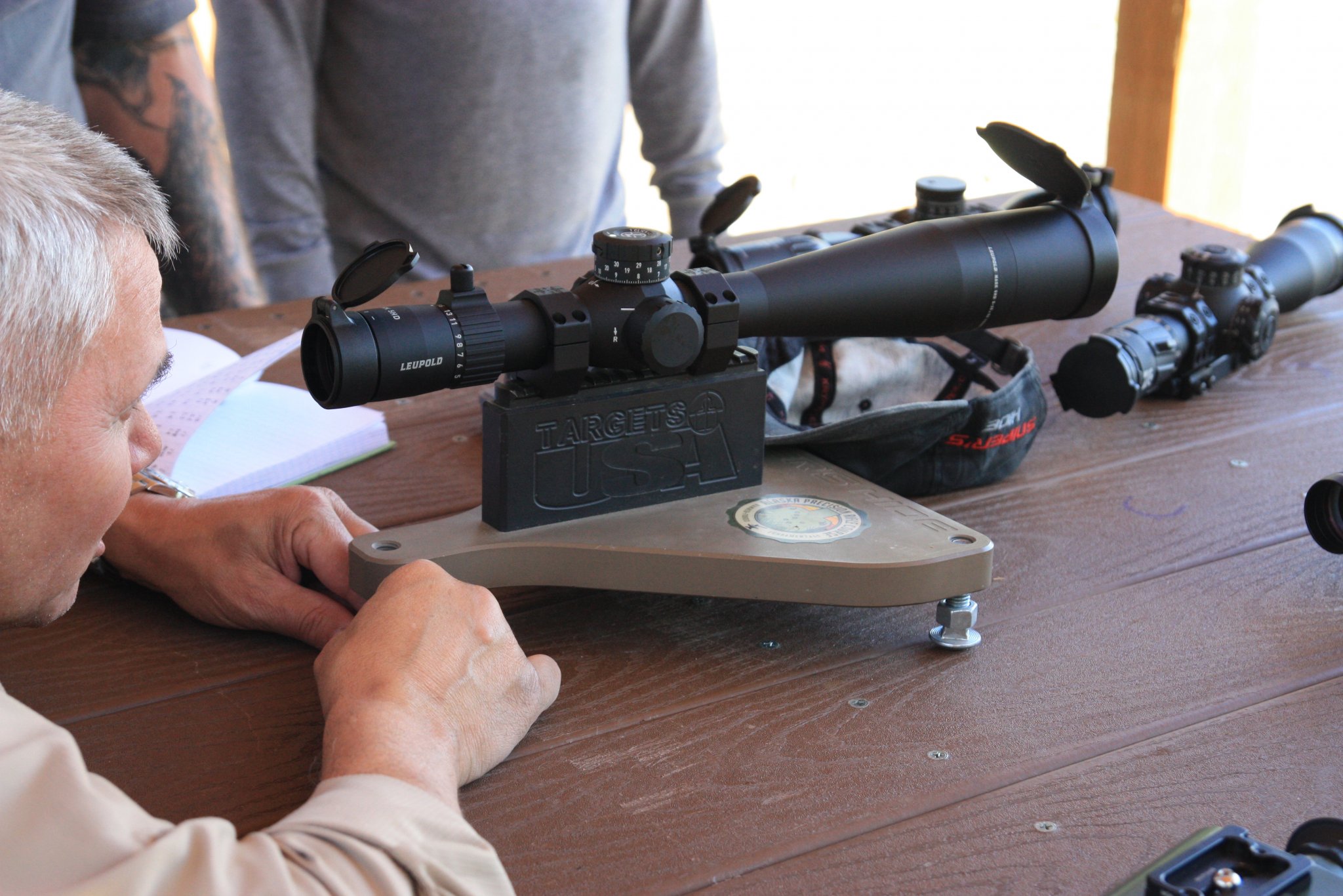

    Using 50 Meters to test then doubling the results may give us a little finer detail to really nail the reticle and ruler relationship. If one was creating a test chart a different color test target might aid in following the black scope reticles. Black on black can create the variation of .00 offsets we see with several optics.
    Measuring to .1 or less is not easy in the field. You want the fixture to be as secure as possible. We use a 30LBS and the bench needs several people to move it because it is made of composite materials. You can’t let anyone touch the bench or fixture during the test or it will influence the reticle’s location on the target. The process has been refined over the years.
    Scope companies have specialized tools and collimators to do this type of testing. How and where you conduct the test can have a noticeable impact on the results. We have set up and identified issues by finding the scopes all appear to be tracking wrong. We had a laser rangefinder that was 3ft off once, gave the scopes a tracking result of 103%. We stopped and completely reset the test; it was obvious when it happened. You would not expect at $4000 laser to be a yard off, but we found it.

    If my math is right, 2% error would be 2 tenths of a mil (.2 mil) if you dial in 10mils.
    Unless shooting .308 or taking 6mm past 1100 or so, most wont be dialing much more than 9-10mil.
    Just to give some perspective if anyone is scratching their heads wonder what is good and what is bad.

    I think generally speaking up to a 2% error is acceptable. Some of these companies have some huge marketing potential by saying their scopes track over 100%!!!
    The tracking error can be accounted for but I would assume if you add a tracking error but your reticle is 100% then you'd have a discrepancy between using the turrets for adjustment vs. holding over.

    Very Helpful... on the Leupold M5 with the fail does that mean it was not dialing at all or not repeatable enough to test?
    Also interesting on the cheaper Vortex.... they were still pretty much within the 2% error- but some of them had the 2% low and others 2% high- so really a 4% error in the scope?
    Nice. Kahles and the GenII razor with TT and S&B are kicking ass. Given that NF looks to be tested more, are doing great.

    They were listed in the order we saw them, some classes have more than one scopes, which you see repeats,
    If the scope was just listed as Fail it was well below 10% the M5 was around 50% that was listed as fail, that is the story above it was an M5, they replaced it.

    I am wondering what happened with Leupold Mark V HD 100.6-100-100-Fail-99-100 ??
    It looks strange. For more than 2y I am supporting Leupold LE/Military distributor in Poland and I have tested and prepared for the showcase a dozen Leupold MK V scopes with different configurations /reticles (3.6-18x44, 5-25x56) for most of them I have tested turret truing using Horus Vision CATS /horus 0280f calibration target and don't have any issue at all.
    I was in the class that had the failed M5. The reticle would just stop moving part way through the adjustments. It was bad enough that Mark called Frank over to make sure it wasn't just him.

    The FAIL we had was a brand new scope. Student still had the box with him. We mounted the scope and as I turned the turret, the reticle stopped at 29 MOA when I was trying to reach 34.5 on the dial. I ran it back to the top multiple times and multiple observers saw the same before we FAILED it.
    Student went on with a borrowed scope and shot very well. -- Taylor

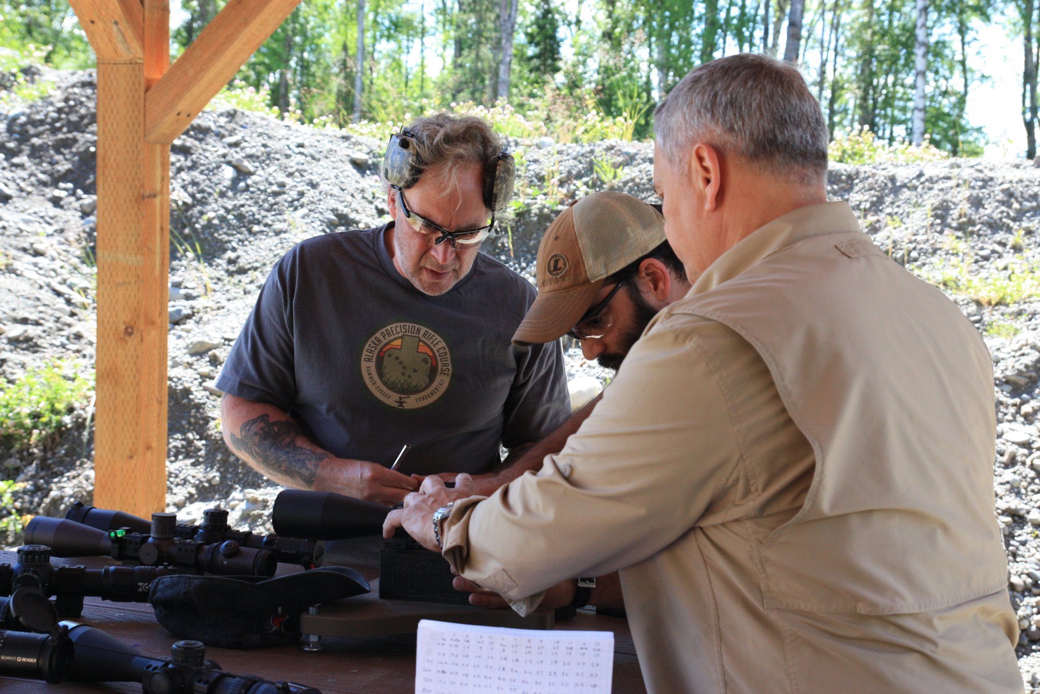

    There's only so far I can go with the details with 14 guys lined up behind me waiting to be tested. We've got to get through this smoothly. I just ask the student what model it is, write it down and move on.
    This is all done very subjectively. The student mounts the scope and I track it. Multiple times with the same outcome before I write it down.
