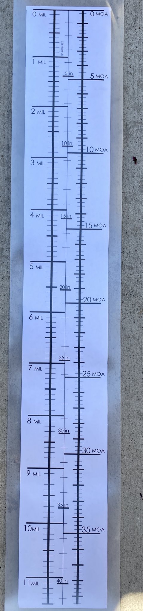

Here is our scale from @Jackmaster on here, he laminated us a Mil & MOA scale that we use, the scale is also leveled with a 4ft Level which gives us a view of the reticle so we can check plumb,

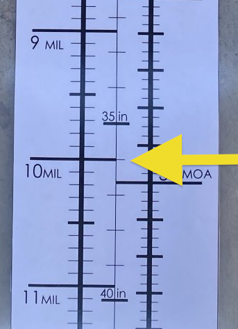

is it fair to say the 10Mil mark@100yds a dead equal to 36inches?
So if we take a "calibrated yardstick" from home depot and run the test at 10mil=36in...and it lines up => OK
is this valid "go or no go" test for a MIL/MIL scope?
IMHO if you chould check one value with an easy to obtain target like a $1 yardstick, maybe more people would flag tracking issues earlier in the process for many people.
Thoughts?

Here is our scale from @Jackmaster on here, he laminated us a Mil & MOA scale ...
It means they moved more than the advertised click amount.
So if it was 98%, it would be .2 mils short (reticle would be at the 9.8 mark) if you dialed 10 mils.
If it was 102%, it would be .2mils high (reticle would be at 10.2 on target) if you dialed 10mils
Ahh. This makes more sense now since it is % deviation from a single point. I was thinking it was how accurately it tracked for multiple points. Thanks.

1 Mil = 3.6 Inches at 100 Yards
Yardsticks work
Thanks, so
-->1mil=3.6in@100
Main prob with using mulitple of 3.6 is lack of calibrated decimal-inch rulers
-->10mils=36in@100
Good to go since the "36.0" line ruler common on all yardstick...even fractional.
Couple more "quick and dirty" datapoints if using the "yardstick" approach
5.0mil@100yd 18.0 inch
2.5mil@100yd 9.0 inch
So this gets you a couple points across the usable range.
Again not perfect but idea is to red flag a major issue with tracking with minimal testing gear.
