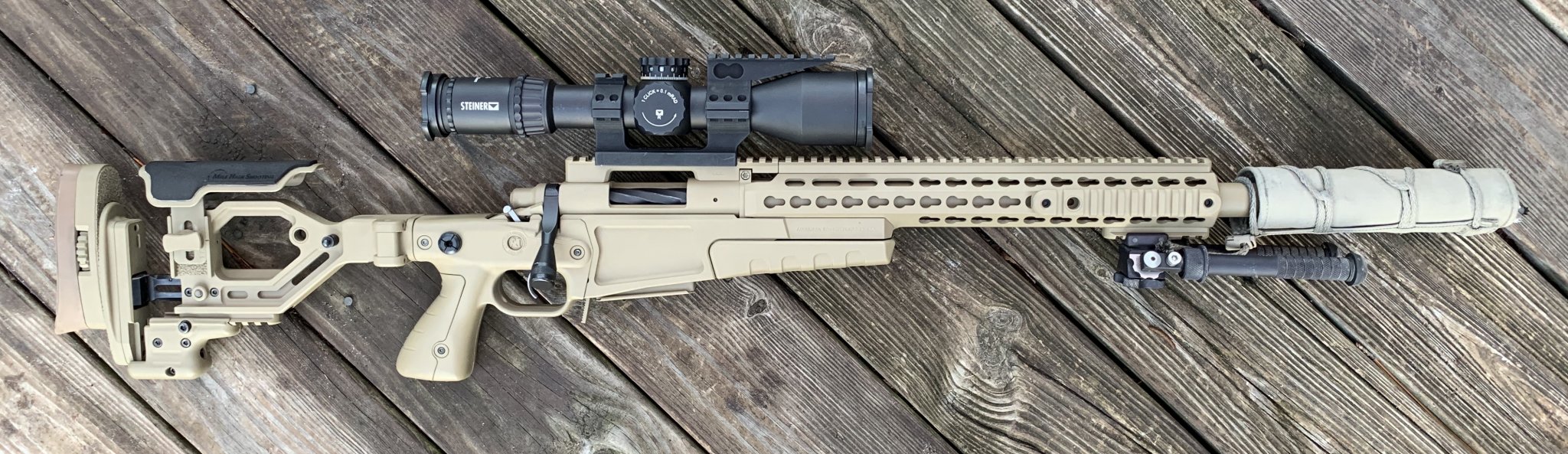

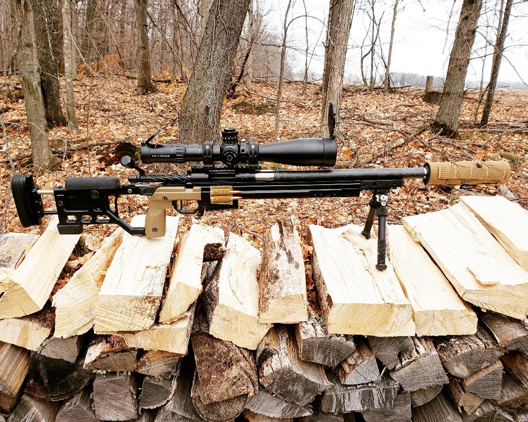

Great rifle by the way I’ve got a shorty in an AX also. Best chassis made IMO. Only thing that would make it better is a flush cup in the very rear.
Just got the 20MOA continuous top rail in. Gotta get it cerakoted to match and it’s done.

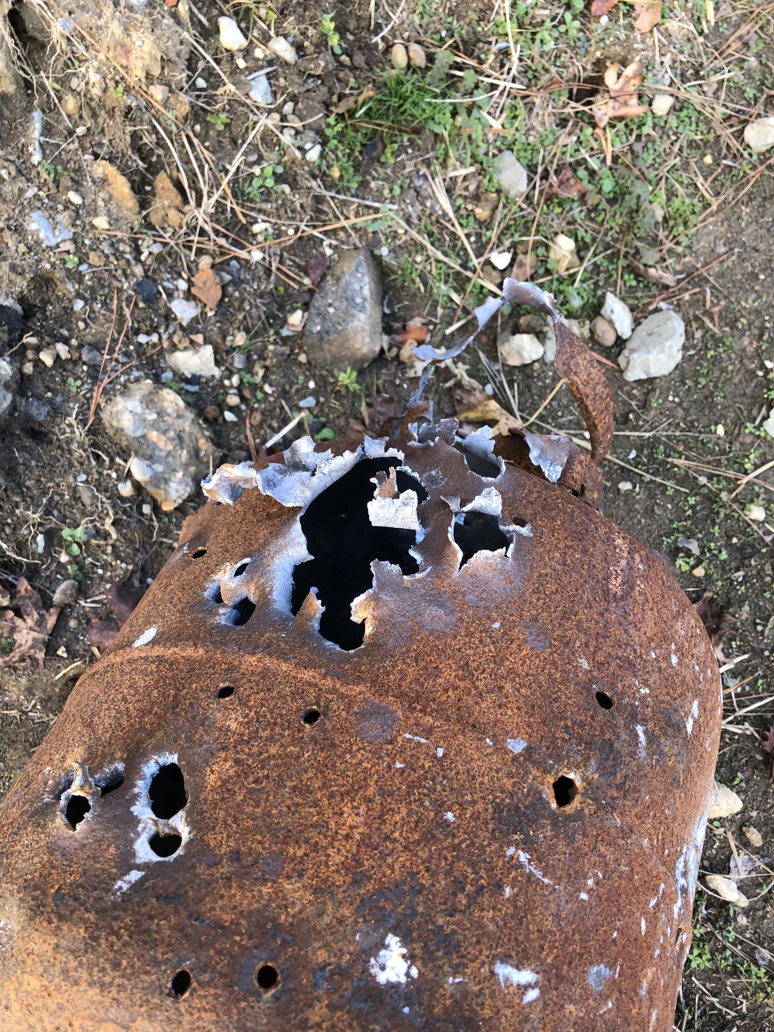

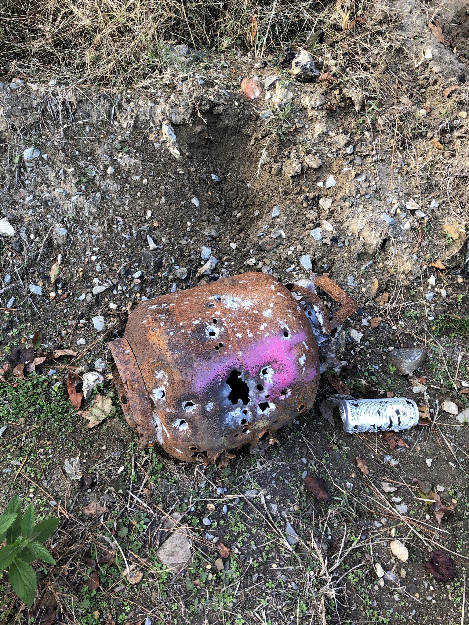

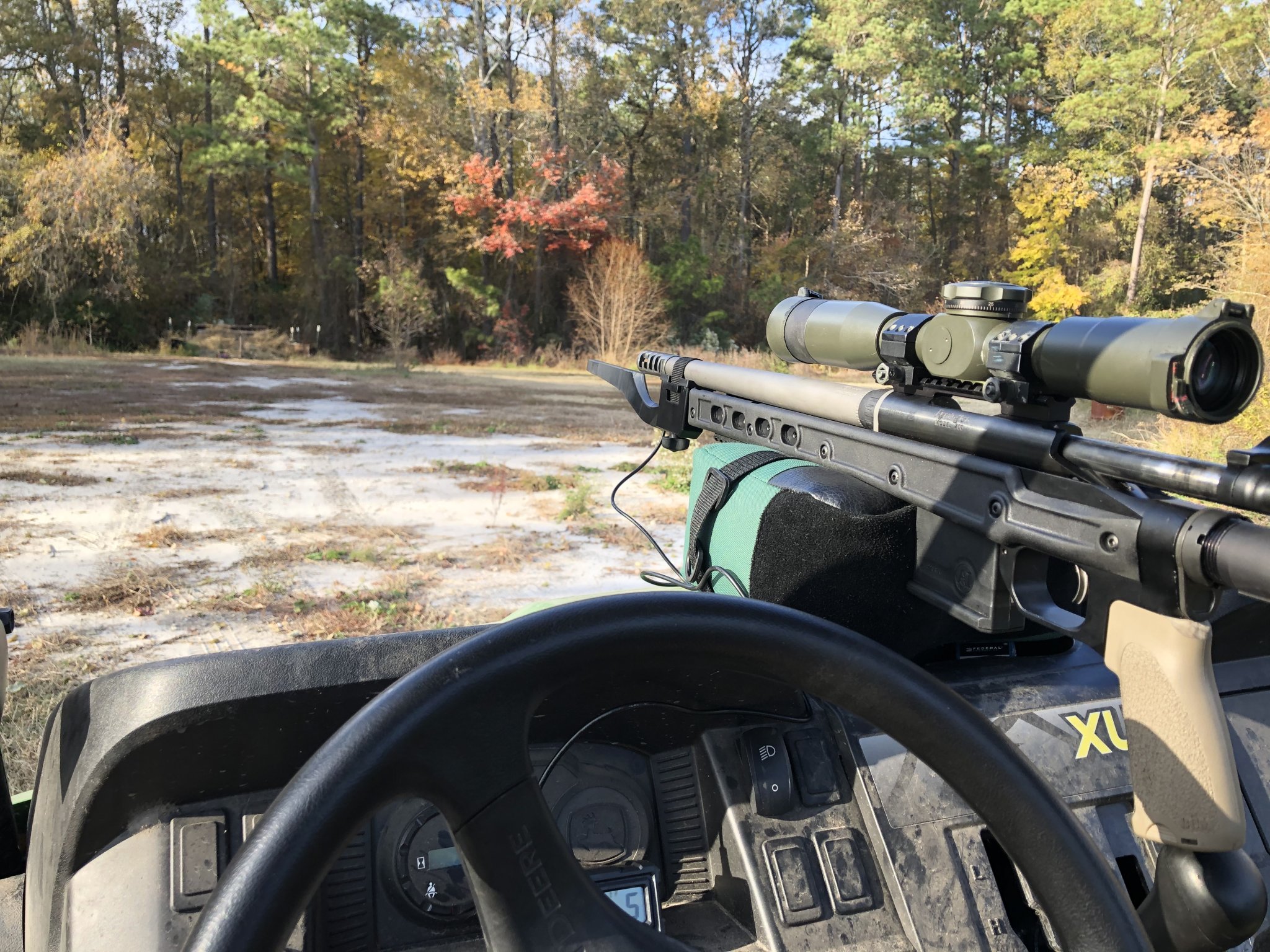

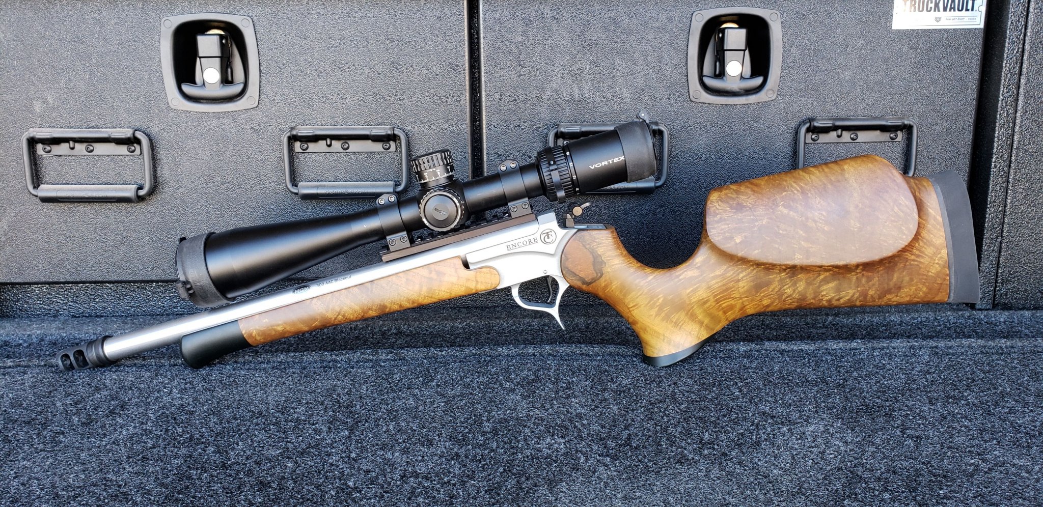

@HolyCity73 speed tests in 16 inch 350 legend post from a few days ago. Sorry it took so long had to get a new chronograph, I shot my other one in the face with a 22 Nosler. Little gun shoots quick for what it is. Was shooting at an old propane tank. The big hole in the middle is the group and the back side is Swiss cheese. I tried to find some bullet fragments or parts but most were to small to pick up.
145 FMJ
1-2196
2-2203
3-2210
4-2195
5-2211
AVG- 2203
SD- 7
ES- 16
150 Extreme Point(one fail to fire think it was to short for the chamber. Was getting light strike on primer. All other rounds fired
1-2285
2-2272
3-2254
4-2259
5-2245
AVG- 2263
SD- 15
ES-40
180 Power Shock
1-2115
2-2130
3-2105
4-2134
5-2119
AVG-2118
SD-10
ES-29

Man, I bet that's a fun gun to have around in the pickup or mule whenever out in the field/farm. By the looks of it, I'm guessing that's your intended use for it?
Yeah was kind of the idea when I started the build. Just an around the world beater that had some muscle if needed. It shoots good, the 180s let you know they are there compared to the 150s.

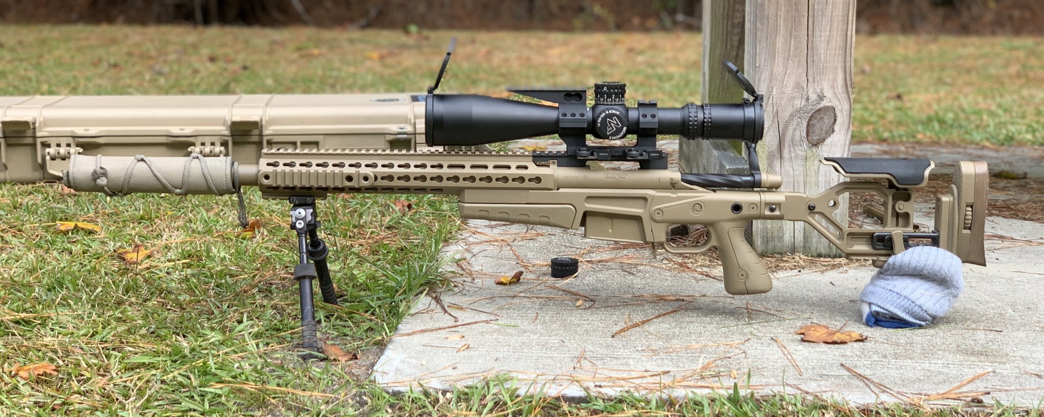

Pinned and welded or full 16” barrel? Looks like a handy little gun, but maybe a little overkill on magnification for the caliber. ? Not knocking it, again, looks like a lot of fun.
Full 16" barrel. The Vortex is a 5x25 and just a bit of overkill but I like it. I normally keep it at 10 and might start looking at a replacement soon.
Reactions: Anb618

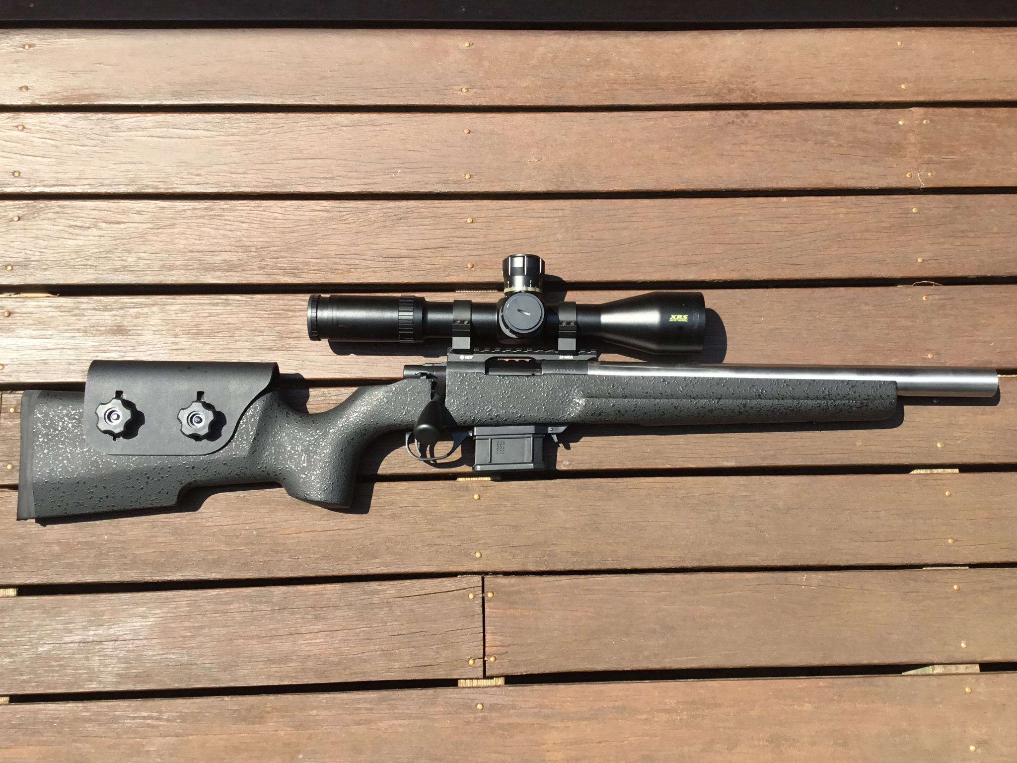

so cool. Always wanted one for a truck gun. How does it shoot. Any mods to the handguard hanger to free float the barrel
I had to change out the stock as it was too short for me; ended up going to High Plaines Gunstocks and getting a much better stock. The barrel fits perfect so no changes needed. This normally wears a TBAC Ultra 5CB. Great shooting rifle. I also had some trigger work done by Haus of Arms.
