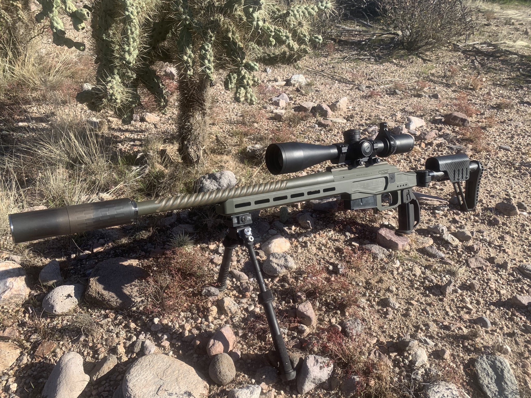

I just purchased a Seekins Havak Element in 6.5 PRC with a 21" barrel. I haven't shot it yet, but in conversations with Seekins, they claimed that in their testing the PRC started to drop off much more precipitiously at lengths of less than 21". They said thats why they picked such an arbitrary barrel length. So there's that little nugget for ya.

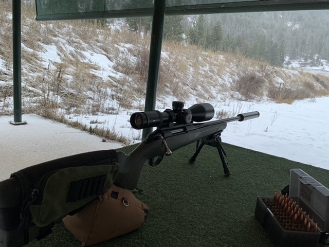

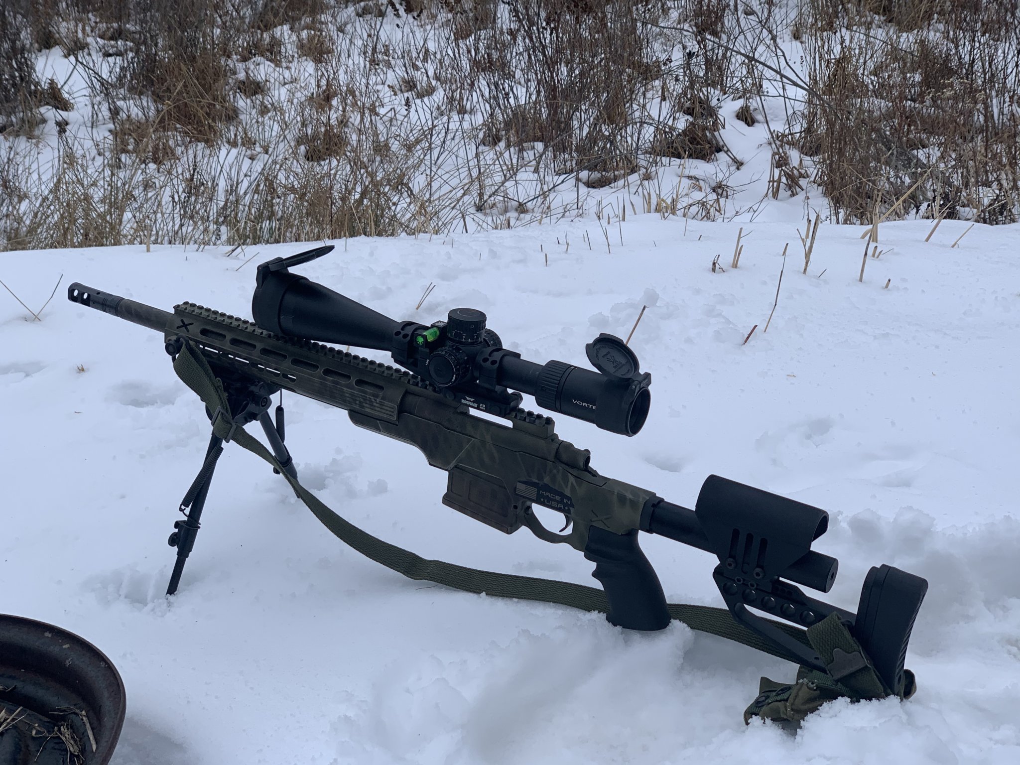

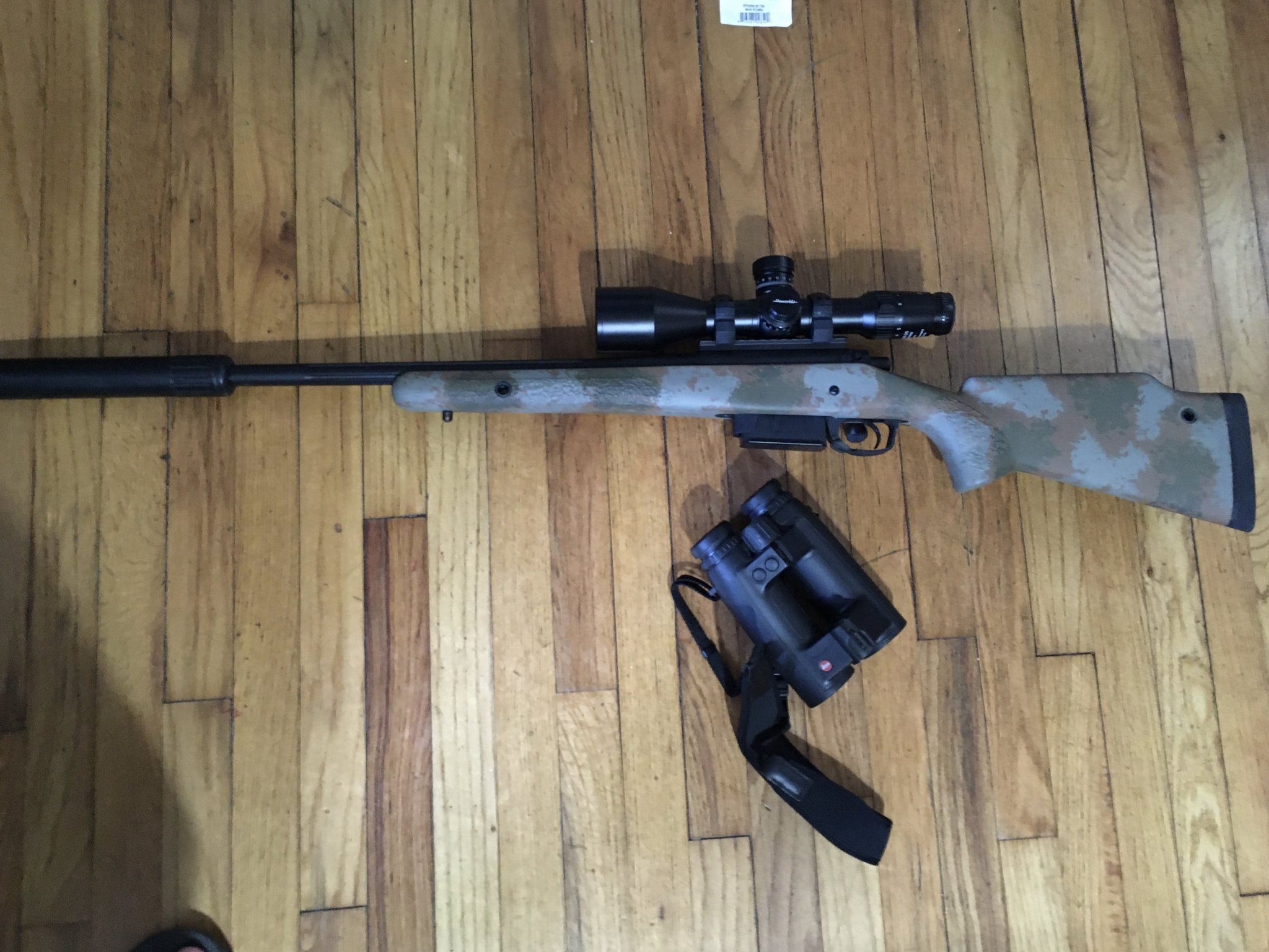

My 16” tikka Tac a1, awesome rifle and it shoots beyond belief

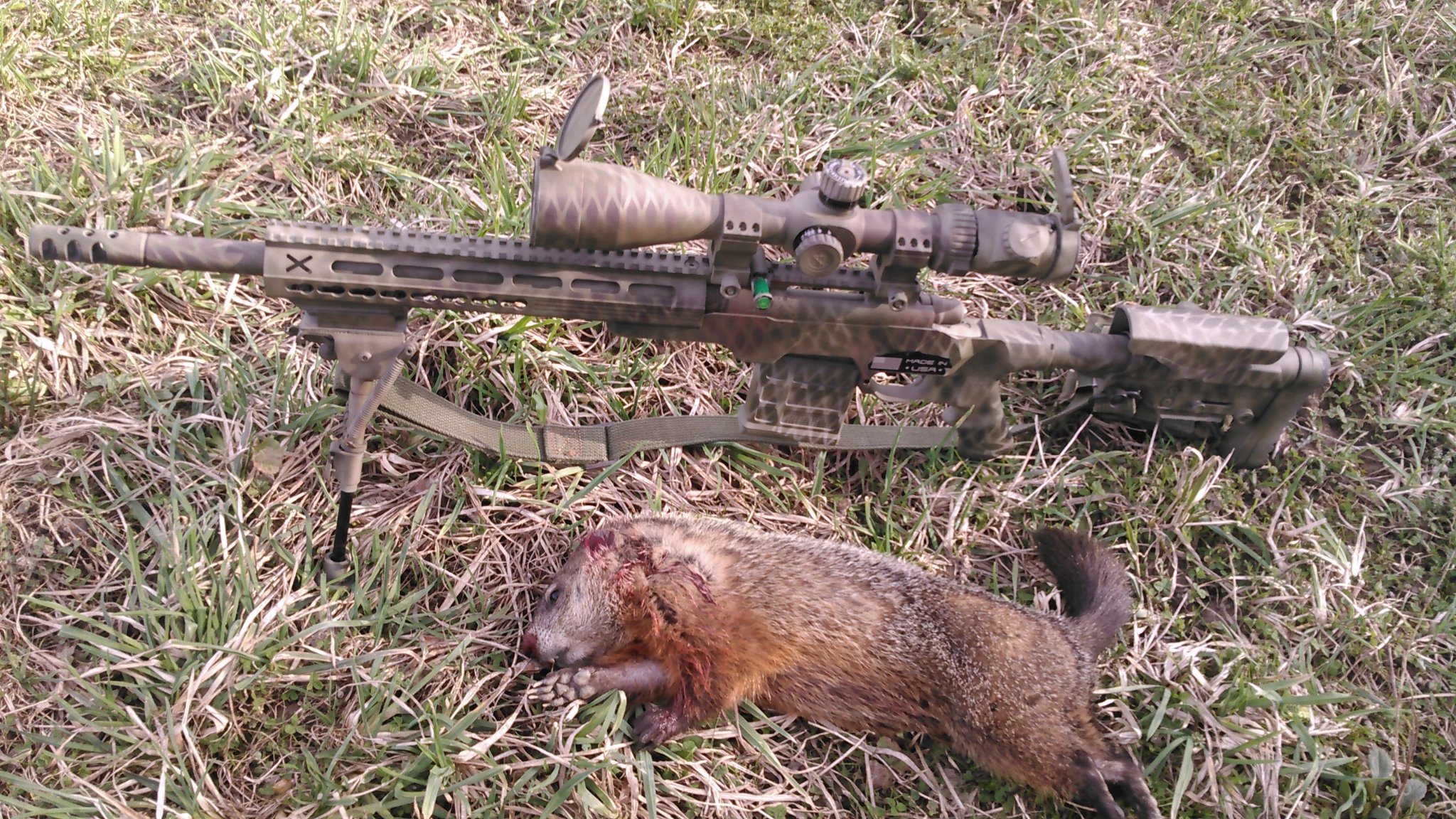

Got the shorty (16.5in) 6.5cm out to 1k today. Unfortunately pulled it out later in the session with not a lot of ammo left over, but go hits on steel at 1k (obviously missed more than I hit) but surprised myself. Ending up dialing in 10.4mils of elevation, and held 2-2.4mils of wind with 147 Hornady ELDs:

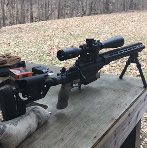

Can't wait to take this to the range and then the farm

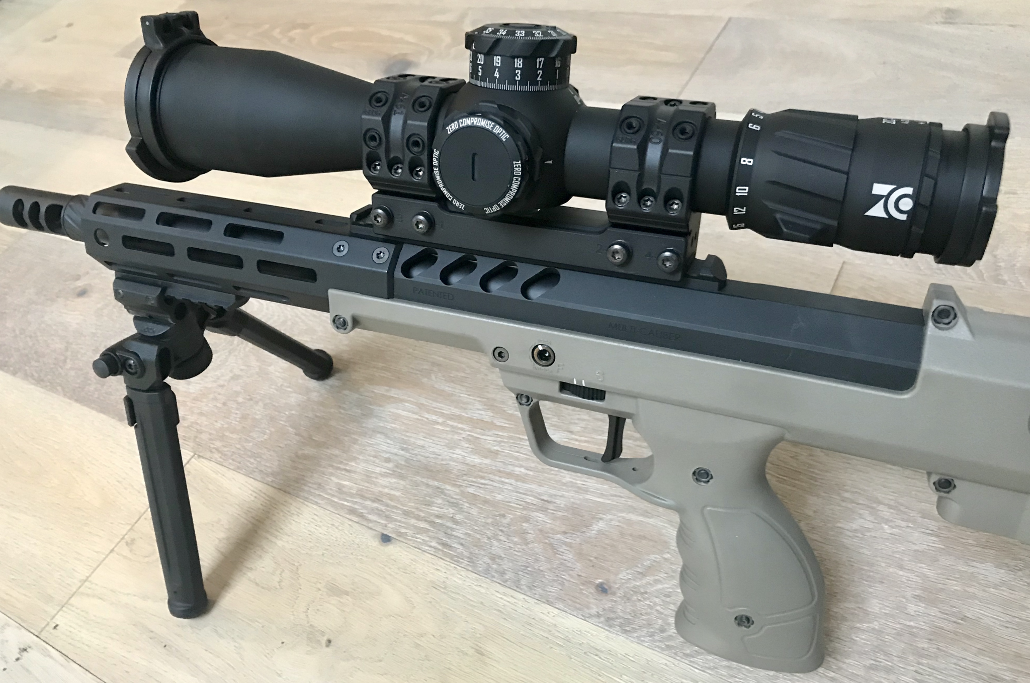

bergara ridge 18" 6.5 creed
I don't know if I'm going to get a better bipod because it'll be used for hunting 90% of the time and the rest for shooting steel to 1000 for fun.
@jwhjwh54 I picked up one of those myself, it is an amazing rifle! I love the look, the weight, and the accuracy. Only small change I made is drilling and bedding a rail to mount my bipod on.

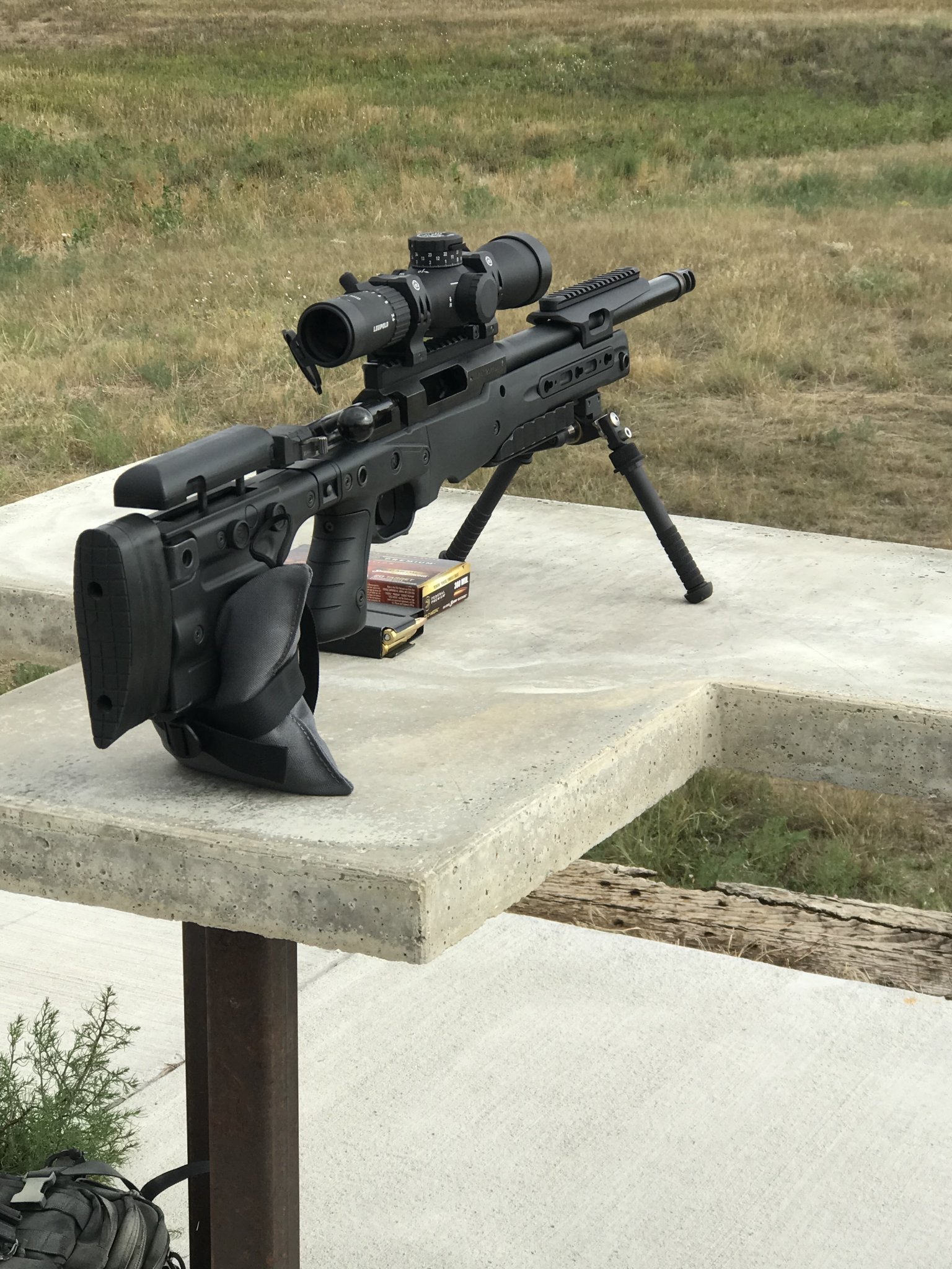

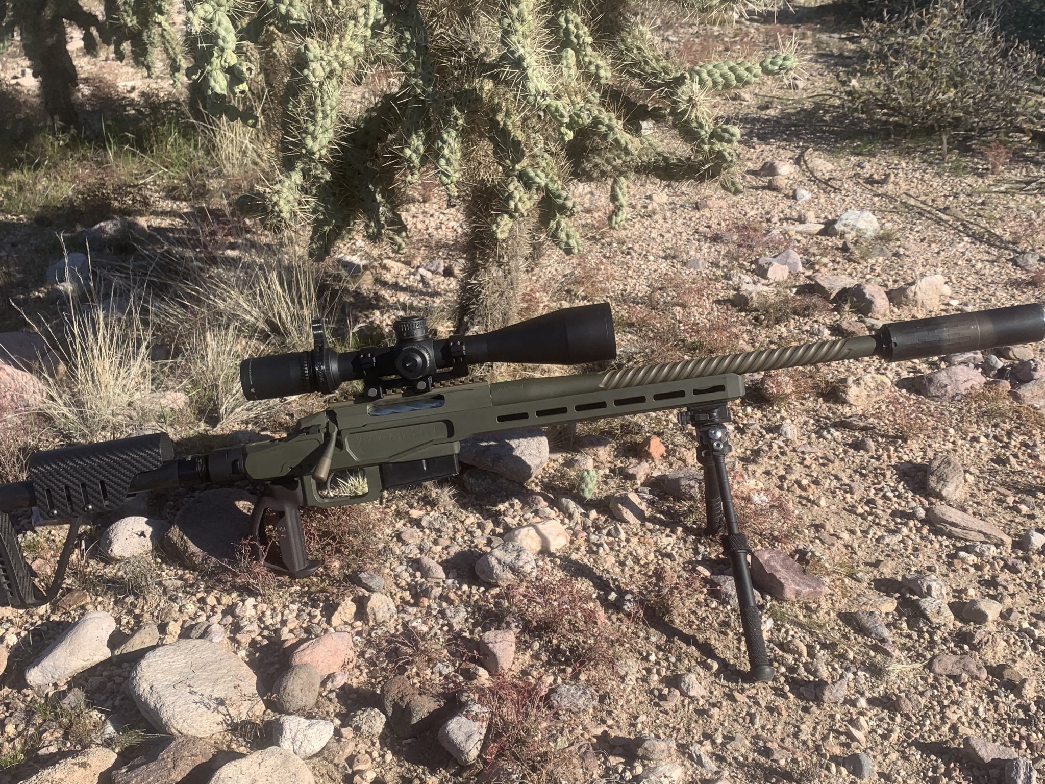

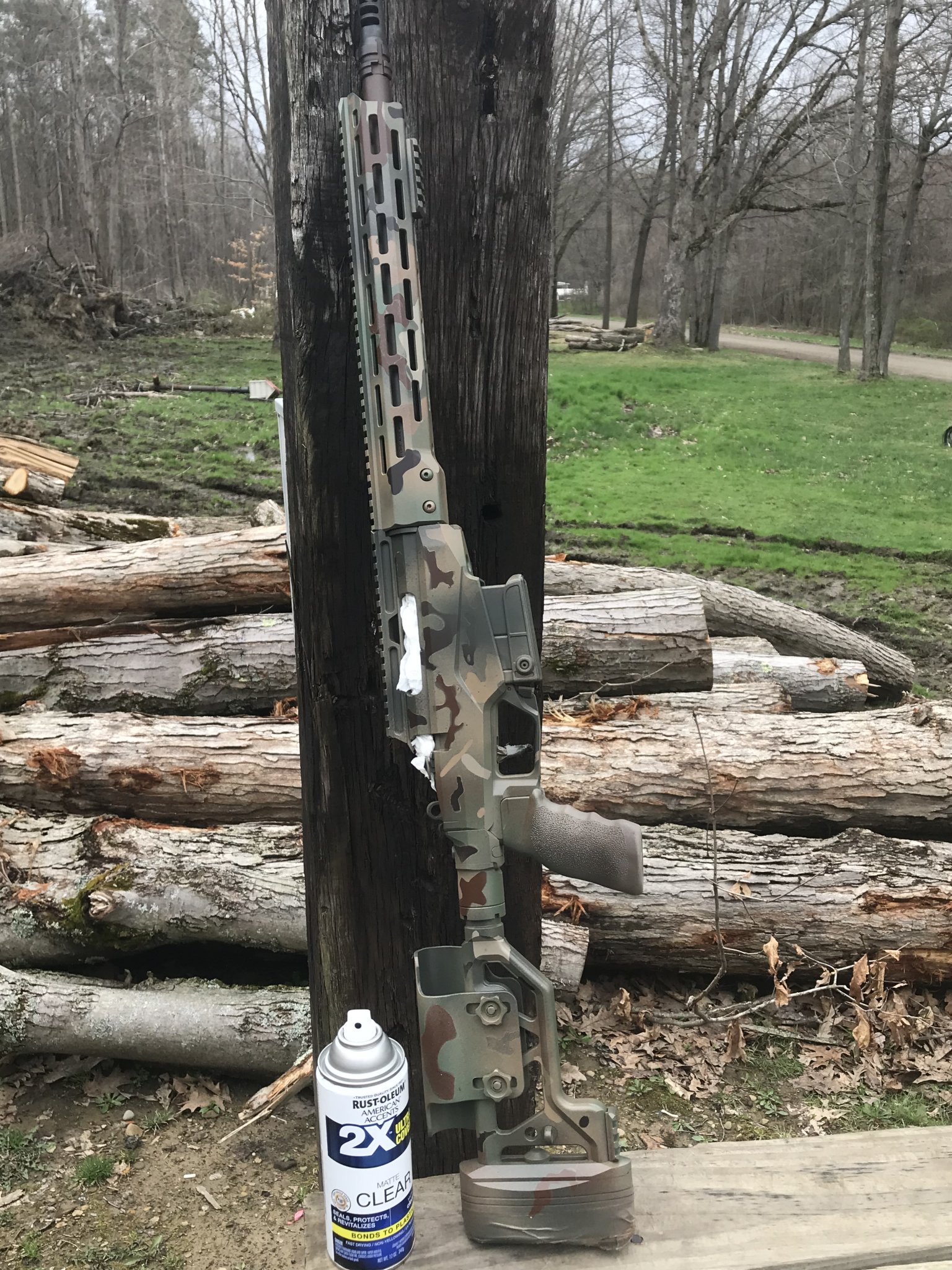

16 1/2 308 1/10 twist. Aba chassis. Timmney 510. Shilen barrel on a trued 700 action. It’s a hell of a truck gun. The second picture is how it sits now.

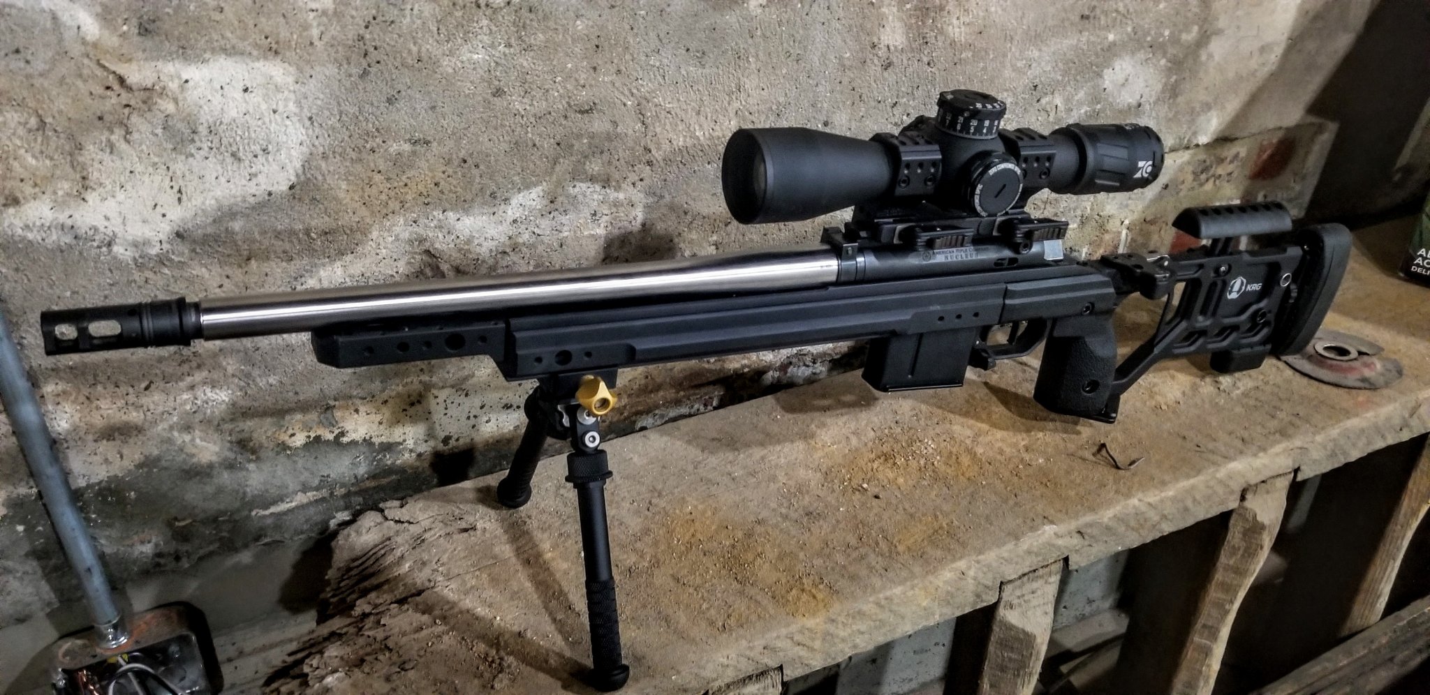

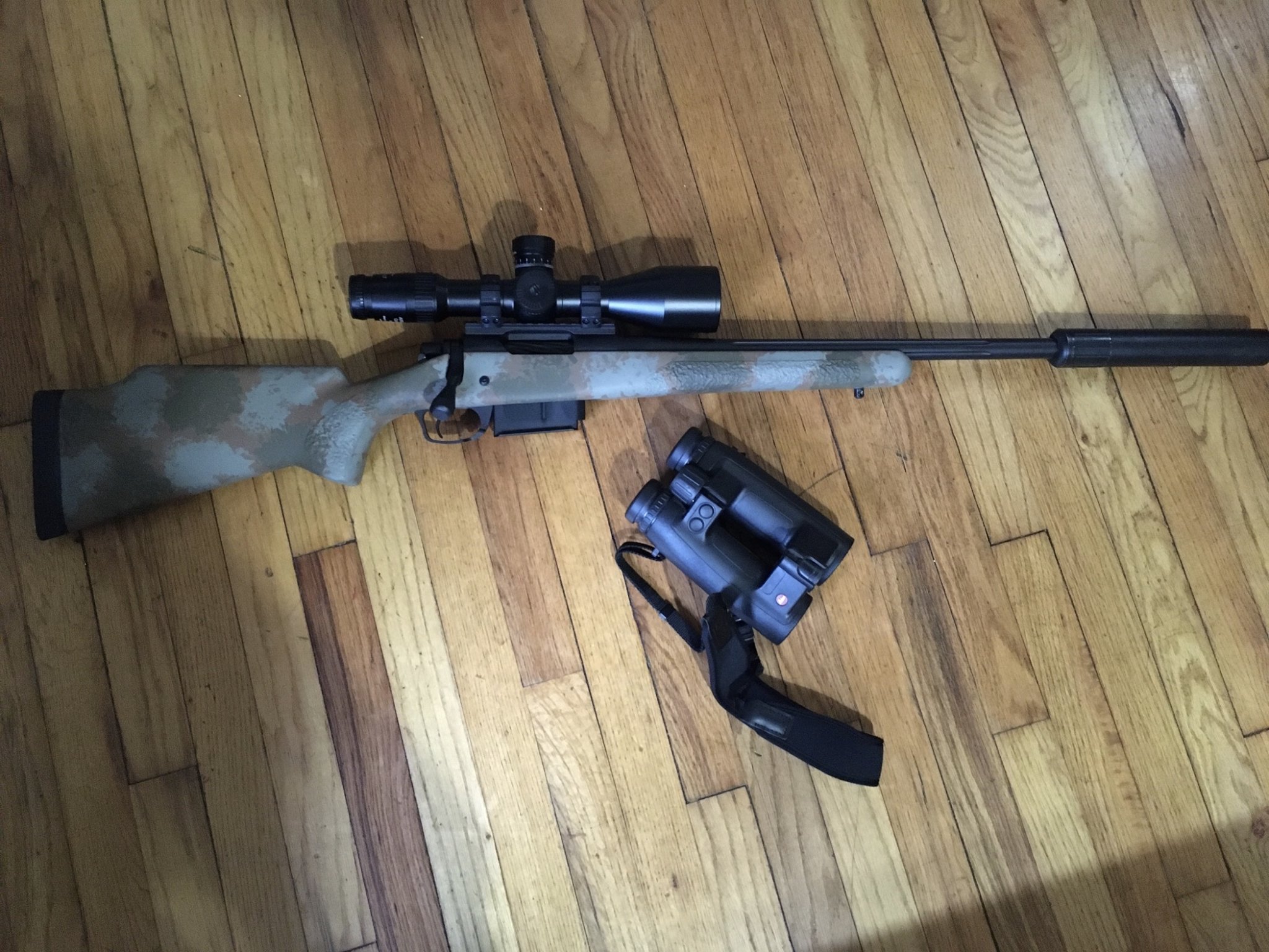

Just finished the rifle up:
18” 7-08 stiller action Brux barrel
Manners EH2 with mini chassis
APA .856 rings
Custom AAC Silencer (SPR/M4 tube with cyclone baffles)
Hensoldt 4-16x56 FF LT H59
