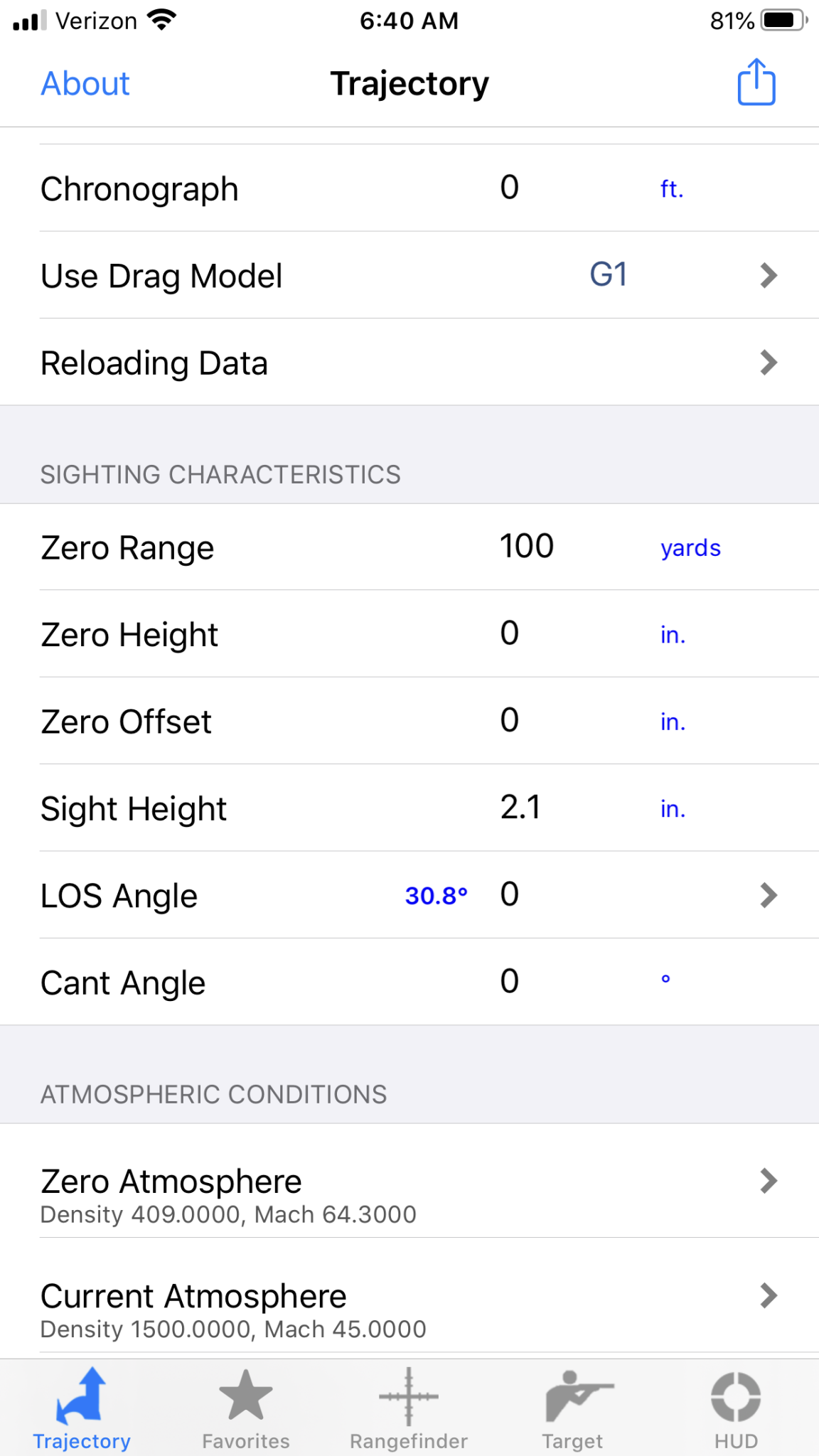

I use Ballistic AE on my phone but it’s not as popular now.
I’d research in the ballistics section.
lots of great information there.
Here’s the area in my app where you enter in any offsets.
