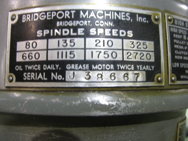

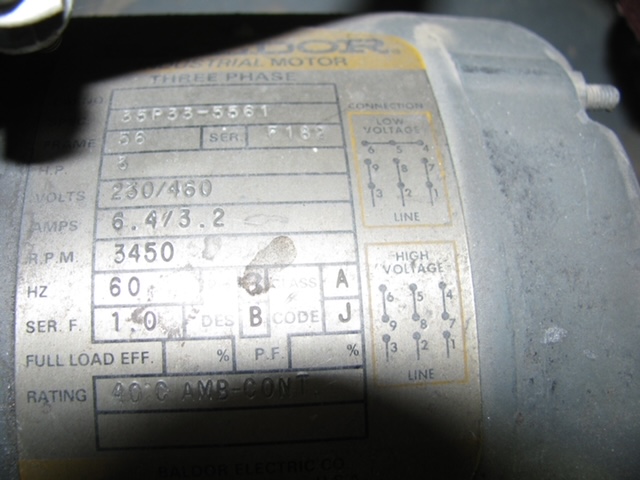

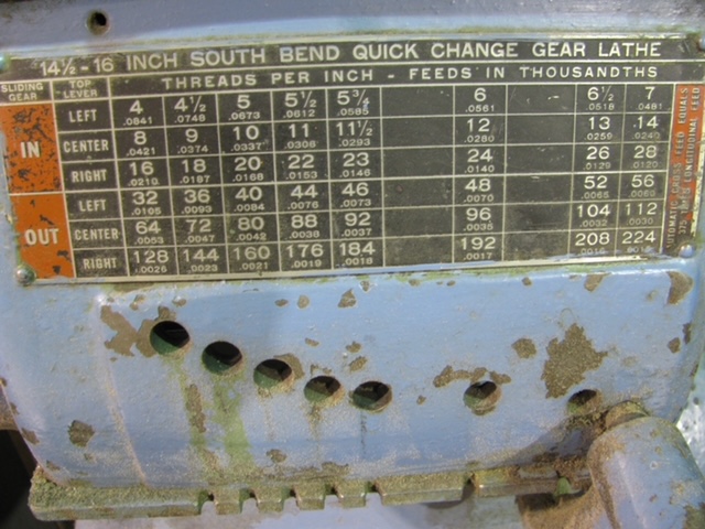

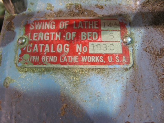

    I have limited info on these so far. Jusy the attached photos. South Bend 183C and a J series Bridgeport.
    A friends company is closing a shop so they may be available.
    Not sure yet of the size of the J series bridgeport. The 183C lathe is 6 foot.
    Both are 3 phase so a converter will be required.
    Both will need transported 5+ hours to get them home.
    Anyone have a link, info or experience on either piece?

    From the last picture the Mill I would guess to be a Series 1 step pulley.
    Good old unit. Likely will need TLC if it came from a working shop.
    YouTube is a great source of information for inspection, repair & rebuilding.
    A wonderful company that can help with tech & parts is:
    Located in Ft Wayne, IN
    Barry is a good guy with lots of wisdom and knowledge.
    I can not speak about the lathe, not familiar with that one.
    Best of Luck, I have an old Series 1 Bridgeport and it serves me well!

    The SB is a 14-1/2", UMD. Could be single tumbler, or more recent double tumbler QCGB.
    IIRC, they had an oddball spindle nose thread, 2-3/8 x 6 tpi. Don't know if that was all of them, or the older single-tumbler models.
    Not a huge obstacle, but you may need to machine your own backplates if that's the case.
    Parts aren't going to be nearly as available as more popular 13's- be sure to evaluate carefully.
    Also, if you plan on chambering barrels through the headstock you may be limited to longer barrels without needing a "workaround".
    Be sure to check the length of the spindle.
