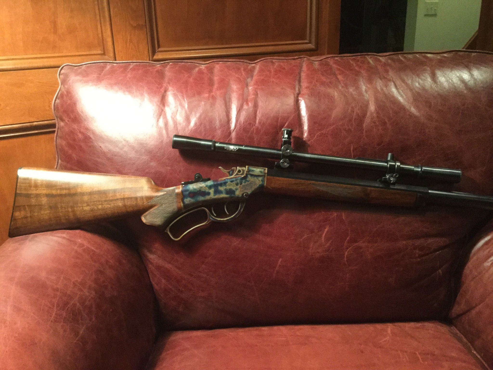

I am picking up a Pendersoli Dixon Sharps 1874 with a 6x scope on it next weekend. This is my first forray into this type of gun. It is a 45-90. I would like to reload to shoot 600-1000 yds with it. My heart wants to reload black powder paper patch rounds but my brain say grease groove smokeless. I have no experience with anything but modern rifle reloading. Anyone here have experience in this area?

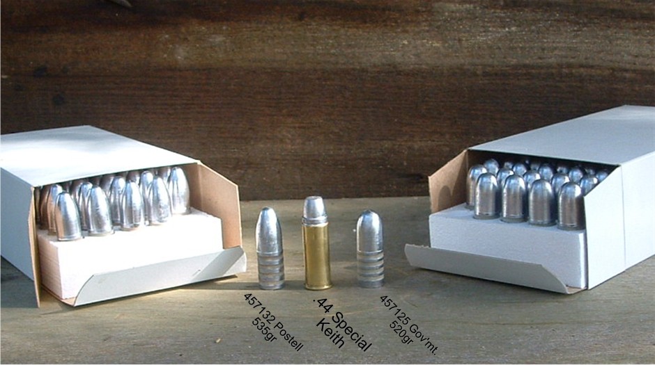

A short while ago, an old timer in my area passed on and his family dumped all his bullet make stuff at our local gun shop. Besides his tools, (that I snatched up) there was about 900 pounds of cast bullets sitting in vacum packaged 50 round boxes. Beautiful looking bullets cast in a 20:1 lead/tin alloy. I tried shooting a few as is, but my Sharps didn't like them. So I used them as lead for casting 535 gn Postell's. (Lyman mold number 457132) In the end, the gun shop got tired of the bullets taking up space so they gave them all to me just to get them out of there. So at some point in the future, I still need to learn about mixing alloys. For now, I'm cheating.
A couple of weeks ago I bought a different Lyman mold for a flat-nose 405 gn bullet that I want to use with a Rem Rolling Block that found its way into my safe. (Did I mention that block powder shooting is really addictive?) Anyhow, the mold makes such a beautiful hassle-free bullet that I decided to try some out of the Sharps.
They grouped well, but at 100 yards the POI dropped just over 8" compared to 535 gn Postells. This surprised me. I've since heard from several sources that this is due to the shorter period of time that the lighter and faster bullet spends in the barrel subject to recoil/barrel rise. I had never encountered this to any significant degree with modern rifles. But with these big slow moving bullets it's very pronounced.

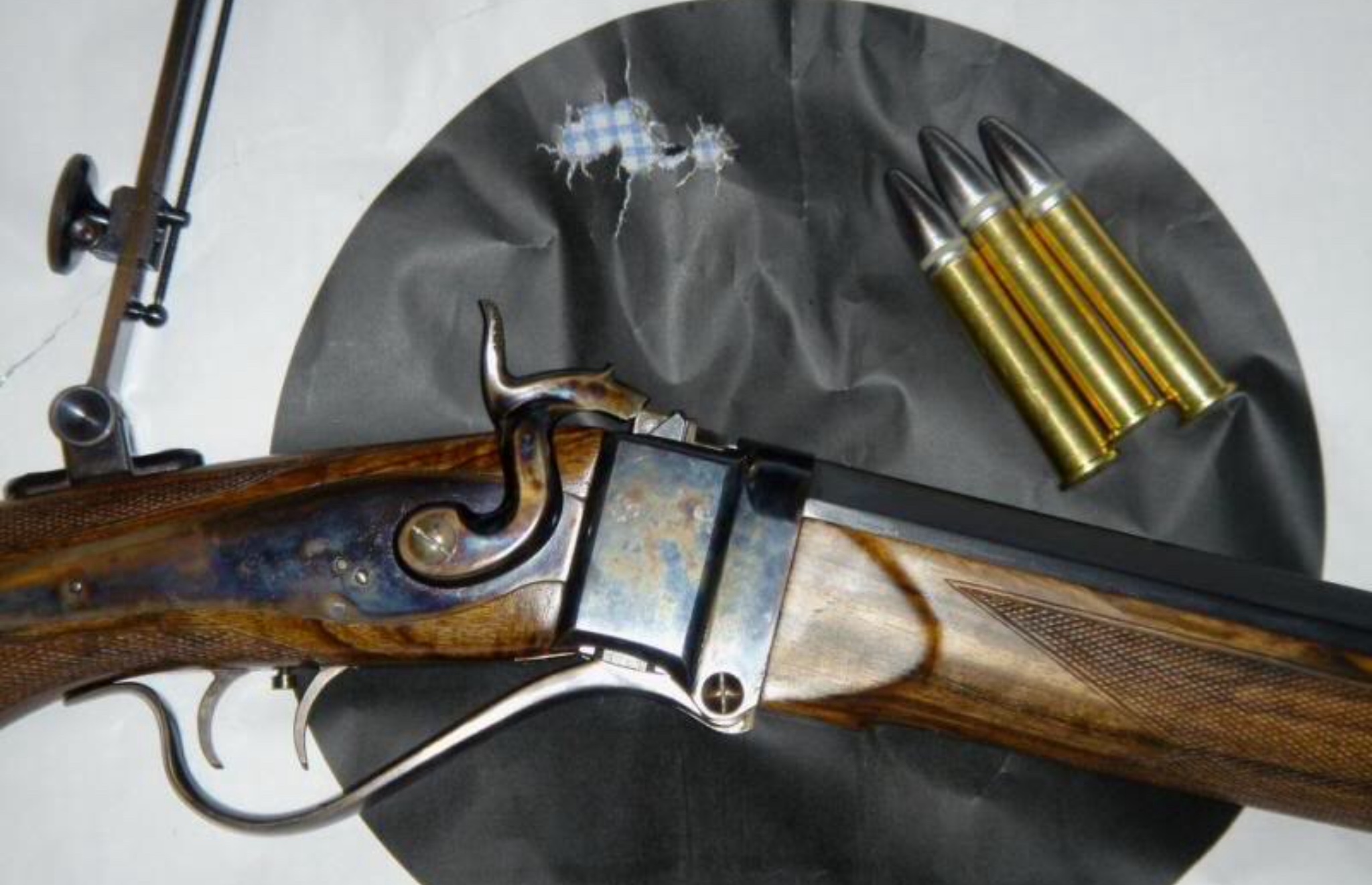

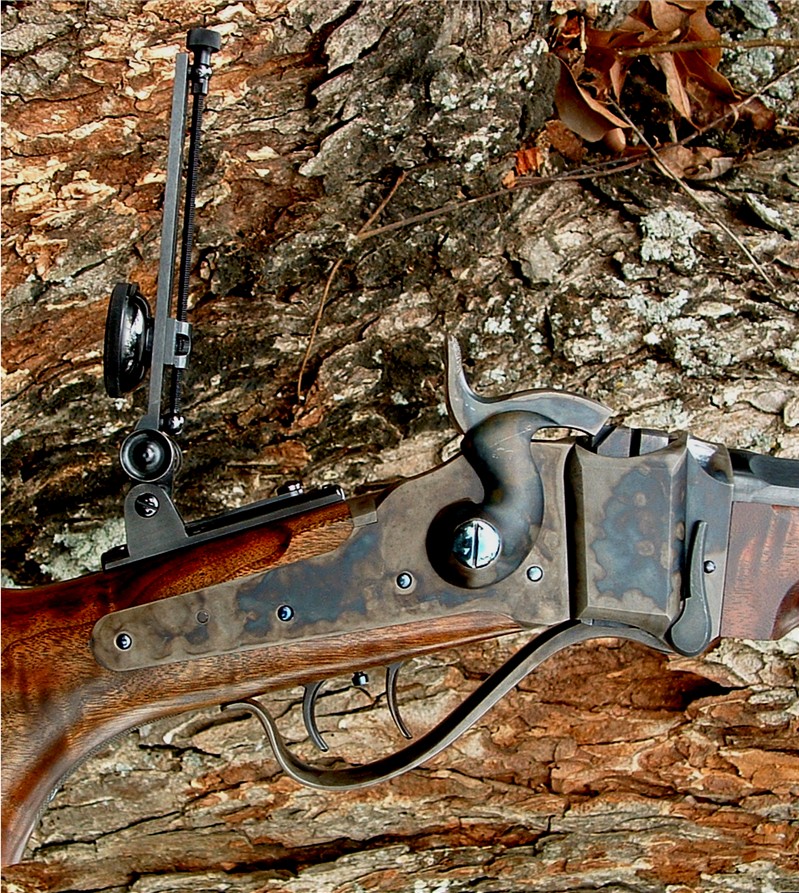

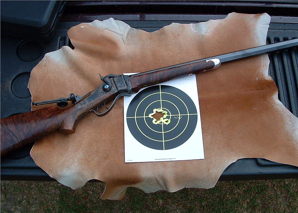

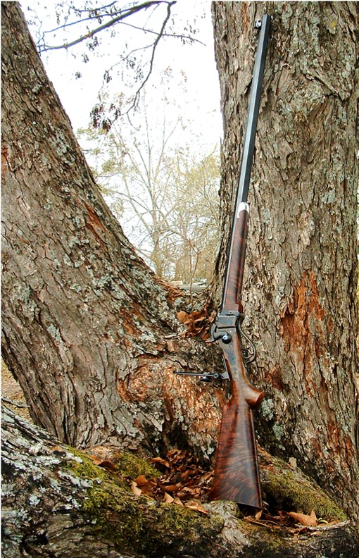

About 20 years ago I purchased a used Pedersoli 1874 Sharps Billy Dixon model in 45/70.
I replaced the tang sight with a Pedersoli souls sight.
That was a mistake!
I then purchase a MVA Buffalo souls sight with a Hadley eye piece.
I also replaced the Pedersoli ‘bubble’ front sight with a better one - no cold molasses slow bubble level.
My loads have been 60 to 61 grains of Swiss 2FFg or Swiss 3FFFg, .03 vegetable wad, slight compression with one lube groove exposed and an overall length of just under 3.00”.
This is with a Lyman home cast Postell Bullet.
I have made hits beyond 1000 yards on occasion!

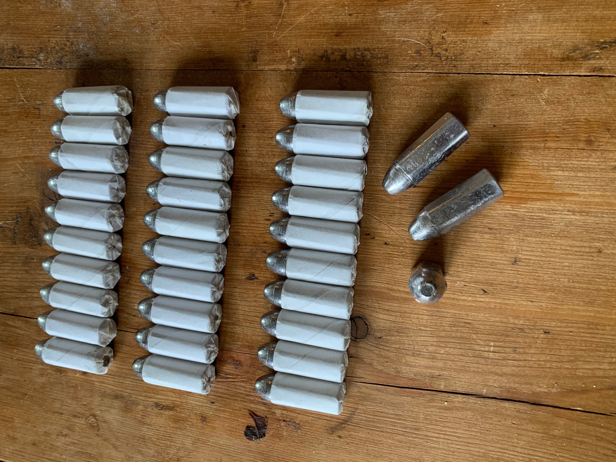

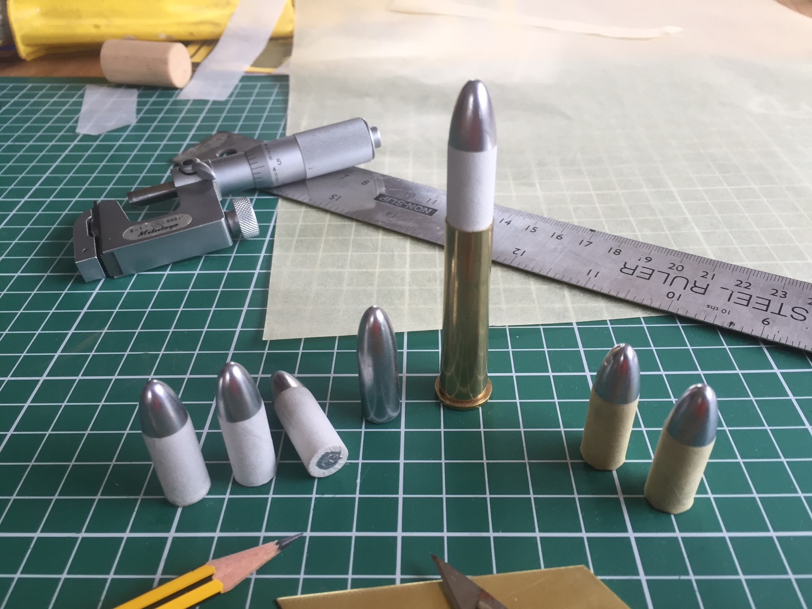

So now that it's finally not snowing here.... I broke out the mold and started to make some Hexagonal Whitworth paper patched boolits...
I got about 100 cast and about 30 patched in a short afternoon. I could have done more, but it's time for a beer!
I have 20 done with a small dab of (highly-diluted with water) white glue holding the patch corner... but I am concerned that it will not release the paper patch completely and will cause erratic flight. So I ended up doing another 10 with nothing holding the patch on at the top and those worked out just fine... I just had to work on my technique to get the paper to sit down during wrapping so that I could 'capture' the point without it slipping. Turns out no glue needed once you get the technique down. I did put a dab of my diluted glue mixture on the tail to hold the wrap in place.
Paper was a gift from a fellow 'Hide member. I love this place! .003" airmail vellum that was just perfect! I designed a parallelogram pattern that puts exactly two layers on a .451 Bullet and the edges match up very well. After the Elmers mixture set up, I rubbed each with a bit of liquid Alox and that is now drying.
I might even go out tomorrow and shoot them all! Get a range report! My first time paper patching and I can't wait to see how it comes out. Very satisfying and relaxing!

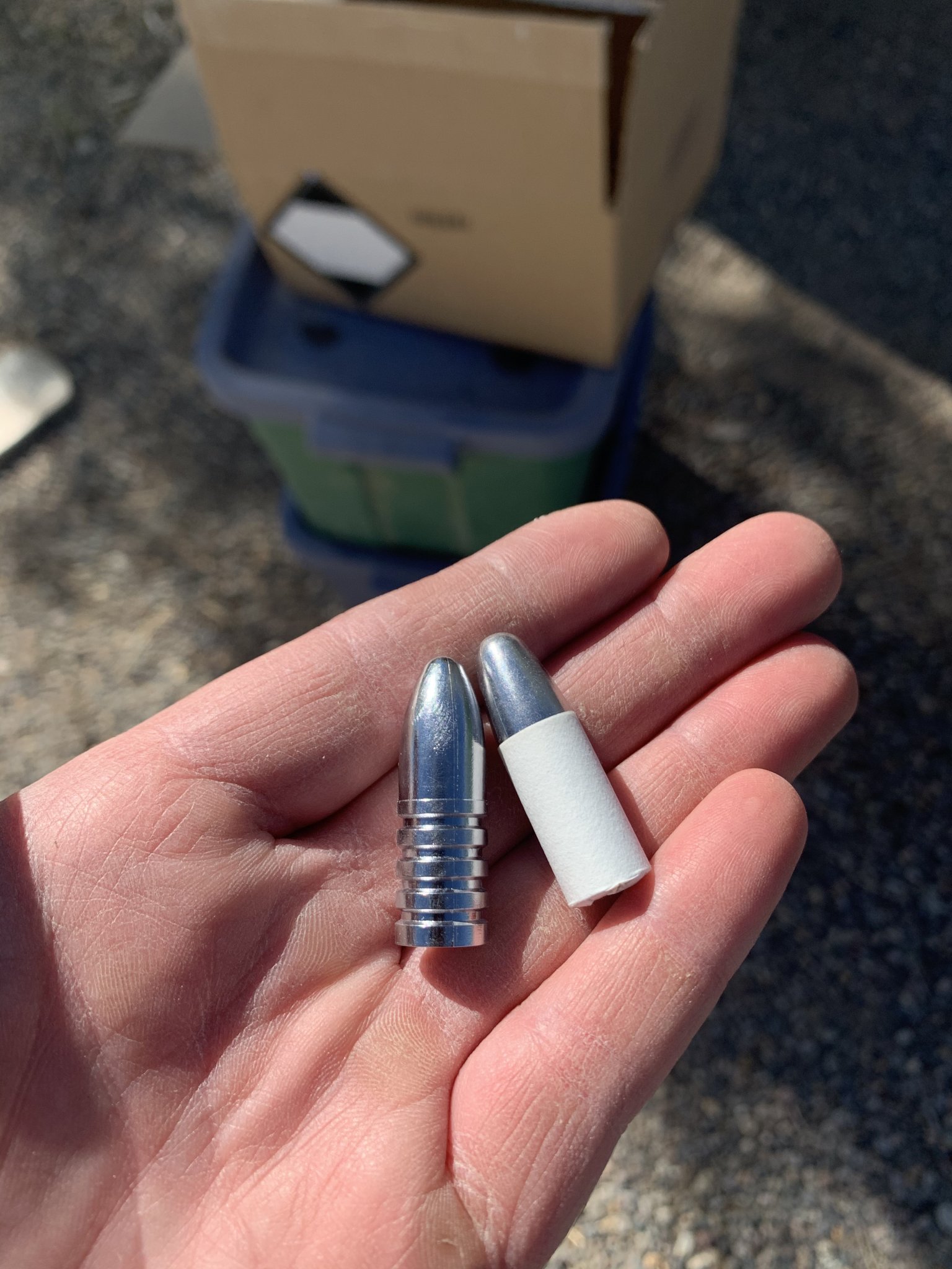

Your Finish on those is spectacular. I am not
Coming close on the Whitworth. Even though mold is hot and I am giving them a good set time.
Pedersoli steel mold. Lee production pot at full temp. About 3 percent tin on the hexagonal. Very short drop on the pour (less than 1/4”). They frost fast. Dropping into bucket of water for a chill.

What do you mean “drop” on the pour? Like a stream of lead out the bottom of the pot? That could be your issue. I pour with a ladle, which remains in contact with the mold for a few seconds. “head pressure” I think it’s called, which fills the mold better. After that I’d say mold cleanliness or pot/ mold temperature.
Yes, that is the drop. I can try direct contact next batch. That puts a lot of head pressure on the mold. I will also give a good cleaning to my molds! Cheers!

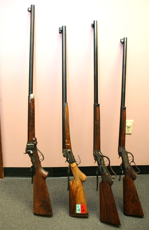

Great thread! Really enjoy shooting my 45-90 Shiloh with BP and bullets i cast myself. Mostly settled on a 530gr Postel over a compressed charge of Swiss 1.5. The bullet is lubed with a Paul Matthews formula. I use the Lyman 457125 in my original Trapdoor Carbine.

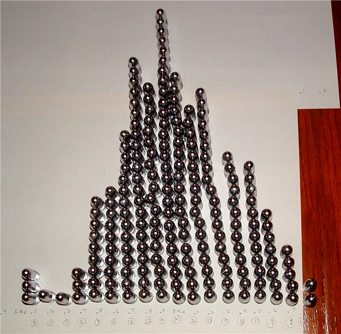

Speaking of casting for these big bullets, in my experience you need a very large spout orifice to use a bottom pour pot or you get very inconsistent results, particularly wasp-waists. I use a ladle. No need to water quench, or run the pot hot. Mine work fine at 1350fps with a nice lube star at the muzzle. All it needs is three breaths on the blowtube and you can shoot all day without wiping.
Also, casting technique and pot temp needs to be consistent to produce consistent weights. I found stacking them in a distribution pattern with .1gr increments in a batch helpful in refining my casting technique.

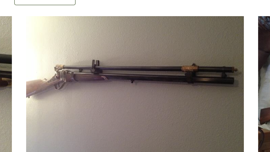

A couple years back, when I bought a Pedersoli Sharps to find out if they're as much fun as they looked like, SirHrM and Buffalowinter welcomed me to my new obsession. I didn't understand that at the time. Now I do.

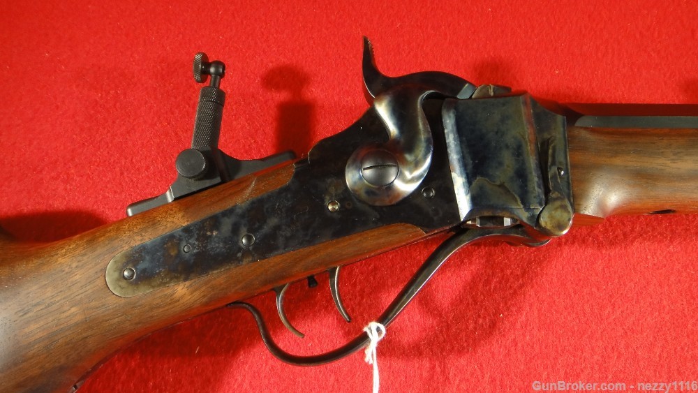

Tonight I just bought my third Sharps off of Gunbroker. It's a C. Sharps 1874 Sporting rifle. Never been fired. 34" barrel Chambered in 50-140. Here's a pic from the auction. It probably will be a week or so before I get my hands on it.
The price was just too good to pass up.
For the record, this makes Sharps #3.
