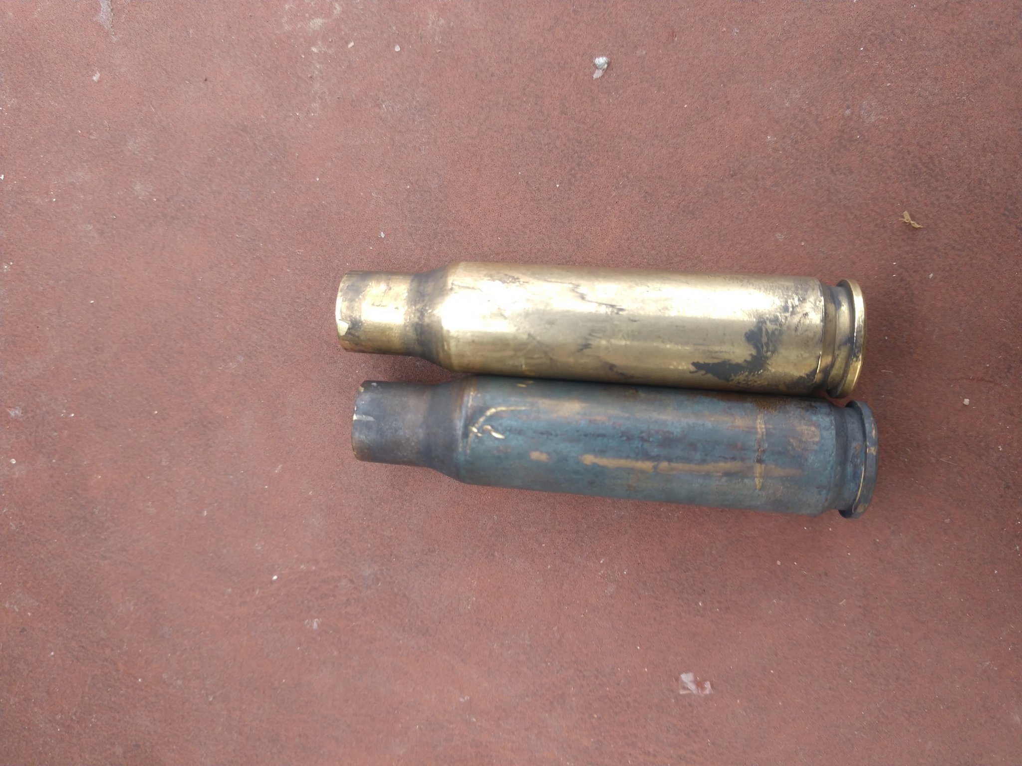

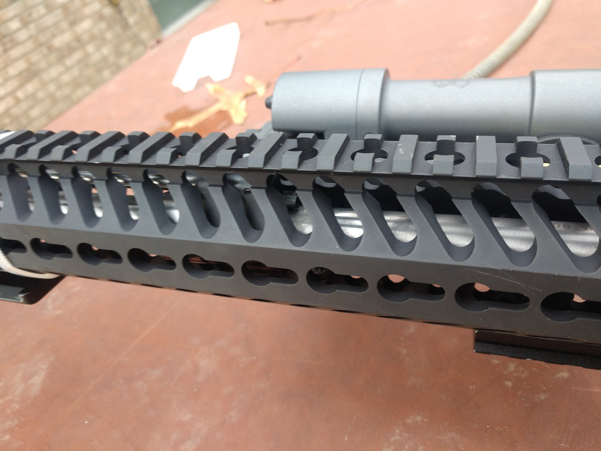

So I picked up a superlative arms gas block and tuned this thing with the can attached, it's still plenty over gassed using the bleed off method, so I went restricted. What a difference! Things way better to shoot and tuned the brass to ejected at right at the 3-5 o'clock instead of the 1 o'clock. It definitely doesn't ding up the brass at all now. Thanks again for all the help!
