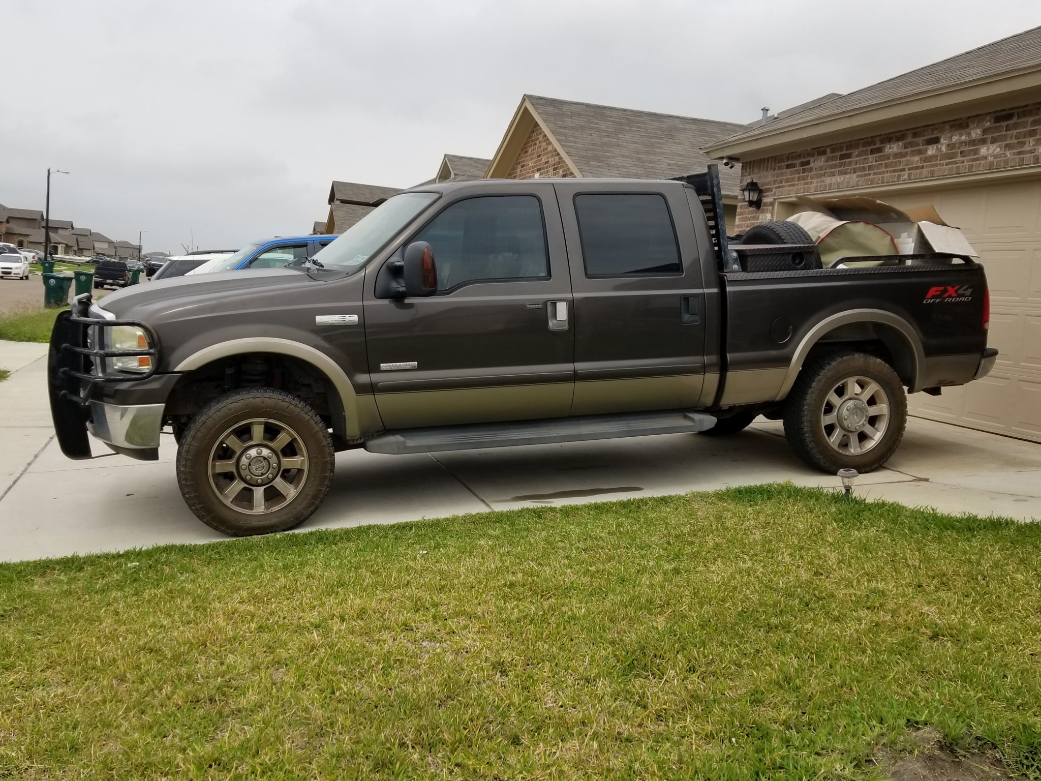

    Hello all,
    Posting here because idk if there is a right section for this and felt this place could at least be Ok. The hide has always been helpful with one another when it comes to giving advice or helping solve problems.
    My dad and I bought an f250 yesterday for cheap money because it had problems. The previous owned said it's the VSM that is fucked up. We never had a diesel or heavy duty type truck before so we are not familiar with these. I'll explain below what the truck does.
    When the truck is off, dash lights and interior lights all stay on, causing it to drain battery. You must leave the truck unlocked because it does not have a keyhole, only a keypad. It does not have a remote to unlock or lock it. If you do lock it, with all the lights staying on, it drains the battery and there is no way to get in your truck due to no keyhole. The previous owner said there is no door code to unlock it or if there is, he doesn't know it. Even if we knew what it was, it's no good with a dead batter.
    The truck runs real good though. When it's running, it is always indicating the front left door (driver door) is always open even though it's not and all interior lights are on. When you park, you must disconnect both batteries to avoid draining them and you must park leaving your doors unlocked. Hopefully there are no junkies trying to get into your truck at night.
    Anyhow, does anyone have any advice?

    It sounds like the drivers door switch is faulty. I know it doesn’t have a conventional switch that pushes in when the door is closed like the old days, but it does have some sort of switch there that allows the lights to illuminate. I don’t know what you mean by VSM, but all these newer trucks have lighting modules, which control all of the illumination. It may be part of the BCM ( body control module) or a separate module. If you go online you can buy a 24 hrs subscription to the factory wiring manual and schematic for that year and download it. Also what trim level is it? I think lesser trim models like XL or XLT does have a keyhole on the door handle. You may be able to source one from a salvage yard with a key, so that you always have the option of keyed entry at a later time even after u fix this. And don’t let anyone tell you the 6.0 is trash. Once it is built right, they are pretty remarkable motors. Better than the 6.4 that replaced it. Also keep an eye on radiator for leaks, the way it’s mounted and torque of truck will eventually cause it to crack on the drivers side.
    The VSM is the Vehicle Security Module which I think is on 2002 - 2008 models. I'll have to look more into this.

    I would start with the easiest thing first: check the pin switches and wiring in each of the doors. If that's not it, you may have a tough one.

    We found it in the glove compartment, it's not working.
    Something in the computer is messed up and that's what's causing all these problems. Some sort of module thingy...
    Door switch is in the latch. Pull the door panel. Known problem.
    This. The door switch is faulty, indicating it's "open". Since its "open" all the interior lights come on.

    On our second diesel Excursion. It’s the door switch but you have to trouble shoot which one. Expensive to replace easy to moderate to pull and clean. The plunger is what gets fouled and shows the door open.

    To the issue: Spray all the door latches with WD40 or whatever. Open/shut the doors multiple times. See if that helps solve the issue. If you drop in to Powerstroke.ORG there's PLENTY of help.
