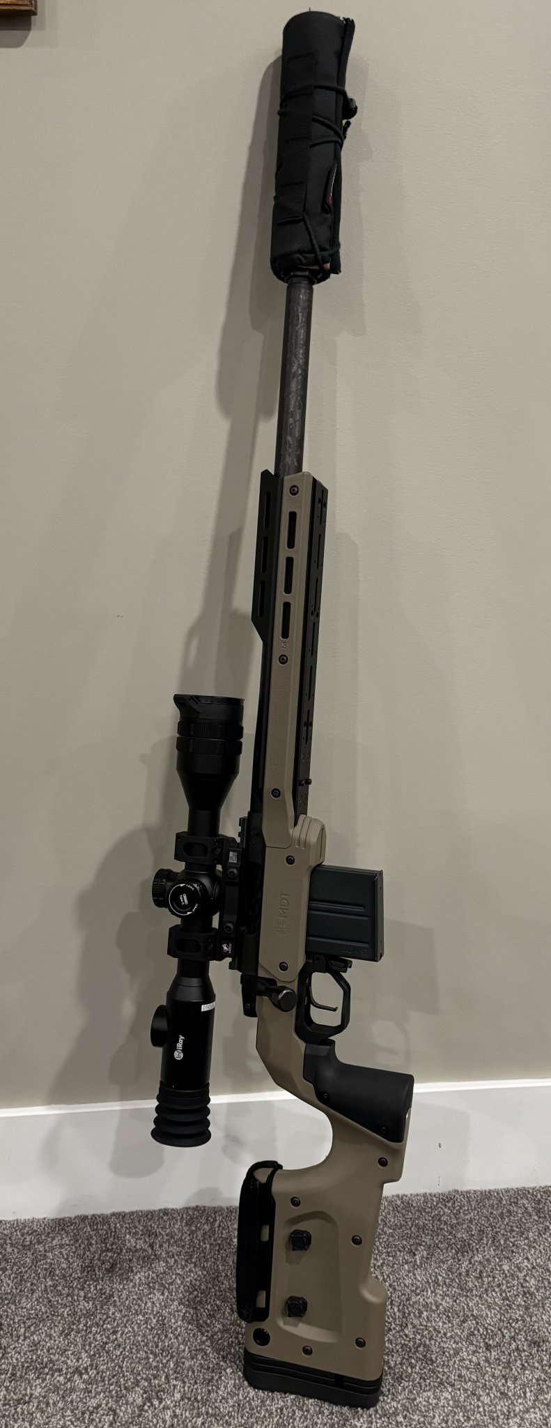

Best pic I have at the moment. I just switched the rifle from a manners LRH into this XRS with enclosed forend.If anyones got a 22-250 in an mdt XRS chassis, or any caliber for that matter, with a 20” CF barrel, post a pic, just trying to get some visuals. Thanks!
BEAUTY! What’s the contour? Diameter of barrel before the supressor, and by chance have any pics of it without supressor ?Best pic I have at the moment. I just switched the rifle from a manners LRH into this XRS with enclosed forend.
It’s a Terminus Apollo, 6cm 20” proof carbon. 14lb 6oz with 8” steel can, 10rd loaded mag, and thermal.
It’s a Sendero contour. That’s the only pic of the gun I have at the moment.BEAUTY! What’s the contour? Diameter of barrel before the supressor, and by chance have any pics of it without supressor ?
Okay thank you. If you happen to end up taking more pics without suppressor, I’d like to see emIt’s a Sendero contour. That’s the only pic of the gun I have at the moment.
