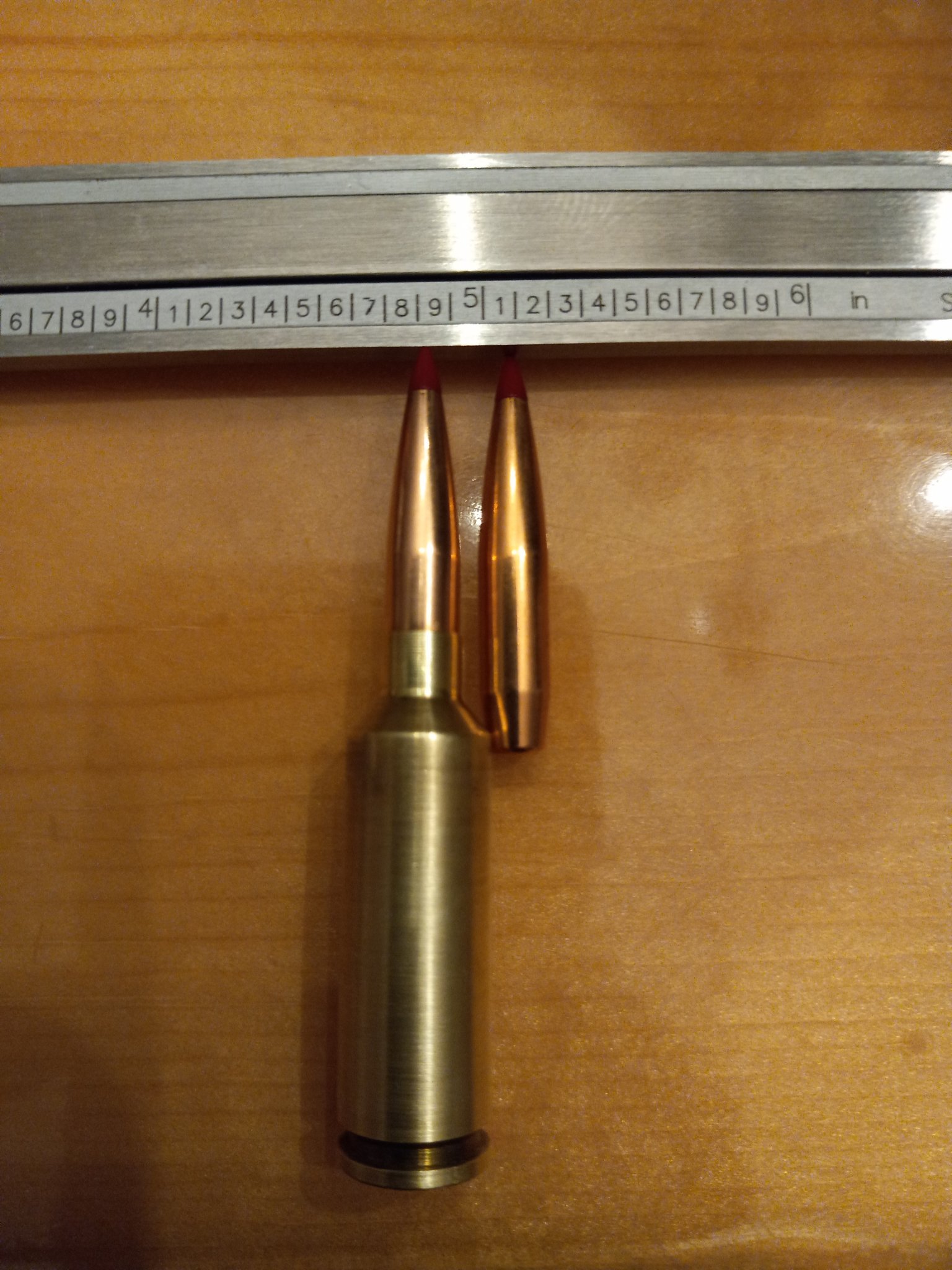

The 88 ELD will be pretty far down in the case with 0.050" FB... Now you can have a shop throat it out for you very easily. Takes all of a few minutes to do.... So thats an option...
I had good luck with my first barrel with a standard 22BR reamer, .050 fb and .252 neck. The next barrel I had chambered with the same reamer, I had stiff bolt close and open due to the tight neck. There is a local smith that has a .100 and .253 reamer. I am tempted to have him set back my original barrel that has 1800 rounds on it and see if .253 is big enough. If I were to order a new reamer, it would be .100 and .254 or .255.
Thanks for the perspective there, I think I will have the freebore extended out to the 0.100”-0.130” range. Maybe I can find a shop with a newer reamer too.
@Deep South Tactical has mine, 0.255 neck and 0.130 FB. Reamer’s brand new, they’re gonna cut my chamber soon but happy to loan it out for a minor wear-and-tear fee.

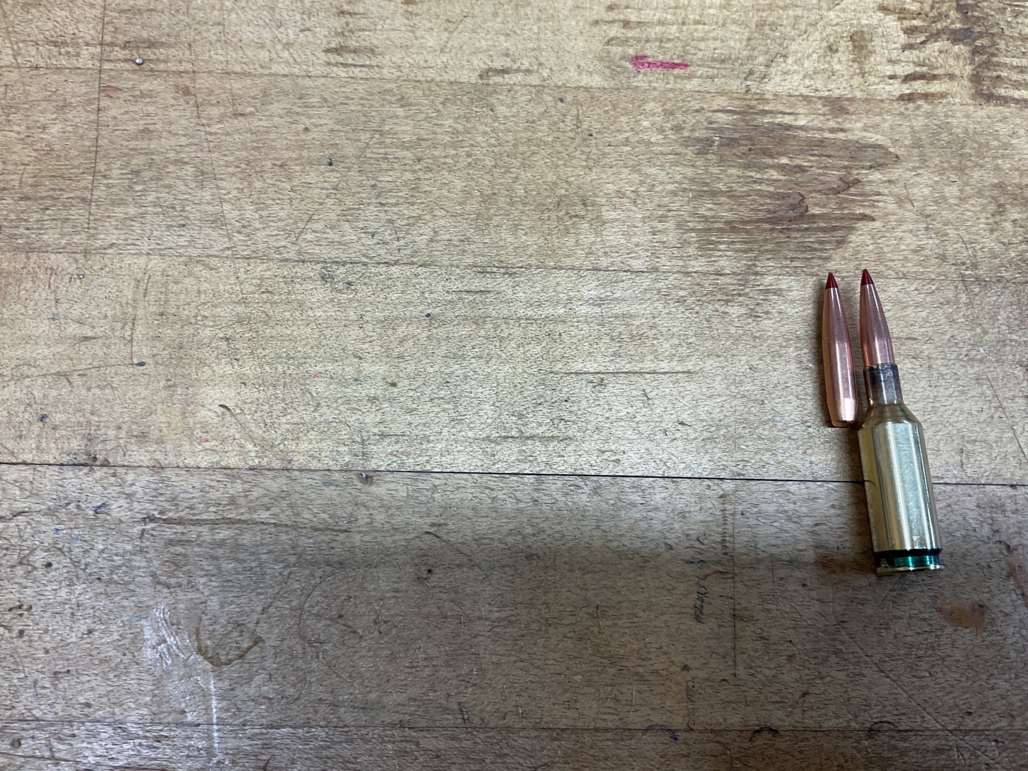

i had JGS make me a .255NK and .130FB reamer. The 88’s still sit well into the neck. a .150FB would have worked as well.
Remember, rule of thumb is you want at least bullet diameter worth of bullet bearing surface engaging the neck... So you want at least .224 of bearing surface engaging the neck.....

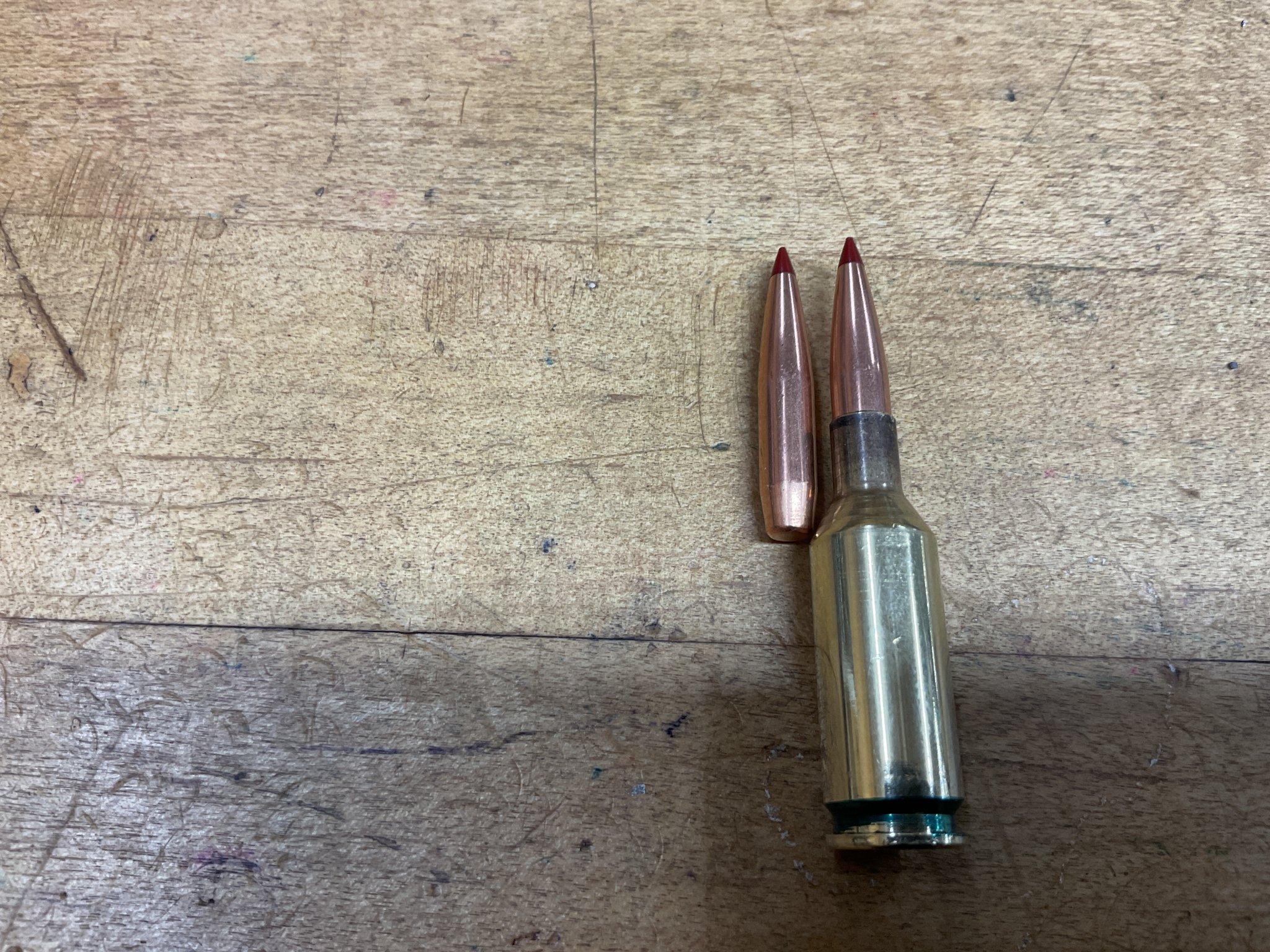

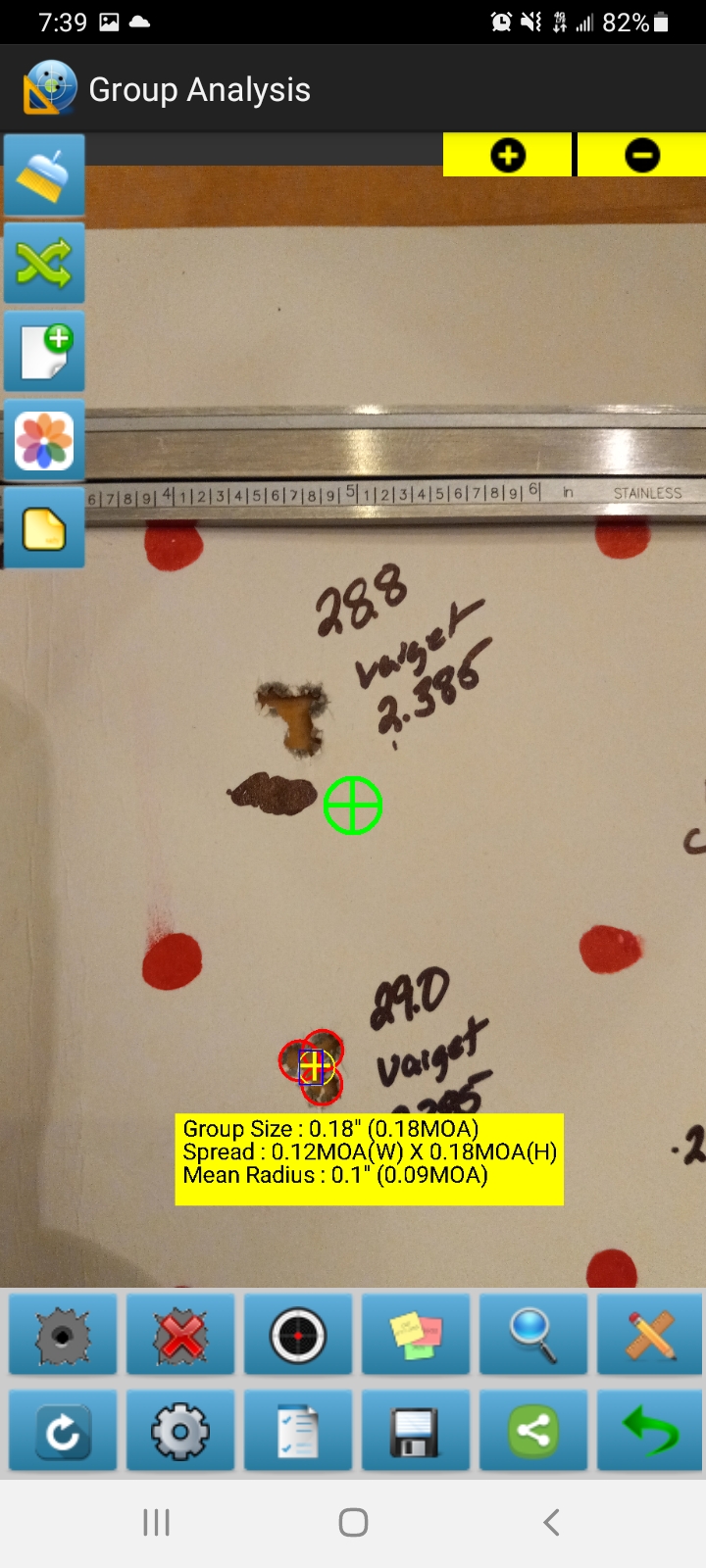

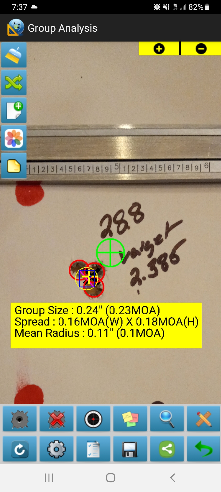

here’s what it looks like at .020” off.
