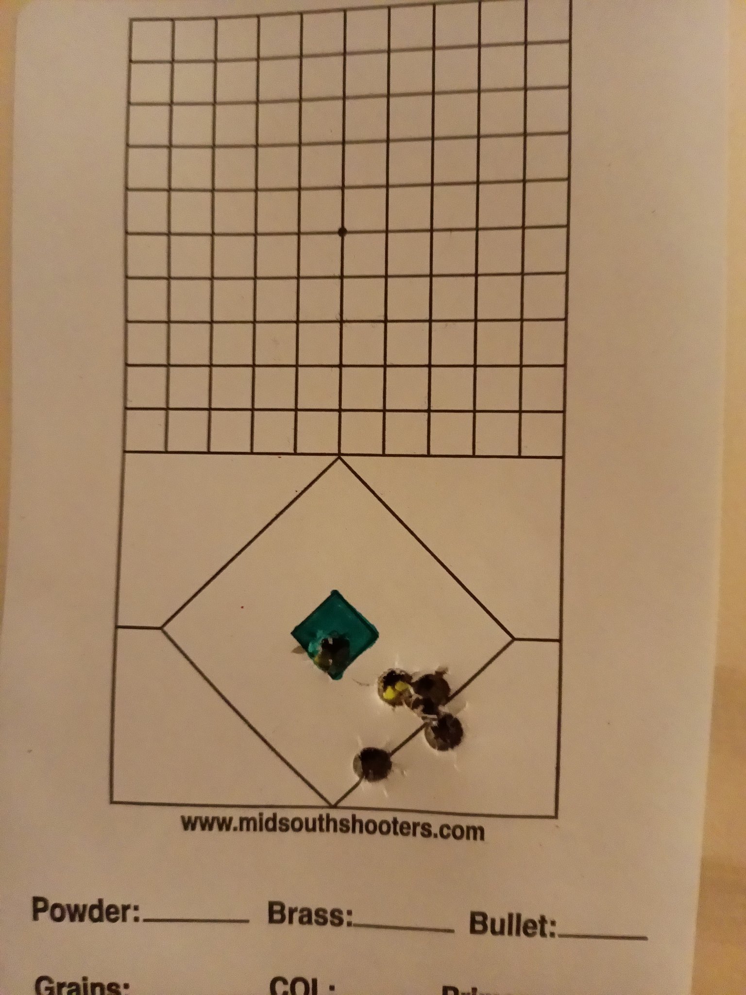

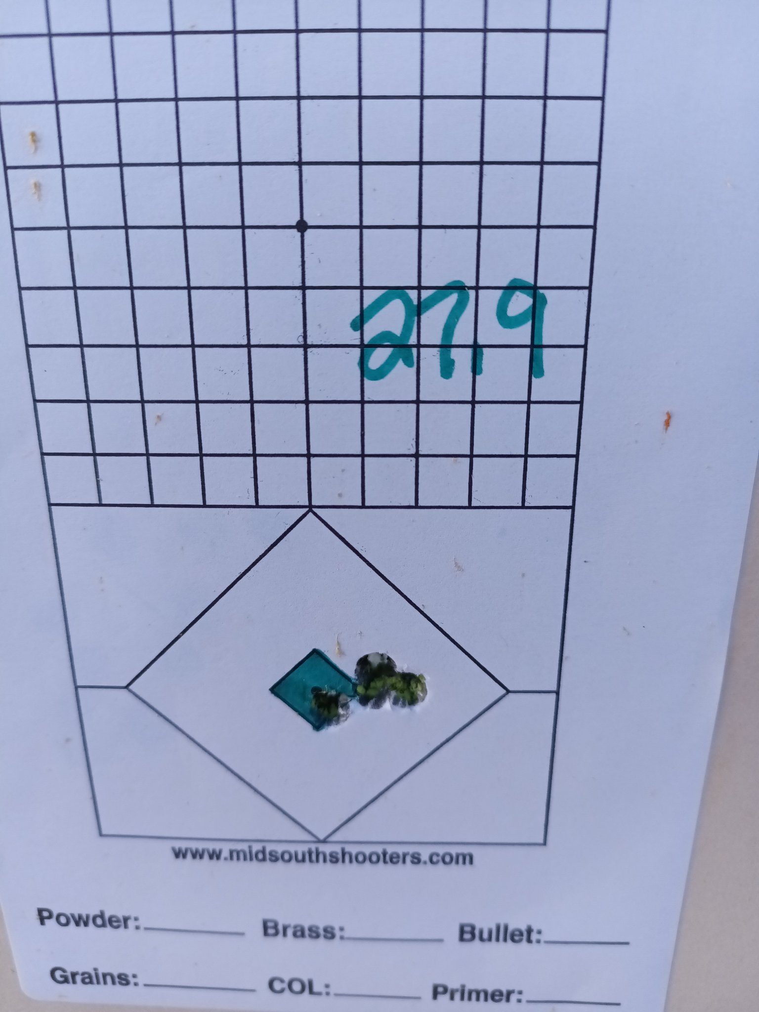

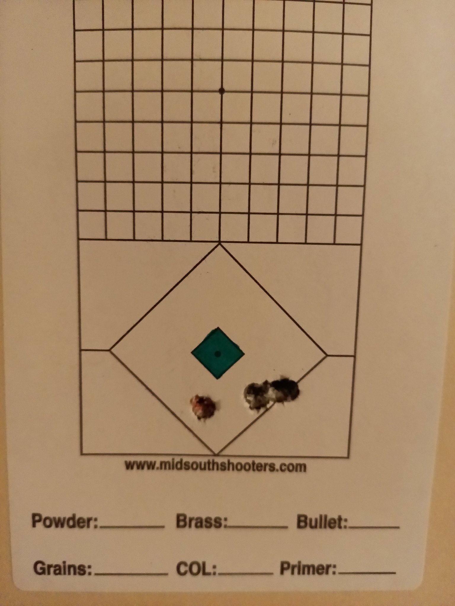

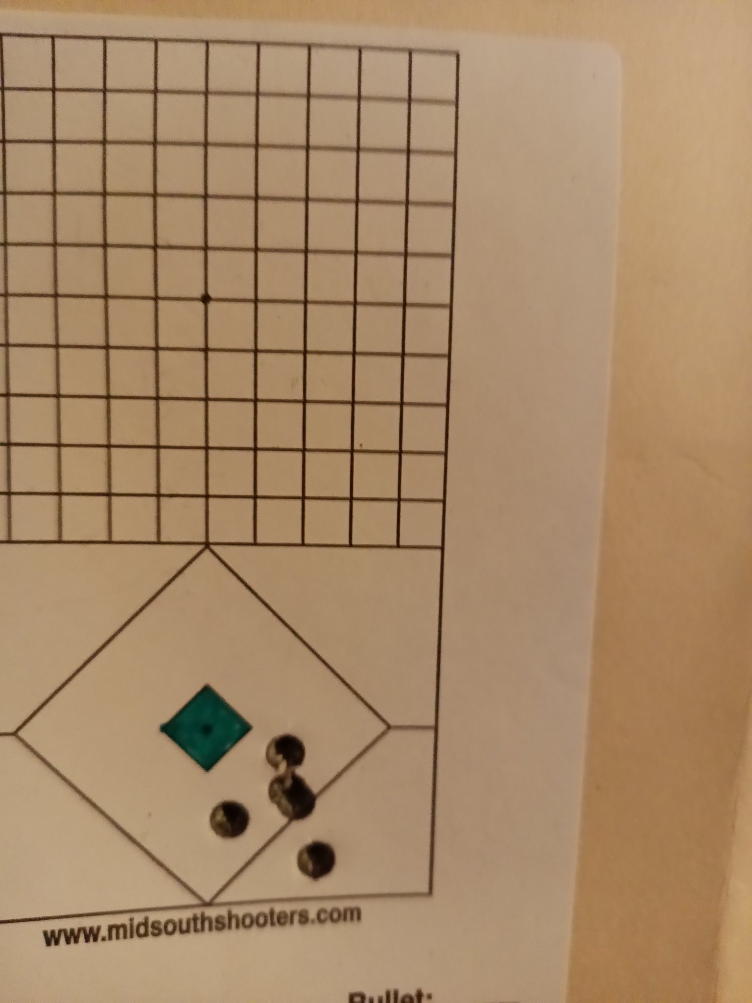

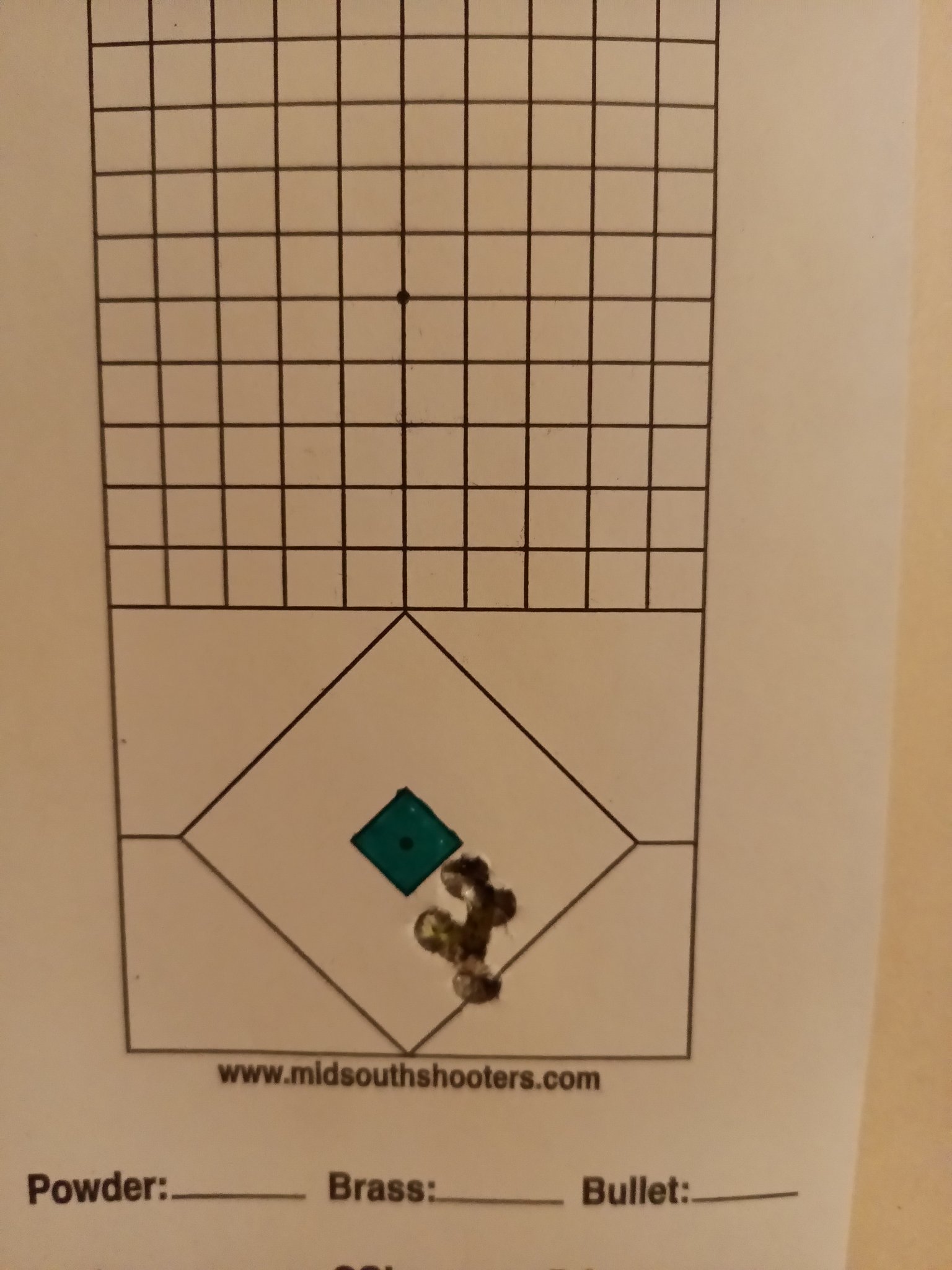

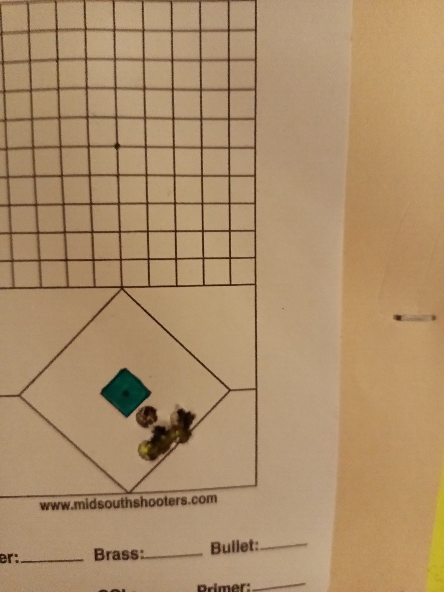

Got out today to play with some 80's over H4895. IDK why I didnt test H4895 first, its my go to 6BR powder with super low SD's, higher velocity per charge weight than Varget and is super accurate.
Loaded up 28.0-30.5gr in 0.5gr increments with both Berger 80 VLD and newer pointed 80 SMK. The 80SMK shot awesome, just like they did in my 220TB with Varget. No pressure at 30.5gr primers looks great, bolt feels great so not sure how much higher I can go but over 3230 @ 30.5gr.... SD's were all 5 or less across all the charge weights. Really like this H4895 / 80 SMK combo...
The VLD didnt shoot so great but not terrible. Because I have 0.100" freebore, the 80 SMK were jumping 0.060" and that still only had half the neck engaging the bullet bearing surface. 80 VLD also had half the neck engaging the bullet bearing surface but that was 0.008" off the lands...
80 SMK - H4895 OCW @ 200yd
80 VLD - H4895 OCW @ 200yd
