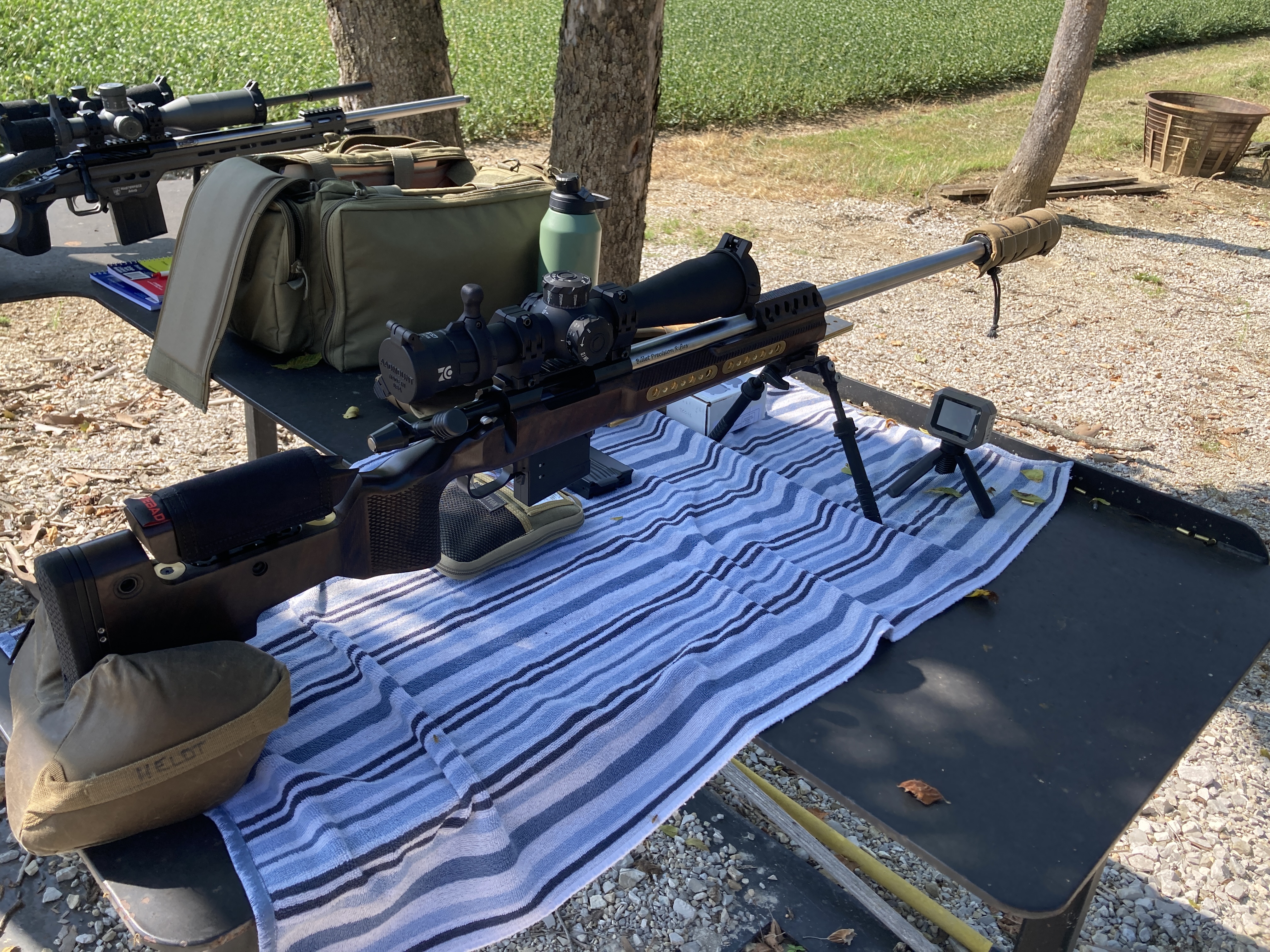

New 22BR setup chambered by Billet Precision Rifles. Did some seating depth tests with 85.5’s using 29gr Varget (avg 2,950). Definitely some speed left to go, but don’t see the need. Fun round to shoot! This 4 shot group was .080 off of jam.
