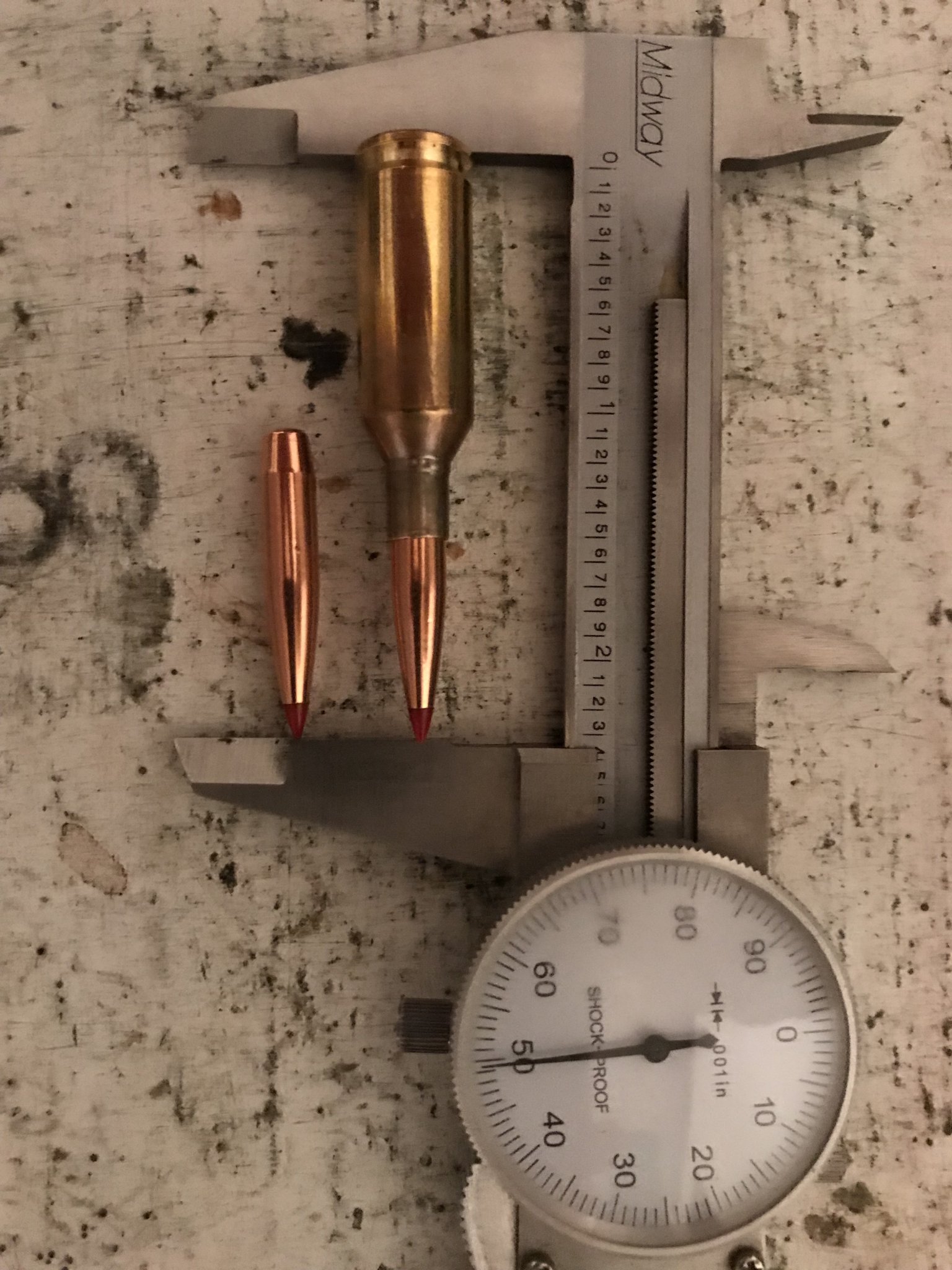

88's touch lands @ 1.767" bto

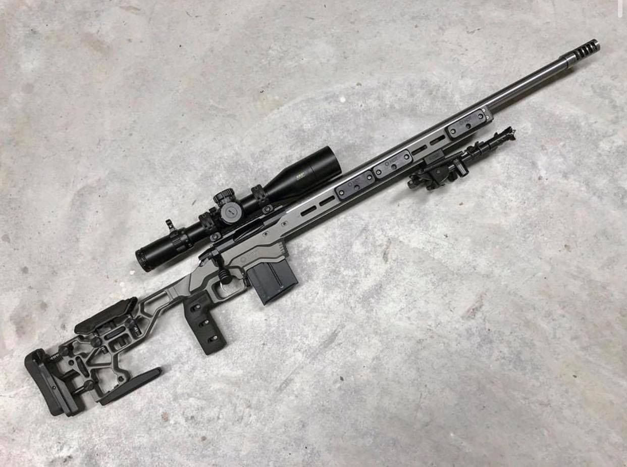

Well I finally got my rifle together. 24" Barlein (chambered and shouldered by Bugholes), RV contour, 1:7, Origin, KRG Bravo, Burris 5-25XTRII.

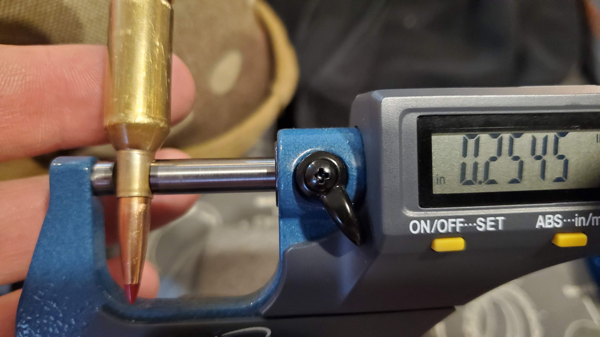

I fretted neck diameter (supposed to have a .255" neck) as I wanted to be at .252" loaded. I played with my neck turning kit on Virgin Brass and finally just figured I was overthinking it.
I took the 7 cases on whose necks I had been playing with, loaded 30 grains of LeverRevolution and a 450, seated 88's to 2.370" OAL (.080" throat) and went to the range. I ran 3 over the chrony at about 12'. It read 2924, 2961, and 2904. The spread could be due to the loads, the fact it was raining on my chrony, or the fact it's just a cheap shooting chrony, it didn't really matter, I just wanted to be sure I was at or below 3000fps, unsuppressed. Temp was around 65-68 deg., FWIW. Sighted in at 100 yards with the other 4.
I sized 25 necks down on a Redding FL sizer (took the expander ball out, sized down, then ran the necks back UP on the expander ball) and left a slight shoulder on the neck (.050-.060 or so). This did make them a bit tough to chamber, so I'll try do a bit less shoulder on the next batch.

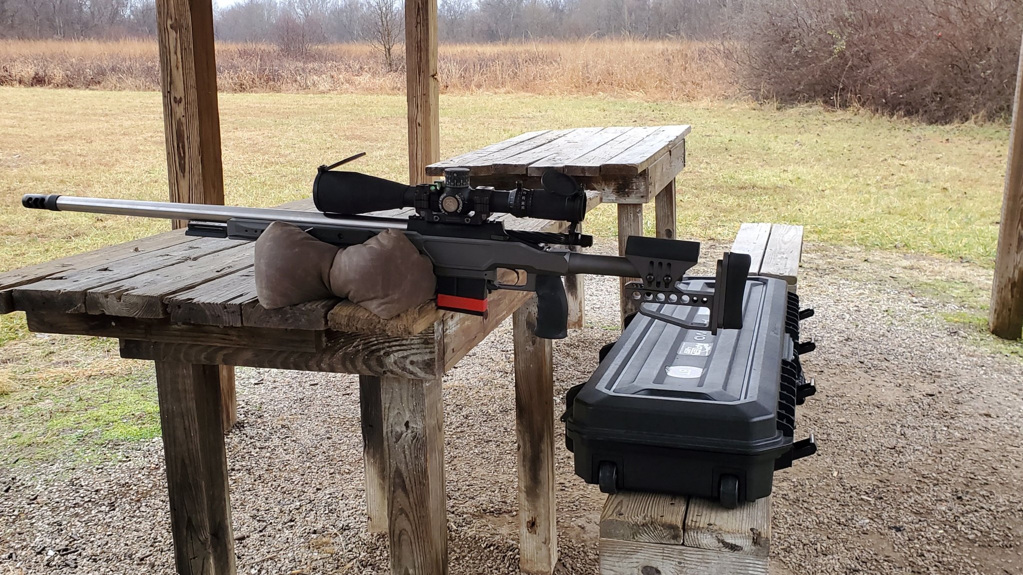

Went to a friend's farm yesterday where we had our annual muzzleloader and rifle sight in. Broke out the .22BR and it put 5 rounds into two holes for group that looked a touch under .5" (100 yards).
The only issue I'm sorta concerned about is I've a slight ejector slot mark on some of my brass (about half the fired loads). I really doubt the loads too hot, I've got an A Bolt .25-06 that'll put an ejector mark on factory ammo, so I'm not sweating it too much.
Thus far, I'm in love. I know that one, five round 1/2 inch group at a hundred doesn't mean much in the company that's on here. But for the first load I spitballed down the barrel, I'm pretty tickled. Gonna get a few more loaded and try to get it out to 600 and possibly 1000 yards next week.

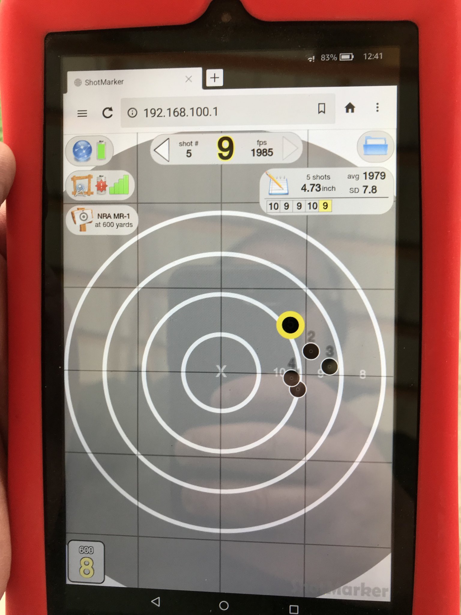

Took mine to the range last week. I'm pretty sure the last one was me. The first four were at 2.96" at 600 yards. I think I pulled the top one a smidge high for 4.73".

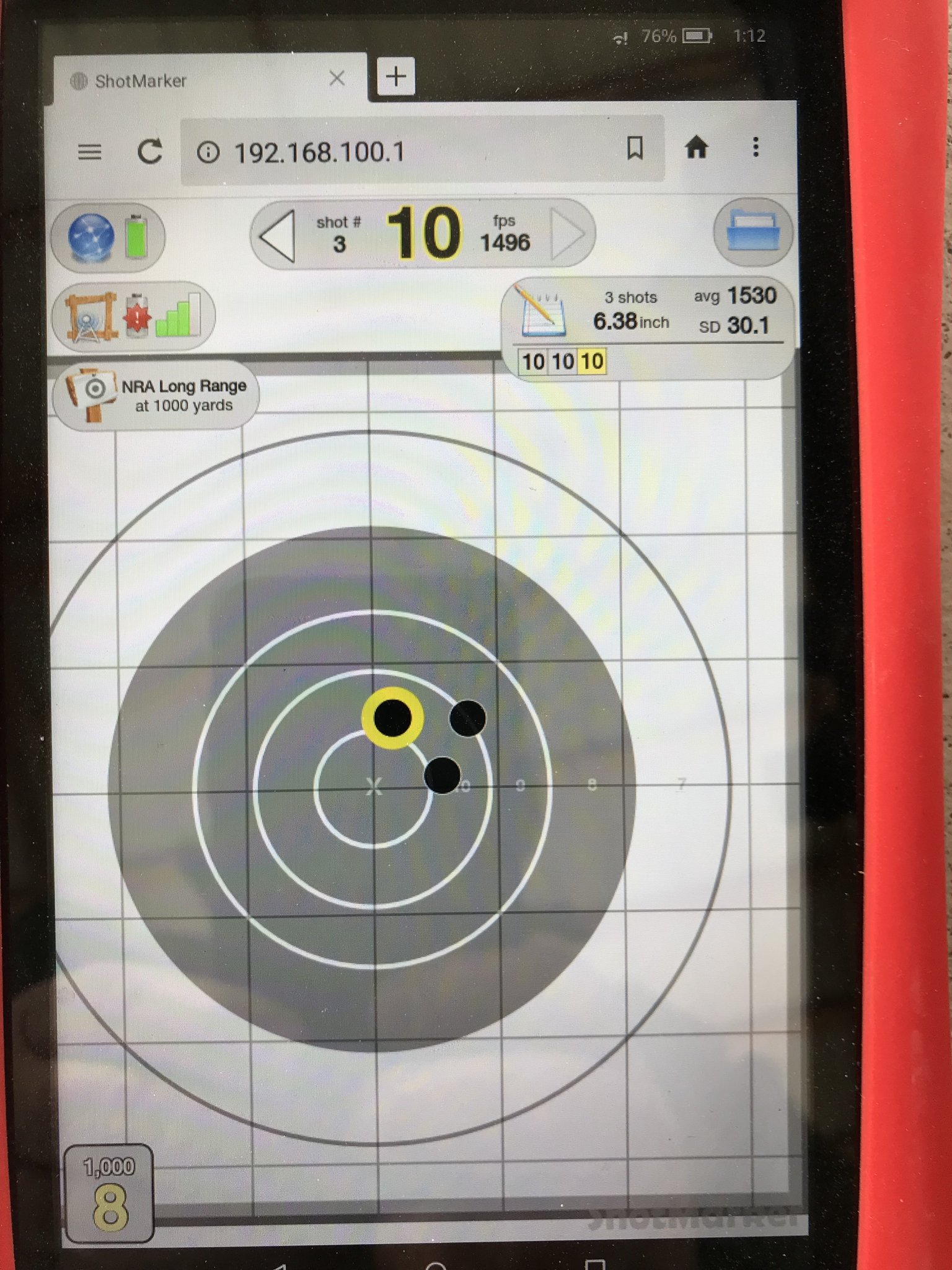

Then I went to 1,000 yards for the first time ever. I had five rounds left. Shot one at the wrong target (dumbass), but fortunately, no one was on it. Then I pulled one way low. Three rounds left. I finally got my crap together and ran a 3 round group. 3 in 6.38". I'll take it.
A few takeaways; 600 is one thing, but this noob found out that 1,000 is a whole nother ball game. I spent several rounds at the gongs before firing away at their electronic targets and figured out my dope sheet was about .3 mils low. The wind (which was pretty whippy that day) is a whole nother ball game at 1,000 as well. For the group, I cranked it a half mil left, and watched the flags for it to die down just a bit, then fired.
I've got a lot of work to do, but I'm loving it so far.

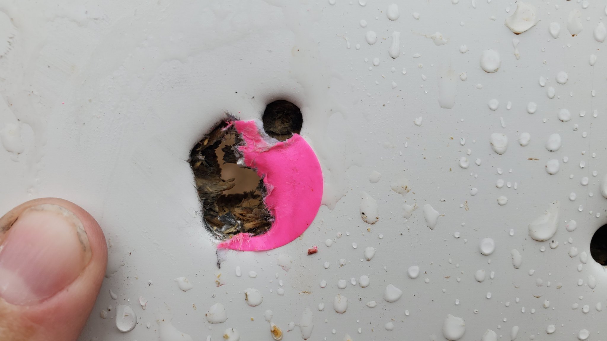

Oh yeah, it works on coyotes too! 120 yard chip shot. An 88 high on the shoulder. No smoking crater, but still dead before she hit the ground.

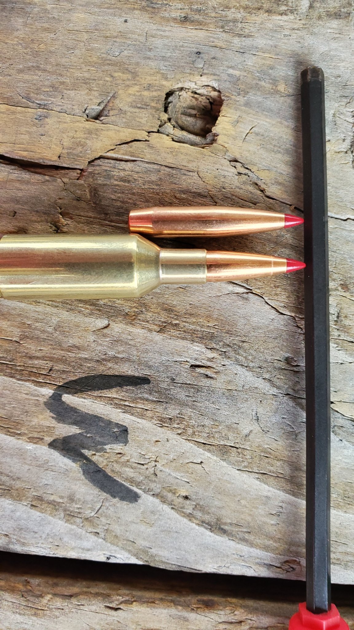

Trying to decide if I should start with the .050 freebore the reamer comes in at.
Or load some dummy rounds with the bottom of bearing surface little below neck/shoulder junction and have the chamber throated for that.
Thoughts? Going to be running berger 85.5 hybrid and hornady 88 eld
Thoughts?
Thoughts?
I have a reamer with a .150 freebore which seems to be perfect for the 88 grain bullets to sit just above the neck/shoulder junction. You'll probably want your freebore extended. I also shoot 80 grain bullets in the same chamber and because the 22 BR has such a long neck the bullets still have plenty of seating depth when they are out by the lands.

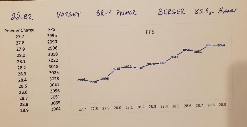

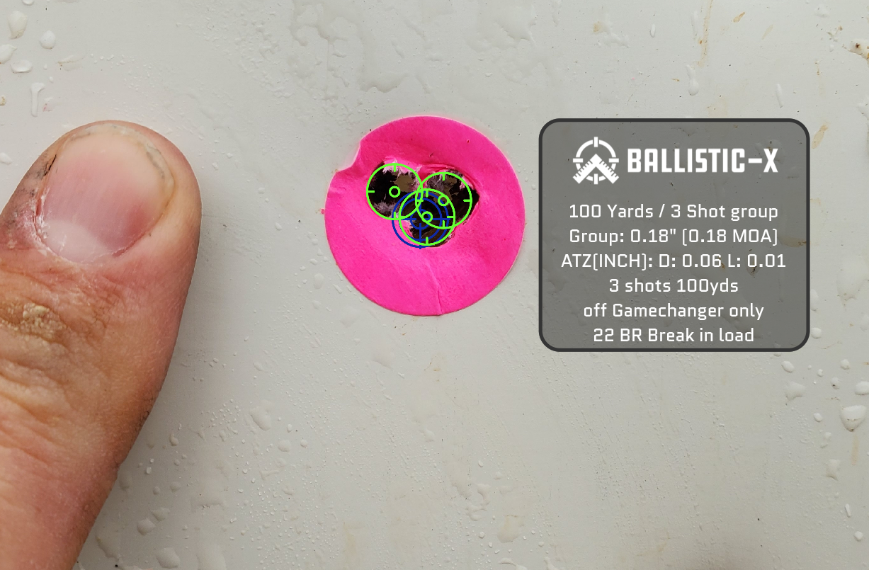

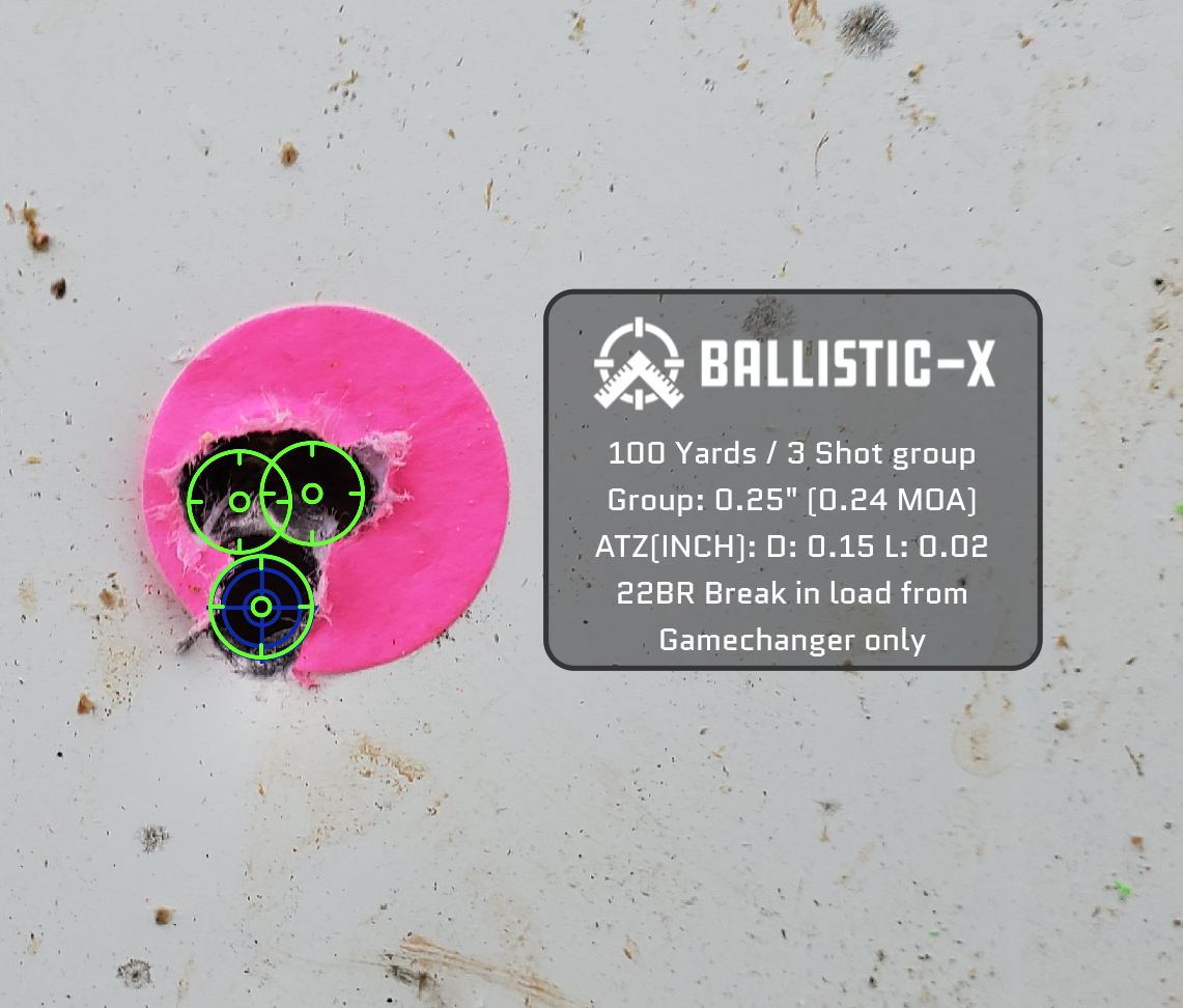

I just got my 22 BR up and running Monday. .255Neck with .100FB, Krieger 7t 4g HV at 26", Kelbys Black Bear Tactical action in a XLR Envy. I sized the new Lapua 6BR brass with a standard Forster Die. Once I had the barrel I did not have enough shoulder bump to get a free bolt drop. I was able to get just enough bump from a Redding 22 BR die with the bushings removed. I assume there was a small doughnut at the neck shoulder junction from the initial sizing that was making contact because a 1x fired case needed .003 less bump then the virgin brass. I was able to get a free bolt drop (.002-.003 bump is what i look for) with the Forster die on the 1x brass very easy.
I initially loaded 50 with 28gr Varget, CCI 450 and Jumped an 88 ELDM .020 for the start of the break in. Shots 41-50 we at 2884fps, 100yd groups were great. I do most of my break in positional and only fired a few from a bipod/bag combo. I then loaded up 50 more with 28.5Gr Varget and shots 81-90 were at 2958fps. I had 5 loaded up at 29.0 for curiosity and shots 101-105 were at 3017fps with no signs of pressure. The fired rounds were not much larger than my loaded rounds and a bullet would not go back into a fired case. I returned home and sized 5 fired cases . I then turned 5 necks and loaded them with 29.0gr of Varget and went out to test them again. Pretty much a 1 hole group again but the turned necks of the 1x fired brass (shots #111-115) were 3011fps 6es/2.4sd. I now have nearly 200 pieces of Virgin brass loaded up with 28.5gr and a little over 100 turned and ready for load development. The 88s are way down in the case but are shooting great. I have 200 of the new 85.5 Berger coming this week. Would have more to report but a sick kid has given me plenty of press time and not much trigger time.
... I had 5 loaded up at 29.0 for curiosity and shots 101-105 were at 3017fps with no signs of pressure. The fired rounds were not much larger than my loaded rounds and a bullet would not go back into a fired case. I returned home and sized 5 fired cases . I then turned 5 necks and loaded them with 39.0gr of Varget and went out to test them again.

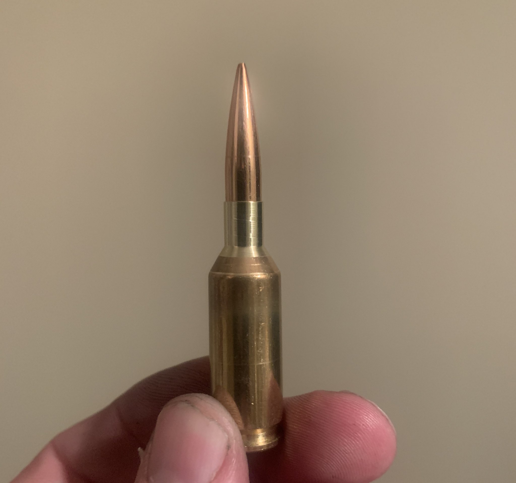

Tried some 85.5s tonight. The bearing surface stays above the neck shoulder junction with these. I jumped them .020 and will do more testing later on. The 85.5's with BR4's ran around 50fps faster for me than the 88ELDM's with CCI450s with the same charge weight.
