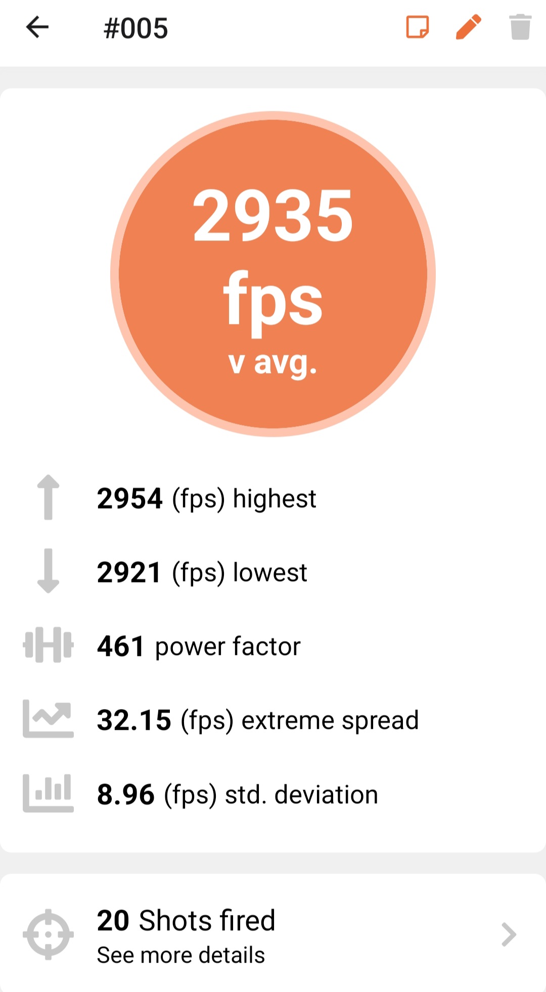

Here my 22BR 90smk results after switching to 7.5 twist. Initial testing with same everything as the MW 7 twist. I couldnt shoot a group over 3/8" and my final load shoots in the 0.1's.... You can see I have a low node at 28.7gr which is my go to nice easy load which sped up on this new barrel to just over 3000.... I have a high node there at 30.2gr which sped up to right at 3100 but thats too fast for me. My goal when I went to 22BR was 90smk right at 3000fps..
Bartlein 7.5 90smk OCW
Bartlein 7.5 90smk Seating Depth Test
