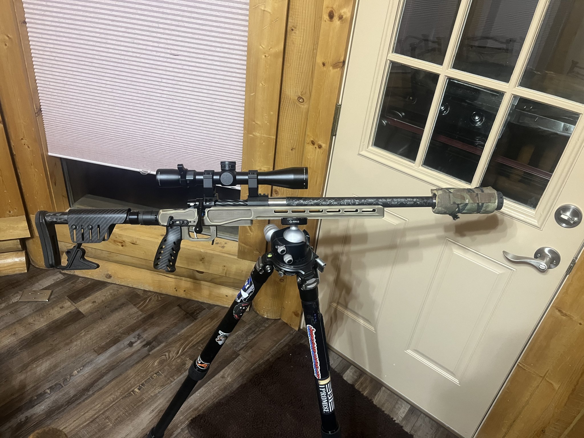

Picked up my first 22br this weekend and got to the range to test it out today. Kelbly nanook, 16” proof 1-7 chambered by Fischer T&C in a XLR element magnesium. Came in around 7# 12oz without the can.
Used N140, 62eldvt and 75 eldm. I hit pressure with the 62’s at 32.8gn (3267fps) slight resistance on bolt lift. 75s I hit bolt resistance at 31.8gn (3082fps)
I only shot 2 shot groups to check velocity and pressure so doesn’t tell an accurate story on accuracy but seems to have potential. I struggled to shoot the gun with as light as it is. Going to load it up with weights to help with testing next time.
