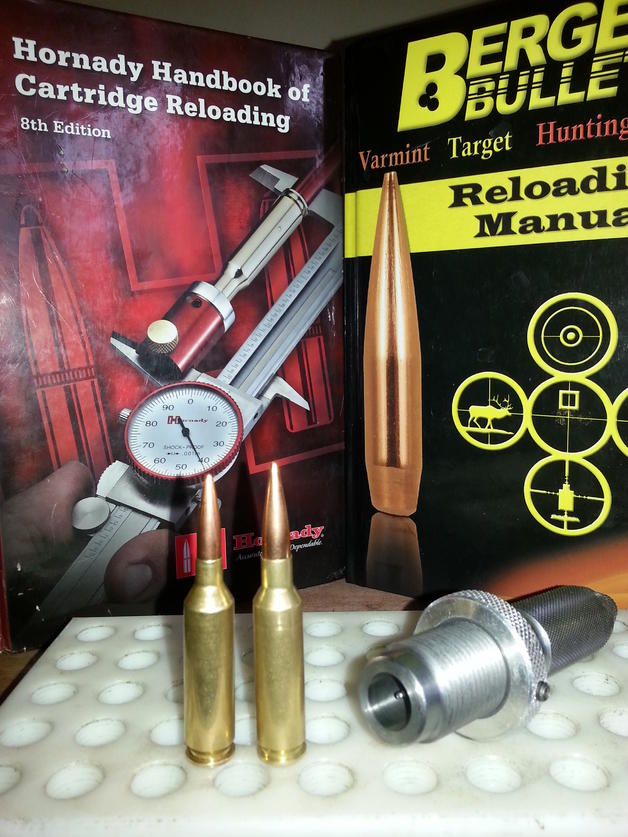

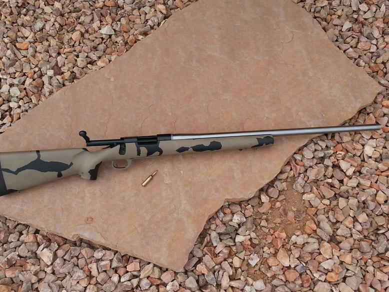

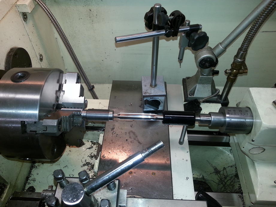

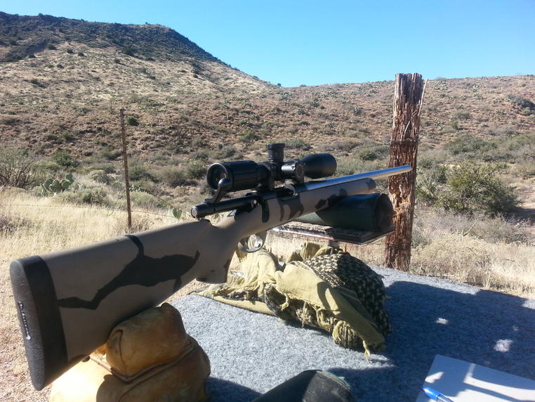

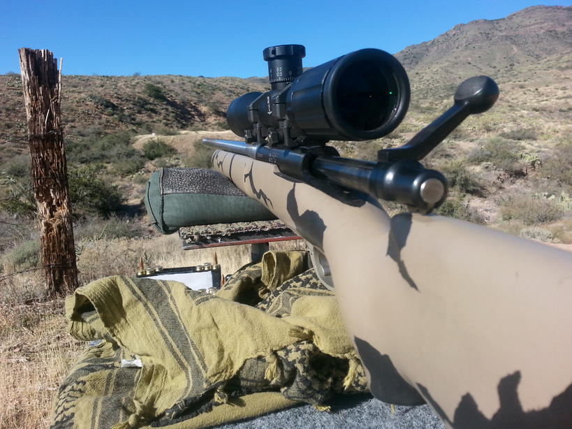

Started building my new .22 creedmoor. (.224/6.5 creedmoor)

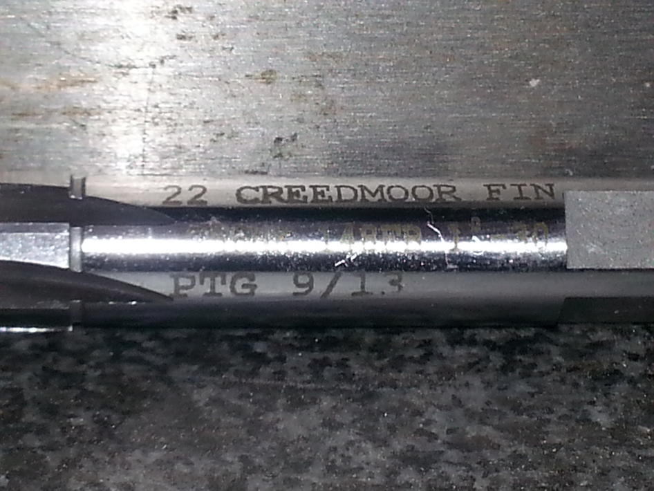

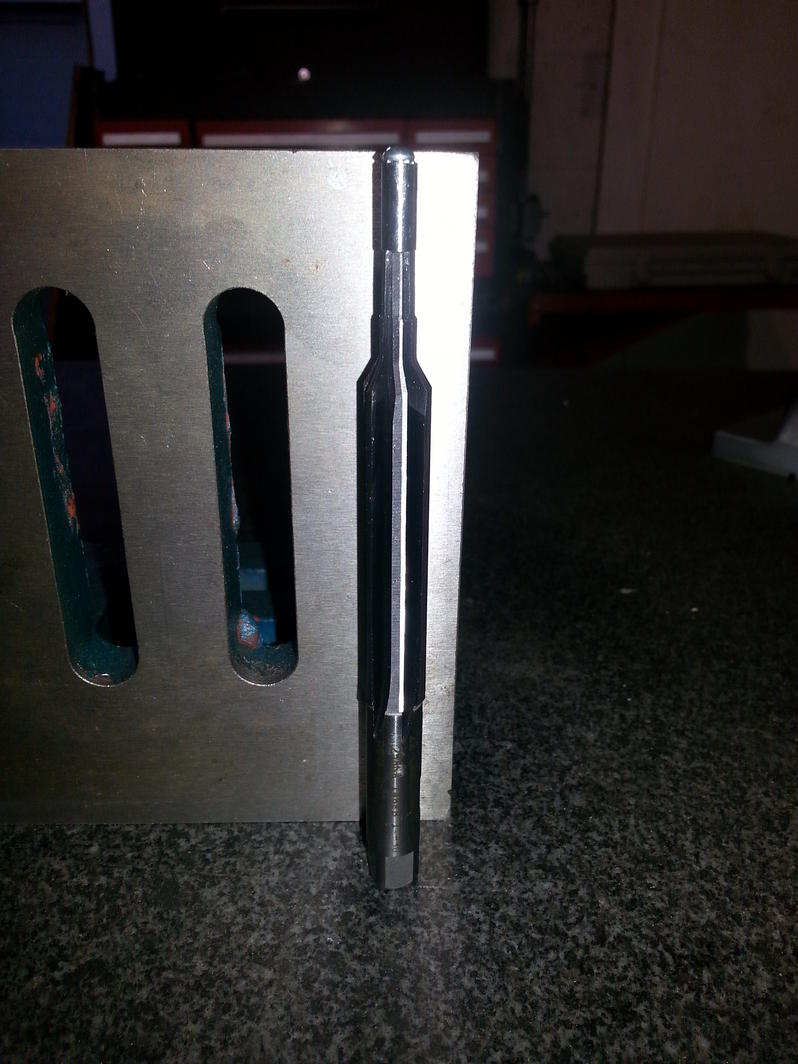

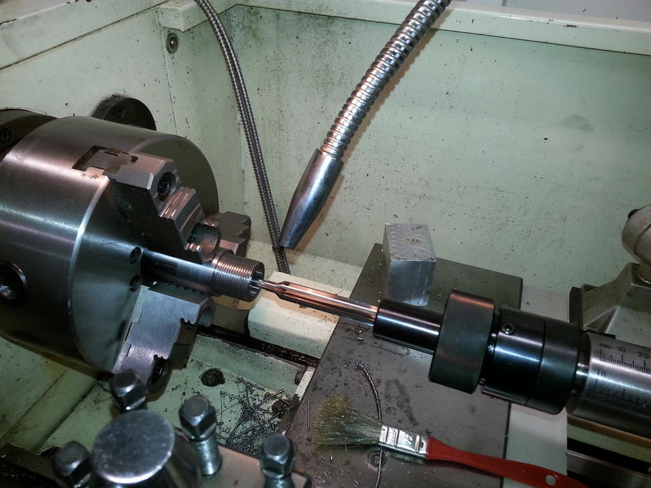

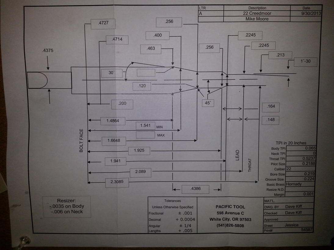

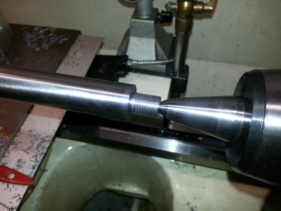

I had the pleasure of Dave kiff at Pacific Tool and Gauge build me up a finish reamer and full length die reamer for a .22 creedmoor. The main objective was to shoot the 90grn bullets at a respectable velocity and use it in various types of match style shoots/competitions as well as a hunting rig. According to Berger's 90.0 grn Ballistic Coefficient (
.551), velocity running around 3100fps-3200fps and a modern match grade case geometry to boot, the .22 creedmoor became a very intriguing cartridge. After running the numbers everything shows that it does very well in both trajectory and kinetic energy not to mention very little recoil.
Here is an example of the .22 creed against the parent 6.5 creed. Using the 6.5 and a 130grn berger running 2800 FPS drops about 8.0 mils vertically with a 100yrd zero and 1.7 mils horizontally in a 10mph cross wind with 734 ft-lbf @ 1k according to strelok ballistics . Under the same conditions the .22 creed with a 90.grn berger running 3100fps drops 6.1 mils vertically , 1.45 mils horizontally and has 676 ft-lbf on impact.

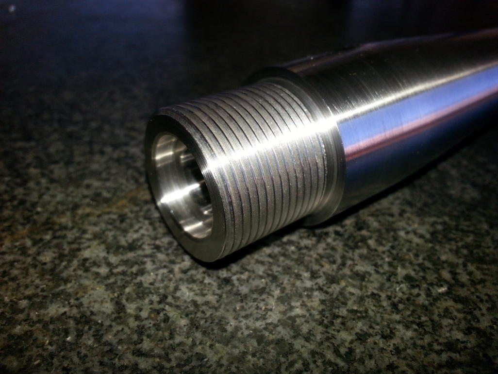

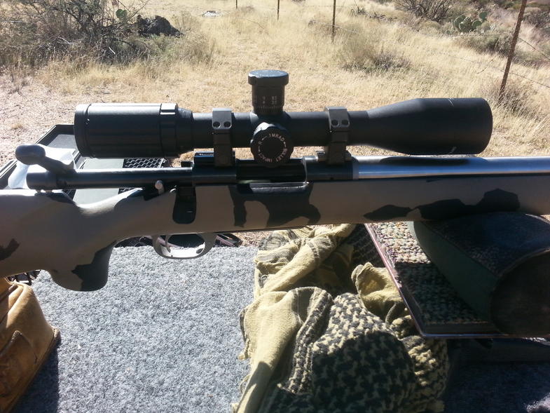

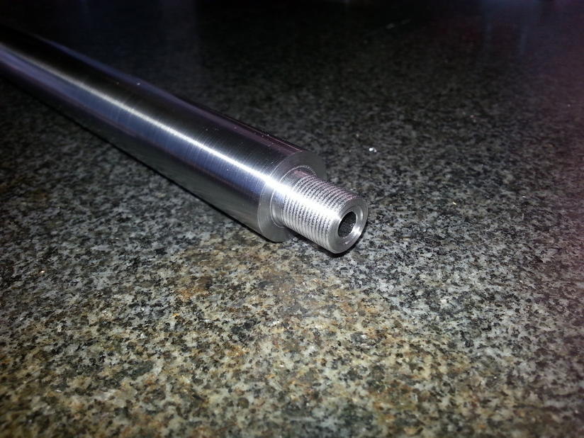

So far for testing purposes I have acquired the following... Remington M700 SA, PTG lug, Bartlien 7.7 twist varminter barrel finished at 26", jewel trigger, Custom K.B Precision Scope rail, H-S police Stock skim bedded and PTG BDL bottom metal. Started the build and should be ready for load testing over the weekend.
22 creed.jpg .22 creedmoor left and 6.5 creedmoor right

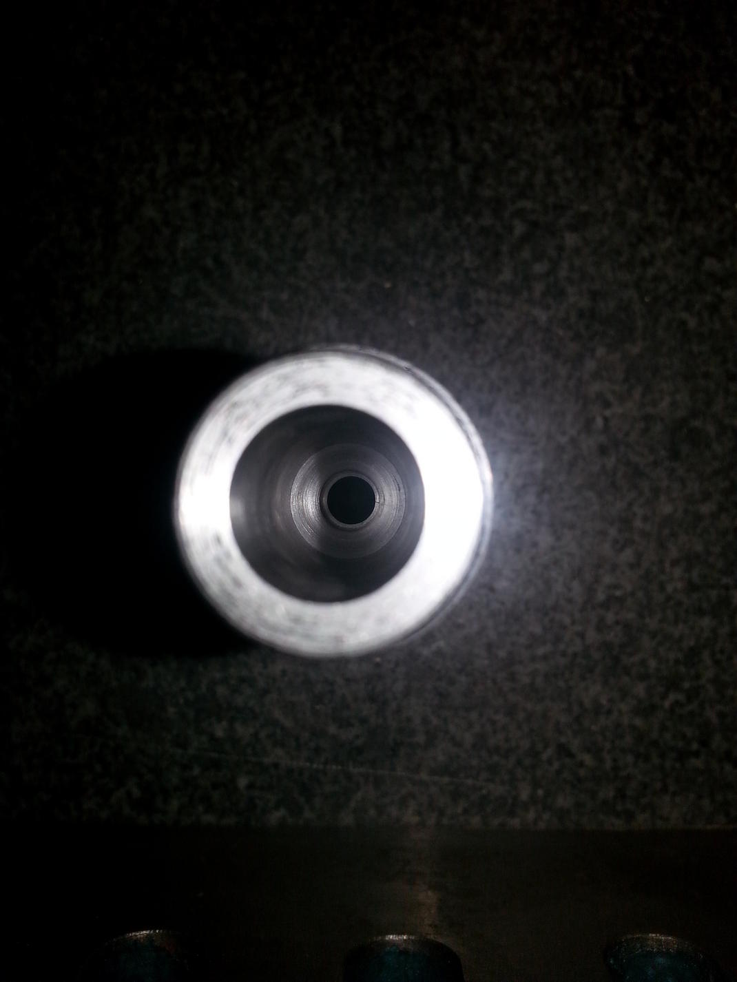

View attachment 19762finishing the FL sizing die
phone 066.jpgPTG removable pilot reamer
phone 063.jpg a look into the FL die

.22 creedmoor

Why did you go with a 30 Degree shoulder and not say a 35?
p.s. Im' shooting 140Berger VLD at chrono 2769 H4350. Corrected to 2900 per 900y target shooting 1/2 minute at 900y.
I wanted to alter as little as I could of the parent case and still achieve what the 22-250 couldn't. I looked at going with a 35Deg shoulder and shortening the neck length some but just not sure if there's a point to. For me it was very easy to take 6.5 creedmoor brass and strait neck them down and run with it. How many firing do you get out of your brass?

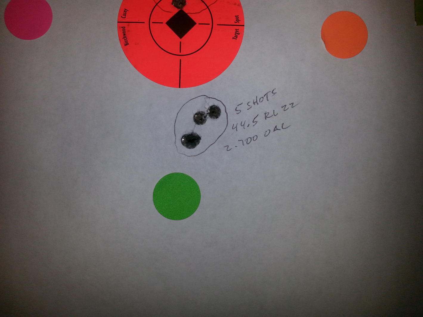

I have tested 5 different bullets. With my barrel twist rate I found that accuracy is not great with anything less then a 70gr bullet and no heavier then 80gr. My favorite load is the 75gr amax. It's been the most consistent across the board. I did have success with 62gr solids. But theta speeds were getting pretty high. Around 3670 fps. I'd say that will kill barrel life pretty fast.
