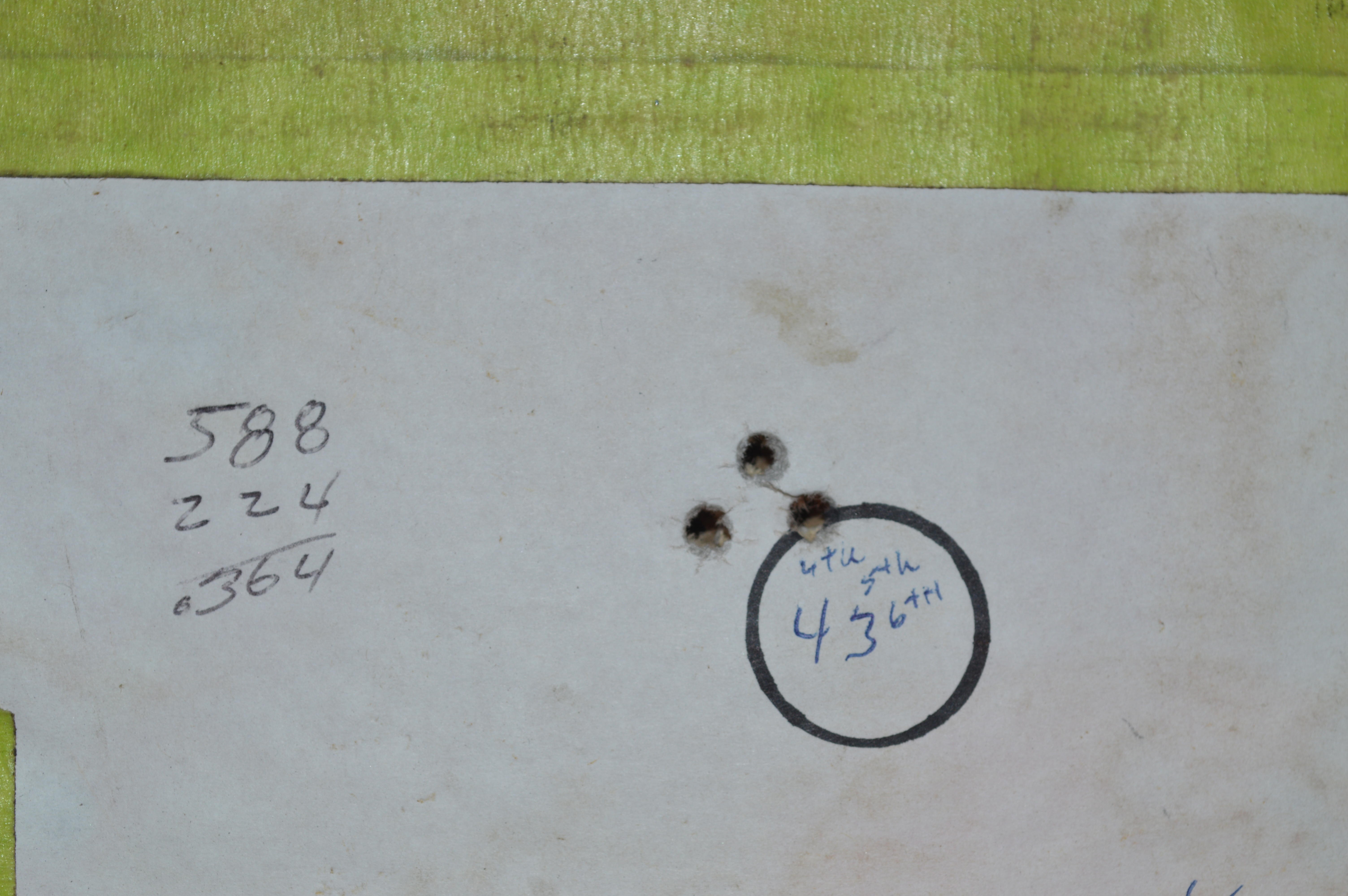

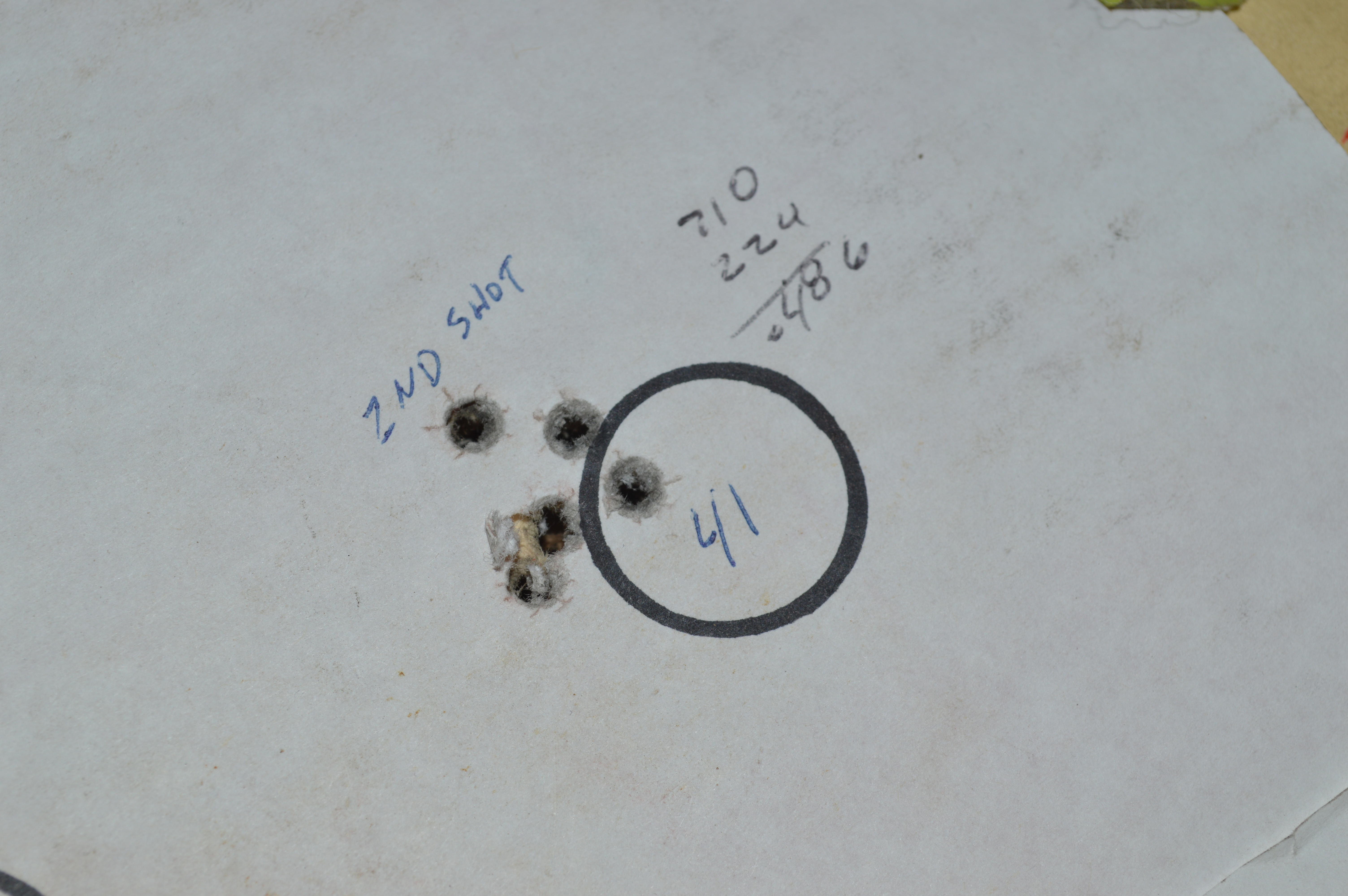

So far I have tested 69gnSMK, 77grn SMK, 80grn SMK,90grn SMK, 80grn A-Max, 80grn Berger VLD and the 90grn Berger VLD is on it's way after back ordering. Powders tested are H4350, H4831SC, RL-22 and RL-19 for 77grn,80grn and 90grn bullets. RL-15, IMR 4064, varget and H4350 were tested for 69grn and 77grn bullets. I just received the new stock :) it's in the AICS 1.5 now.

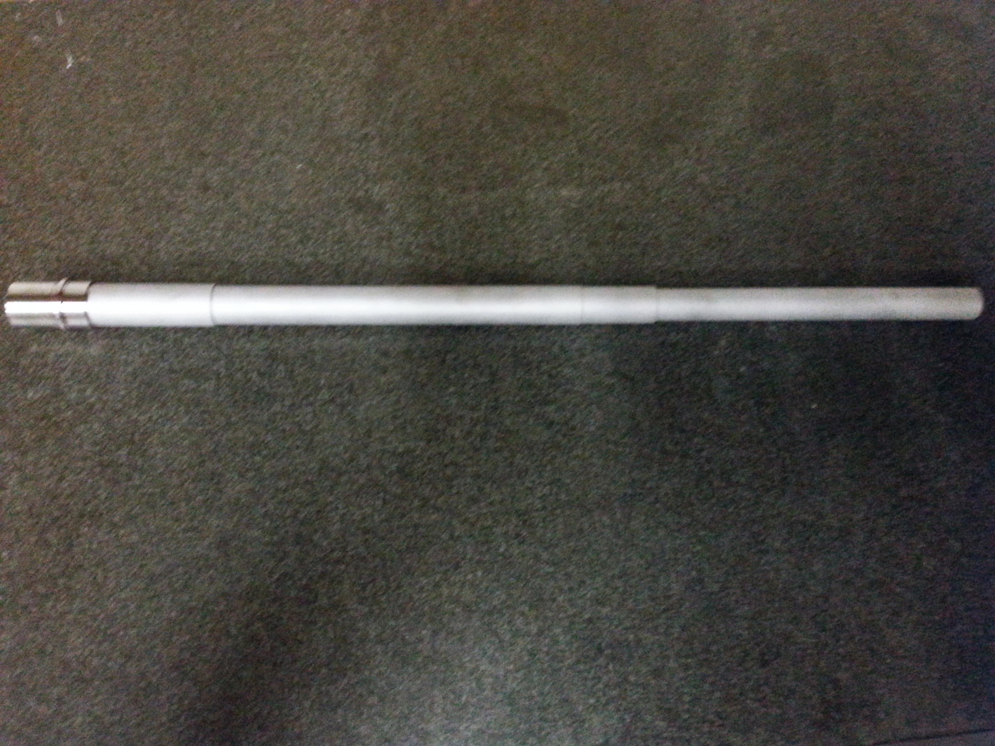

for 100 yards groups I would go back to the bench and rethink my loads. They appear to be opening up.
