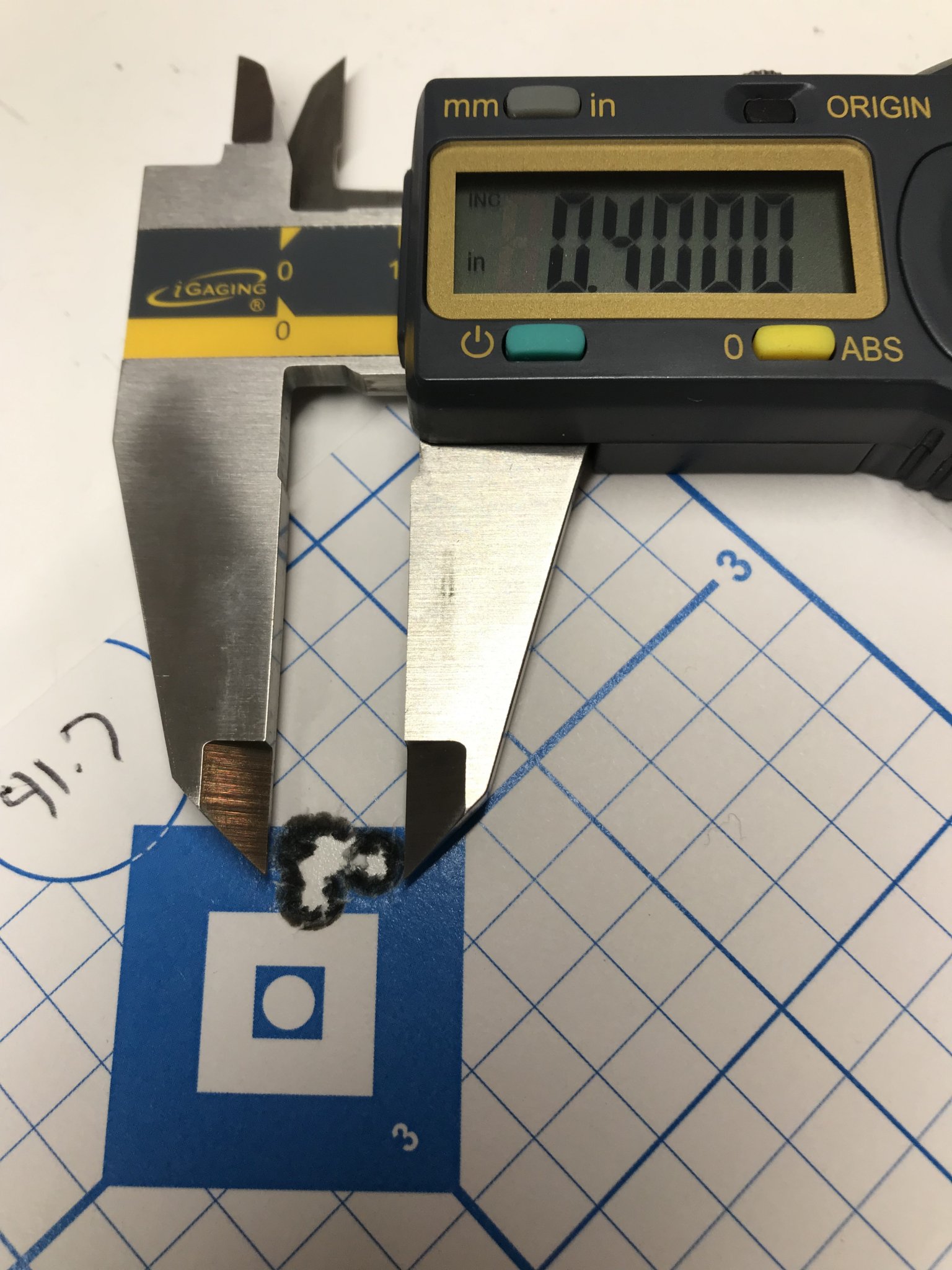

Settled on this load:
Alpha brass, 88g ELD-M, .02 off, 41.7g RL26, CCI 450
100yd. 4 shots, high .1 MOA
After doing a ladder and the barrel seems to have settled out I ended up with my final load below for the 95 smk

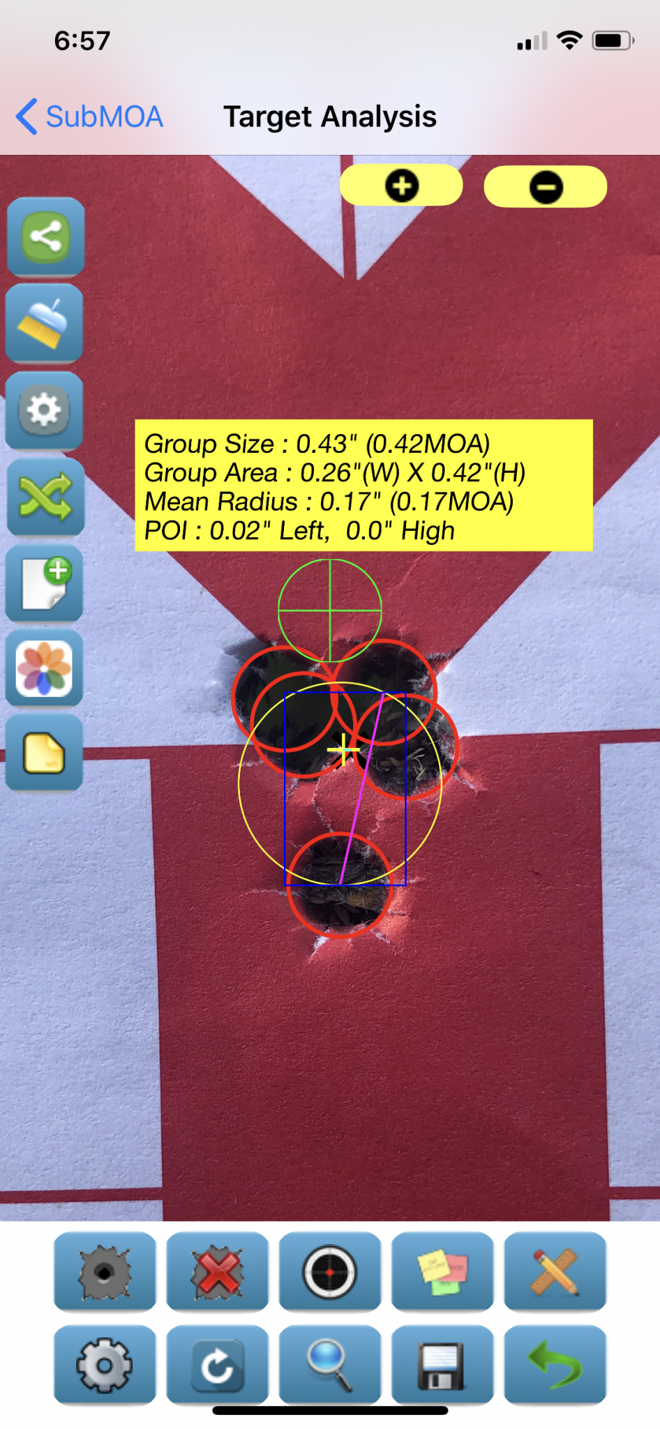

So I’ve got a PTG reamer .257 neck. .089 FB. Alpha LRP brass. 41gr H4350, WLR primer and a 75ELDM seated 2.100 ogive / 2.650 OAL. Bout .017 off the lands. .252 bushing. 3506fps SD of 6 for 10 shots. Bighorn origin action bedded with JB in a grayboe terrain stock . Krieger 4 groove 7.7 twist 25” rem varmint contour.. I had a bartlein that would NOT shoot under .75” no matter what I did. Switched to this Krieger and it’s been .5 or less since new !
Reactions: Trapper1956

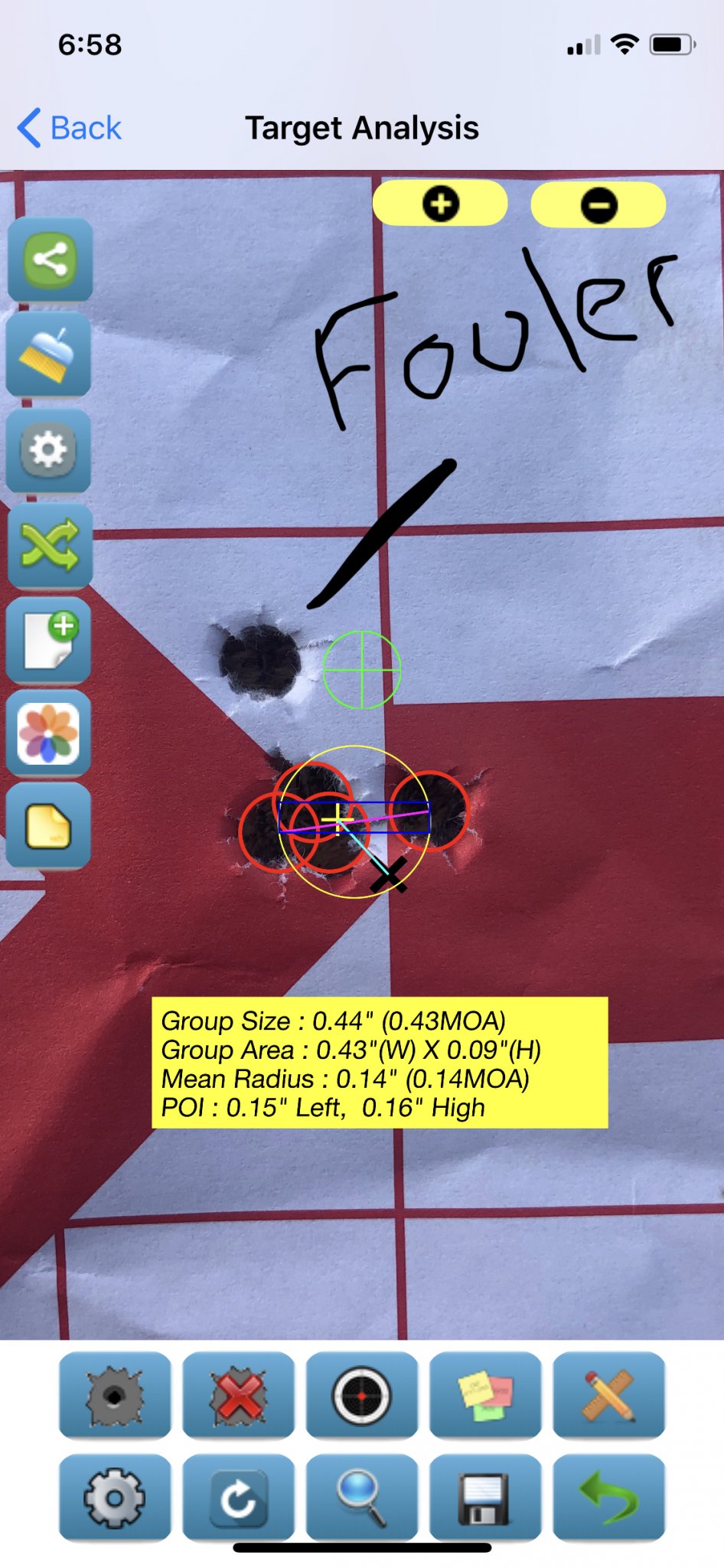

i think all "fouler" shots should be shot on another "spotter' target. They just ruin good groups. OR they make great excuses for a ruined group. He77, I have "foulers" on about all my groups.........
JK Dirtbiker...great rig. It is amazing but there are just some bad barrels which get out. My builder will send barrels back for free replacement if they dont shoot. it just happens. My smith did have to buy 2 new .22 creed reamers as the one he had was a tight neck and would require turning...not for me....plus if I ever sell it, no one wants to turn necks. Mine is .800 FB
9 shots from my rifle, got a good start on an accurate load. more testing to do
LOL yeah sometimes I shoot the fouler at the steel gong for that purpose! But these groups I was at my father in laws ranch and had no reactive targets so I just fired at the paper HAHA. My smith and I both built rifles with bartlein barrels back to back. Mine 22 creed his 6xc. Neither of them would shoot worth a DARN. Reallllly frustrating. He swapped to a benchmark and I bought this Krieger and they are both hammers now.. we need to send the Bart’s back and see what’s up. I have a bart 223 on a trued rem and it shoots tiny tiny groups

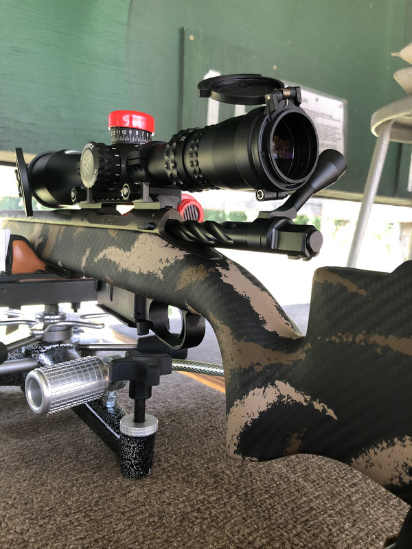

Origin, HawkHill, heavy palma, 7twt, 26 in. 350 rounds
41.4g RL23, Berger 90g VLD T Alpha SRP brass, CCI 450, about .003-.004 off 3298fps
Anything hotter, started to show signs.
No problems yet.
.22BR is pushing them @ 2,940 and zero issues there as well.
Honestly, I've only seen such minuscule vertical in my 6 Dashers loads.
Alpha brass is really, really impressive.

Using 37.9grs H1000 @2929 FPS out of a 7 twist 26 inch Krieger with excellent accuracy and s/d. Good velocity out to 1100 yards.
