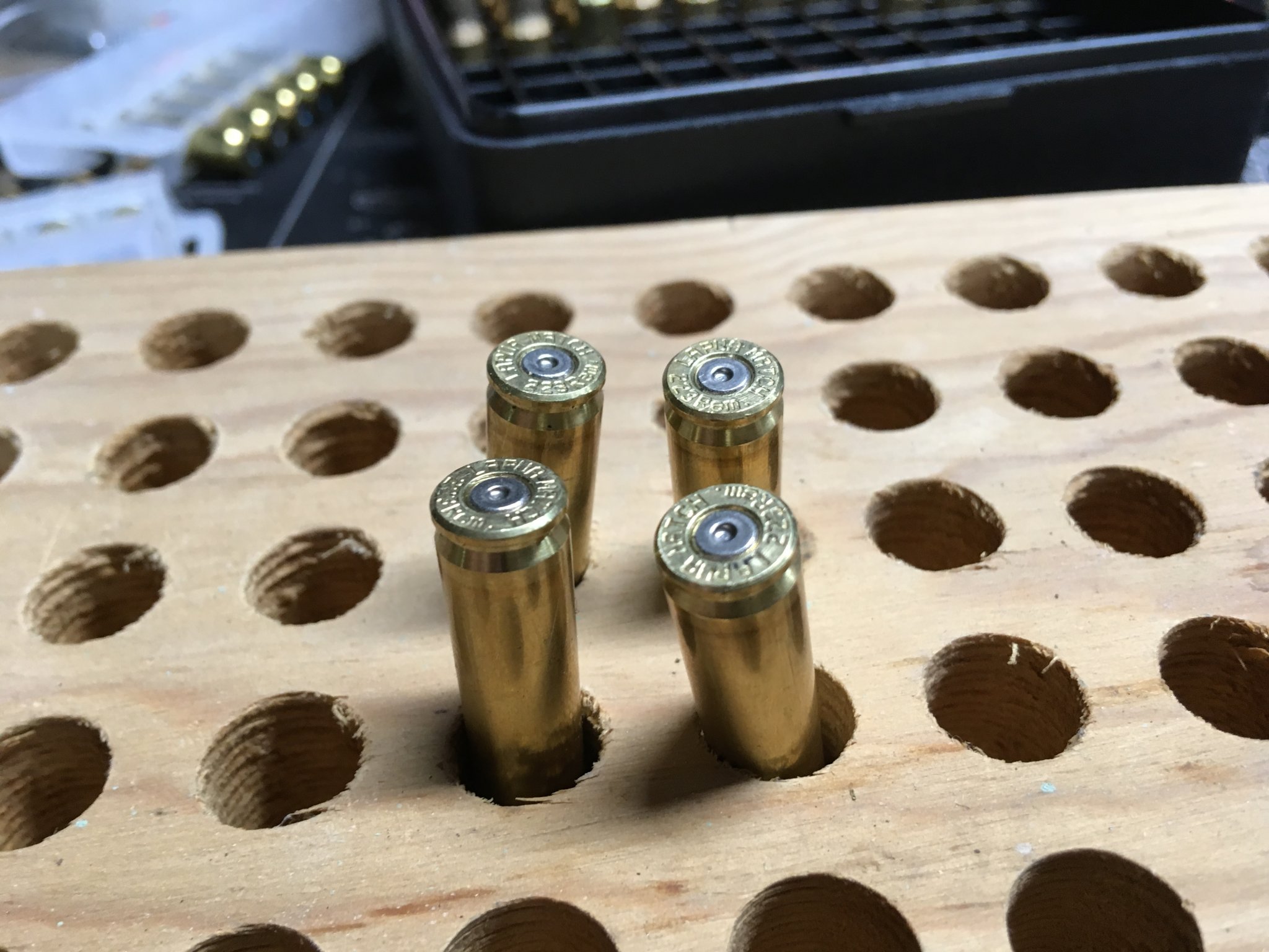

I run 24.4gr Varget in my standard 223 with Berger 80.5. I am seating .010 off the lands and getting 2856 fps.
These have been loaded and fired about 5 times and the primer pockets are still with in specs and tight.
