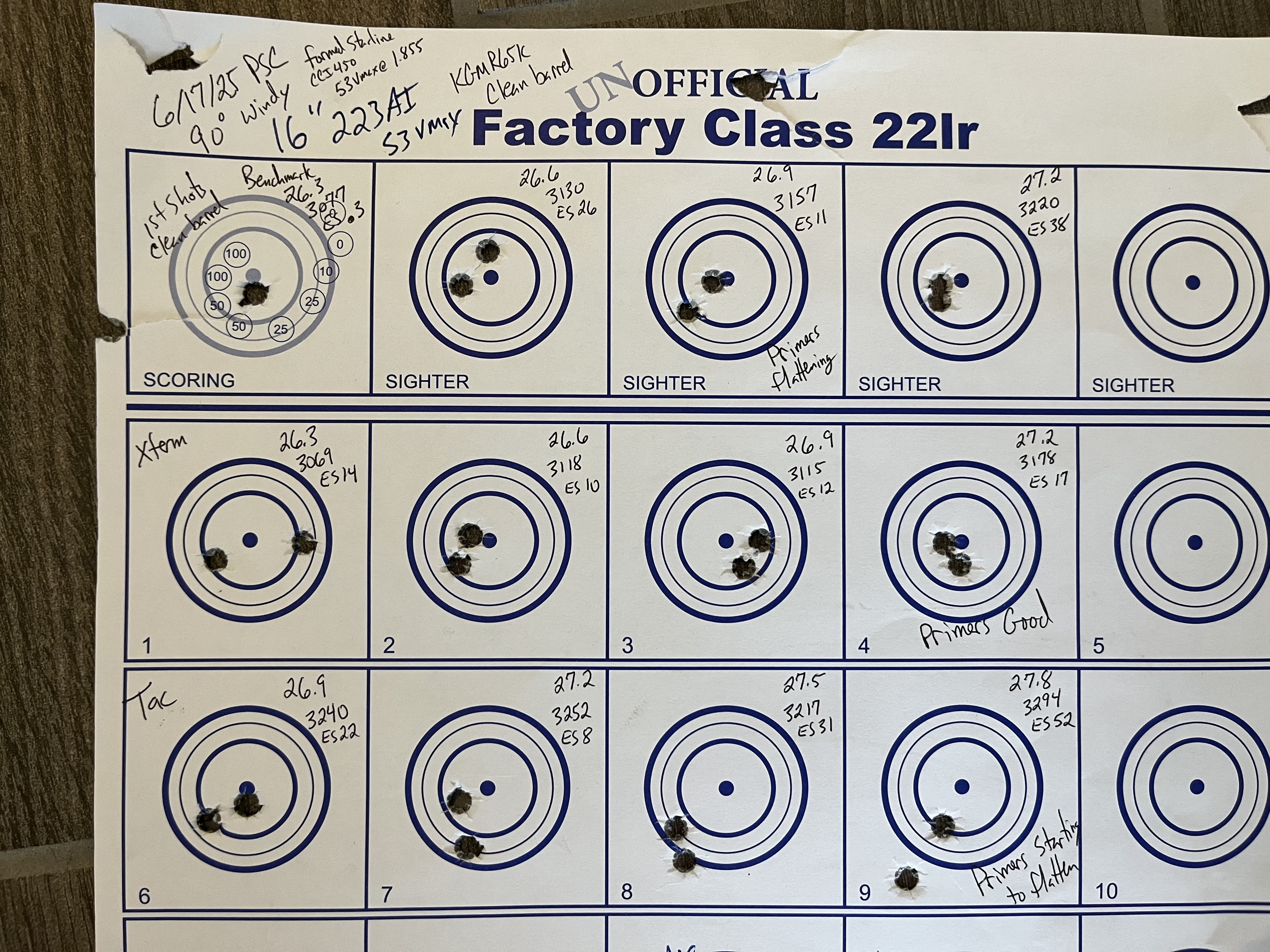

Initial pressure test and load sample for a new criterion 16” 223 ai.
Formed starline brass
Cci 450s
53 vmax
Benchmark, xterminator, and tac powders.
Pretty impressed with the velocities got to 3150-3300 before noticing pressure depending on the powder.
I shot the same loads back to back with my 22” 223ai and saw a 200-250fps increase with the longer barrel.

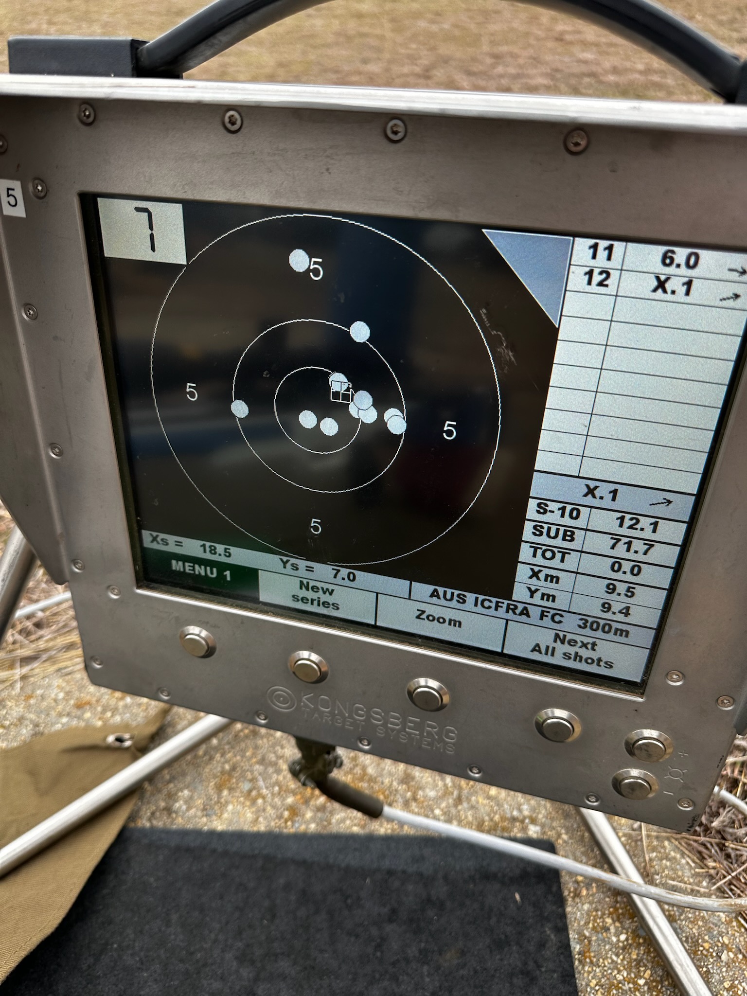

Last week I threw together a load for a 300m match at my local club. 26.3gn 2208/Varget with 69gn SMK. Absolutely dynamite! 3075fps from my 26” 1:7 twist, SD of 9.9fps. Conditions were near perfect. Zero wind. Results in picture attached.
Ran it this week at 500m, again a very impressive performance from the same load in 5-12mth winds.

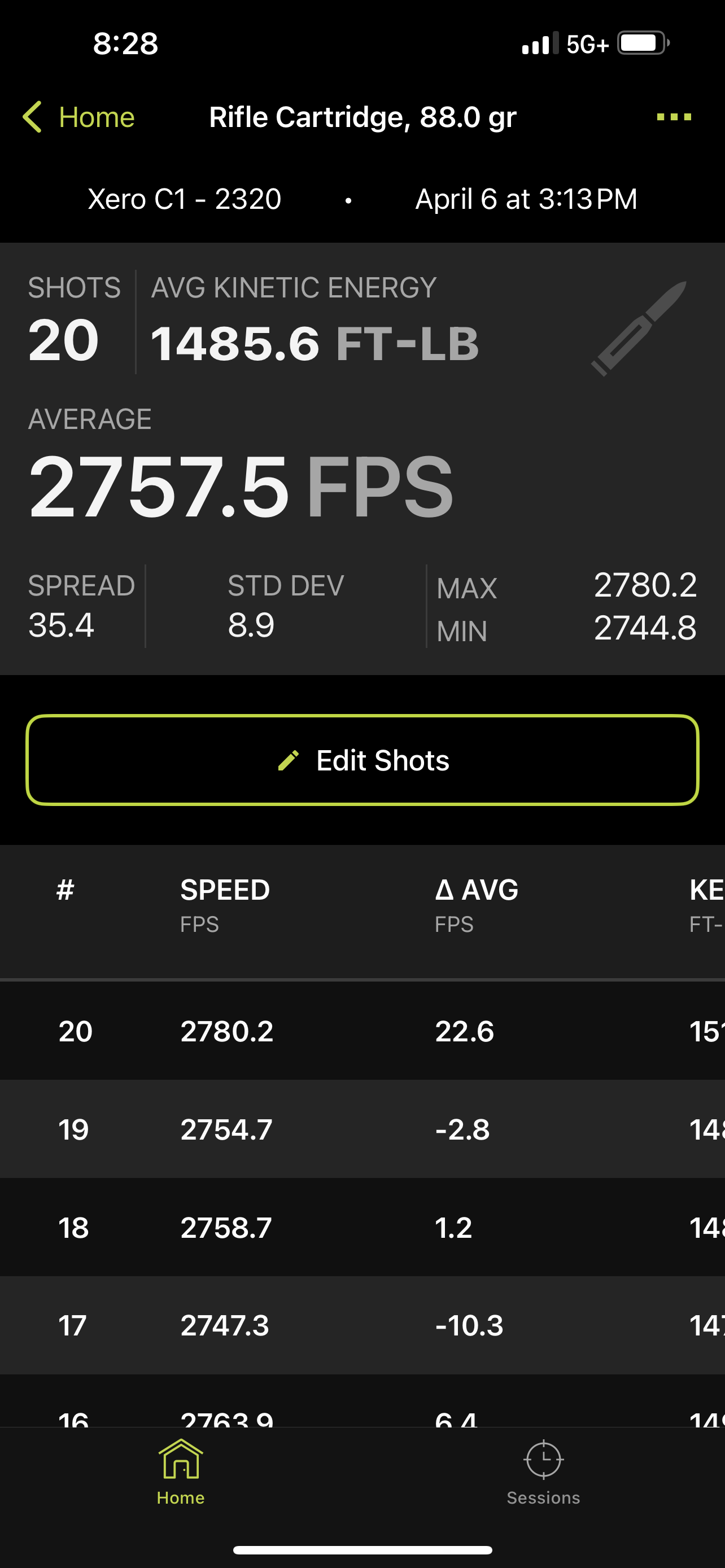

I would think you'd want chase acceptable speed with the best accuracy. I'm running the same cases and powder, but have been bounching around between Berger 75 & 80's, and Sierra 77 & 80's. I'd be happy with Mid 2800 and great accuracy; getting there but not quite yet.
