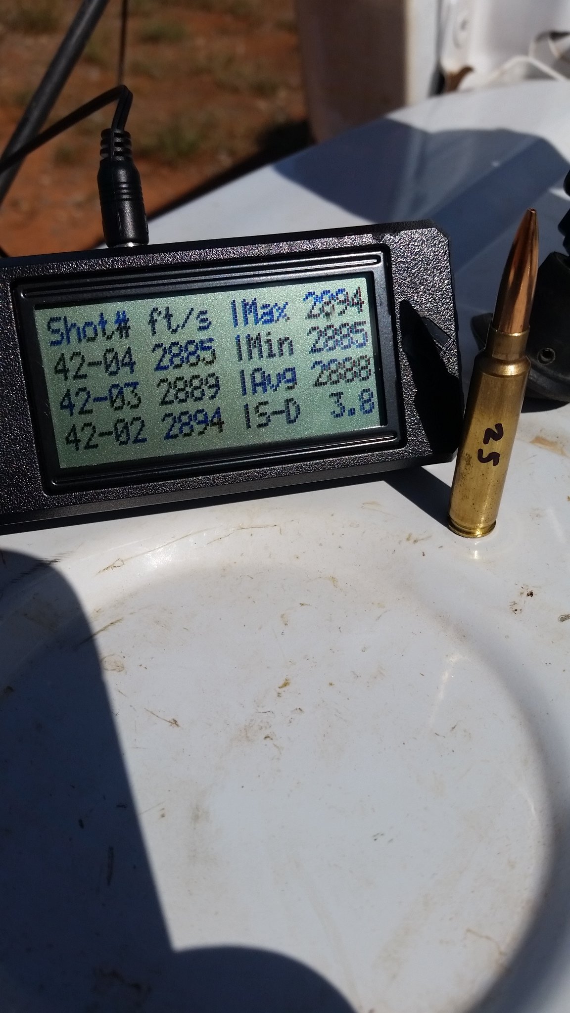

Huckleberry75 that’s your FF load? If so what is your regular load. I’m trying out that 8208 too

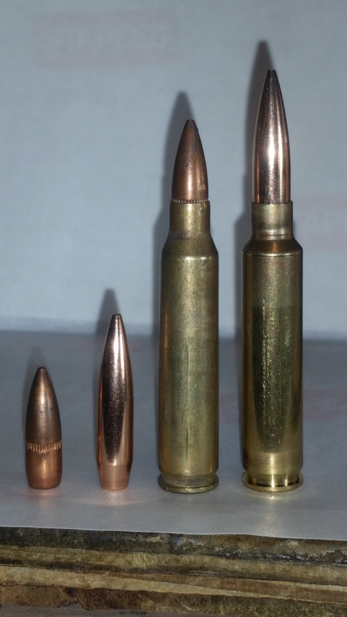

25.0gns of IMR8208 with the 80.5's. Crazy accurate at 2888 fps. Could probably get more speed from H4895, but meh, it aint broke. First pic is a comparison of 55gn ball 223 next to the 80.5 AI's.

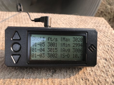

I have found my Proof CF barrel likes this load.
.223 AI
CCI 400
Fire formed brass.
80 grain Amax.
27 grains n540
3050 with good accuracy and case life.
Barrel is 22” IIRC.
