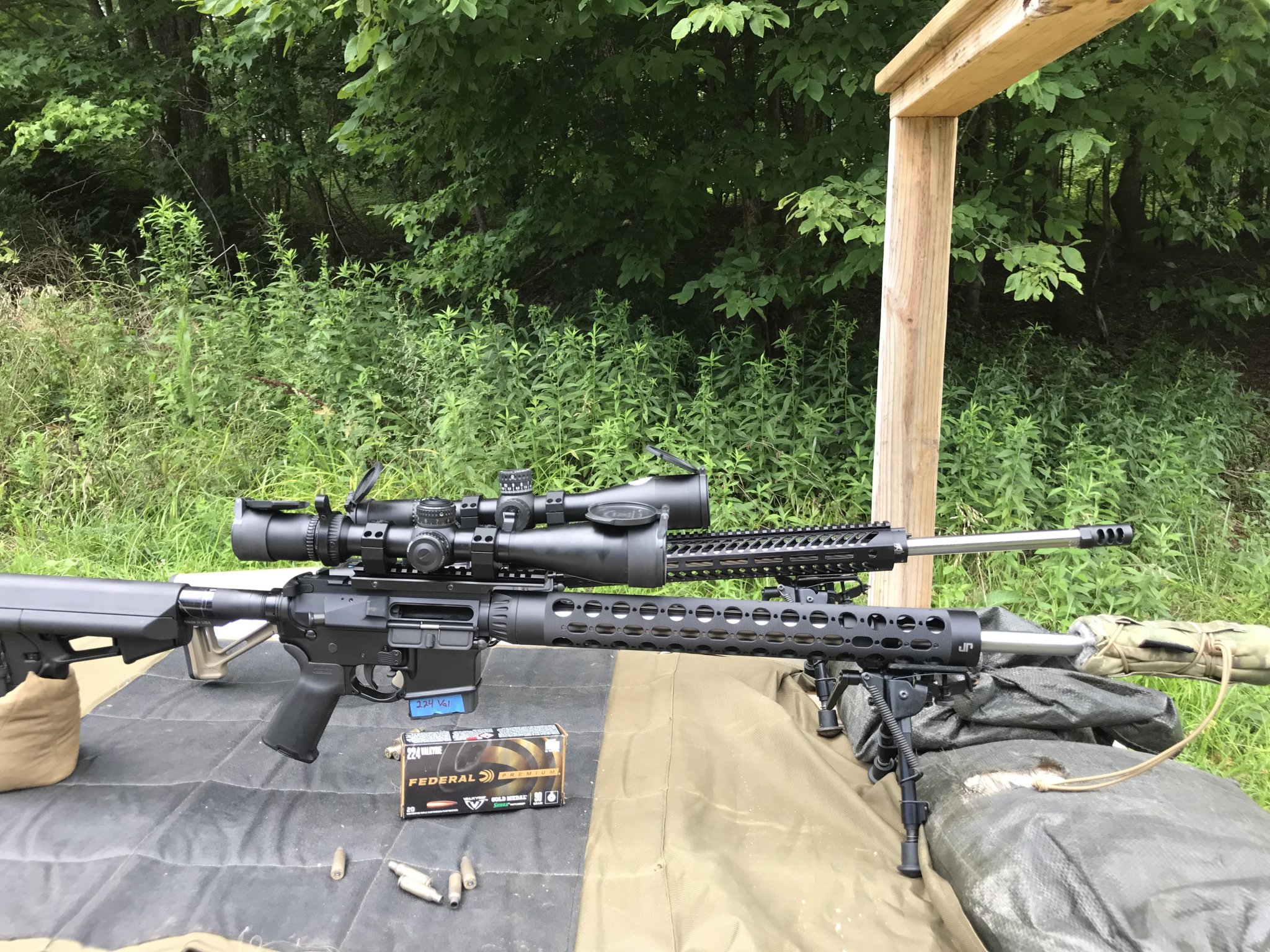

When I get mine back from the paint booth I am going back to try benchmark but with 450’s, drop down to a node where I can avoid the ejector ring and see if I can keep it a tight group.
How many rounds are you putting thru your 20” psa before you are seeing good groups? I just built a rifle with one and first trip to range was unimpressive with 75, 88 or 90 factory at 100 yards

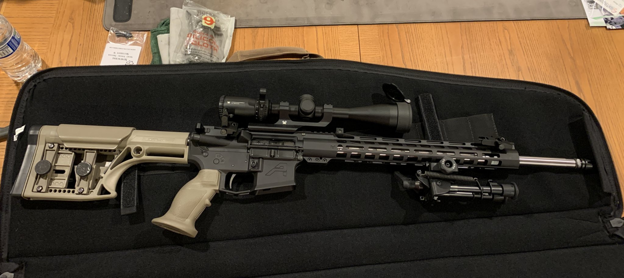

Built it with aero m4e1, Timney impact, luth ar parts and butt stock.
I’ve built 7 rifles with psa Valkyrie barrel/upper parts. 4 for me and 3 for others. None did well with factory 88/90 ammo. Only factory ammo that shoots about moa is federal 75fmj which on a good day shoots about moa and on a bad day about 1.5-1.75moa. Reloads will get you closer to moa both 75gr eldm and 80gr eldm. I’ve also got some good results with 88eldm reloads but velocity wasn’t where I wanted and wouldn’t outperform the 80’s which I think ? is where the sweet spot will be. Btw I have 2 of the 1/7 and 2 of the 1/6.5’s and can’t really tell too much difference between them. At first I thought the 6.5 was shooting the 88’s better and it might be slightly better but once the correct oal is found both barrels will shoot the 88’s well but again I haven’t gotten the velocity with that bullet with good groups to make me switch. I still need to get some h4895 to try as I’ve only run cfe, w748 and tac. My psa 6.5 creedmoor barrel will shoot .5 moa with 140eldm. The Valkyrie is proving to be a tough nut to crack
Mine is the 6.5 twist. Only my first trip but the 75’s were decent - everything else was shotgun. Hope after I get more rounds thru it will tighten up. I am able get 1/2 moa consistently w 6.5 prc seekins havak bravo factory 147. - don’t expect that from a psa / my built lower but moa would make me happy
I also have a PSA Valkyrie barrel in 20" but I'm pretty sure my twist rate is 1:6.5 not 1:7. I will have to double check when I'm home. I've had great luck with it so far shooting 75g and 88g projectiles.
First thing I would try if it was me is remove the brake and see if the muzzle is clean, then shoot it bare muzzle and see what happens. I have had a muscle device in the past create uneven carbon build up, and that can screw your day all up.
Shoot more of the factory federal 75 fmj and report back. Bet you get back to near moa again. Unless you are going >800 yards you will ring steel all day with those. Reloads obviously wi be better but with the psa barrel I see no need to go with other factory ammo

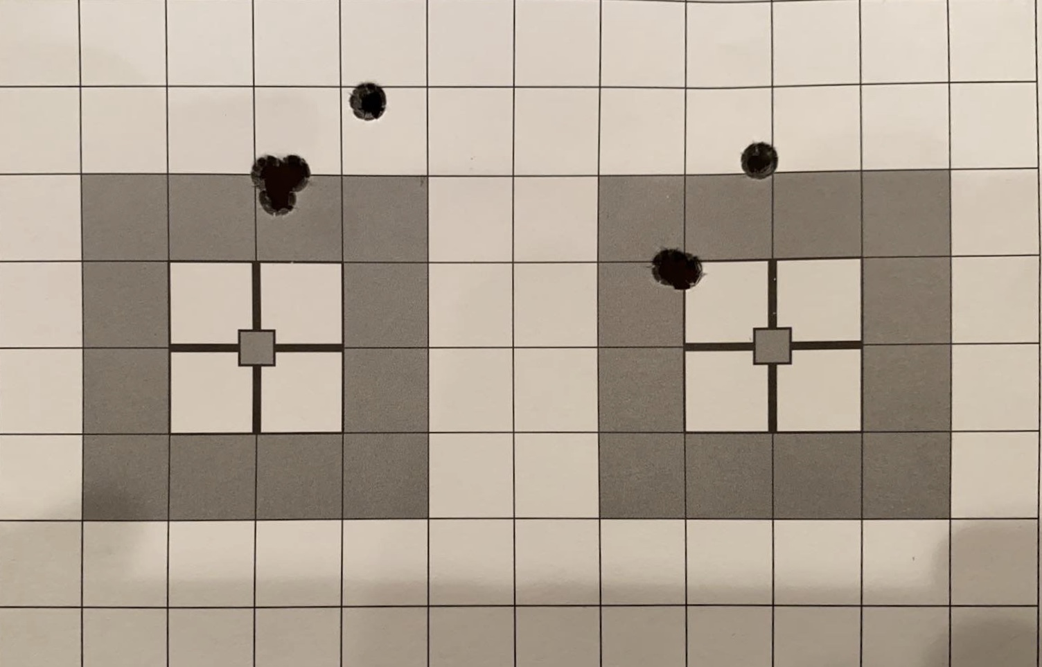

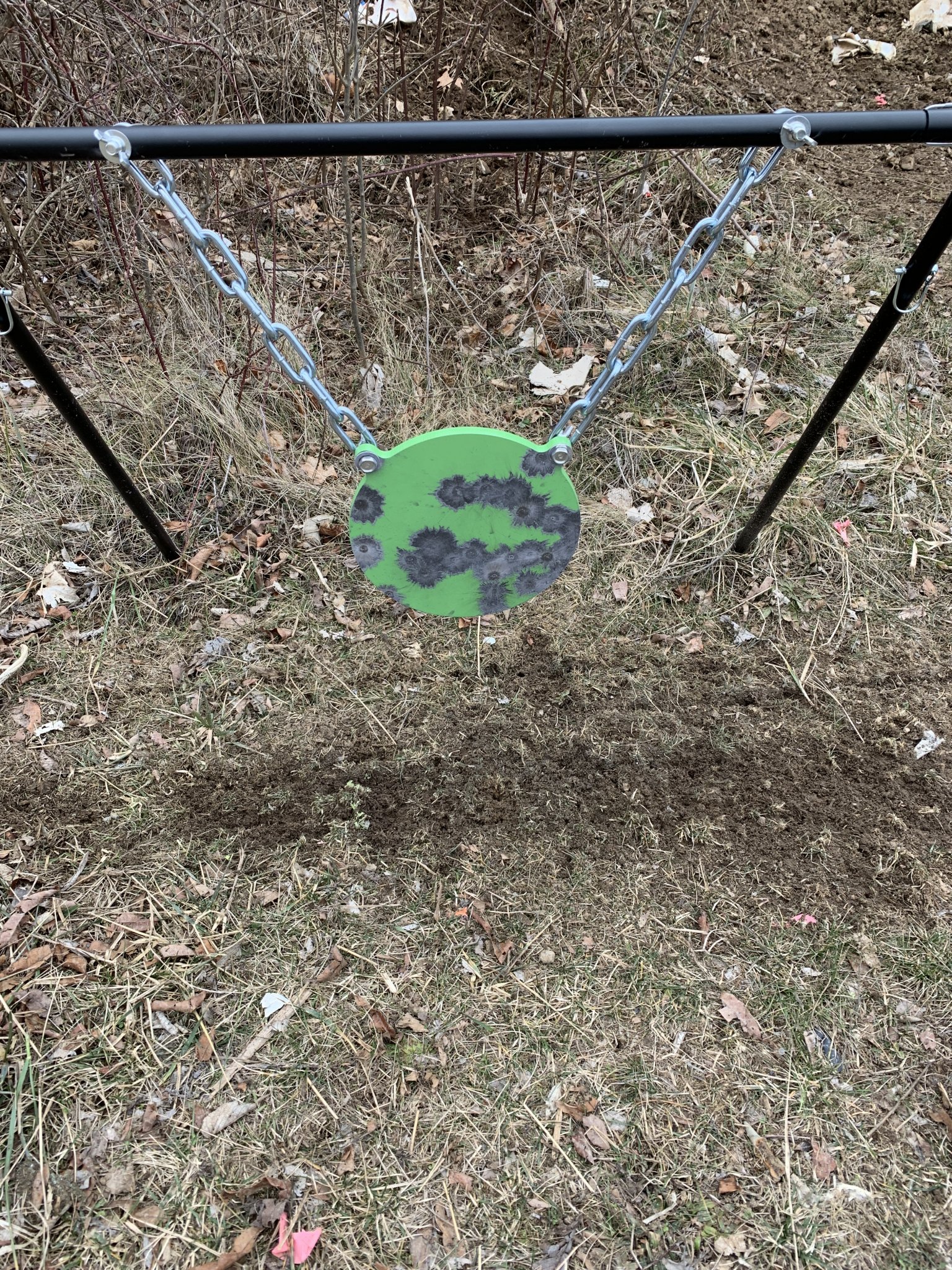

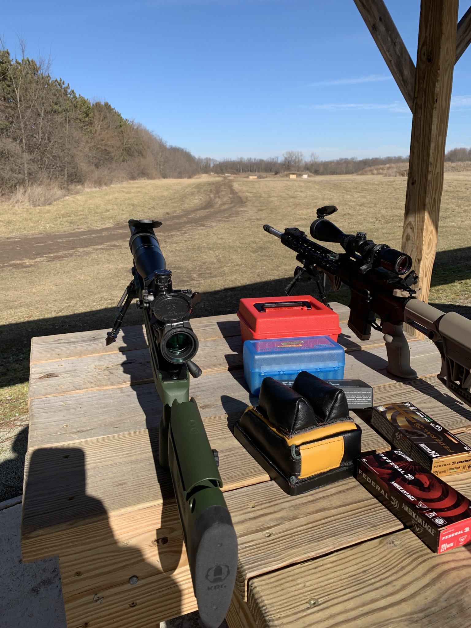

Well after about 150 rounds my groups are tightening up and I was able to hit steel out to 750 yards yesterday. So I’m feeling better about my budget 224 Valkyrie. Thanks for talking me off the ledge Randy. 90 grain was more effective past 500 yards.
Reactions: lash
Btw I added a vg6 epsilon brake. Really enjoy the no recoil/ muzzle rise which equaled the ability to stay on target all the way to impact. I was able to spot my own shots easily.
Monday is range day in Indiana!
Nice!!! Yeah the PSA stuff I’d decent for the $$$. There is always better and if you get the itch you can always upgrade barrels later. Way I figured it, was their gear was good enough and I could upgrade if I got snakebit by the caliber.
I too run the vg6 brake; good stuff.
Trigger I run the Larue MBT.
good times though and keep it up. Reload and I think you’ll be happy enough.

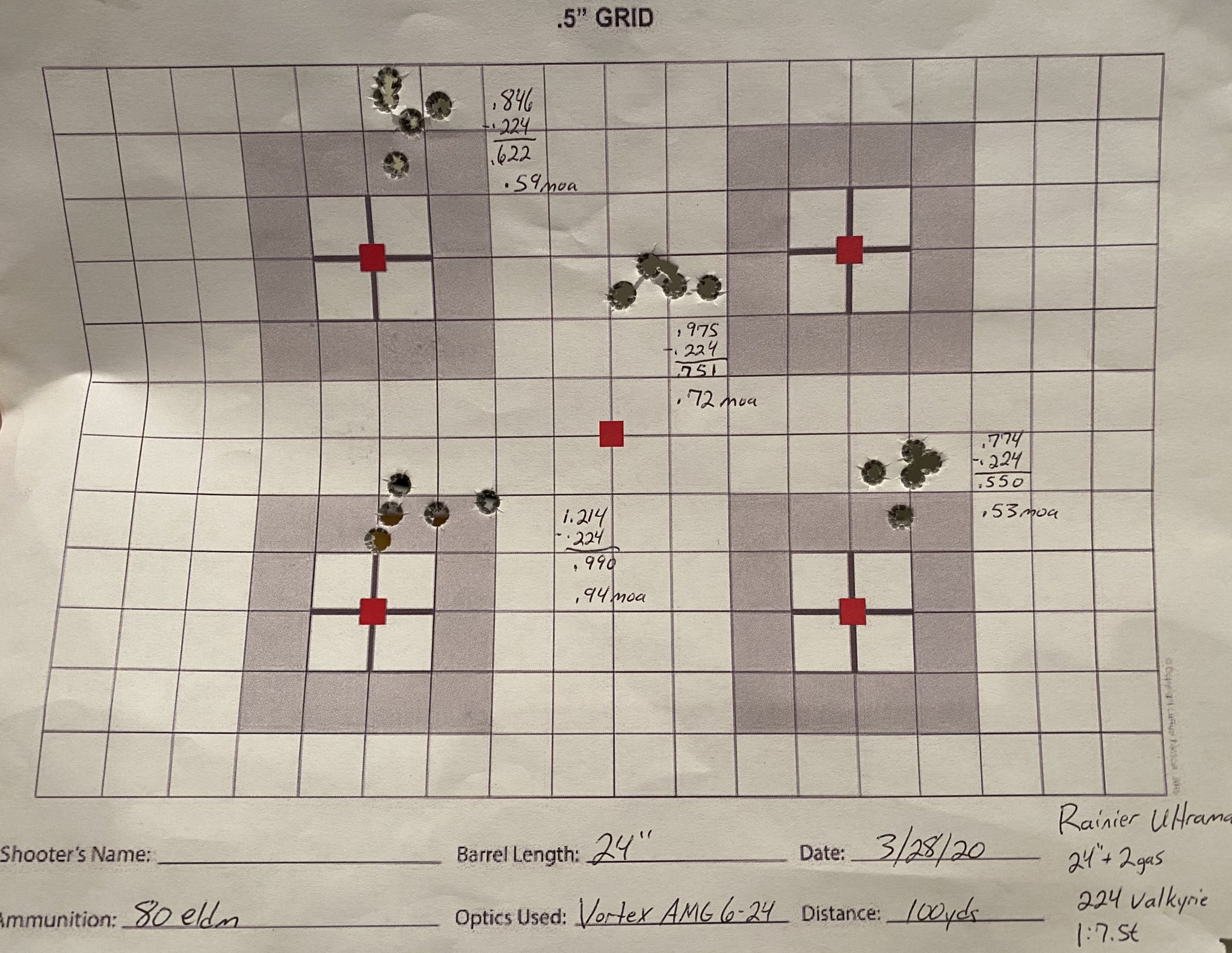

I’m 2 for 2 with the Rainier Ultramatch barrels with 80 eld’s and h4895. Both are 24” +2’s. Both barrels have been sub moa with handloads, but the first barrel showed that the 1:7.5 twist wouldn’t properly stabilize the FGMM 90’s. I don’t recall shooting the AE75’s in them, but I’ll try and do that on future range trip.

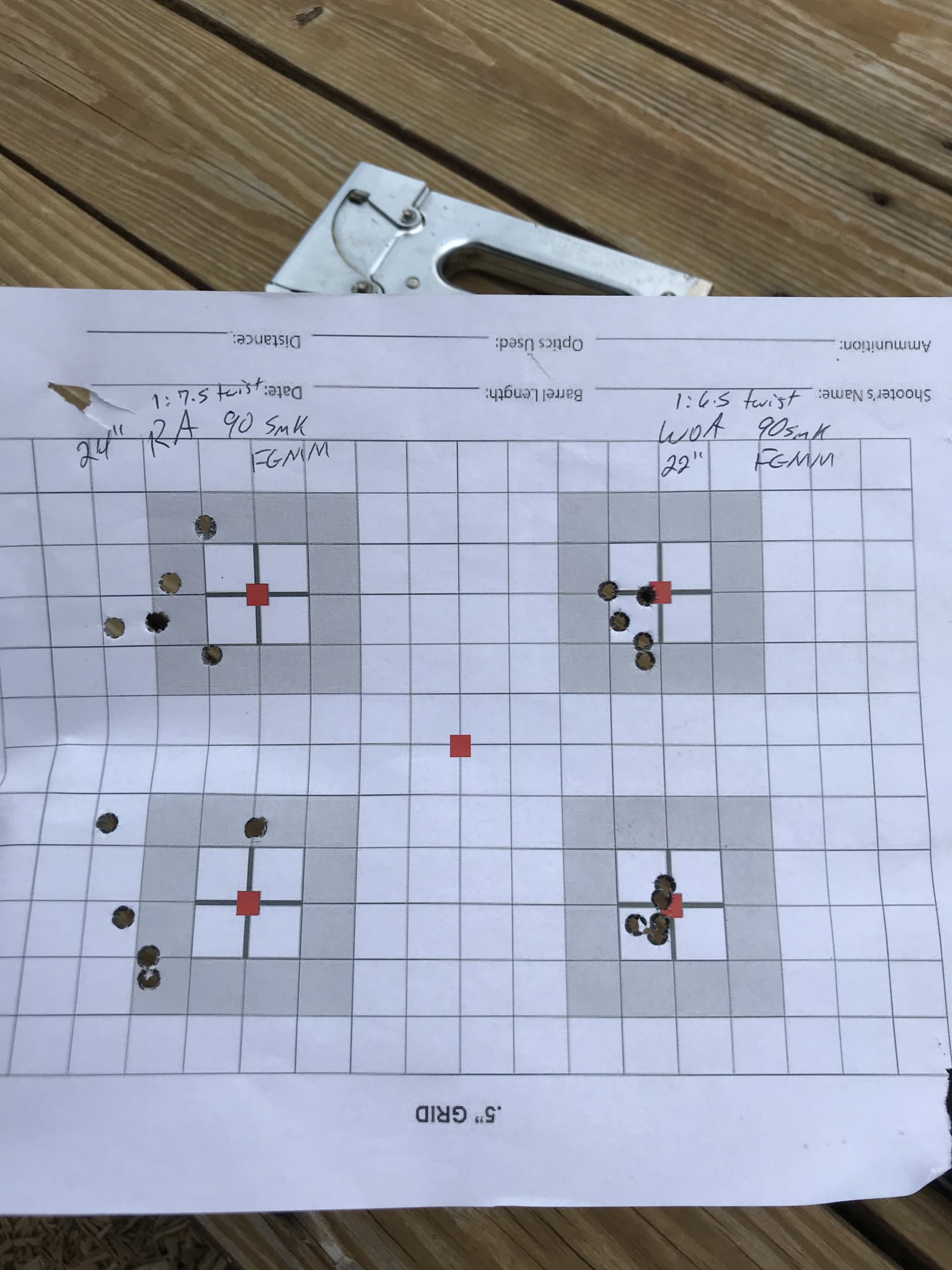

I also have a 1:6.5t 22” WOA and just picked up a 24” +2 WOA, also a 1:6.5t. The 22” has been sub moa with FGMM 90’s and shot the 75tmj factory load very well. I’d say the 75tmj is closer to moa, but it has shot several groups that were sub half moa, and closer to 1/4moa. I need to find tune a load with it for the 80 eld’s, but I built it to run factory ammo without having to reload.
I have some FGMM 80.5’s on there way. I hope my luck with these barrels continues.
I also have a 22” WOA and just picked up a 24” +2 WOA. The 22” has been sub moa with FGMM 90’s and shot the 75tmj factory load very well. I’d say the 75tmj is closer to moa, but it has shot several groups that were sub moa, even 1/4moa. I need to find tune a load with it for the 80 eld’s, but I built it to run factory ammo without having to reload.

Were the FGMM 90’s the new production, gold/black box, or the first lots produced? The WOA has done well out to 850yds for me with the new lots of FGMM 90’s.

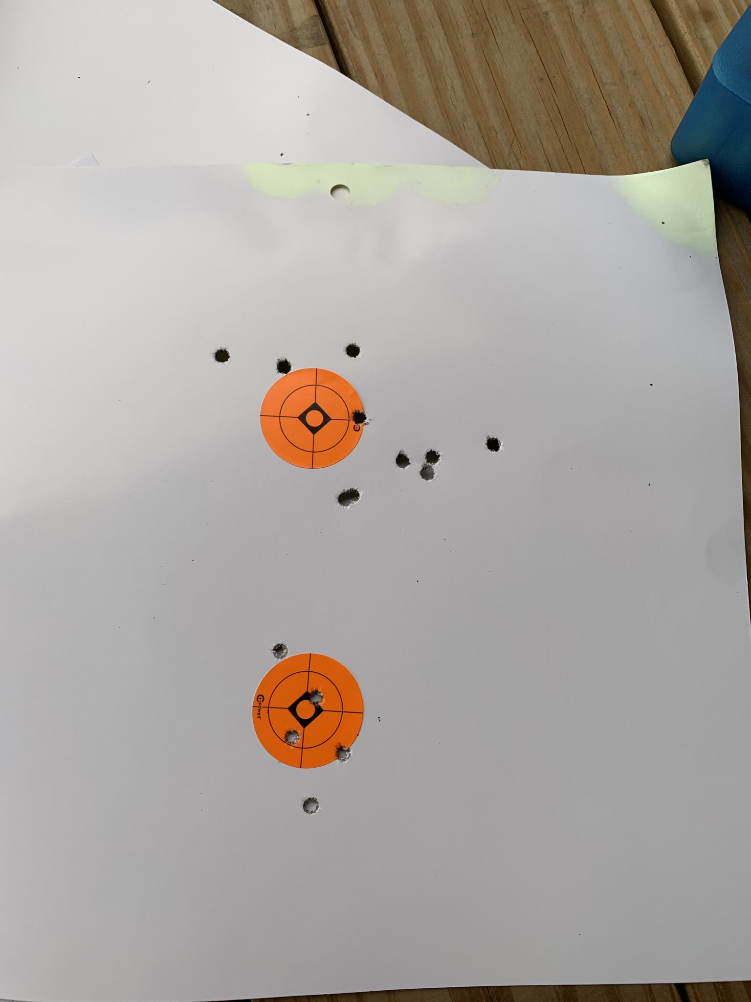

Cobbled together AR, second range trip trying out some 80 eld’s and Berger 85.5’s w/ H4895.
The 4 groups of 80’s were with FC 1x brass for 3 groups, and the upper left group was virgin starline. All groups had the same BTO measurement but different charges.
Berger 85.5’s, same charge weight, but varying seating depth. POI shift of the main group was due to zeroing for the 80’s between strings.
Spent another day at the range comparing different ammunition through my White Oak Armament 24" 6.5-twist .224-V barrel. Results were the same as last time:
  • Hornady Varmint 60gr ... super accurate - consistent sub-MOA - 5 shot groups almost in the same hole
  • Federal Berger 80.5gr ... not bad - 1.5 MOA-ish
  • Hornady Black 75gr ... just OK - 2+ MOA-ish
  • Hornady ELDM 88gr ... awful - 3 MOA with a flyer in every group
  • Federal SMK 90gr ... same - just lousy - best group was 3+ MOA
I also took all of them out to 12x12 steel at 500 yards. The 60gr Varmint was spot on center mass - everything else was either "OK" or just lousy. Next trip out will be to shoot the Hornady Varmint 60gr ammo to 1,000 yards, and see if that light bullet struggles at the longer ranges.
My quest for .224 truth marches onward.
Buying the lower-twist barrel to stabilize the heavier bullets ... appears to be the opposite of what I was expecting ... at least "for me" and on "this gun". I know - I know ... the usual suspects will say "... spend more money - buy a better barrel ..." but I feel like $800 "should" be enough to get a quality upper in .224. But that's just me.
