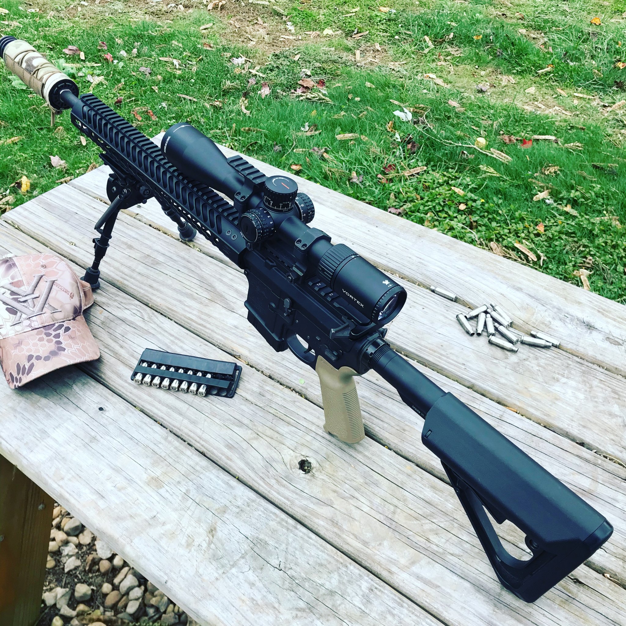

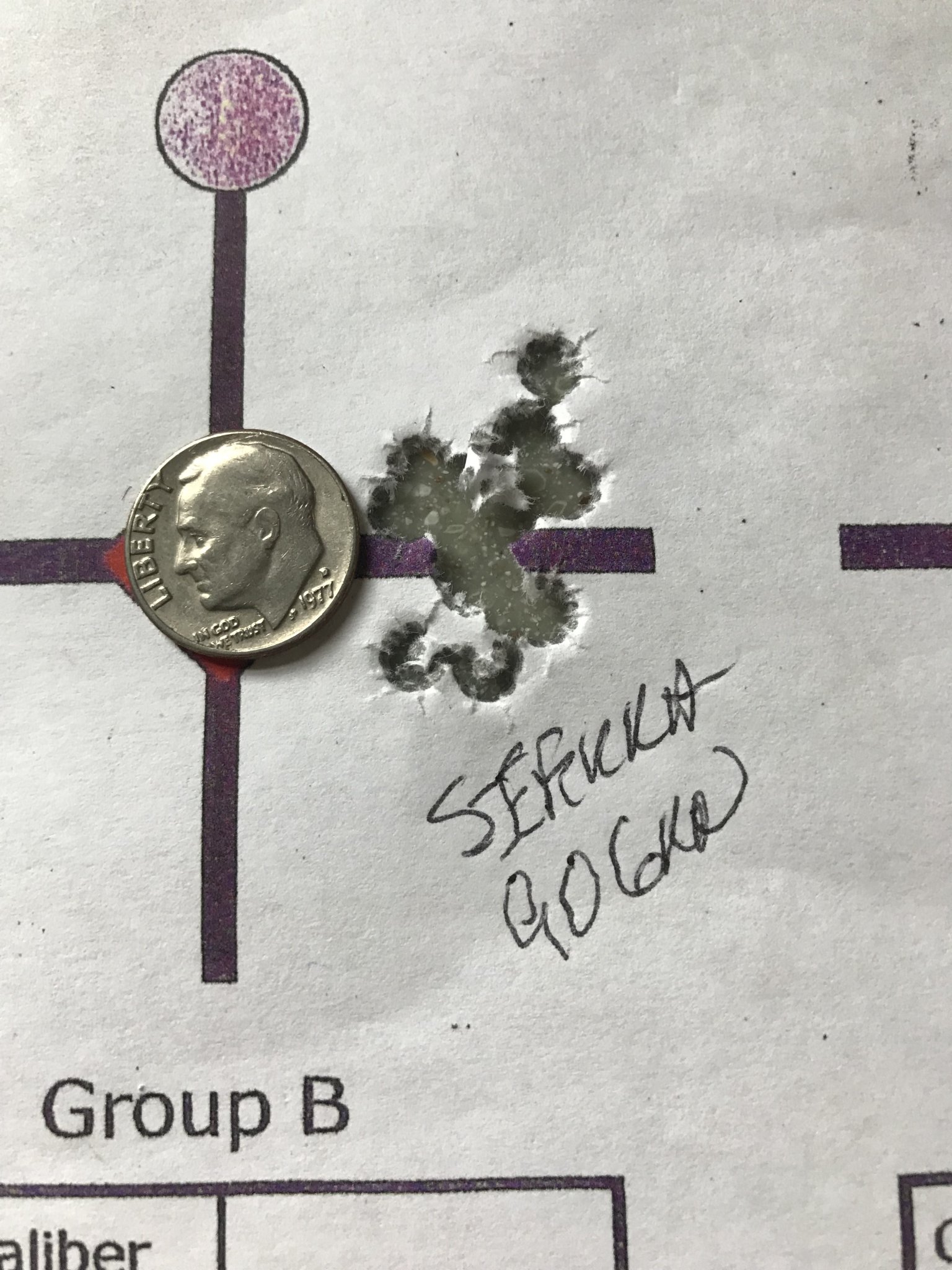

I shot this 10 shot group today at an indoor 100yd range. This is Sierra 90grn HPBT sitting on top of R17. CCI 450 primers and Starline brass. FPS is 2685 and SD is 4.4 1543614093985.jpeg
This is a JP 22” med weight 1:7 twist barrel. Templar Tactical matched set upper and lower. JP lightweight bolt carrier and JP silent buffer spring. Trigger is JP / Armageddon Gear Revolution.
This set up did NOT like the Hornady 88’s. I tried them with several powders and adjusting seating depth. It really did not like the factory 88 ELD ammo. I started with the 88’s and when I saw the dismal results, I had little hope for the 90’s, but I think these results speak for themselves. It also loves 85 RDF on top of some CFE or MR2000.
I am no barrel twist expert or ballistician, but I am a knobdicking reloader.
So my .02- buy the best you can afford, reload if you can and experiment, and don’t buy into the “this won’t work with that” argument. If you all recall, JP actually was canceling orders for folks who were on the list waiting for their barrels because they were not having results good enough for their standards. They even sent emails telling folks that if you want to shoot 90’s, you may want to look elsewhere. Apparently they got it worked out, cause I will take these groups from a gasser any day.

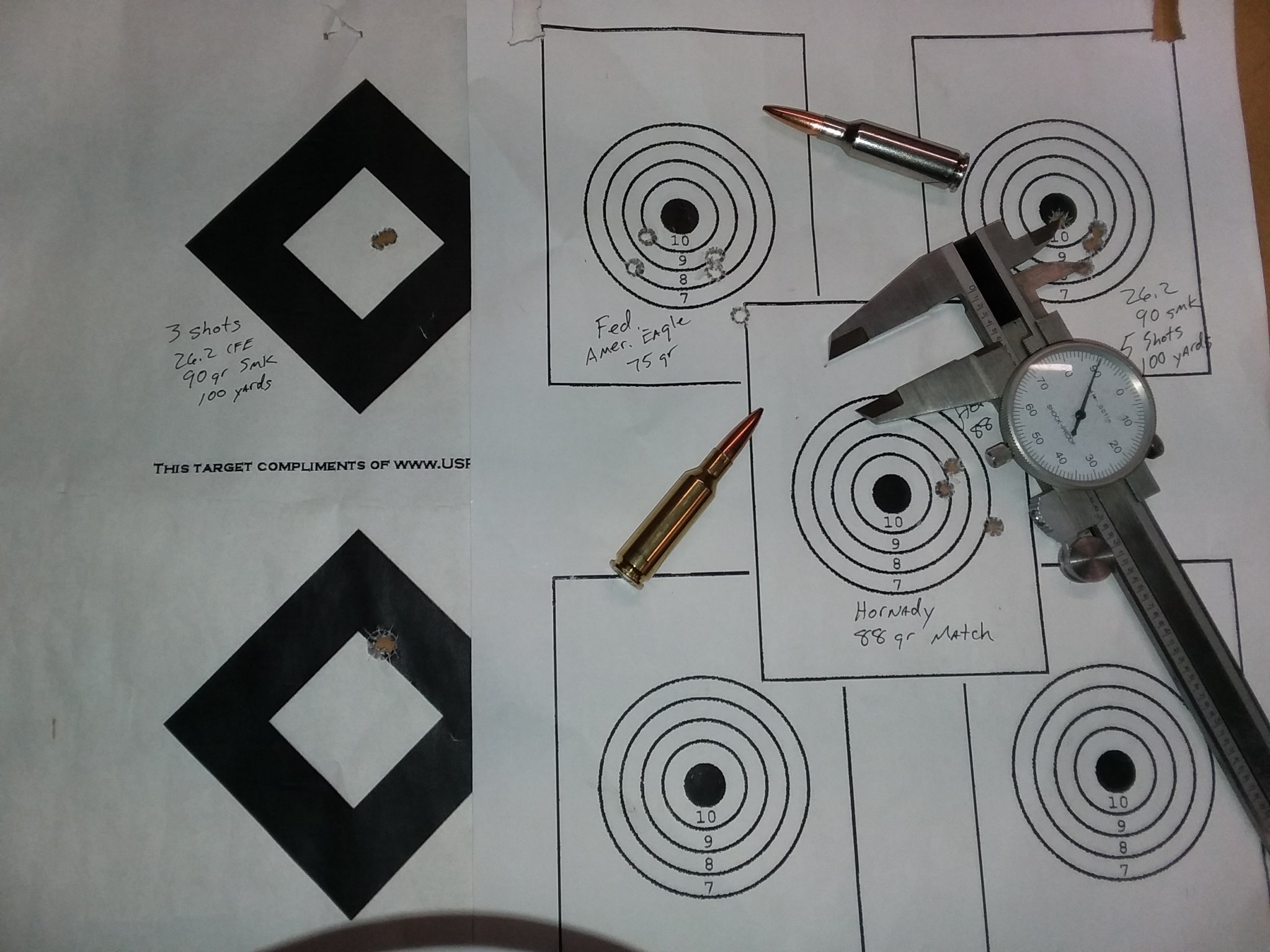

Here's some targets that I shot last week out of my PSA 20" barrel. I didn't spend a lot of time on paper as I wanted to see what this load was going to do further out. I shot the American Eagle first and you can see they didn't group very well for me. I shot 3 rounds of the Hornady 88 gr. Match just to see how they would group, then saved the rest for the steel targets at distance. Then the first 5 of my reloads, indicated with the calipers are just under 0.6" at 100 yards. I then proceeded to shoot steel at distances from 200 out to 700 yards. My load was performing great! The 88 gr Hornady's did well on the steel too, but not as well as my reloads. My last 3 shots of the reloads I had left were shot at the other target on the left. As you can see, they did very well.

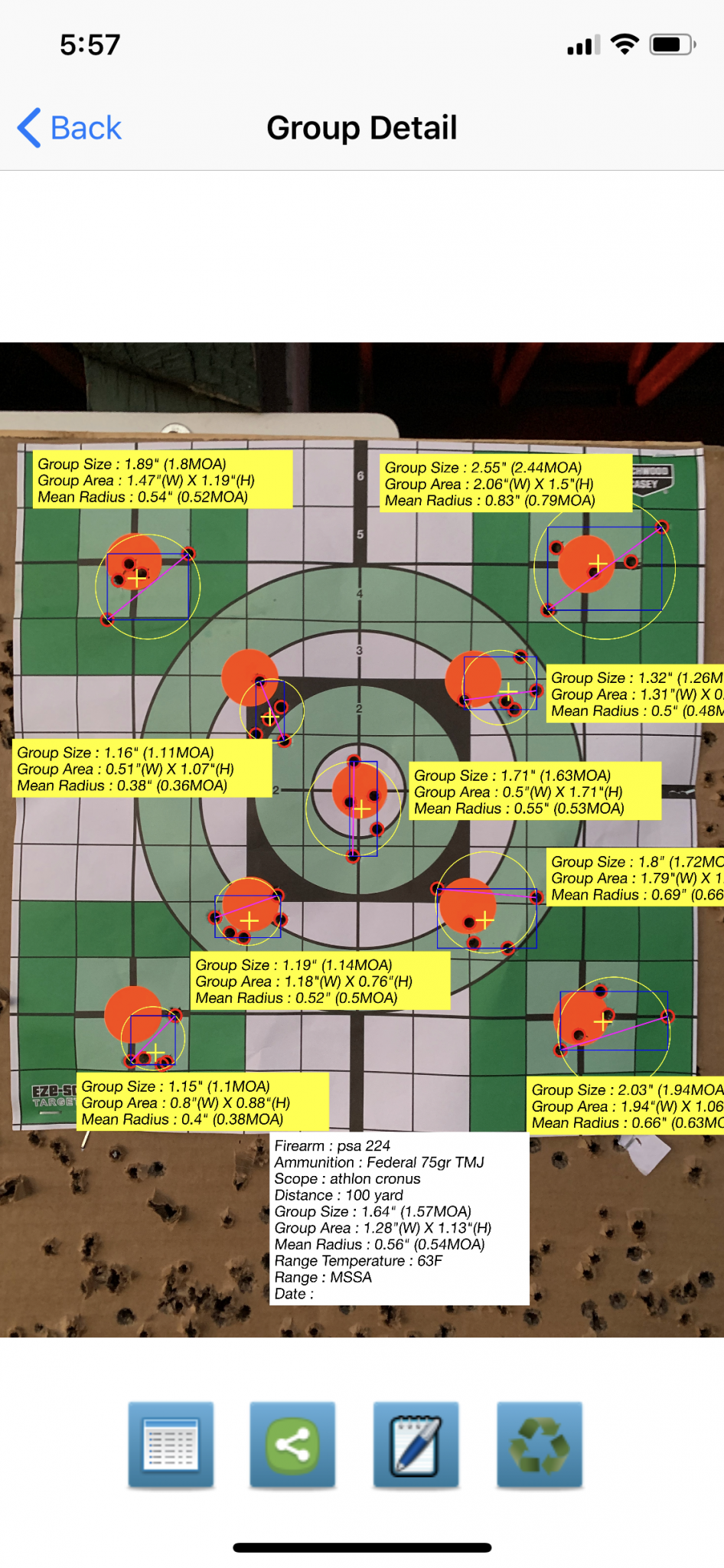

shot 9 5 inch groups today with the AE 75 gr tmj. Average is 1.57”. I just emailed craddock letting them know I’m in on their 22” 1/7 upper. Anybody interested in this PSA upper? 195 rounds total :oops::D

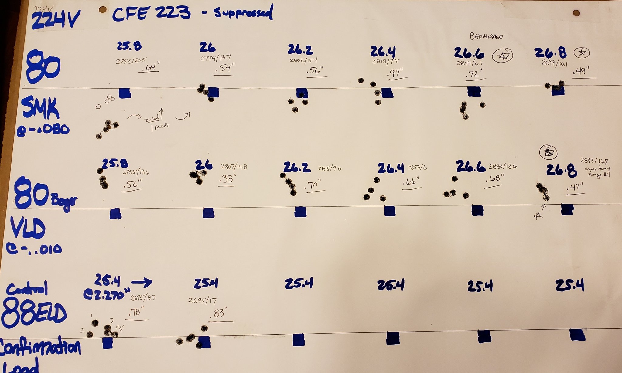

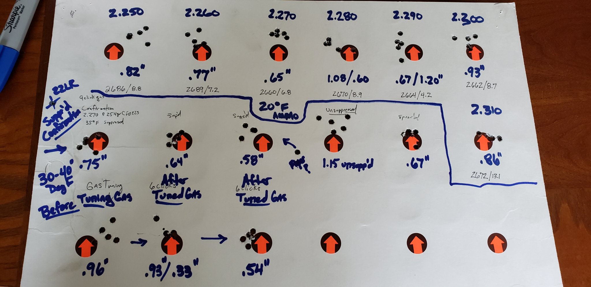

Here is a 7.5T pushing 88 ELDs, 80 SMKs and 80 Berger VLDs shot this weekend, and 88 ELD load development by seating depth. .010" seating depth can make a big difference just as tuning gas block can also.
88ELD Tuning: seating depth on top row, confirmation middle row and gas block tuning bottom row.
80gr bullets charge testing vs 88 ELD load developed above.

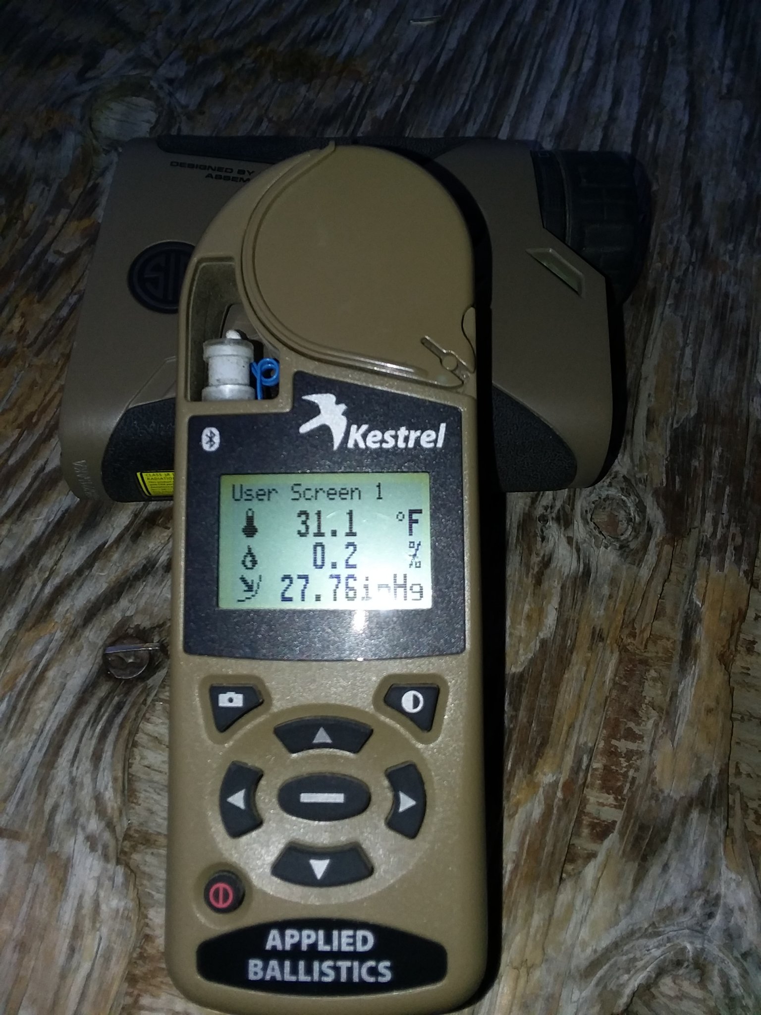

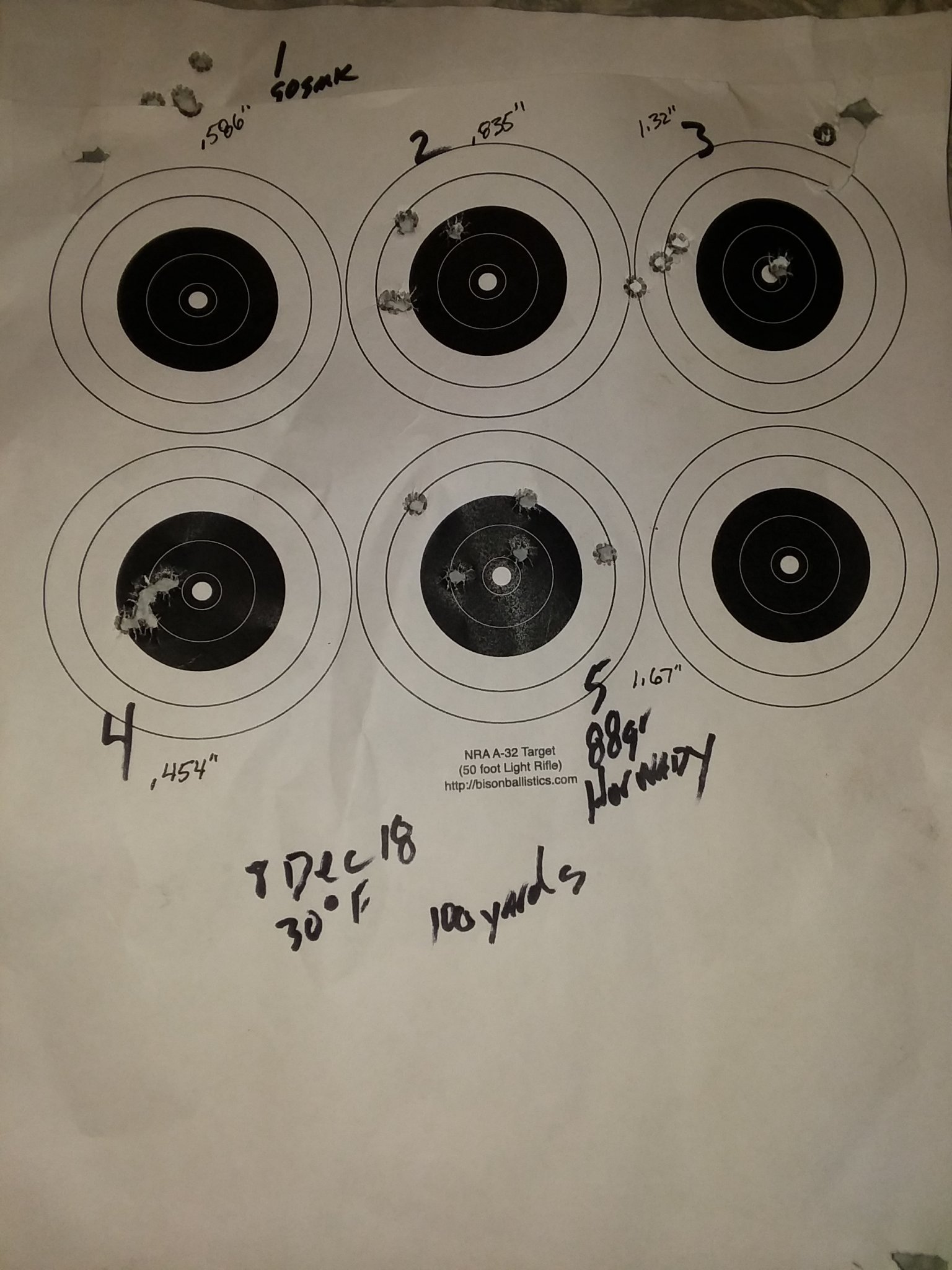

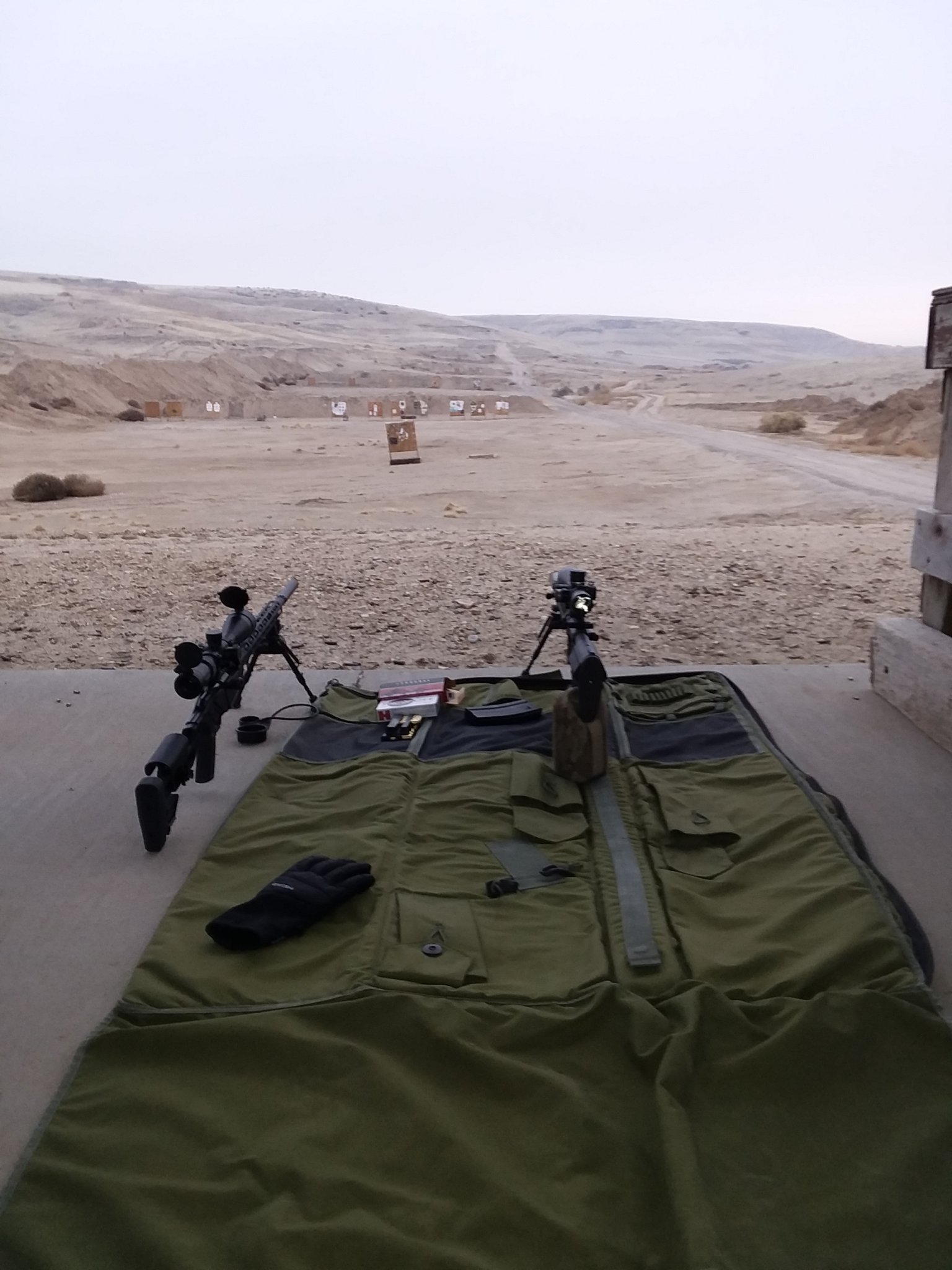

Ok, I found a box of Federal 90gr. SMK and used it to do the (4) 5 shot groups. It was cold today. Temperature was 30 degrees and started to go down as I was out there, so my fingers were cold and I think it reflected in my shooting ability. All shots were at 100 yards. Here's a couple of pictures:

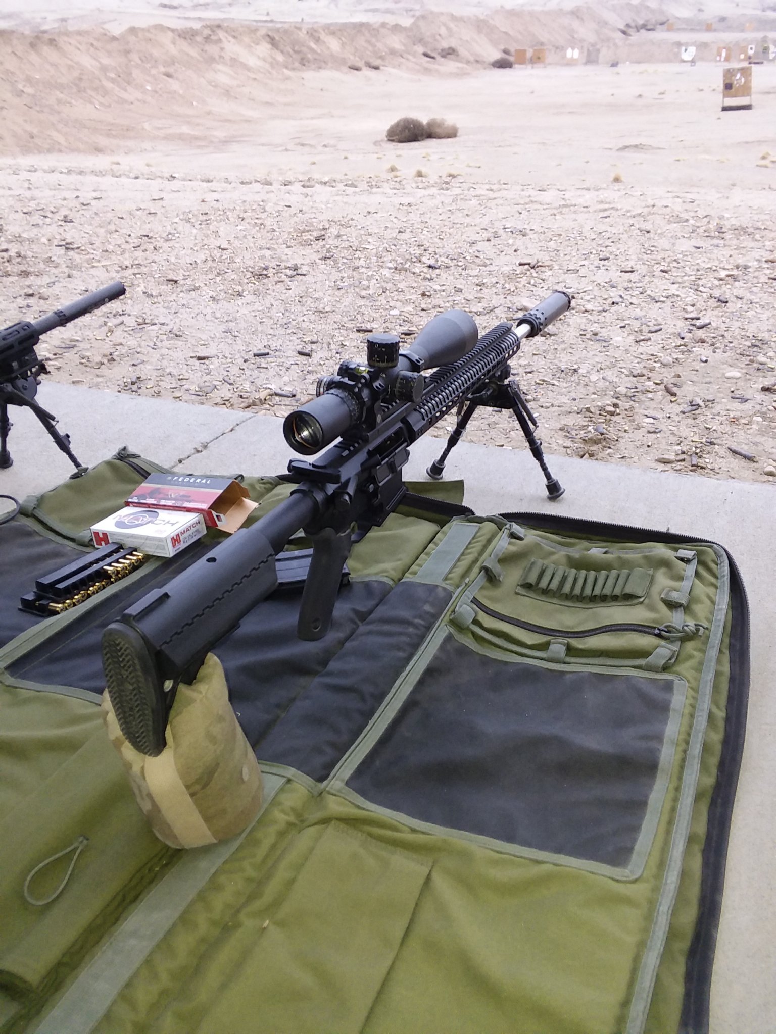

This is my rifle. PSA 20" barrel with 1:7" twist. MEGA upper and lower. ATC AR Gold trigger. PSA BCG. Odin works handguard. Magpul adjustable stock (something I'm going to change soon. Going to get a Magpul precision or LUTH). Nightforce NXS 5.5 to 22 scope, Nightforce rings, YHM Nitro Suppressor, Harris bipod, and rear bag.
The very first 5 shots are indicated in group 1. This is a cold/dirty bore group. Meaning these were the very first shots of the day out of the rifle. You can see that they went high. (that rectangular looking hole to the left is where the staple was) I think that is because my scope is zeroed for my reloads. I then adjusted the scope for the next 3 groups. I didn't spend a lot of time in between groups 1 and 2 and then 2 and 3. The only thing I did was loaded up 5 more rounds in the magazine, got up and looked through the spotting scope and then back down on the mat to shoot the next group. I took my time shooting each round. I definitely didn't blast them off like we've seen on some YouTube reviews! :p
I don't know what happened on group number 3, other than I think I was just cold. After that group I took a little bit extra time and warmed my fingers up. It was maybe 5 minutes but no more than 10 before I started shooting again. That's when I produced group number 4 at 0.454".
I then took some Hornady 88gr Match and shot a 5th group. As you can see, this rifle, does not like the Hornady factory load. I may order some Hornady bullets and see if I can get a load of my own to shoot those better.
The remaining reloads that I had, I used to shoot at distance and have a little fun on the steel.
I'm still happy with the barrel and will enjoy it until I need a new one.

How far off the lands were you seating these? I've heard the RDF's love a little jump
I was seating the RDF’s same as the 90’s. 1.740 BTO. This was using a Hornady lock and load comparator and zeroing the caliper on the comparator. I really don’t know the measurement of off the lands as I don’t measure my rounds that way. My method of load development is to prep brass, select primer, choose powder, and begin. Once I find a powder charge that looks promising, I start tweaking seating depth until I settle on a length. Then I chrono load for SD and FPS. I know this will cause many to go into convulsions, but this is MY method and has worked for me. Many will put a chrono on the load while considering accuracy, but for me, I want to see accuracy befor FPS. What do I care FPS if it is 2 MOA at 100yd? Each shooter has their own method of round verification. I argue none. Do whatever works for you to get to where you need to be.

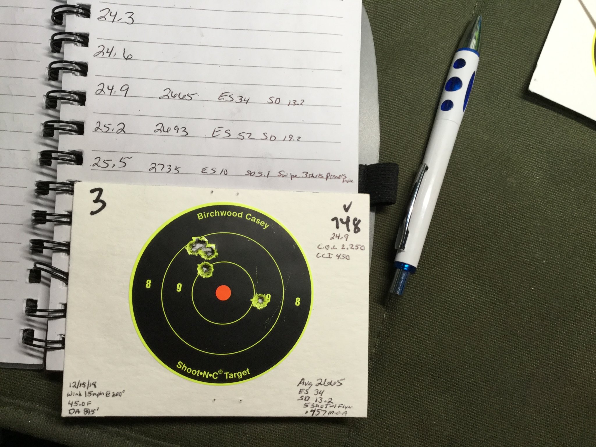

Someone asked on page one about 748. Today was the day I could get to the range. Tried CCE223, Powerpro Varmint and 748. 748 was the only powder that shot the best and this was the last powder tried. This was climbing on hr 4 at a high of 45 and was dropping. Was also testing a new Wilson 223 wylde barrel load developement also.
Aero M4E1 upper/lower, targa, Craddock bartlin 22”, 308 Dakota silencer, Ares BTR 4.5-27
Federal brass
88gr Horney
Pulled a shot
Next time I am loading up RL15 and maybe benchmark.

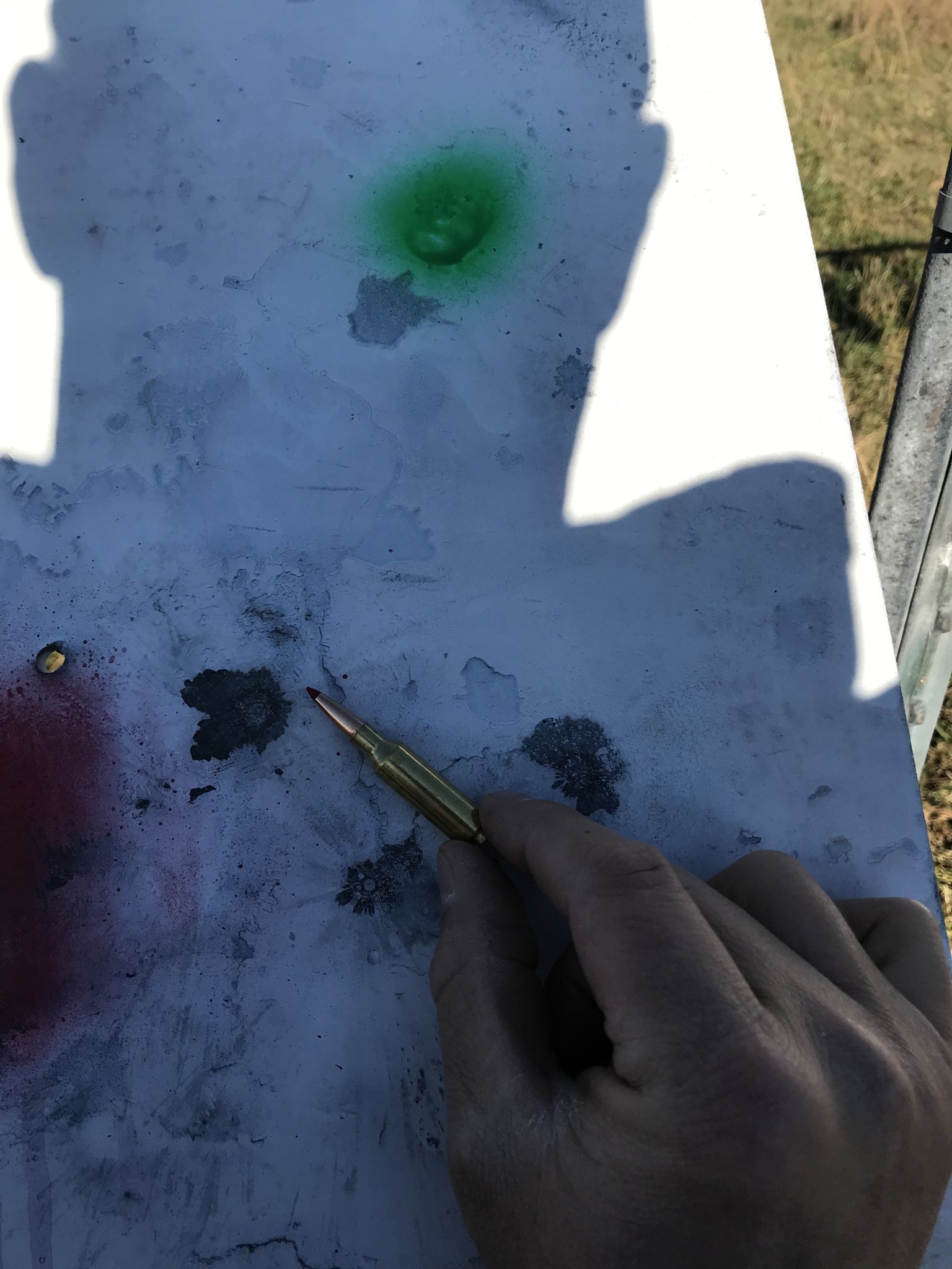

Mine seems to be doing pretty consistent.
Aero upper lower combo
Seekins HG and 18” Seekins barrel (would have went longer but that’s all they had in stock when I ordered). Mainly trying it for coyotes so 18” is fine with me.
RRA trigger.
Hornady 88gr ELD ammo at 500yds
