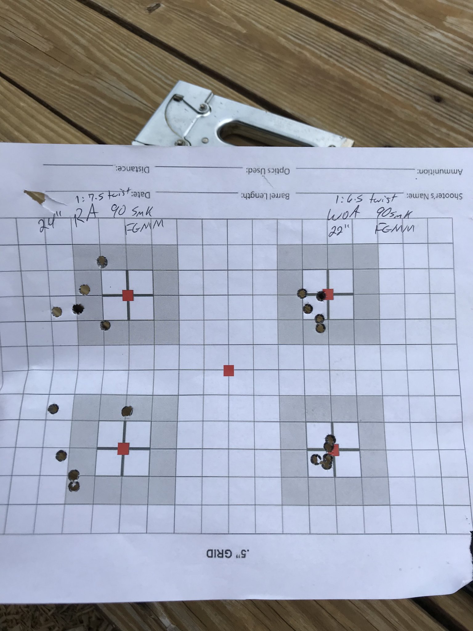

Cool. I’ve got one of the WOA 24” varmint 6.5t barrels. I don’t know if I’ll have it built by this weekend, but it would be interesting to compare results. I know my 22” WOA has been consistently sub-moa with the FGMM 90’s, so your experience has me a bit perplexed.

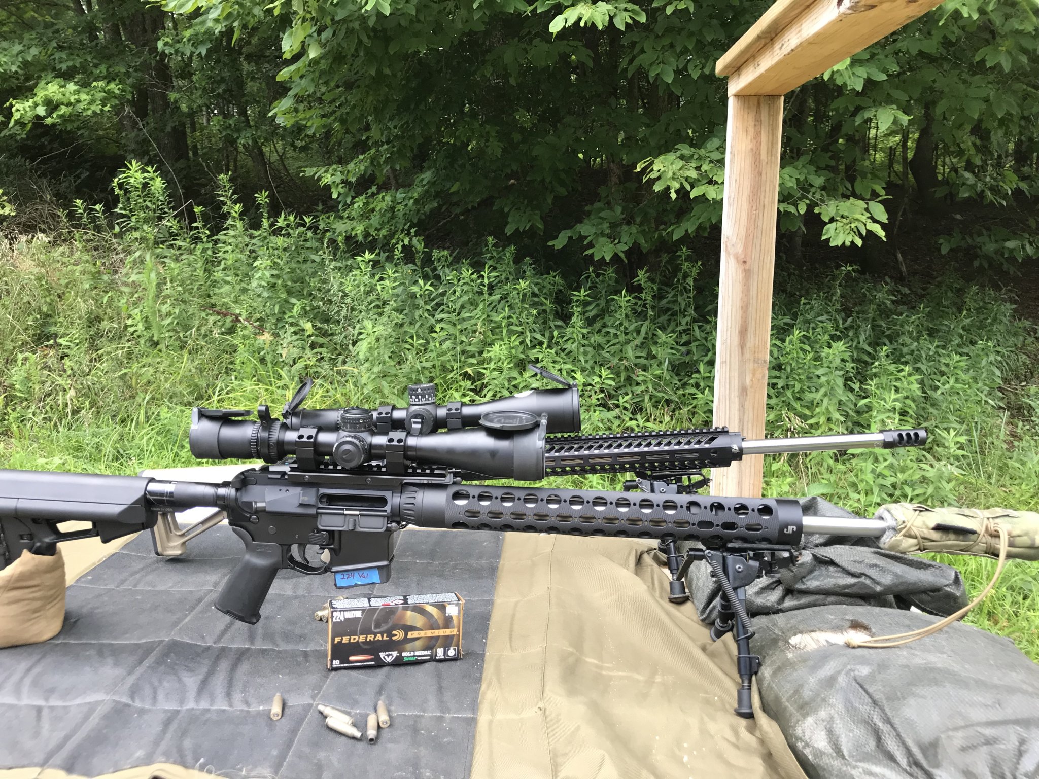

I am also building a Krieger/WOA 24" +2 1:6.5 twist upper and should have it back in a week or so.
As soon as I can get to a range I'll see what I can get started also.
Going to run factory 88's as well.
Mine is the 22" Varmint Barrel but yours is the Krieger upgrade. I hope you have better luck than I do with the heavier bullets. Let's compare notes ... as your odyssey is starting, and mine is in the latter stages. More Friday (with photos).
Tell me about it ... I've been nothing but perplexed since Version-1 of my .224-V odyssey. Now on Version-3 ... and still struggling.

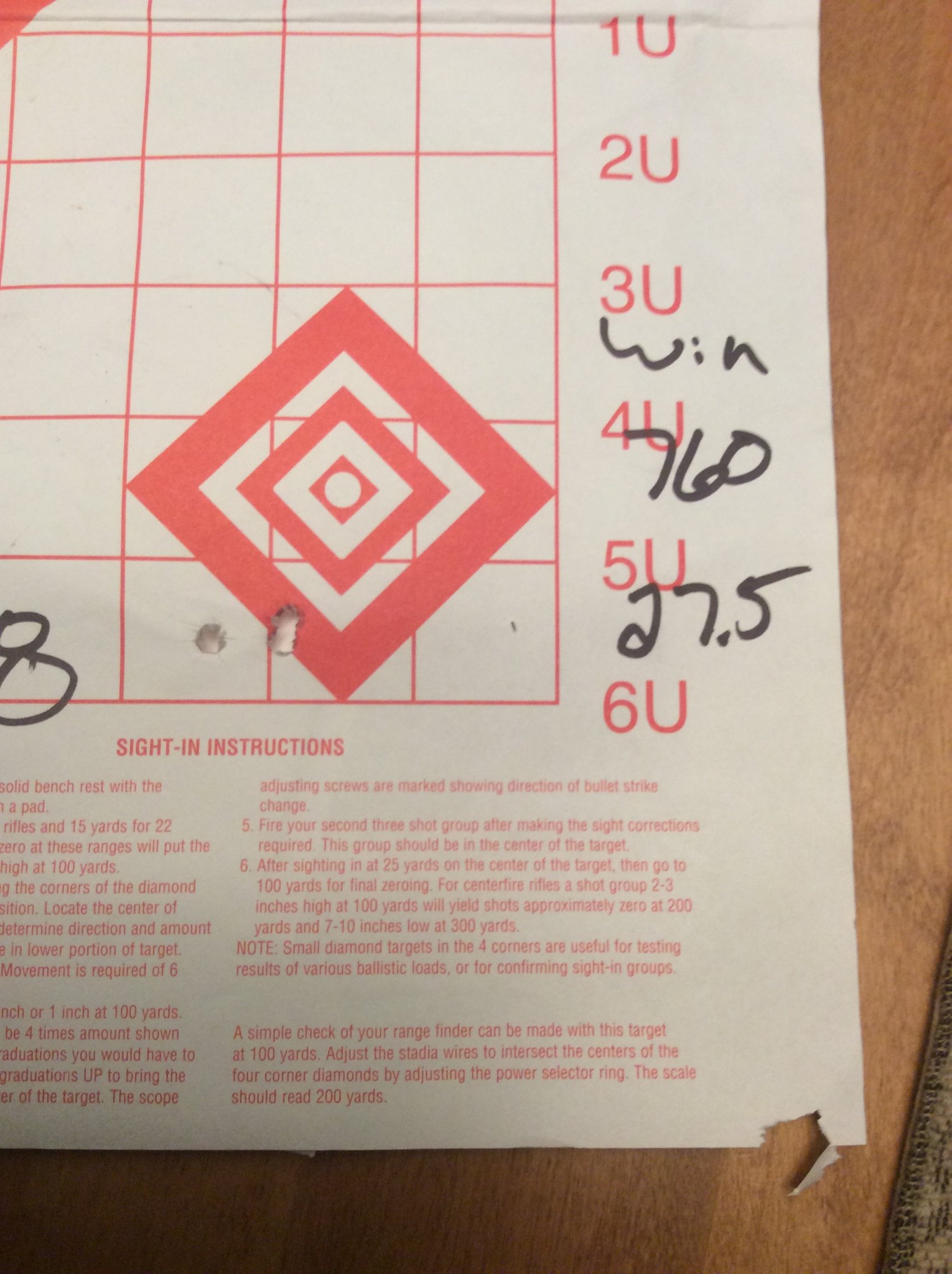

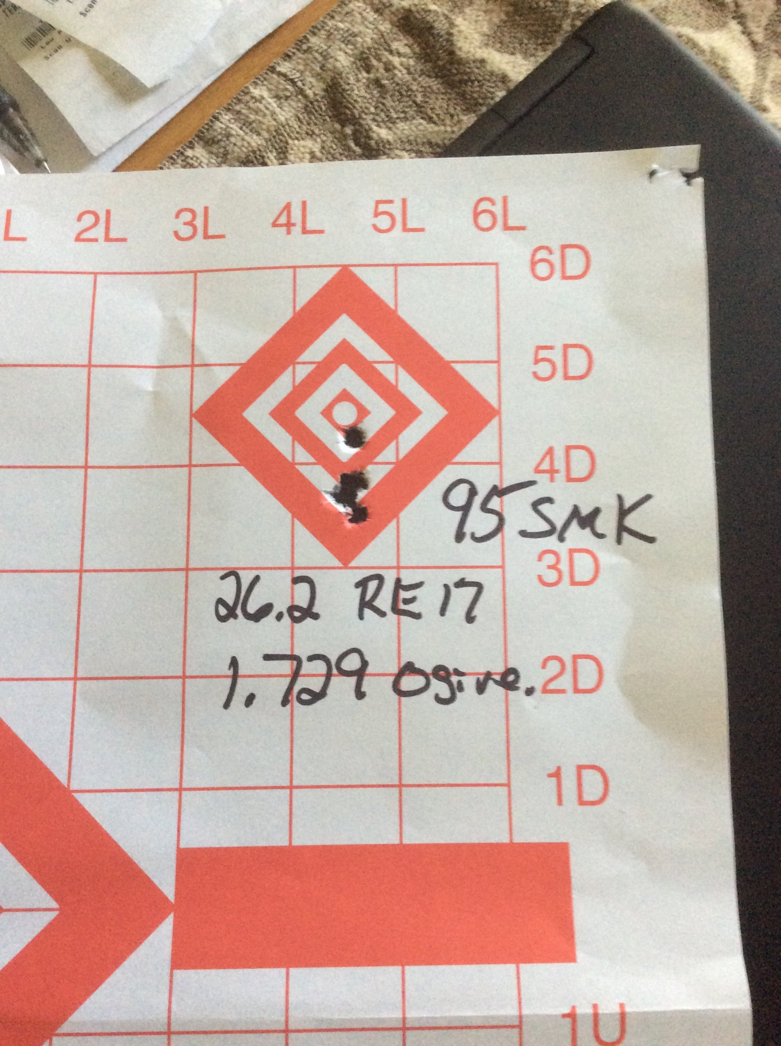

My best loads for the rifle is with 95 SMKs , Reloader 17 and Winchester 760. The group with RL 17 is six shots, after I chummed one high I had to send another, the win 760 is five. I've gotten first round hits on Praire dogs out to 750 yards with this combo and some steel plates shooting past 1000.
