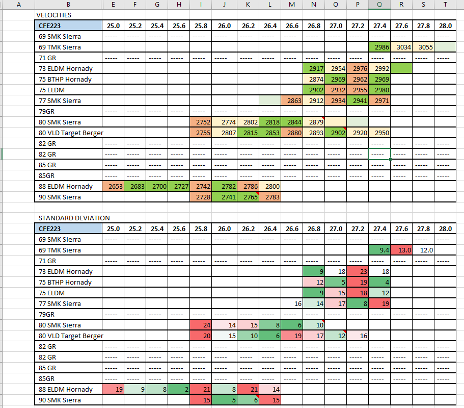

So I shot a load test today with the 224V to wrap up a project that tests SD vs Charge weights with increasingly heavy bullets. Essentially, I wanted to see if SD sweet spots were relatively "linear" for similar weight bullets and, if as you increase bullet weight, does the SD node move linearly with charge weights (vs lighter/heavier bullets). The results are pretty cool.
We know that heavier bullets need lighter charges, but looking at the data this way, you should be able to see the two distinct bands for decent SD's. If I wanted to to find a load with good SD and haven't shot that bullet before, I could load +- .2 on either side of a predicted "band" and see whether its worth pursuing for accuracy.
Two charts: one for charge weight vs Bullet using Velocity and the other is the SD. Thought it would be useful for anyone that wanted to see how CFE reacts to increasing bullet weights and charges. The dashed lines are "theoretical bullets" that I use to space the data approximately inline with linear increase in bullet weight. While I did shoot groups during this test, it wasn't to find a precision/group size correlation; Most bullets were shot at -.010 from lands and precision can be improved with seating depths. Average group ( 4shot) were around .7" but I found I had a loose suppressor for some of the most of the Hornady 73, and 75 grain bullets.

Sweet. Ironically, I just posted a bunch of data on the 88's and other bullets. Your speed and SD's line up with nodes I found in my barrel (26").
FWIW, It seems like there is an SD node with the 77's around 27-27.2 and likely another one around 26.2-26.4.

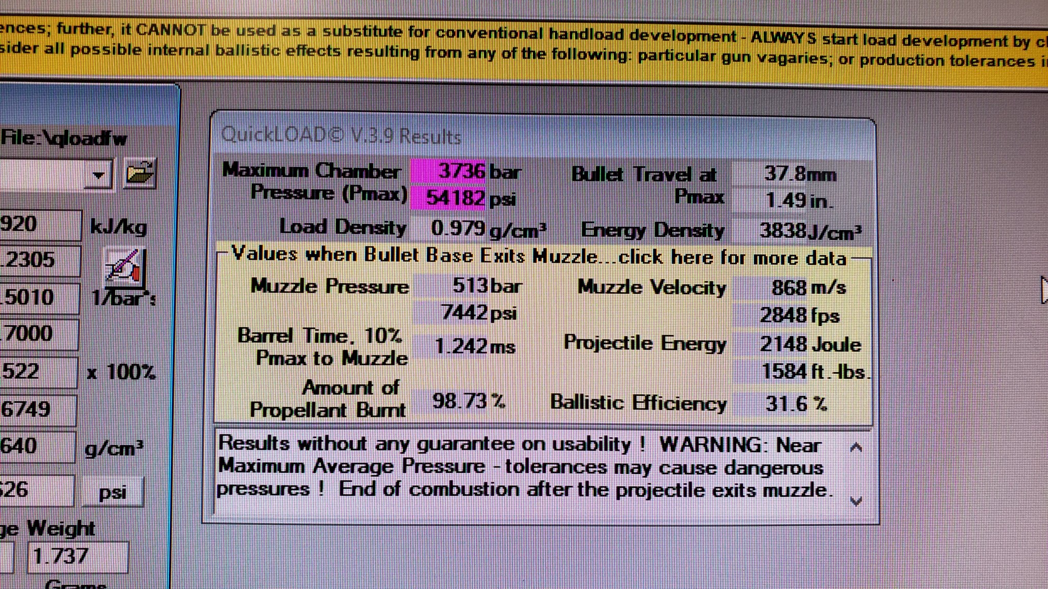

I was VERY surprised to see that QL predicted the exact velocity: 4 shots avg 2848 fps from LabRadar. I've loaded 80 rounds at 26.8gr to see if they hold up at distance over multiple shots.

Have a bunch of CFE223 on hand already, but may need to try some H4895.
Yeah I've got the 88s to be very accurate and work very well, the fastest I could get them to go was + or -2750 in a 24" 1-6.5 twist bolt gun. According to my ballistics that I have came up with a person would have to shoot the 88s 3000fps or more to get close to the 80's.
Most guys on the fb site are getting 2800+ easy. Some are at 3000fps with h4895 or 8208 xbr toped with 80gr eld's.
I started seeing pressure at 25.1 and 25.4....I'll keep my brass life anyday over 100fps and blowing out pockets in short order.
