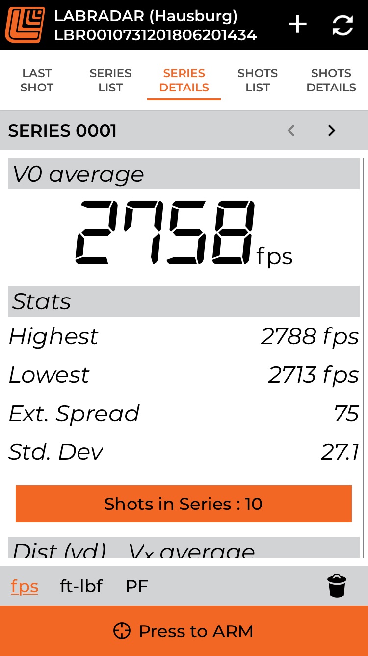

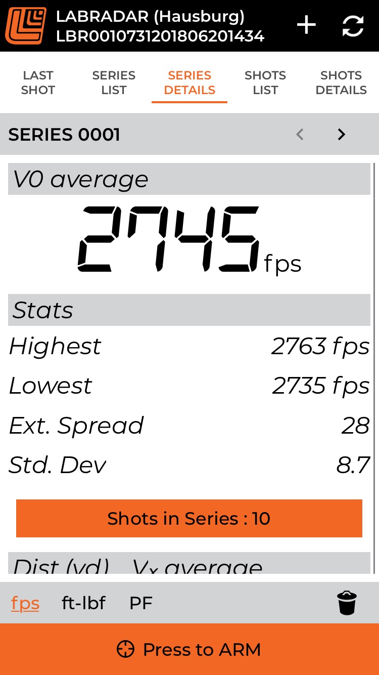

For a control group I shot 10 rounds of factory 90gr FGMM:
Accuracy at 100 was good, about .5 MOA.

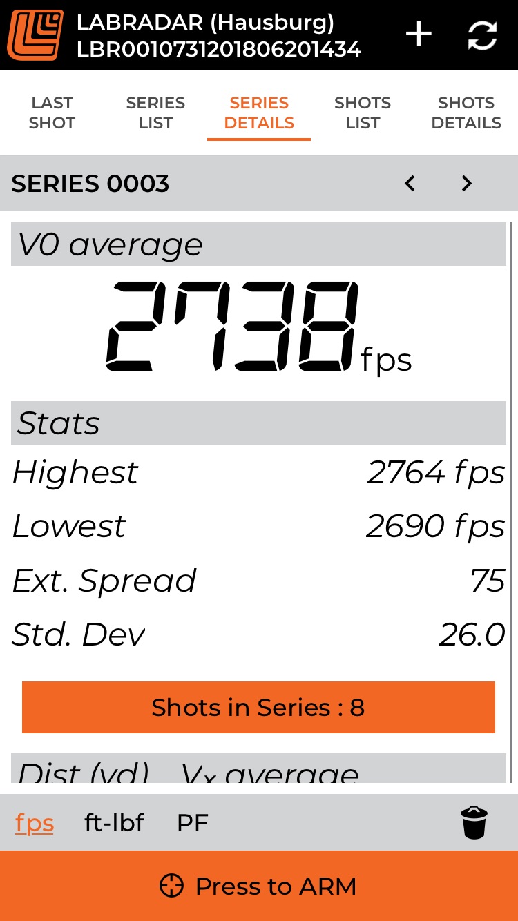

Okay, moving on, next was:
Berger 90VLD
Hornady virgin case
CCI 41 primer
26.4gr RL17
COAL 2.375
This was the best of the day and I neglected to screen shoot the LabRadar but I did record it:
(10 shot string)
AV 2720
HI 2736
LO 2701
ES 35
SD 10.3
Grouped about .5 MOA

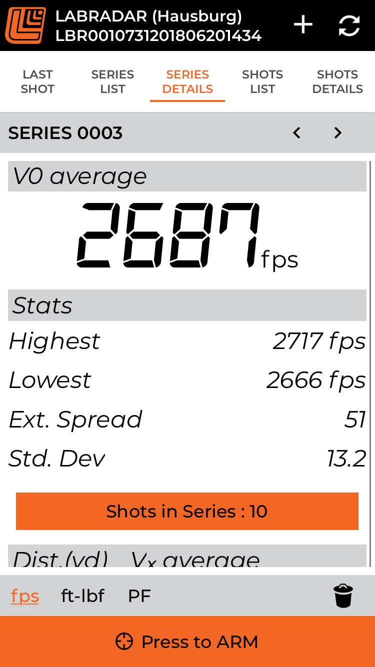

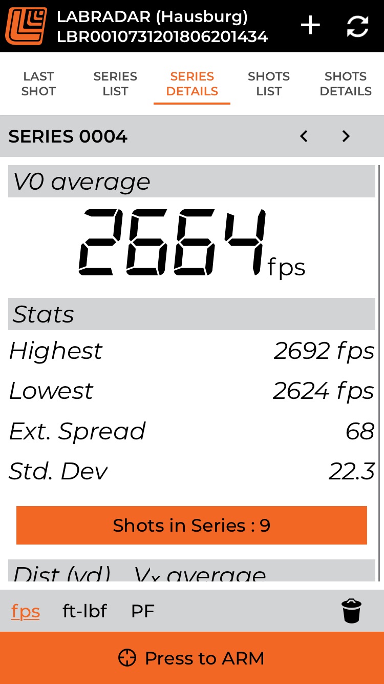

90SMK
Hornady virgin brass
CCI41 primer
26.4 RL17
COAL 2.292
LabRadar data:
This was disappointing, about one MOA.

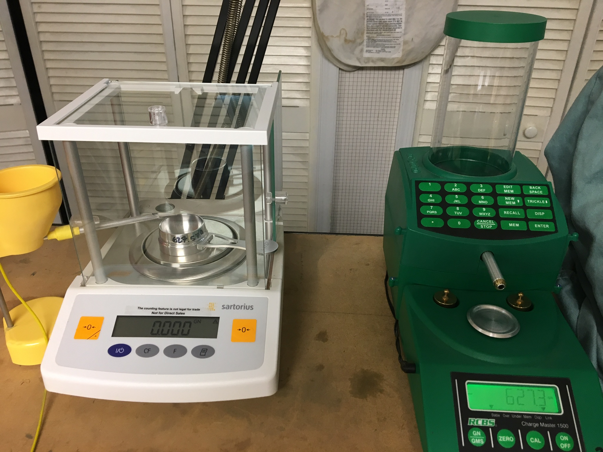

I did get a little crazy this morning and threw charges with one of my Charge Masters and trickled up on my Sartorious GD305..... New 95SMK:
Berger 90VLD
Hornady virgin case
CCI 41 primer
26.4gr RL17
COAL 2.375
(10 shot string)
AV 2720
HI 2736
LO 2701
ES 35
SD 10.3

90SMK
CCI41 primer
26.4 RL17
COAL 2.292
LabRadar data:

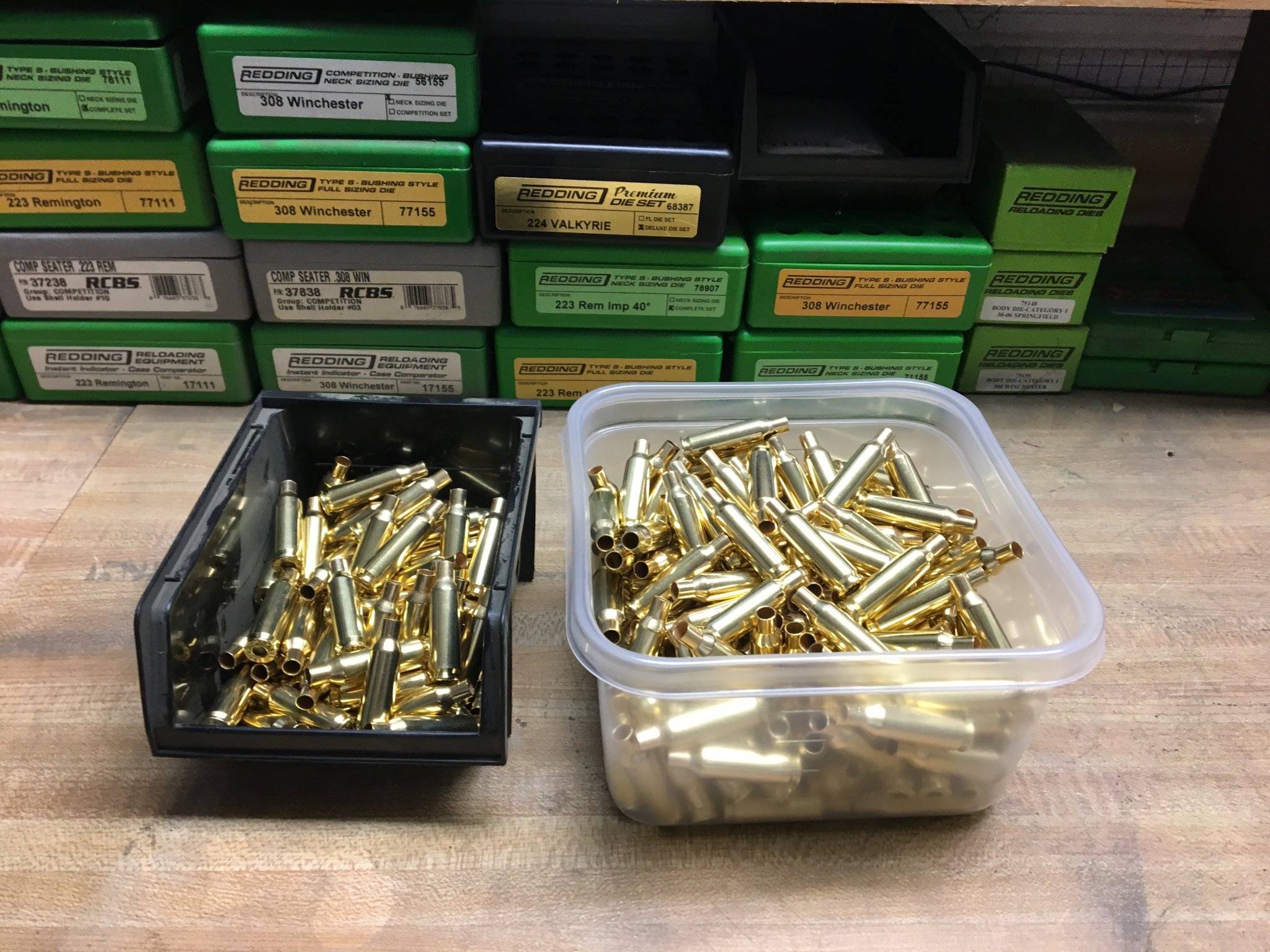

Just got a bunch of Starline brass. In an effort to keep the ES down, I head spaced all 250 pieces.
Most was 1.256-1.2565 and some was 1.255-1.2555. Since my fired brass measures 1.2615-1.262, I’ll use the bigger stuff first.....
Reactions: Subwrx300
Virgin Starline 224V brass has a wet capacity of 30.9gr.
All of my virgin Starline brass had neck IDs around .217.....
After running them through the Redding neck sizing die, the neck ID was .221. This isn’t great, but it’s better than .217......
After increasing the neck ID, wet capacity increased to 31.3gr, one tenth of a grain more than my once fired Hornady brass is at 31.2.

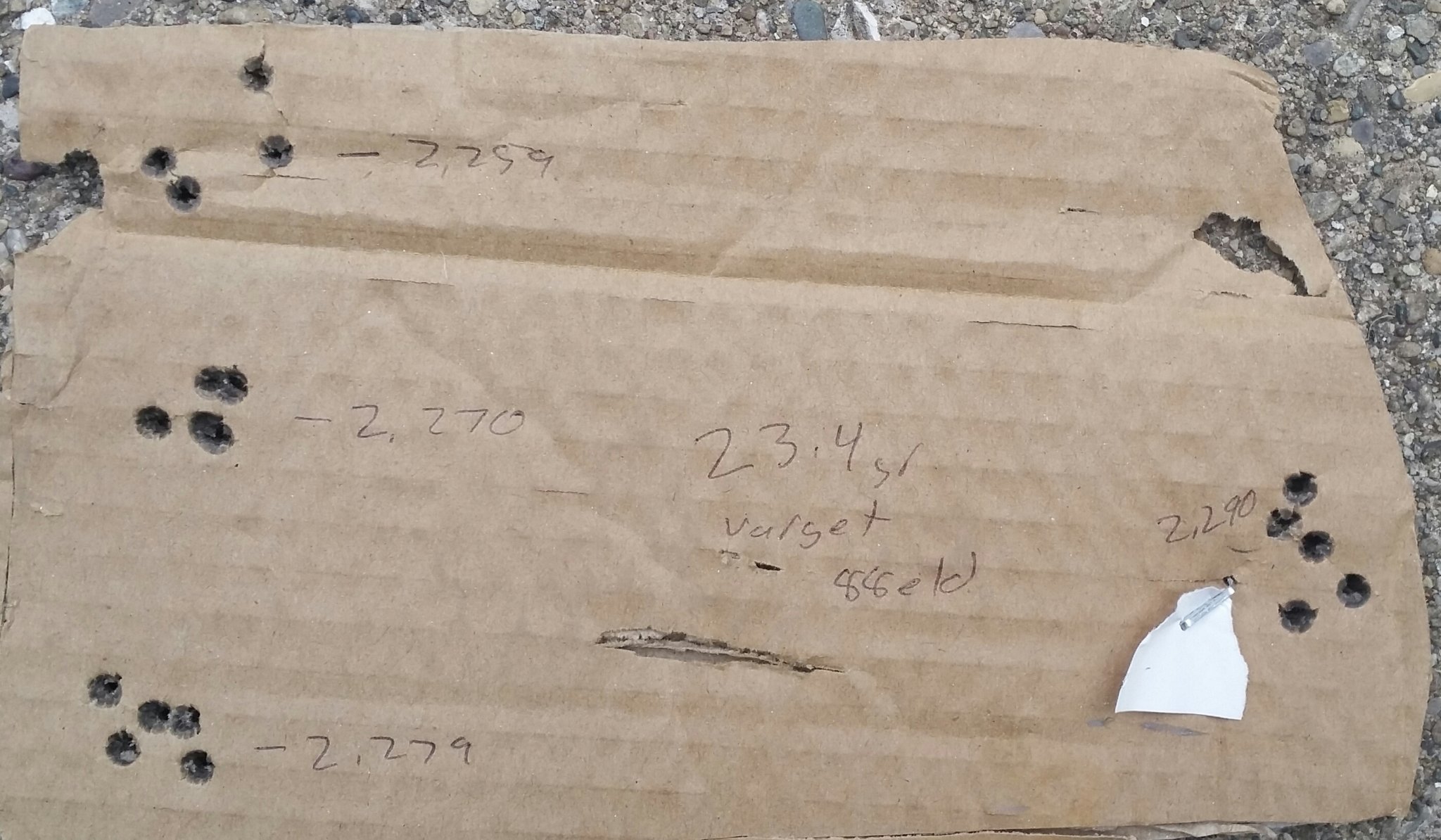

88 eld @ 2.300" with new federal brass trimmed to 1.590" and Varget was not good at all. Best group was around 1.5" . Barrel is a 22" Stagg 1/7 twist . Might retry again and load to 2.260" ?
i was above the published max and was around 2720.... didn't show pressure signs but the primer pockets were toast after one firing ! velocity means nothing to me without accuracy . staying within the published parameters of hodgdon and sierra yielded under 2600 fps with my barrel and no accuracy!
Hmm.

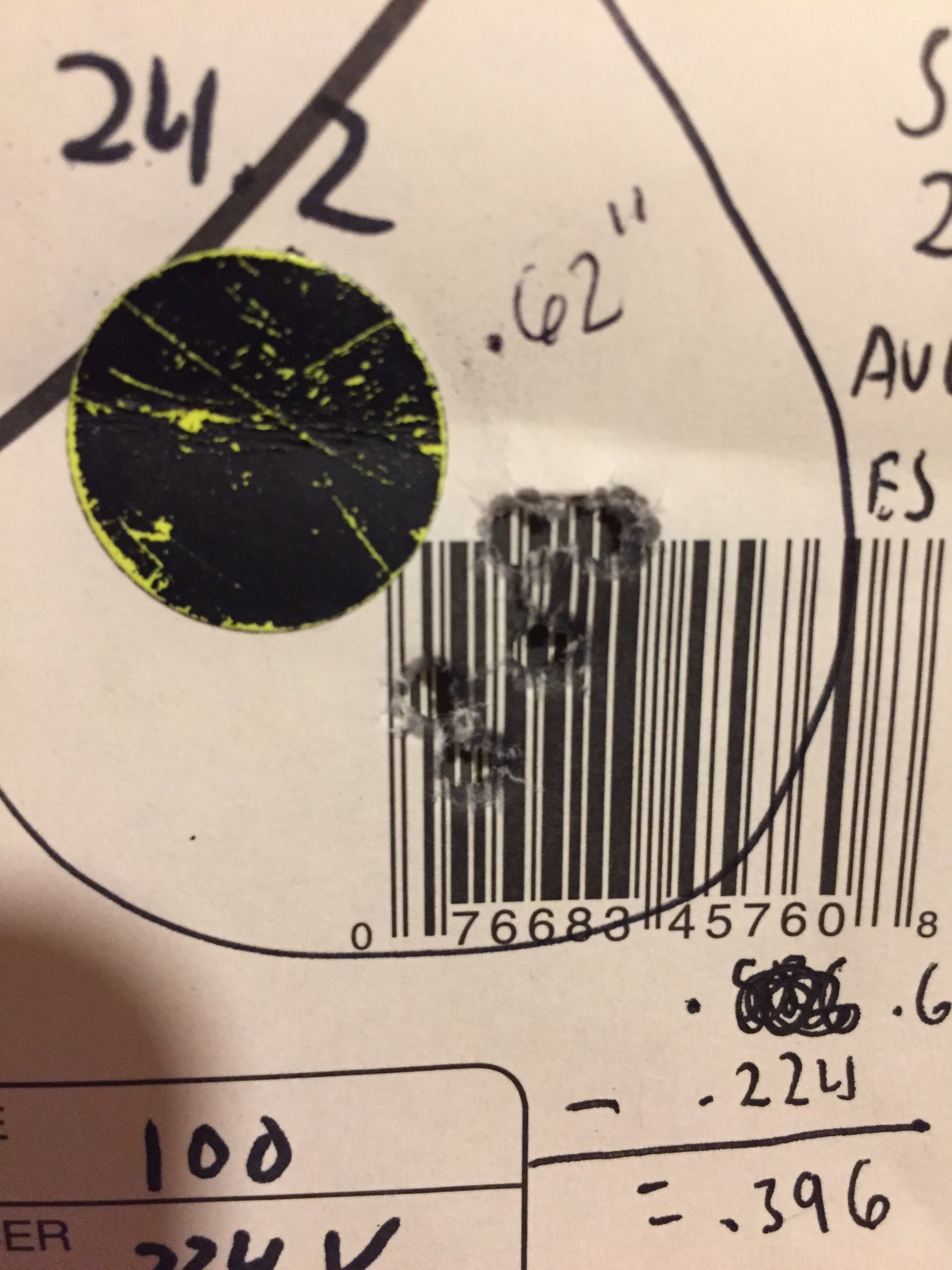

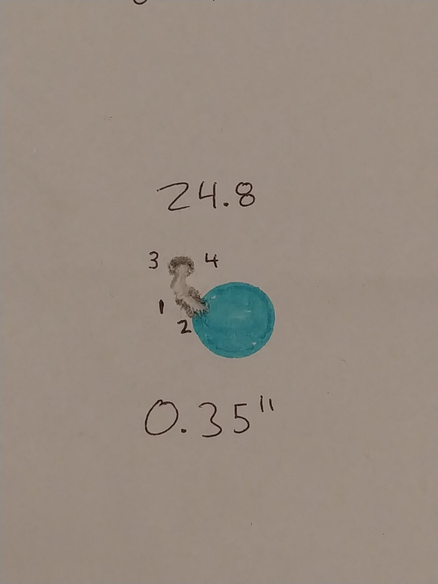

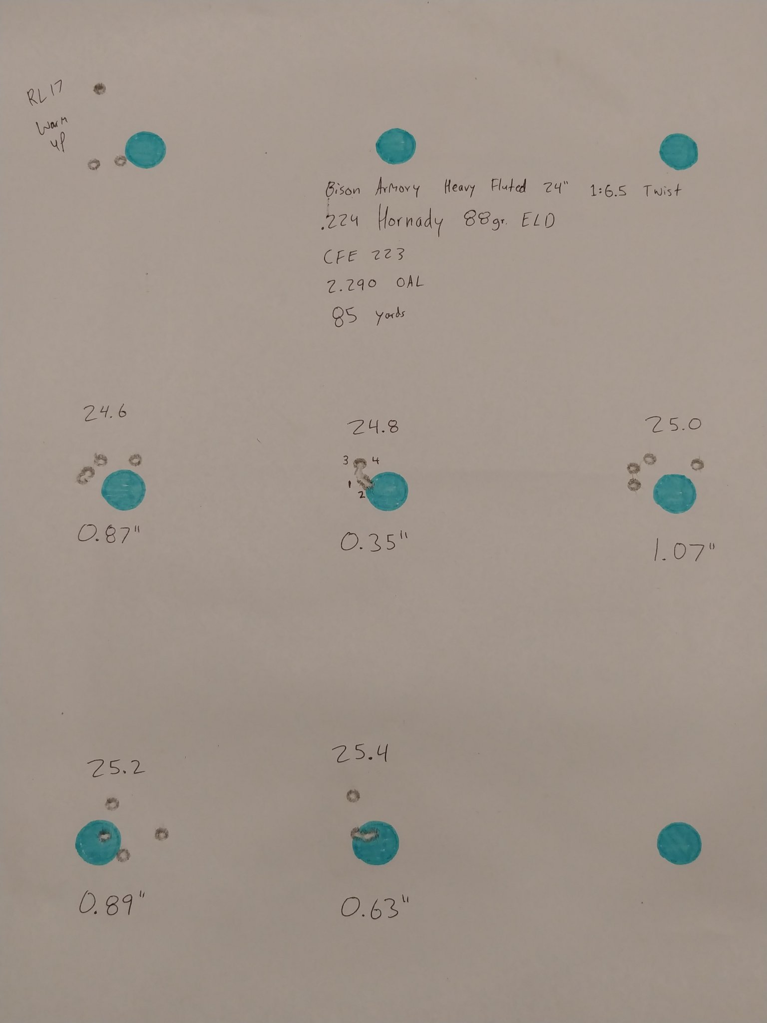

I'm having good results with the Hornady 88gr ELD and CFE 223 (thanks @Subwrx300 for posting your data). Started with the 95gr SMK, tried WIN760, RL17 and CFE 223 - best group was .75" and even then I had flyers. Most 95 SMK groups were 1-3". The Hornady's shoot significantly better in my barrel. This was at 85 yards (max at indoor range). All groups were 4 shots. On the 24.8gr group, the top hit looks wide to me, I'm hoping that was my 4th shot. Will shoot 100y and out to 500y this weekend, we'll see if these groups hold up at distance.
Bison Armory Heavy Fluted 24" 1:6.5 twist
.224 Hornady 88gr ELD
virgin federal brass, untrimmed, chamfered, outside neck diameter sized from .250" to .247" before seating
Winchester small rifle primers
2.290 OAL

the new hornady data for the 88 eld is very close to what I saw with using varget in a 22" barrel. just didnt shoot well. Are you guys having good success with CFE and the 88 eld in a gas gun? I really want these 88's to work!
I am having great success with CFE. It requires good metering as it's about 20fps per .1 grain but it meters very consistently. Node around 25 Grains +- .2 grains.
Multiple 5-shot groups avg .5-.7" with fired brass (or less).

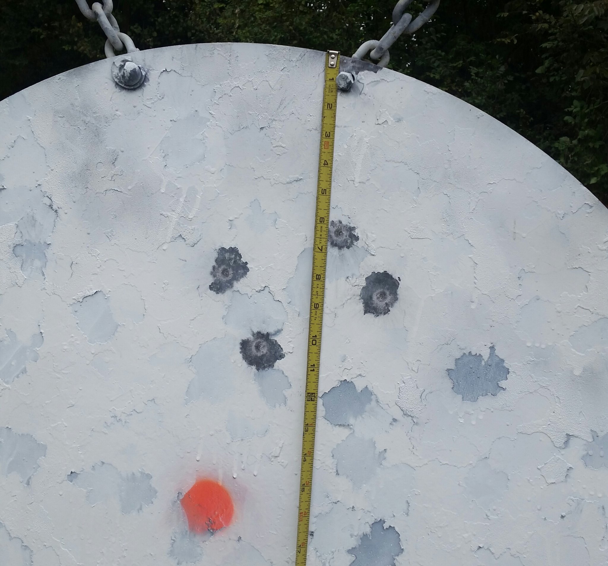

I got out last Saturday with the intention of shooting the 90VLD and 95SMK loads I posted above at 300 and 600 yards.
The weather was shitty to say the least: 73F, 98%RH, drizzle, gusts from left to right @ 10mph and a 1700’DA.
As the range went hot @ 0900, a rain squall blew through and it poured for 10 minutes.
Not ideal conditions.
Between strings I covered my LabRadar with a plastic garbage bag that I found in my truck.

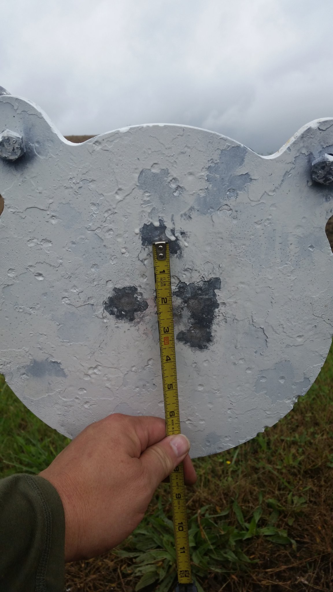

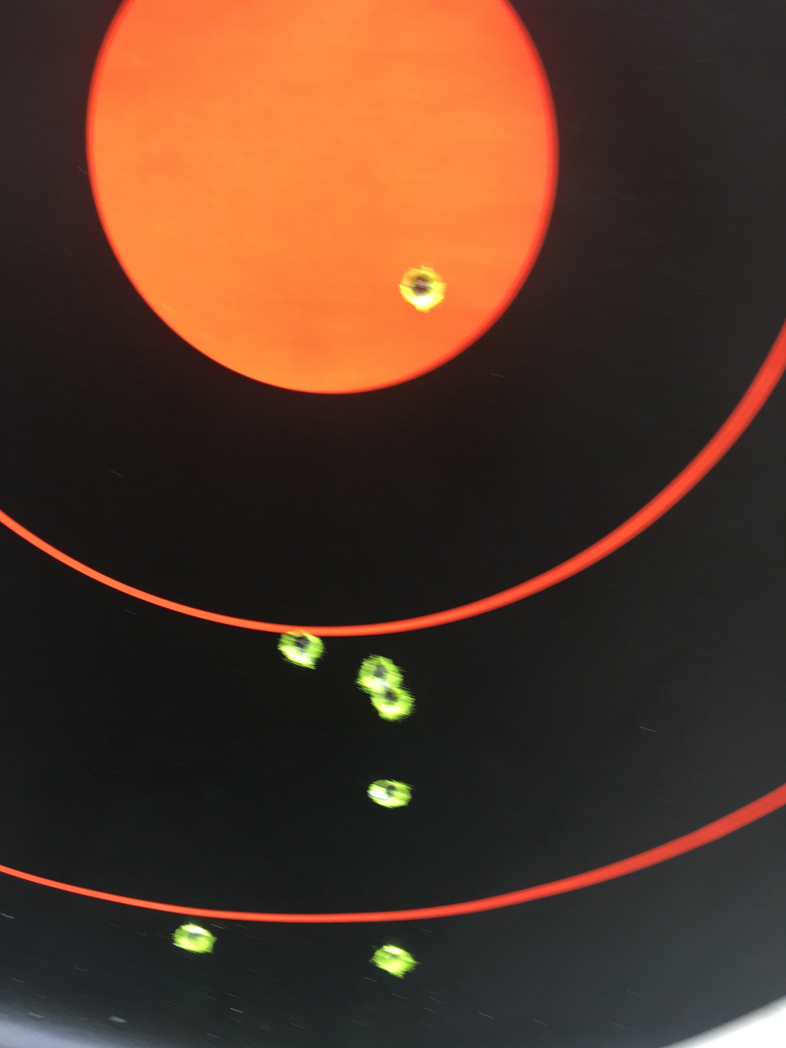

Anyhow, for the first string at 300yd I was gonna try my 90VLD load in my carefully sorted new Starline brass.
90VLD
CCI41 primer
New Starline brass, sorted by headspace, neck sized with .002 neck tension
26.5gr RL17 weighed on a Sartorious GD305 to .010gr
COAL 2.375
Embarrassing, and the target was worse.
Crappy.
I dialed 6.0MOA for the first shot and dialed down to 4.5MOA for the rest because I decided it was easier to see the hits in the black.
There are 3” between the middle rings.
What you’re not seeing is the hits that went way high and way low due to my lovely ES.

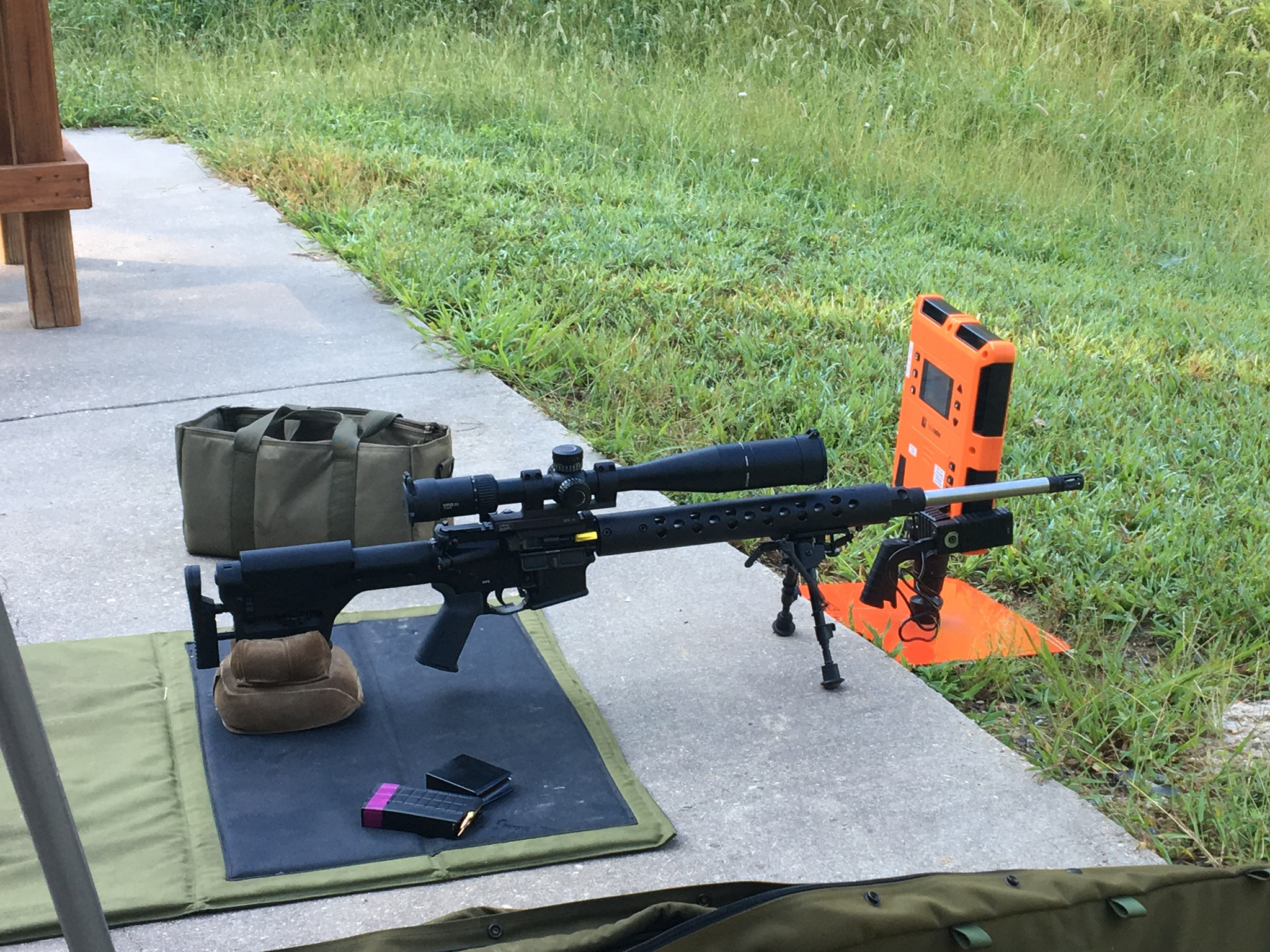

Velocity testing, 95gr SMK loaded to an overall length of 2.290 with RL-17 in new starline brass and CCI #41 primers.
two shots each charge weight over a magnetospeed from my 22" Bartlein barrel with rifle +2" gas system smithed by Craddock Precision.
25.4gr= 2557, 2554
25.7gr= 2583, 2589
26.0gr= 2605, 2608
26.3gr= 2670, 2693
I stopped right there as that is a huge jump in velocity. 26 and 26.3 had ever so slight ejector polishing on the case head. One thing to note I was running my gen 1 JP SCS buffer system with the lightest spring weight so switching to the gen2 H2 SCS and or a heavier spring may delay the opening enough to get rid of the slight ejector marks.
Next up will be group testing and I think I'll start around 25.0 and go up to 26.0

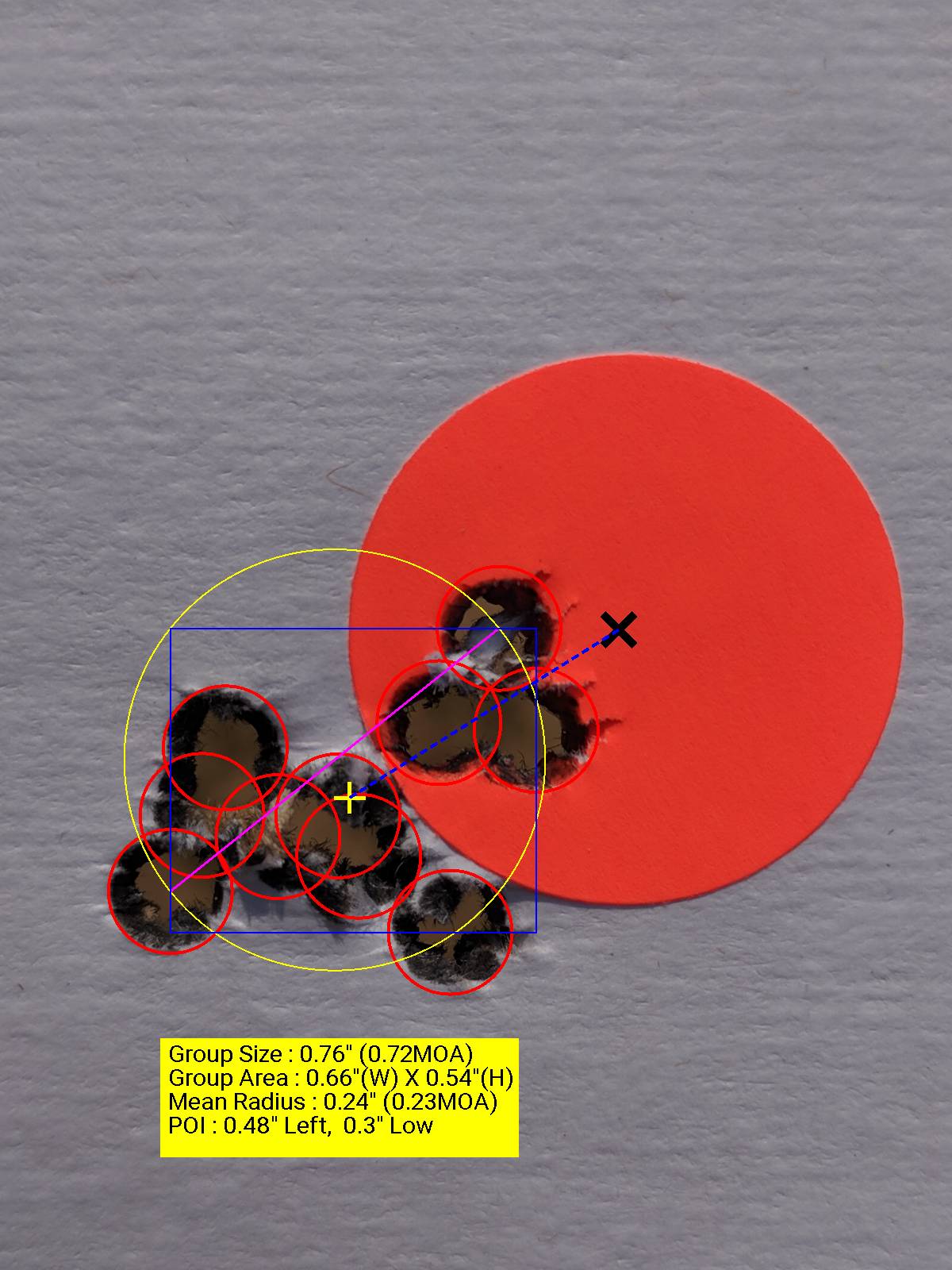

20" Green Mountain blank 1:7t , I spun to a heavy profile in the lathe
Rifle length gas with SA adjustable block set to hold the bolt open on all reloads
Virgin FED brass run over the expander ball to round out the mouths, trimmed, chamfered
CCI400
H414
2.300" OAL in PRI mag
4 shot group @ 105yds:
25.6, 26.2 and 26.5 were also 4 shot < MOA but I'm showing slight pressure signs at 25.9, and getting worse at 26.2 and 26.5.
I know, I know, whoopy! 2536fps, but I ran the numbers and it's still super out to ~1200yds and I can actually reuse the brass.
88ELDs didn't like H414 as much, so I'm going to save the H414 for the 90s and try Varget or CFE with the 88s.

Here's the Varget info I shot yesterday:
Load, fps, SD,ES 4 shot group size
22.6 2511 8,17 0.94
22.9 2526 5,12 1.23 3 into .77
23.2 2572 29,62 1.52
23.5 2608 26,59 0.85 3 into .3
Not my best day on the trigger, range was packed and everybody wanted to go check their target every 5 minutes, so cold line, hurry up and shoot, etc.
Virgin FED brass, mouth run over expander ball, trimmed/chamfered
CCI400
2.300OAL
23.5 was just starting to show the little shiny circle, but no swipes like factory ammo in my barrel.
I'm going to zero in on the 22.6-22.9 in one grain increments. Not thrilled with the velocity, but would rather have single digit SD than +80fps with SD in the 20's...

I actually just picked up CFE223 because I was jealous of Subwrx300's groups.
Good call with the Superformance though because Johnny's Reloading Bench got some pretty good groups with it.
Yes and was very consistent SD and a .5 moa group. I pull a few because I'm using a stock trigger still. Going to upgrade this week.

Jump testing 88eld, 2.270 was best and measured .54ctc, 2.280 came in second just shy of .75ctc. The length to lands in my 22" craddock barrel is 2.340".
This is with starline brass and 23.4gr varget using cci Milspec primers. I'll be checking velocity next.
Jump testing 88eld, 2.270 best at .54ctc 2.280 second. Length to lands in my barrel is 2.340".
Was just about to post asking if anyone had tested different OAL's, thanks for the results. My Length to lands is close to 2.340" as well. I've got the PRI modified mag, does it make sense to try past 2.30"? Any danger jumping all the way to lands in semi-autos?
The pri mag will fit 2.295ish without modification. The reason I tested this is I can't reach the lands. Many times bullets preform their best around the -.010 to -.030, so if you have that opportunity with modified magazines it's worth a try. Moving closer to the lands will generally raise your chamber pressures a bit but unless your right at the ragged edge already, you should be fine.
2652 over 7 shots 23.4gr varget 88 eld at 2.270"
500 5 shots, paints running because I covered up someone's impact... honest. Used 3.1 mils elevation
1000, 1st shot at the top of the plate, remaining four lower. Used 10 mils of elevation and looks like I needed 9.7ish
I was using G7 of .268 so loops like it may be a touch higher given my impacts.

500 5 shots, paints running because I covered up someone's impact... honest. Used 3.1 mils elevation View attachment 6947987

I did the same but to no avail. Tried all four factory loads from federal, 90 smk shot best producing one half minute group but wouldn't replicate and is stringing all over. frustrated to say the least.
Well, I had a death in the family
and was off line for a while, but I finally got to test the HDY 88gr ELD-M / Alliant PP2000-MR combo today. I used the top four recommended loads in Hornady's published data: 24.3 gr, 25.3gr, 26.4gr & 26.9gr. The 25.3 gr load was the clear winner in my rifle. It put 4 rounds into 0.315" @ 100 yards, but I had the inevitable flyer with the last shot that expanded the final group to 1.185". I swear the last shot jitters on a really good group is pretty much the same disease as deer fever. Lol! This load should give 2600fps in my rifle. Will chrono it at a later date.
The 24.3gr load was all over the place. 26.4gr was even worse, but with slight ejector marks. 26.9gr tightened up a bit, but worse ejector marks and some primer flattening.
Hornady 88gr ELD-Match
25.3gr Alliant PP2000-MR
Starline case
Federal Gold Medal 205M SR primer
1.710" CBTO / 2.275" COAL / 0.02" Jump
Frankenparts .224 Valkyrie, 24" 1:6.7 heavy barrel, Sanders upper/BCG, rifle+2 gas, JP H2 buffer, Timney Targa 2-stage, Magpul plastic, Acme Machine 6-24X50 scope in Burris PEPR mount
