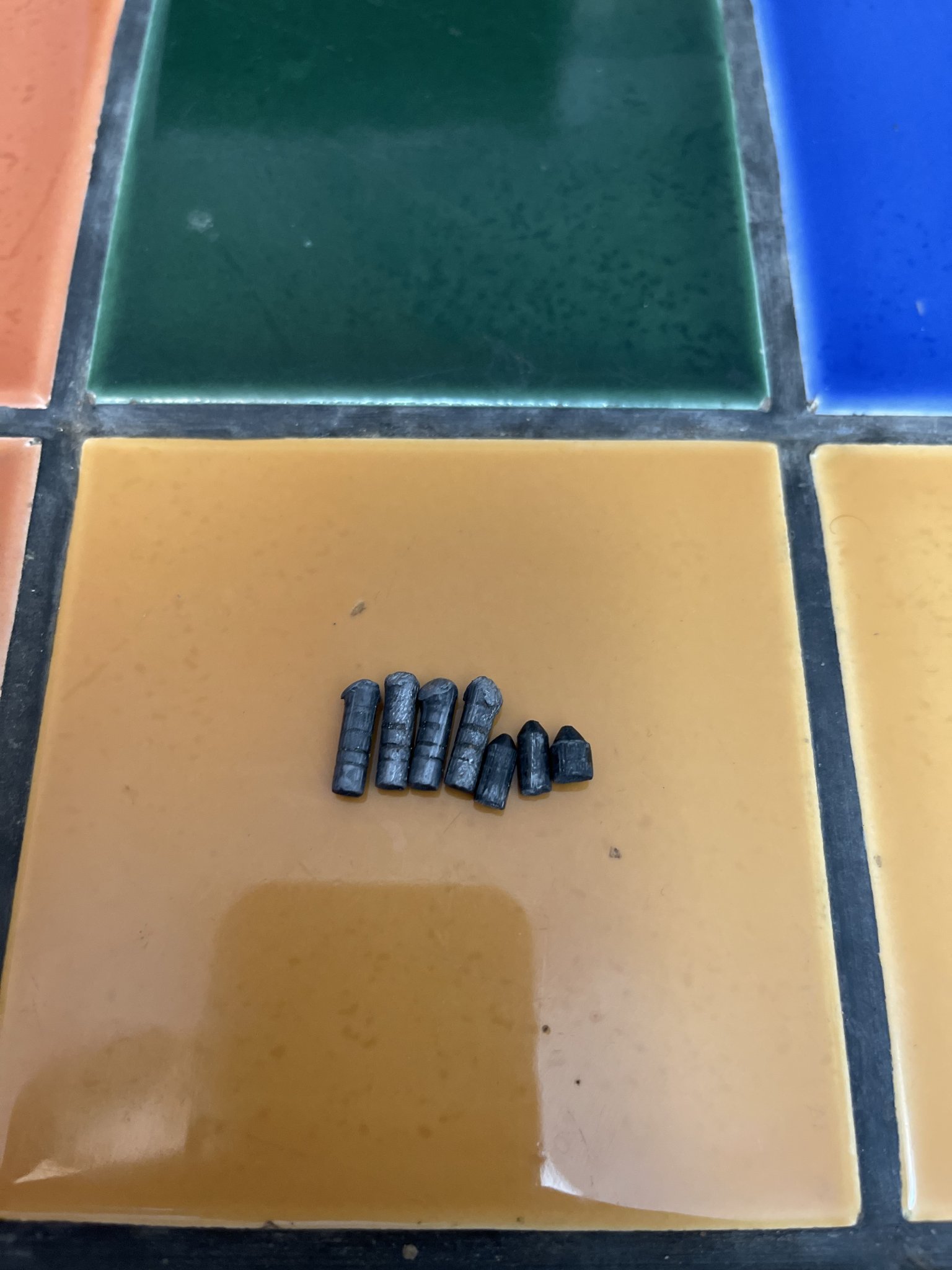

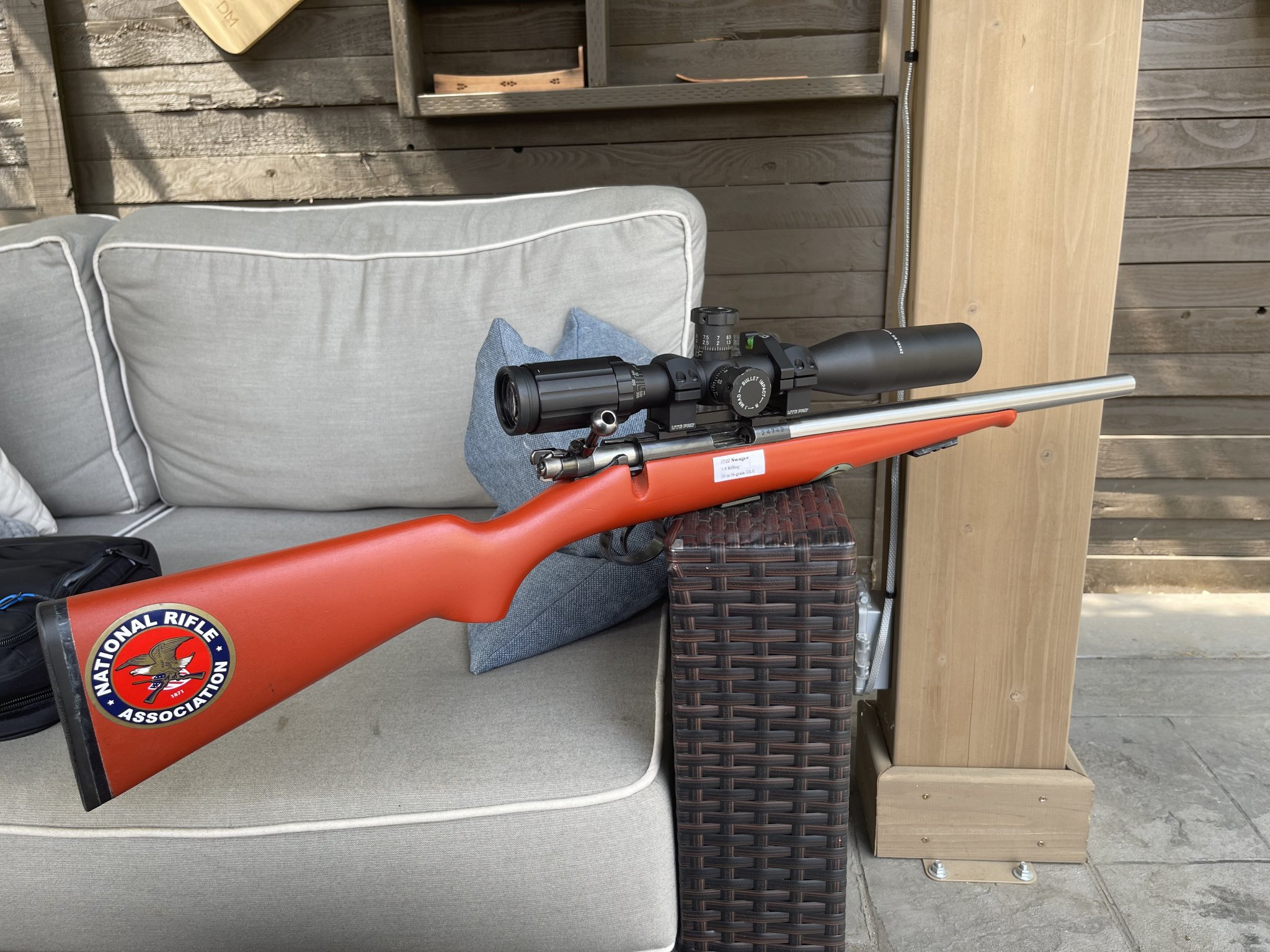

This thread is fascinating. I have a fast twist rimfire. 1:8 PacNor .172. barrel. Chambers 22lr. and swages the bustles down to .172 upon firing. The barrel will stabilize bullets up to 36gr. IT IS NOT A MATCH ACCURATE RIFLE. It is a hunting/varminting gun built before the 17HMR was a thing. However, it has occasionally shot 1-inch groups at 100 yards with yellowjackets (33gr) and Federal 724 (31gr). It seems to shoot any 36gr hv truncated cone hp bullet just over MOA at 50 yards. Armscor Precision is an example. The barrel started life at 24 inches but after 19yrs of lugging that heavy beast around I had it shorted to 16.5. It shoots the same as it did when 24 inches long.
The photo shows some recovered 33gr yellowjackets, some recovered 20gr CB short bullets and one 20gr bullet recovered from firing out of a .22rf. barrel. The choke is just ahead of the chamber and short. Randy at Connecticut Precision Chambering cut the chamber. If decent hunting accuracy can be had from a choked barrel shooting hyper velocity ammo, then I think that match ammo from a match chamber spin a bit faster can be very accurate. Folks with money keep pushing, please!
P.S. in October 2001 I wrote this rifle up in the now defunct Precision Shooting magazine. Some of you may have copies.
Woah! That’s pretty cool.

Thanks. It is fun. I have not shot it past 100 yards, at least not that I recall. This thread has inspired me to do so. It is being restocked at the moment. It is receiving a laminated stock with adjustments and enough meat for the barreled action. this skinny sporter stock is ridiculous on the rifle! When I get it back I will put a 25MOA DIP cz527 rail on it and start testing out to 300 meters. The action is from a Brno model 1. Basically cz452 but with the wider cz527 receiver dovetail, and a two stage trigger.
