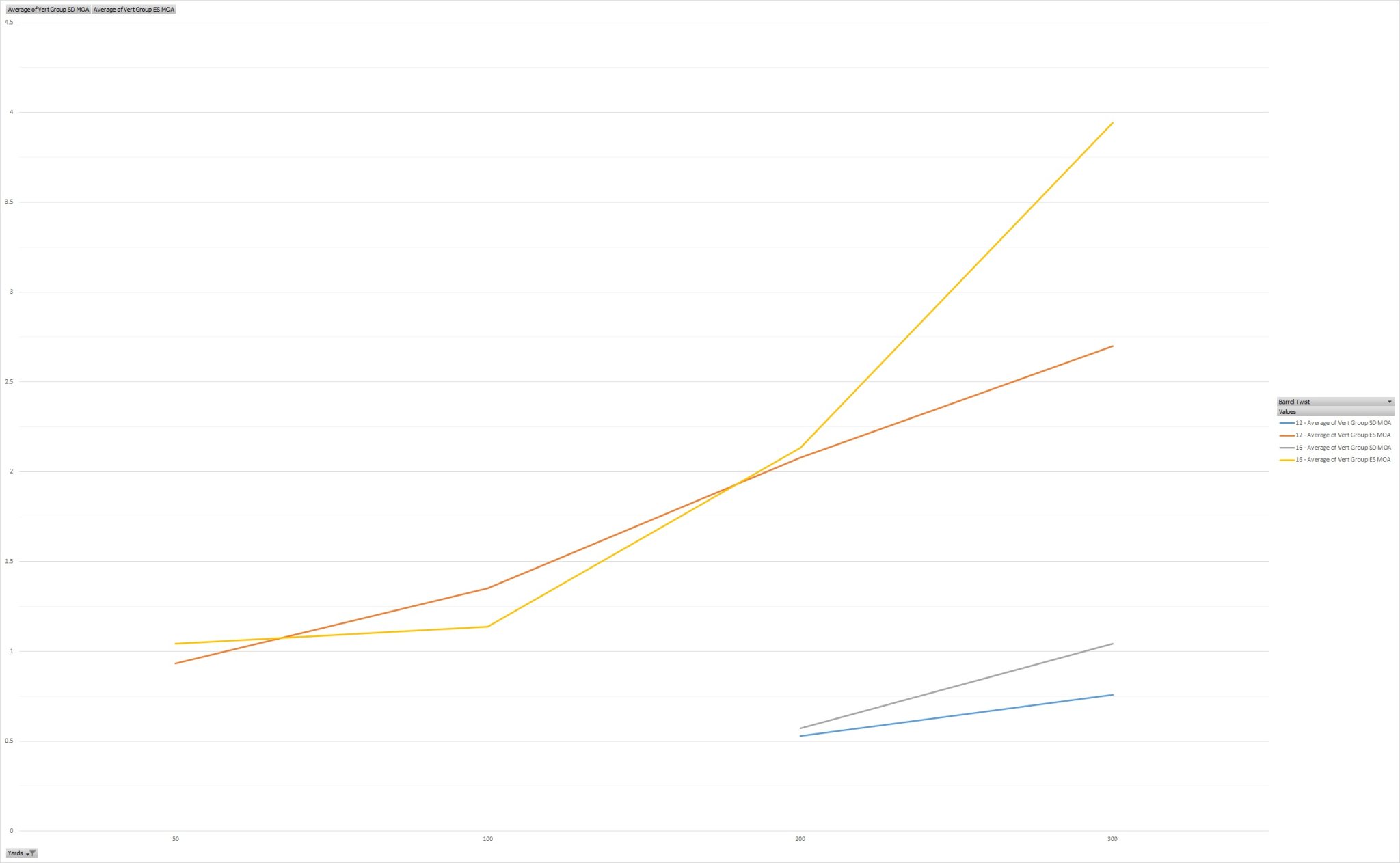

What I do is record my data into excel this lets me look at lots of data and compare very easy.

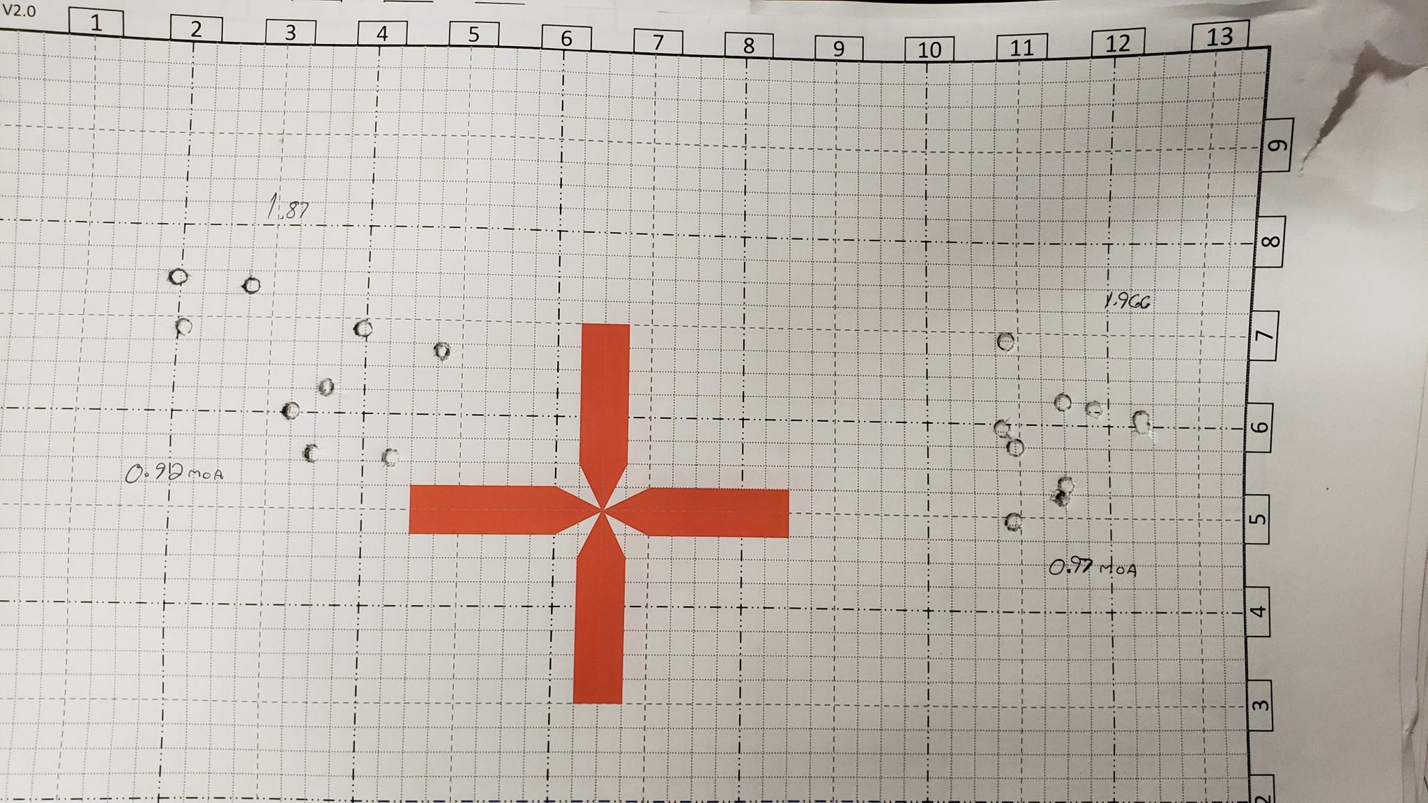

I dont know if this picture is clear but it is a selection of 5 or 6 different midgrade ammo that shot simular at 200 yards to compare the rate of group size increase at 300.
PLEASE NOTE this is NOT the best groups these rifles do but ammo types and lot numbers that shot simular vertical groups at 200 yards in BOTH rifles.
Edit. I dont calculate group SD at 50, 100 its too hard lol

Yes I only look at vertical. I often have wind so I dont test on head or tail wind as that induces to much vertical. I stick to full value days and less then 1.5 mil wind.
I dont make a practice of posting all my targets. It would be a pain and because I do 20 shot groups most people will go "thats no good look at my awesome one off 3 shot group" I dont have the time to waste.

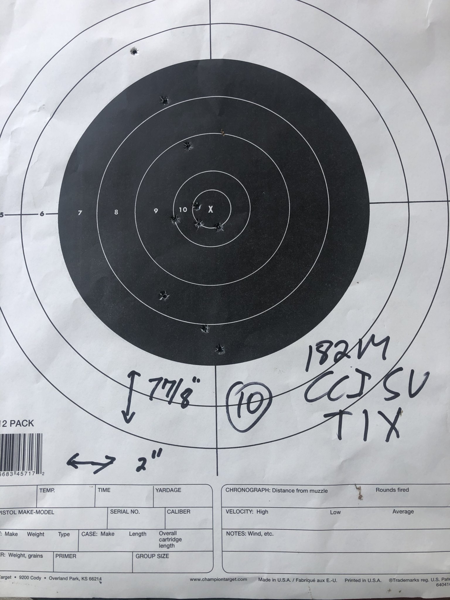

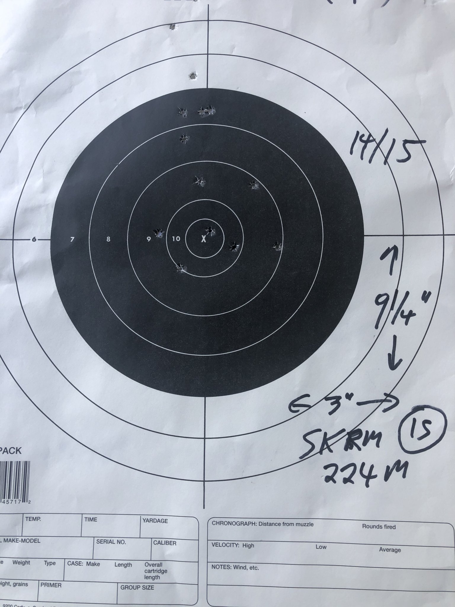

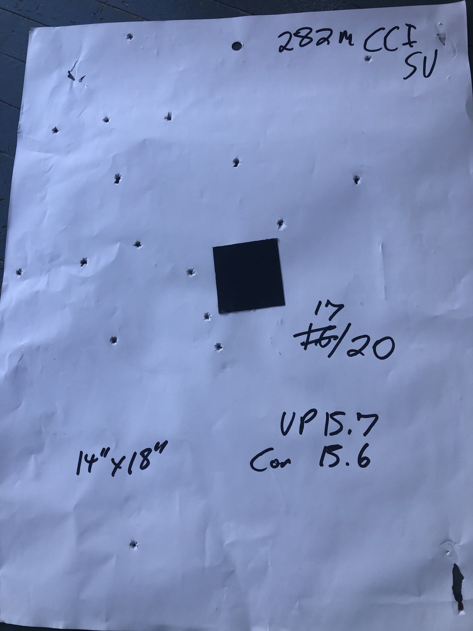

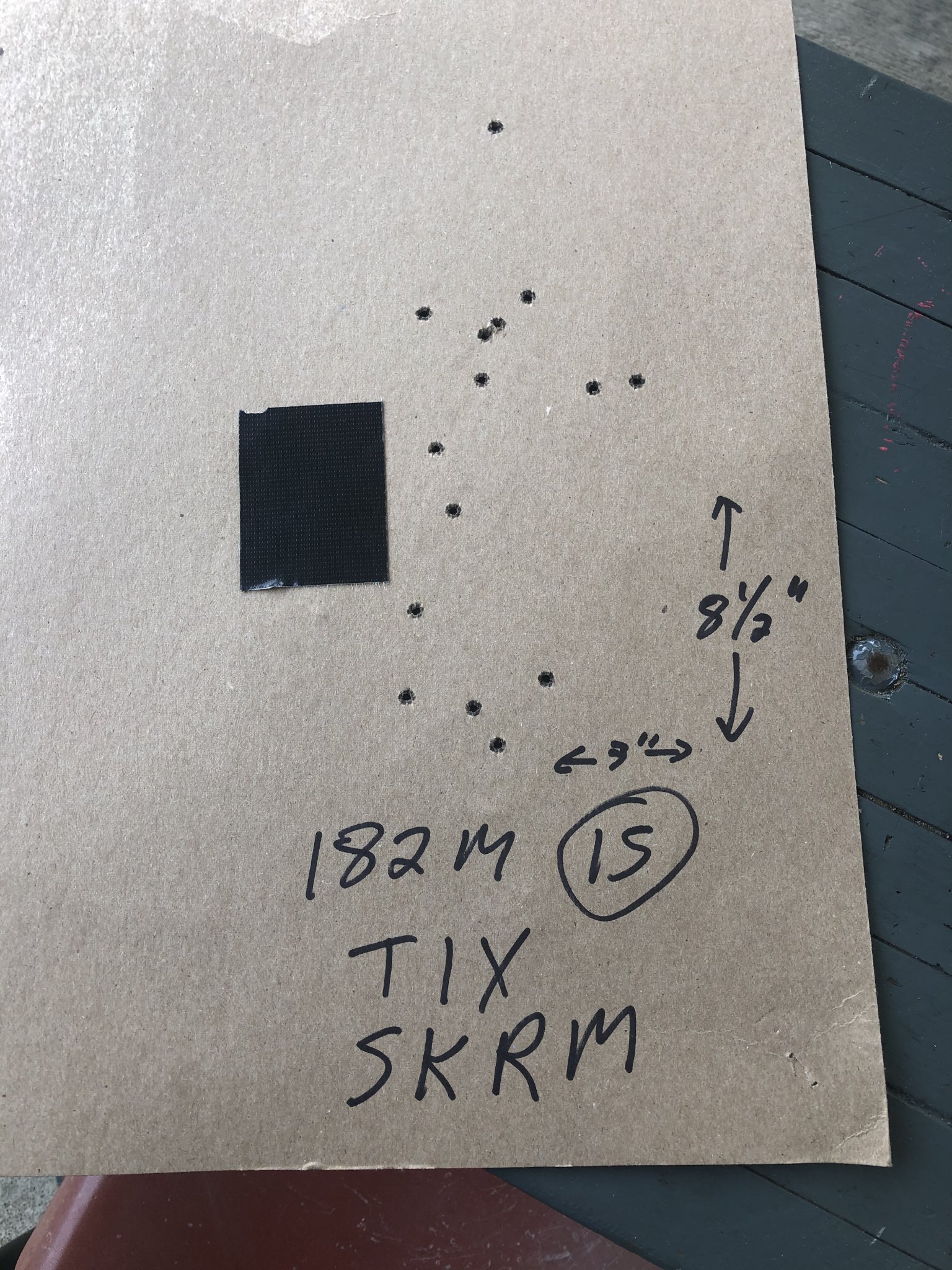

I think perhaps you are the one coming on strong. Wasn’t it a 4 shot group you posted at 200? I do not pretend to shoot as well as either of you, and my gear certainly wouldn’t allow it if I could, but a couple years around here also is a poor representation for a whole life. I know what Rimfire 4 round groups vs 10 or 20 round groups look like because I’ve shot a lot of them. My average at 100 was 1.78” for 44 10 rnd groups for the first half of this year or so, mostly for testing and zeroing. My shooting volume is middle of the road, 19.5K Rimfire this year so far. At 200, vertical is around 9” and horizontal is usually under 3”. 300 is 16”vertical and 14” horizontal, with a factory T1X, CCISV, and 10+ round groups. Your 4 rnd group looks like my lucky 3 round group. An accomplished shooter such as yourself should easily be able to show me how it’s done. Especially since your rifle is high end.
My interest in this thread is because I’ve got a 1:12 sitting here, and some slightly more consistent ammo to test in it when I get it installed. My expectation/hope is to lower the vertical spread a bit at 200, and really tighten things up at 300. I’ve spent some time ringing the gong at 400, but it’s too unpredictable to be called a group. There is a lot of naysayers about 22LR barrels faster than 1:16, but about as many actual testers of them as those who can show good high volume groups at 300. I would appreciate seeing your results for 10 or 20 at 300.

I think perhaps you are the one coming on strong. Wasn’t it a 4 shot group you posted at 200? I do not pretend to shoot as well as either of you, and my gear certainly wouldn’t allow it if I could, but a couple years around here also is a poor representation for a whole life. I know what Rimfire 4 round groups vs 10 or 20 round groups look like because I’ve shot a lot of them. My average at 100 was 1.78” for 44 10 rnd groups for the first half of this year or so, mostly for testing and zeroing. My shooting volume is middle of the road, 19.5K Rimfire this year so far. At 200, vertical is around 7” and horizontal is usually under 3”. 300 is 14”vertical and 6-8” horizontal, with a factory T1X, CCISV, and 10 or 20 round groups. Your 4 rnd group looks like my lucky 3 round group. An accomplished shooter such as yourself should easily be able to show me how it’s done. Especially since your rifle is high end.

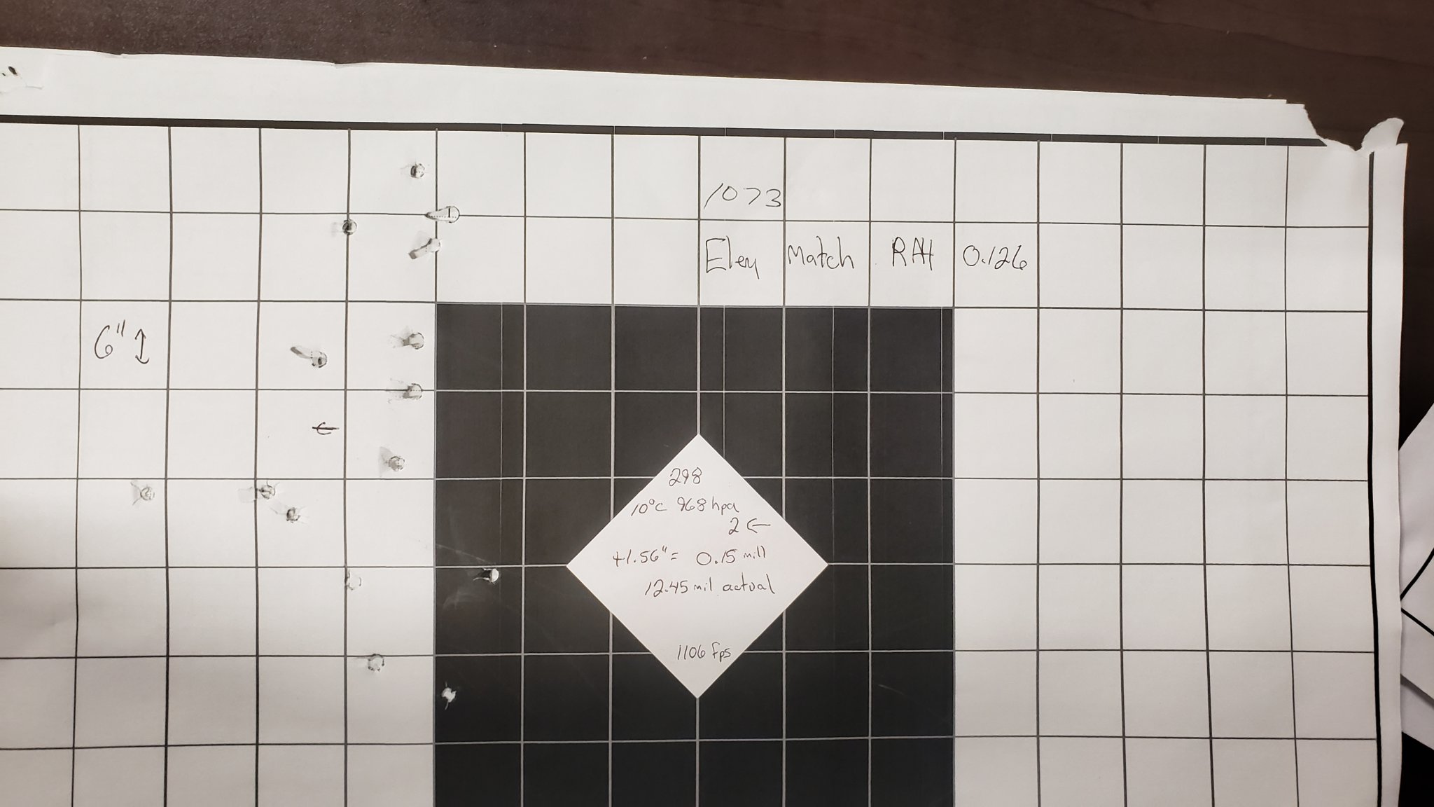

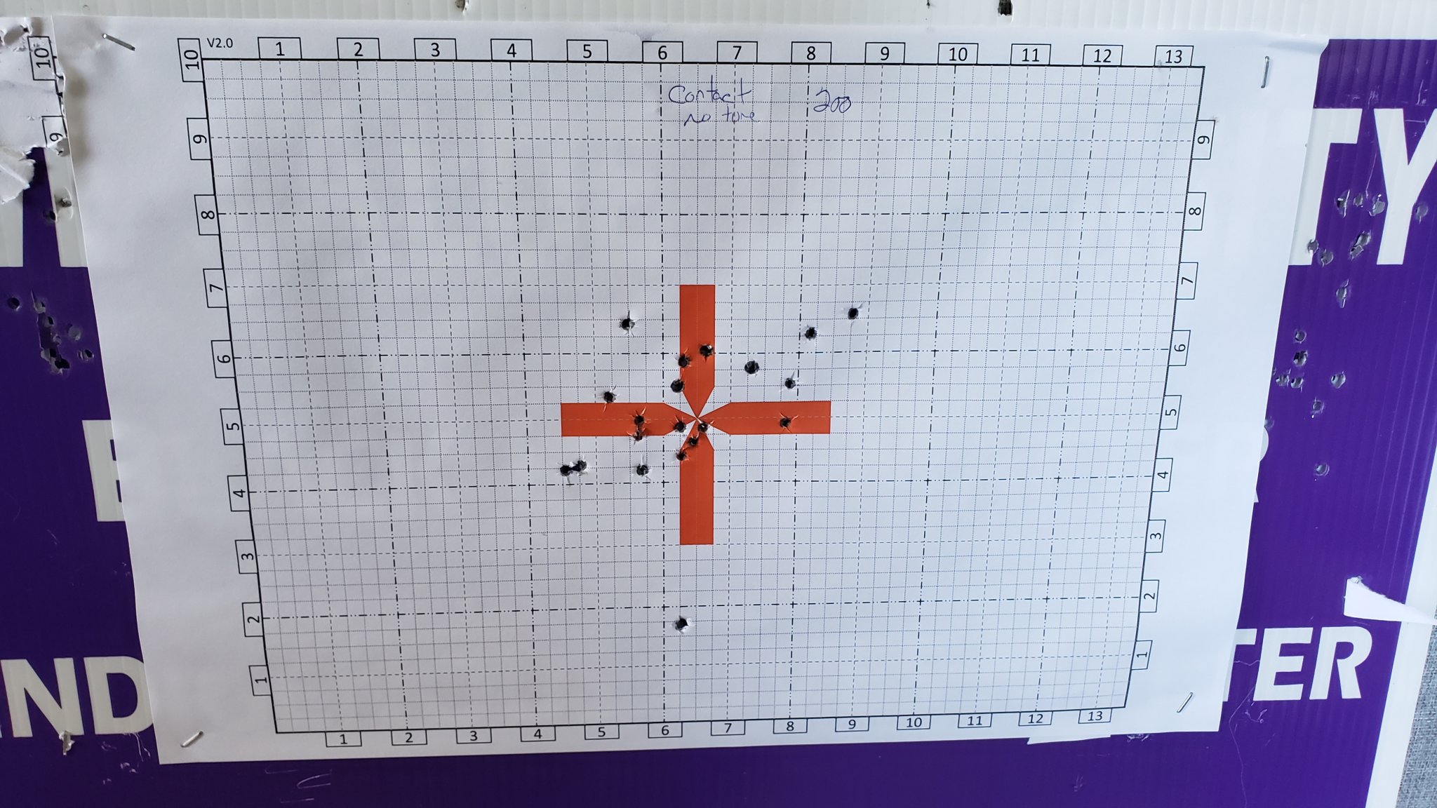

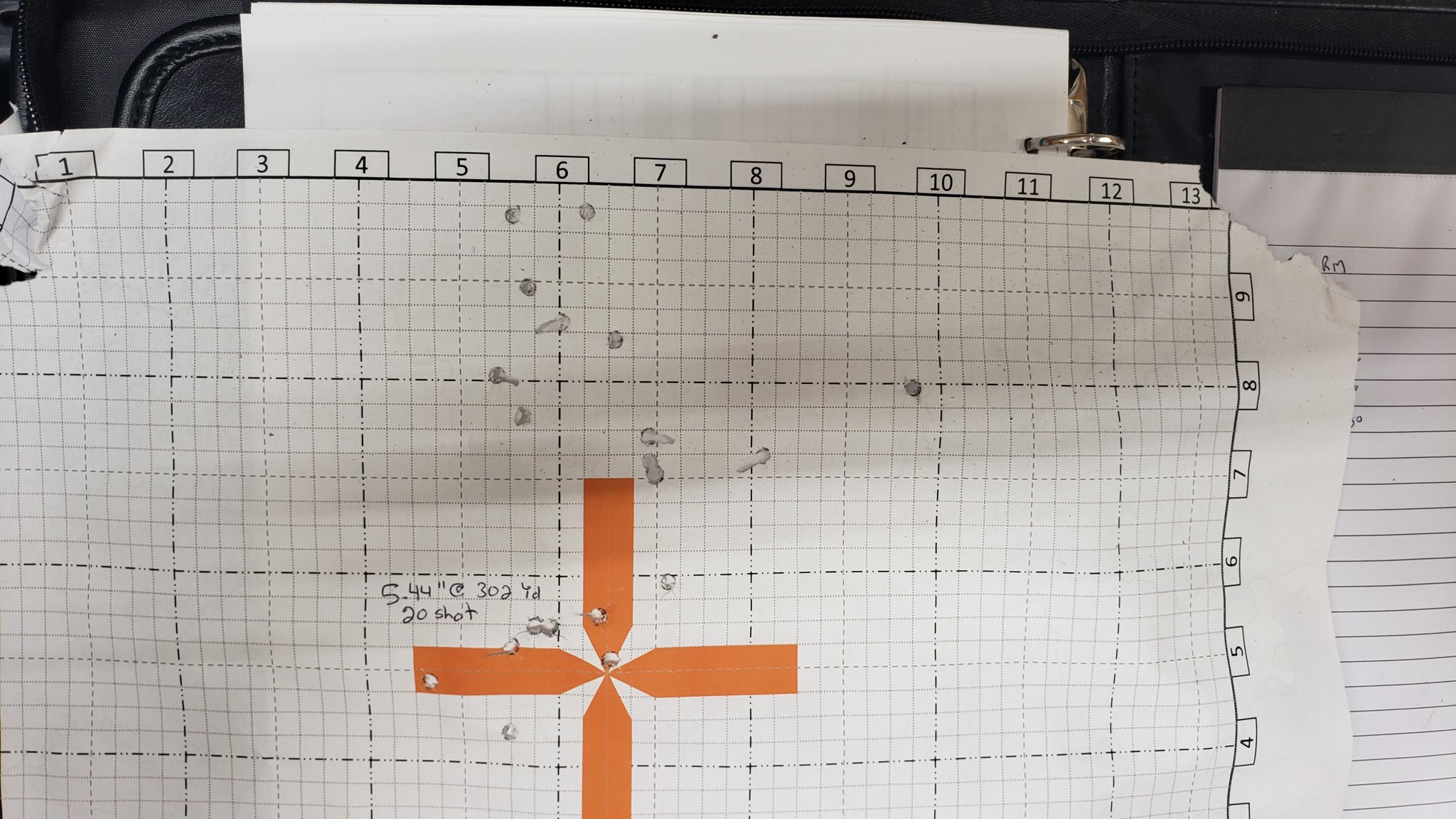

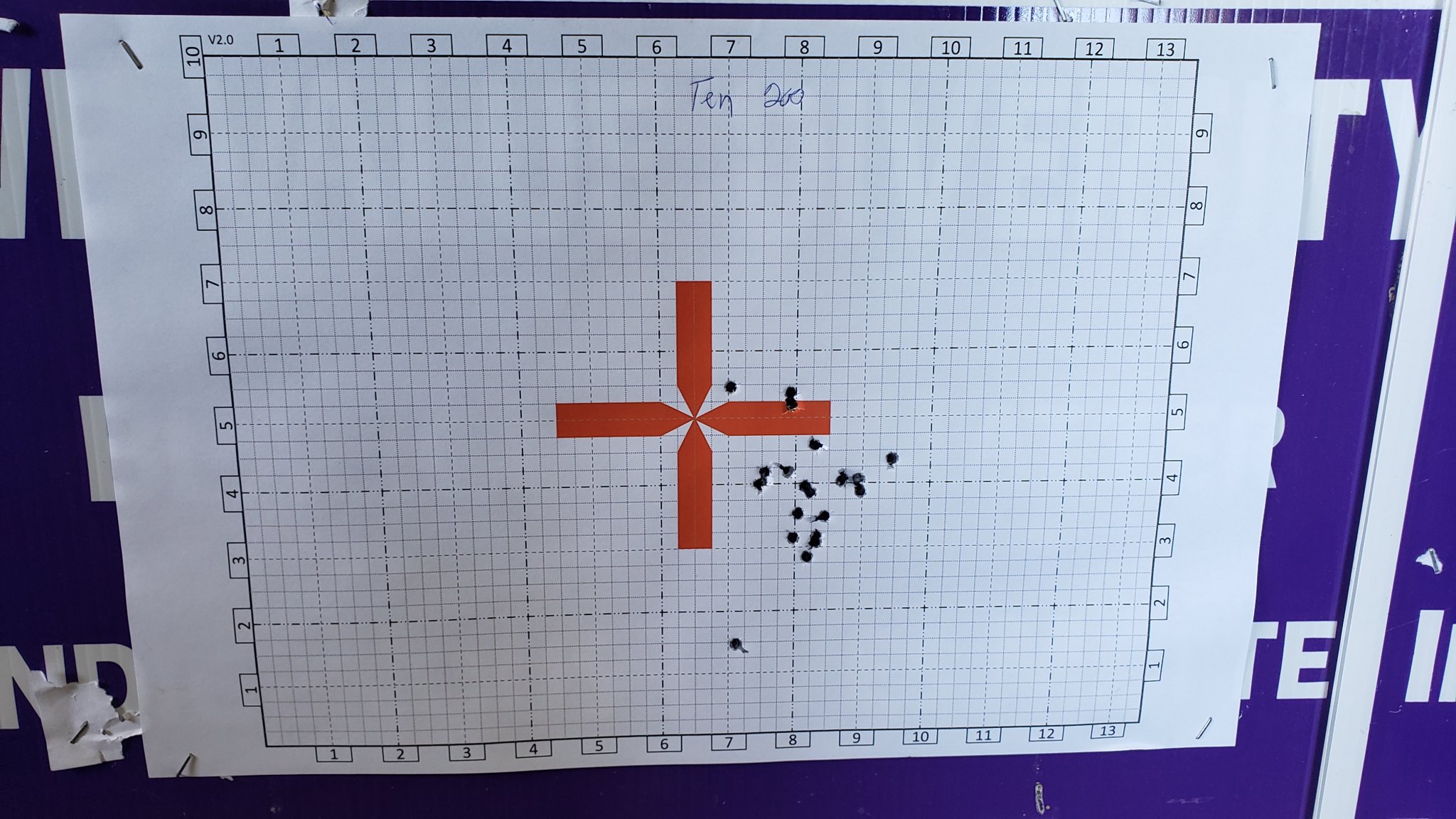

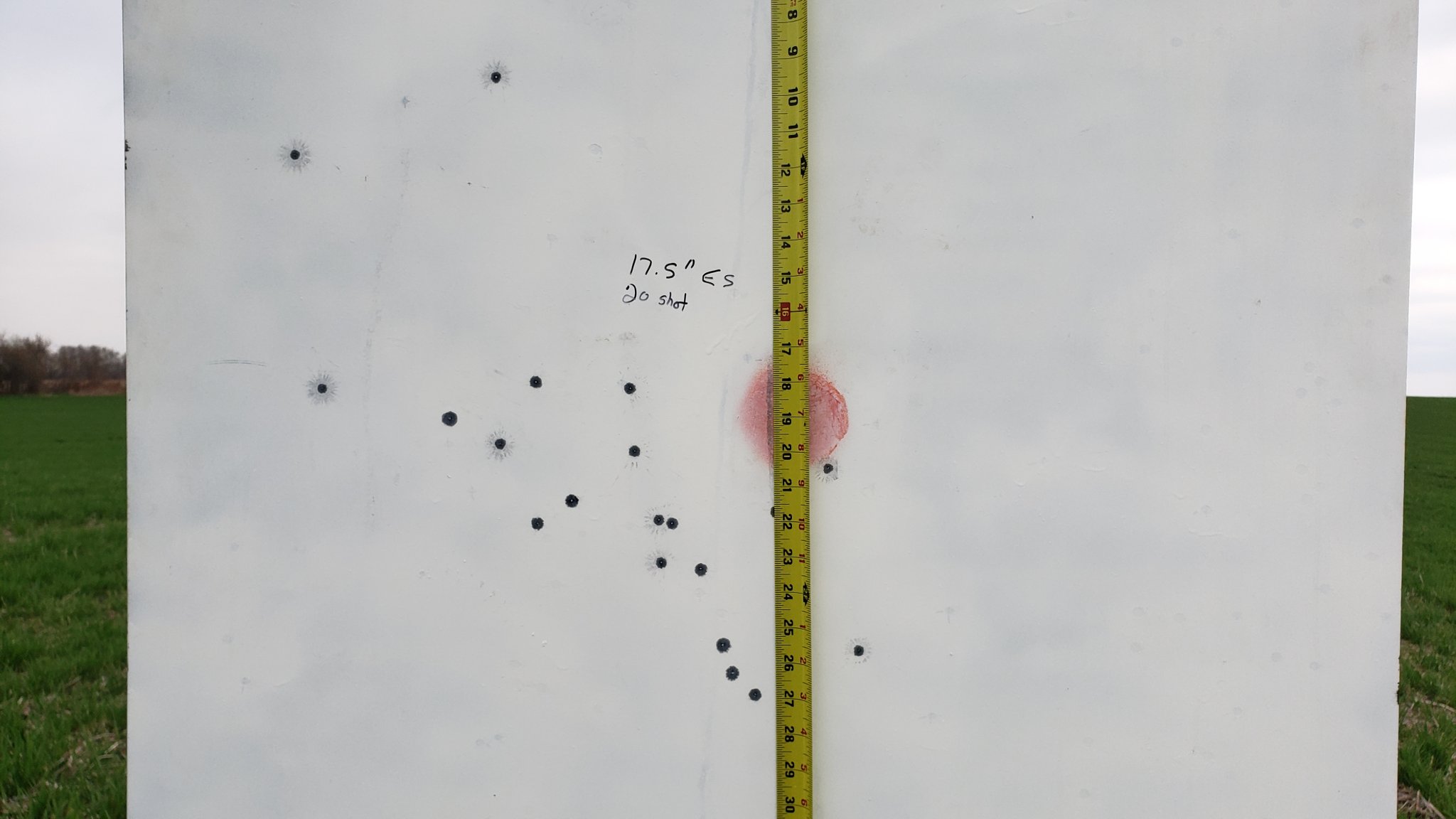

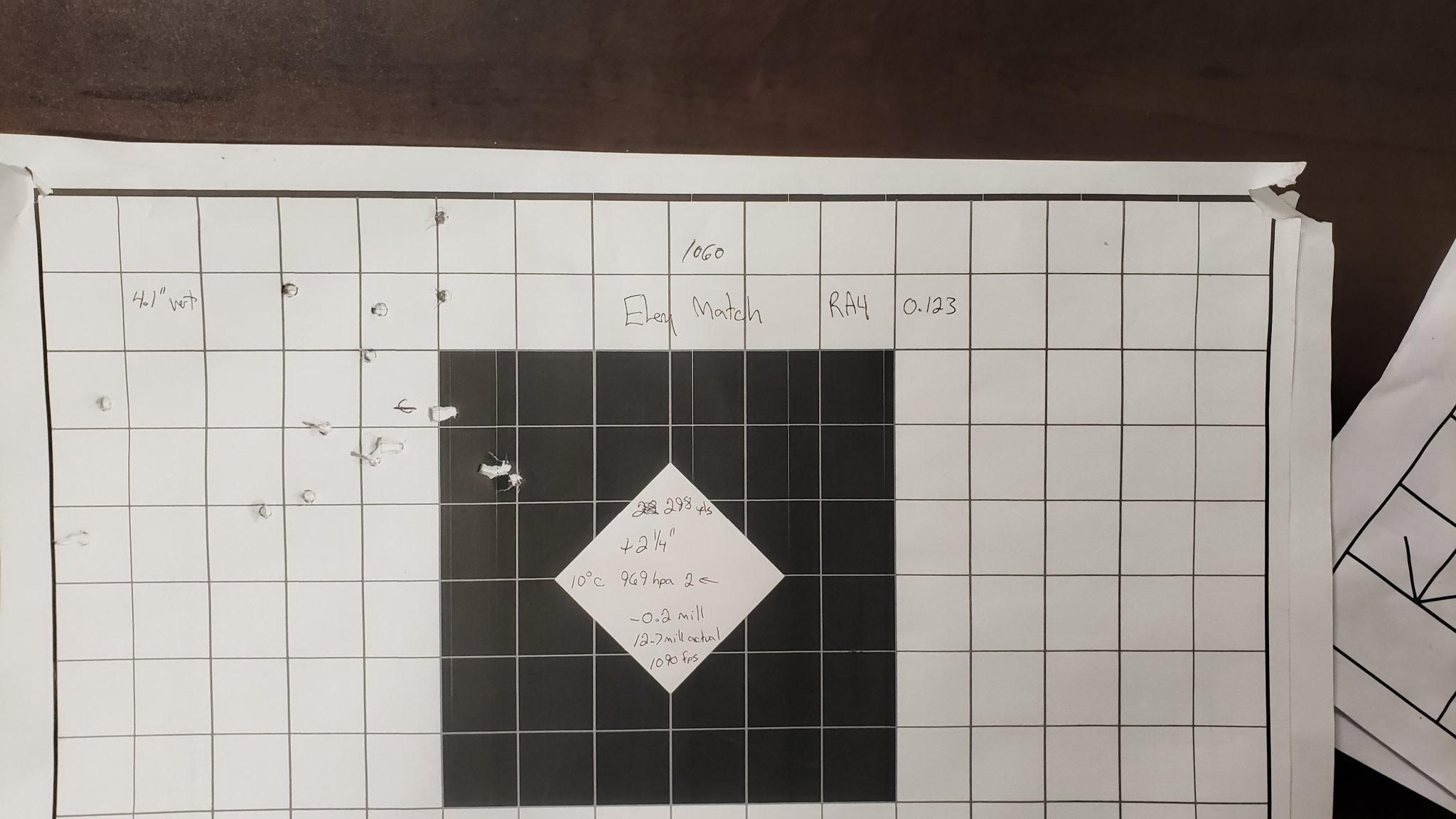

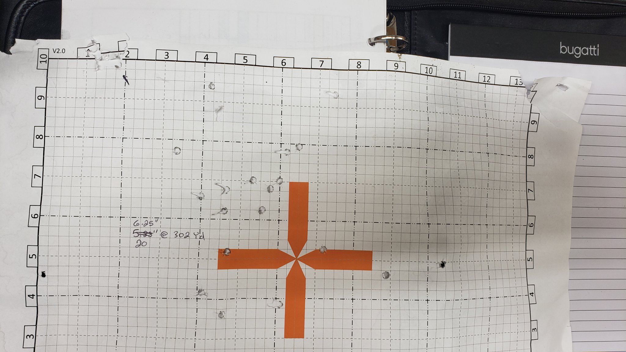

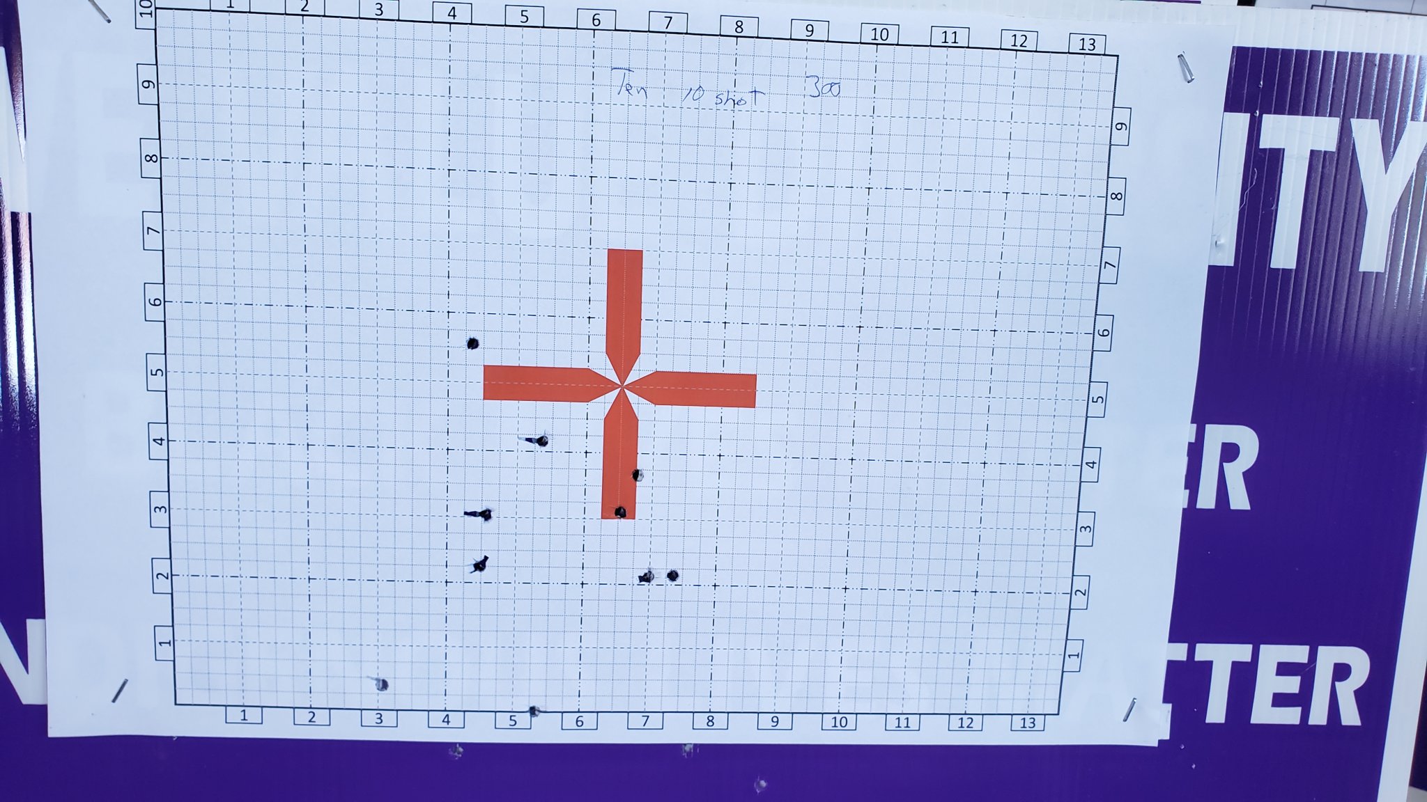

Here are some pictures I found. They are in no particular order and most I wouldn't know what ammo was used. As I explained before I enter everything into excel and done.
This is more as proof that if I'm talking its because I've done it on paper and its all carefully recorded. Your not going to find me spouting off about a few groups I popped on steel and measured the ES with a measuring tape and I think I remember it was so big. I record the group ES and calculate the vertical SD for all my groups past 100 yds. Recording both lets me see if a lot shot very small groups plus a flier or if it was a even dispersion through the whole ES. If you didnt do this then you would need to save all your targets and look them up to know. Group SD is my main criteria then ES as secondary consideration.
the papers with 1 group per is typically 300ish yards papers with 2 or 3 per are 200ish yards. some are noted on the paper. 36" steel plate is at 520 yards. I didnt find many mostly from me experimenting with the Long Shot camera and all with Eley contact. (my main practice ammo) in other words nothing very good...

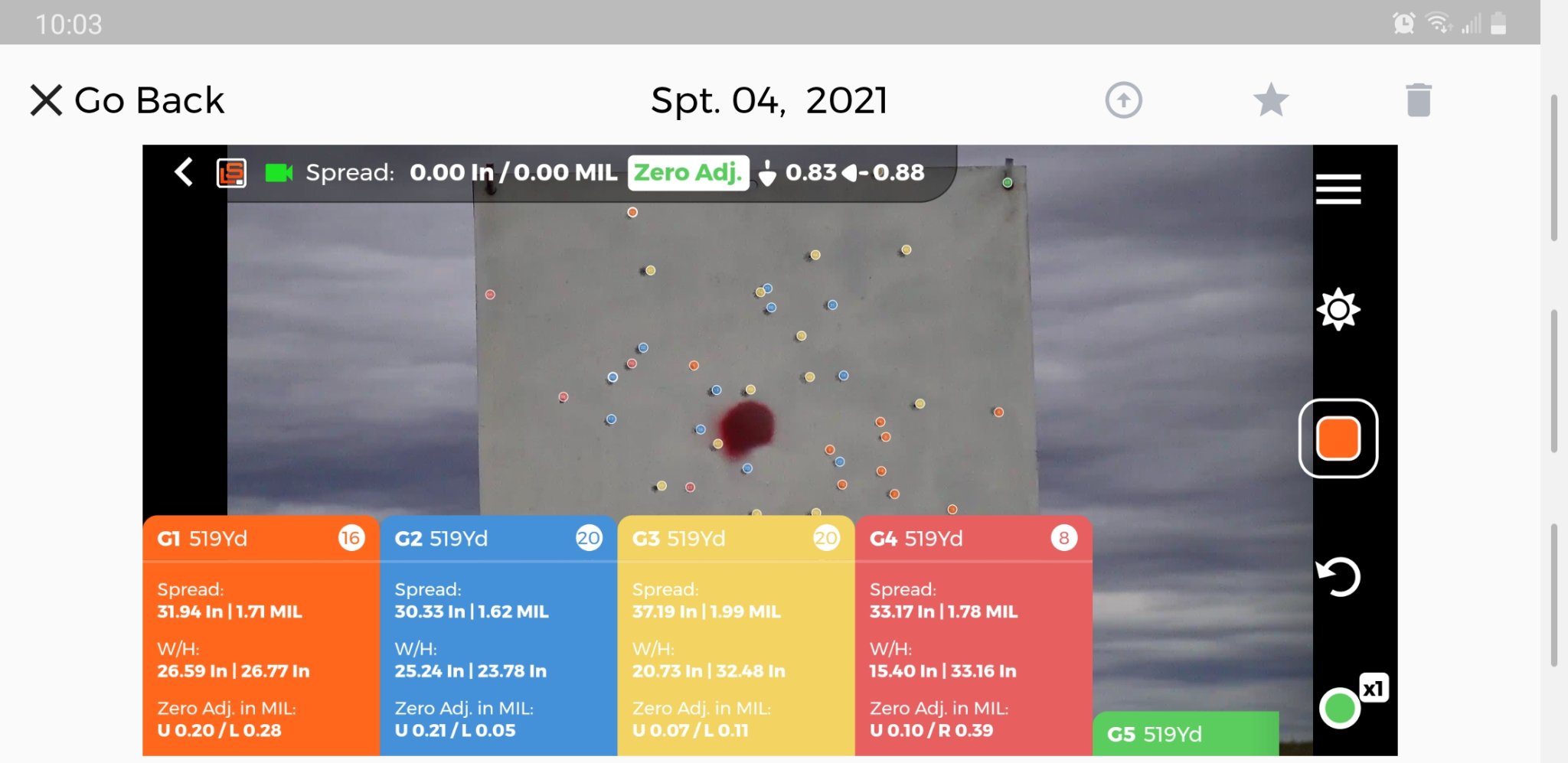

Interesting to note the 520yd Steel has circular bullet splash, no even marginal keyhole or oblong spray indicating the slug hit anyway but nose first. I’m guessing that indicates stability.
Even at 700 its circular. They have not lost stability and between the 16 and 12 there is no visual difference. But this doesn't mean that the 12s increased stability doesn't help. Simply that the 16 hasnt gone haywire

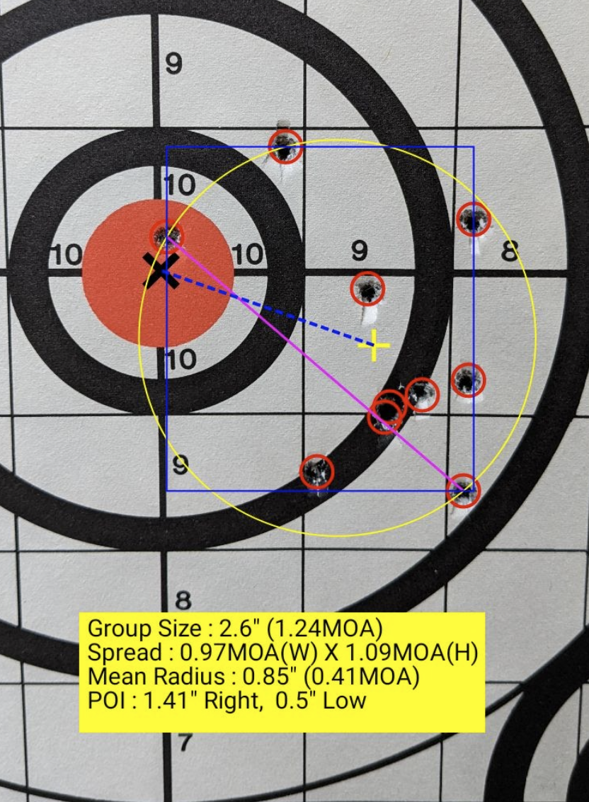

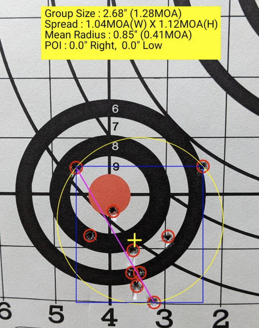

CRPS Shooter "I record the group ES and calculate the vertical SD for all my groups past 100 yds. Recording both lets me see if a lot shot very small groups plus a flier or if it was a even dispersion through the whole ES. If you didn't do this then you would need to save all your targets and look them up to know. Group SD is my main criteria then ES as secondary consideration."
Correct me if I'm wrong, but it appears you're plotting the shots and using the x,y point data? And, then calculating the Standard Deviation from the y-axis coordinates?
If so, there's another statistical metric that may be useful for you called the "Statistical Slope" if you use a chronograph and can match each shot's velocity with its x,y coordinates.
Come to think of it, there's also another tool that might be useful in the shooting disciplines you guys are interested in.

Don’t know if this will help at all, but here goes:
I was testing some ammo through a chrony at 15 ft, target at 100yds
I fired a group of 10+ shots, adjusted scope to center, then started I believe it was 5 shot groups on a 25bull benchrest target. After a short while I could predict the velocity before reading it, as certain impact points were ALWAYS at a certain velocity. I haven’t repeated this test at long range yet. It would be nice to know if EVERY shot location was documented according to speed if we would see repeatability.

At 200 I did some preliminary not really testing but observation to see on what position of importance it would be for testing purposes.
I used a lot of Eley Force that I was getting 70-90 fps ES on 50+ round batches. Observation was that I had no consistency. I'd have a 1153 hit high then a 1120 right beside a 1170 would go low. Then the 1125 would go low. 🤷‍♂️ interestingly I had 4-4.5" 20 shot groups at 200 yards with that lot# explain that with velocity spreads of 70+ 😉 anyhow I shelved velocity and put it in a later details not a major factor. Now this was not scientific in anyway just a bit of general observation and if/ when I test with Tenex I may find something useful.
I should say in broad strokes ES is a factor when comparing different lots of the same ammo type.
