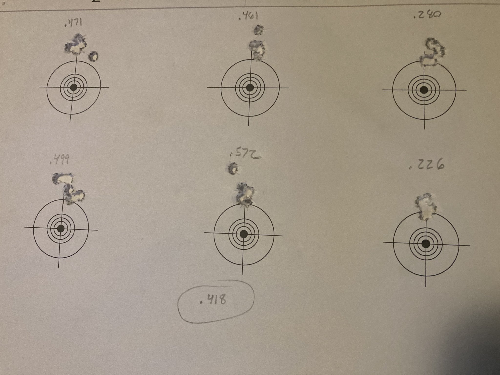

Yes 50 yards. I only had about 15 minutes to shoot so I was rushing. Ran out and set the target up, ran back. So I had some movement from the running and mosquitoes biting.
What’s so promising to me is that the bullets impacted pretty much exactly where the crosshairs were when I pulled the trigger. Not the best groups, but no flyers if that makes sense. It will group much better if I was calm.
This ACC is shared between the .22 and my .223 trainer so it has had a ton of mag changes with steel mags. No issues at all with being tight. I would not say it’s drop free, but not far from it.

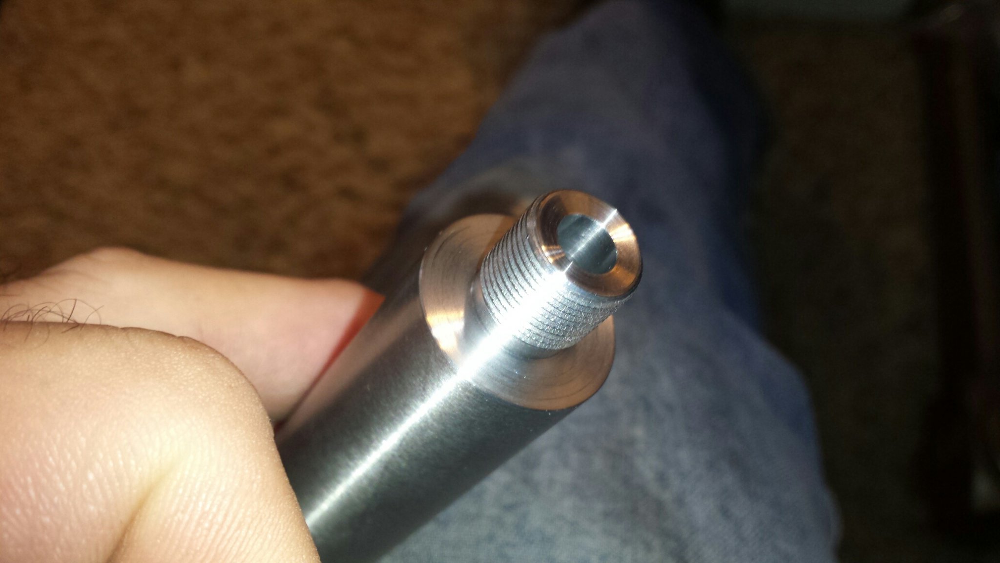

There is a way to thread the barrel and have it not open up the bore at the crown. A person can counter bore the thread section and place the crown at, or just behind preferably, the shoulder area of the thread section so threading nor the torque applied onto the threads affects the bore dimensions.
The problem then becomes executing a good crown inside of a small hole at depth. While it is not the most glamorous picture, here is an example of it pictured. This is a #7 contour shilen ratchet we fit to a RimX. I do not remember the exact dimensions but if I recall correctly the counter bore is 0.255" diameter x 0.625" deep inside of the 1/2"-28 OD threads. There is an 11° crown internally at the counter bore as well as an 11° chamfer from the counter bore to the threads. This rifle shoots very well and no issue has been seen by doing the counter bore this way. This method is partially inspired by how RFBR sporter barrels achieve essentially a built in tuner.

Something to add to post. The barrel was slugged and crown was placed where it was best. If I remember correct the barrel finished 25.3 at crown. The friend we fit this barrel, asked for it to be threaded. We knew the effect of threading the most Important part of the barrel and went this route. There is a lot more work involved but if you feel like you need it threaded this is the solution.
