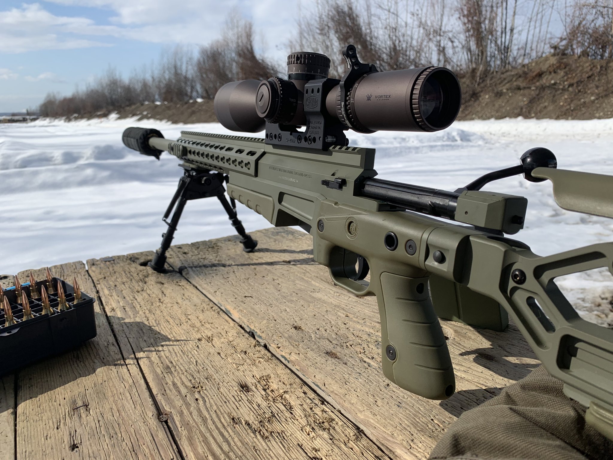

I loaded up 15 or so rounds for a load ladder in my .243win Accuracy International.

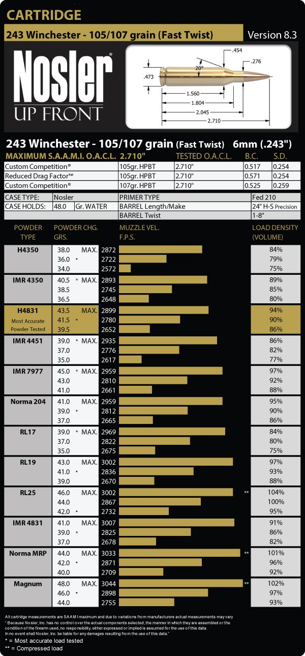

Nosler reloading manual says max is 41gr at 3007fps

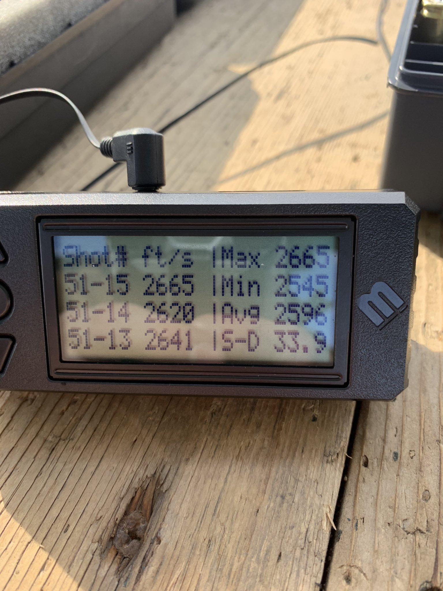

All shots were shot suppressed with a magnetospeed attached.
Problem I’m running into is that it’s slow....like super slow.
40.5gr load clocked in at 2665fps. Wayyyyy off the reloading manual. Has anyone had this problem or suggestions? I want to try to use this powder but obviously if I can’t get the speed it’s not worth it.
If you look at Nosler's load data they list case capacity as 48.0gr of water. I don't have any Sig brass but I'd bet it is more like 53.0gr or 54.0gr of water. Nosler's load data is notoriously conservative, I'd run your pressure ladder up to 42.6gr of IMR4831.
I forgot to mention barrel length and twist.
24” 1-8 twist
I was really just mystified that I have the same on paper spect as the test rifle in the manual and I’m seeing such different data
