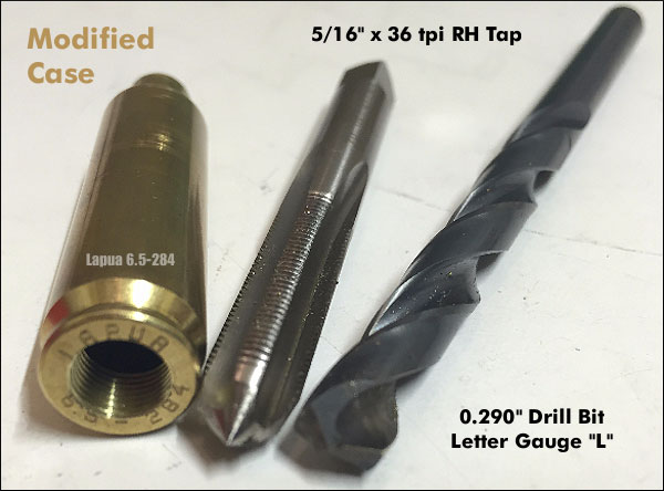

What is everyone using to measure COAL for their chambers? Im thinking about threading the primer pocket of a once fired piece of brass. I have a 6.5cm modified case but obviously, the neck wont fit into the chamber.
Couldn't you buy a second modified case in 6.5 Creedmoor and simply neck it down?
Or if you must have a case make it yourself. FL Size the case, clamp it in some wood blocks in a vice, drill the base out and run a tap through it.

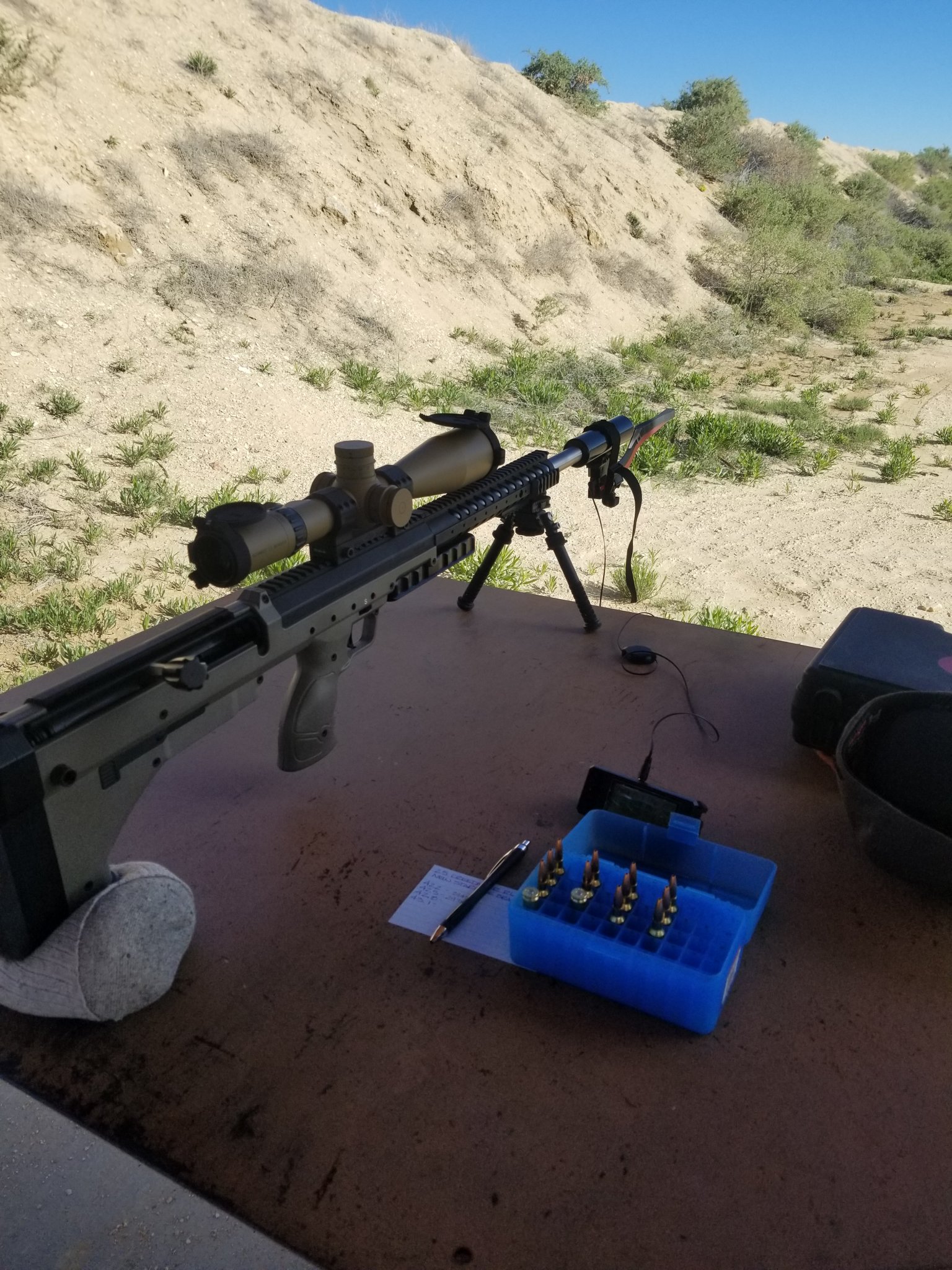

Finally getting to the range tomorrow. My barrel is a 7 twist K&P from @ES-Tactical for my Desert Tech. Alpha and Peterson SRP brass was out of stock and Starline was on sale, so I picked up 200. I'm using RL16 and FGMM small rifle primers. I have 2000 Blackjacks, but I'm using Sierra 120 Gamekings I had on the bench in order to form the brass and get the barrel settled in before I start using the 131s

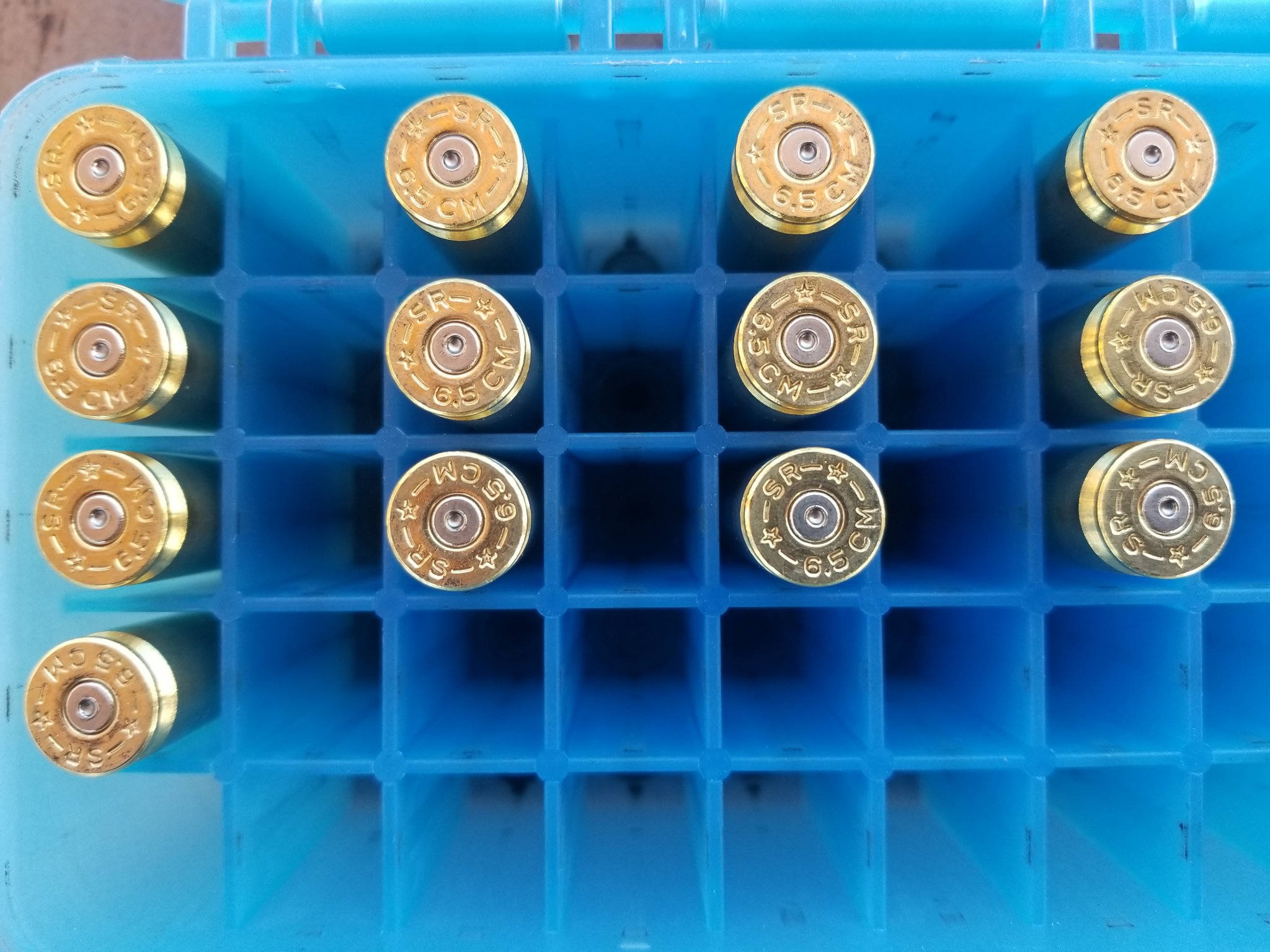

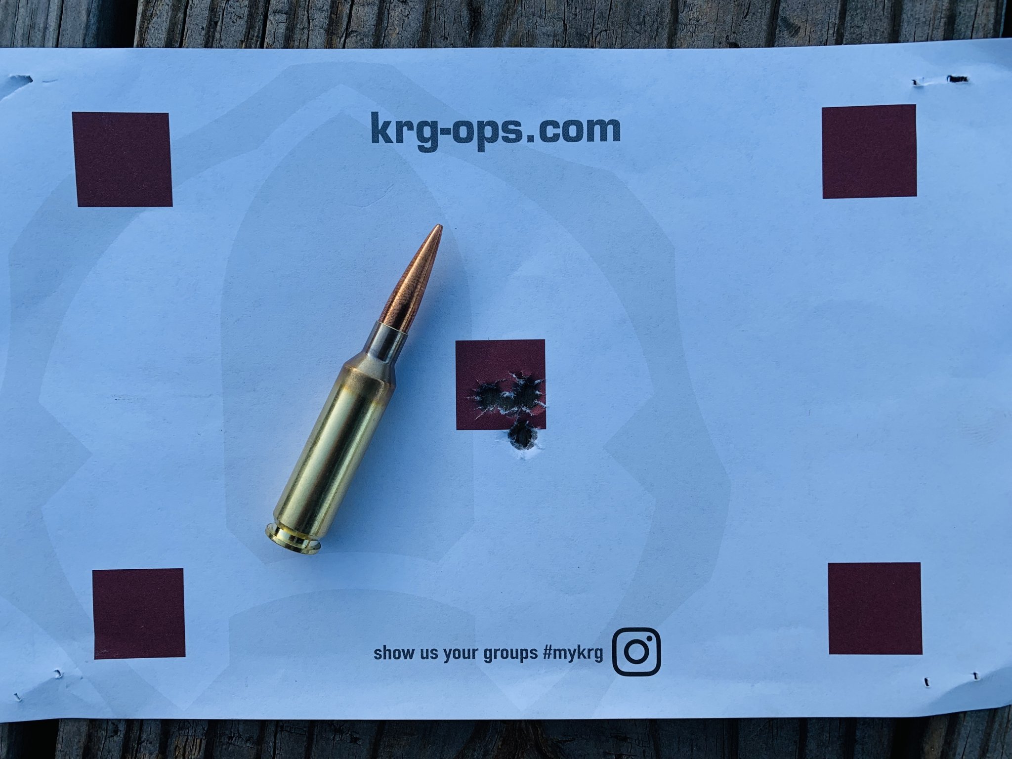

Initial testing went well. Brass prep consisted of running Starline small primer 6.5 Creedmoor brass through a Redding Type S FL die with a 0.282" bushing, then running a 257 expander mandrel through the neck to set my neck tension and ensure a perfectly round interior neck, and using my Giraud to chamfer and debur. I'm using Reloder 16 and all powder charges thrown on an AD FX120I. I'm using Sierra 120 Gamekings for now to form brass and send 100 down the barrel before switching to the 131s. Chrono is a MagnetoSpeed V3. 26" K&P barrel from ES Tactical with SilencerTech suppressor.
I started at 42.2 and went up by 0.3 grains to 43.1. I fired round-Robin with 2 minutes in between shots. My thoughts were the 131s seem to do really well, from what I've read, around 2950, so I figured 42.2 would put the 120s fairly close to that number., which should give me a starting point when switching to the heavier bullets. Velocity numbers were really scattered, which I expected out of new brass and no real load data, but I was really surprised to see those numbers at 43.1 grains. I'm including pics of the brass and primers along with the velocities for informational purposes only. Four 42.2 on the left going up to 43.1 on the right. I fired the rounds from bottom to top, left to right, then right to left, so you can match up the brass with the velocities.

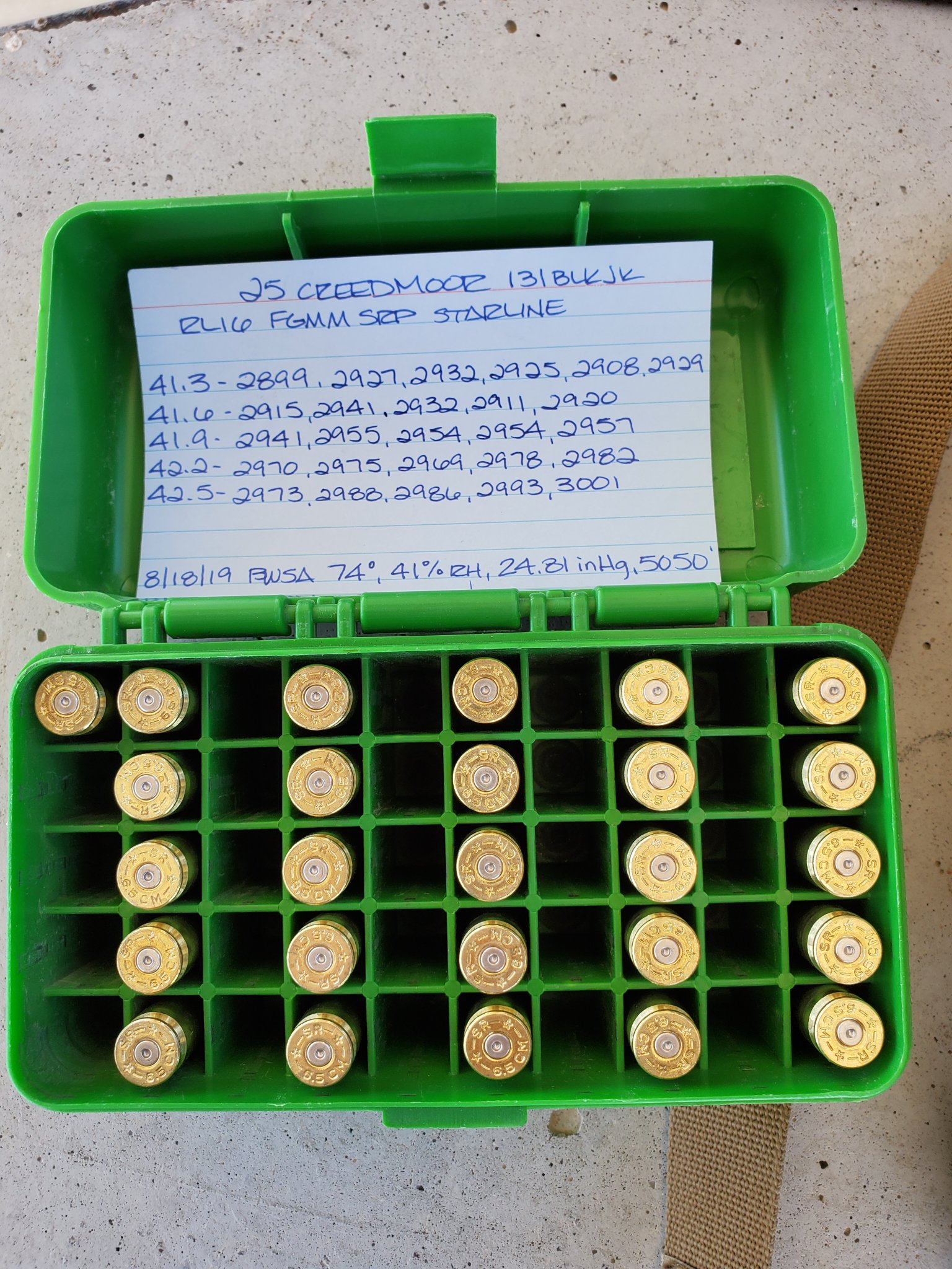

These are rounds 75 to 100 and my first with the 131s. I'd been using Sierra 120 Gamekings to get some rounds through the barrel and form the brass. I'm using Starline small primer 6.5 Creedmoor brass, Federal Gold Medal Match small rifle primers, and Reloder 16. All rounds fired round Robin from left to right, beginning with lower left and ending with the upper left, which was an additional 41.3 round.
As you can see, no pressure signs whatsoever, even up to a high of 3001 fps at 42.5 grains.
41.3 - 2899, 2927, 2932, 2925, 2908, 2929
41.6 - 2915, 2941, 2932, 2911, 2920
41.9 - 2941, 2955, 2954, 2954, 2957
42.2 - 2970, 2975, 2969, 2978, 2982
42.5 - 2973, 2988, 2986, 2993, 3001
I was at a match and I was just shooting them at various range steel targets, so I don't have groups (groups with the 120 Gamekings were very impressive).
