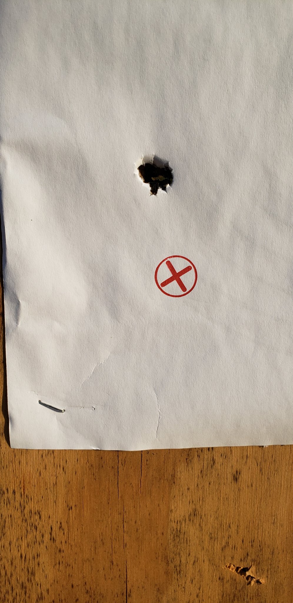

42.2 grains of Reloder 16, MV of 2974, and a G7 of 0.335 gives me first round impacts at 705, 890, 924, and 1020.
5.0 mils to 890, 5.3 to 924, and 6.2 to 1020.
Wind was around 5 mph from 10:00, but gusting around 8 to 9 downrange. Still only needed 1 mil of wind to connect at 1020

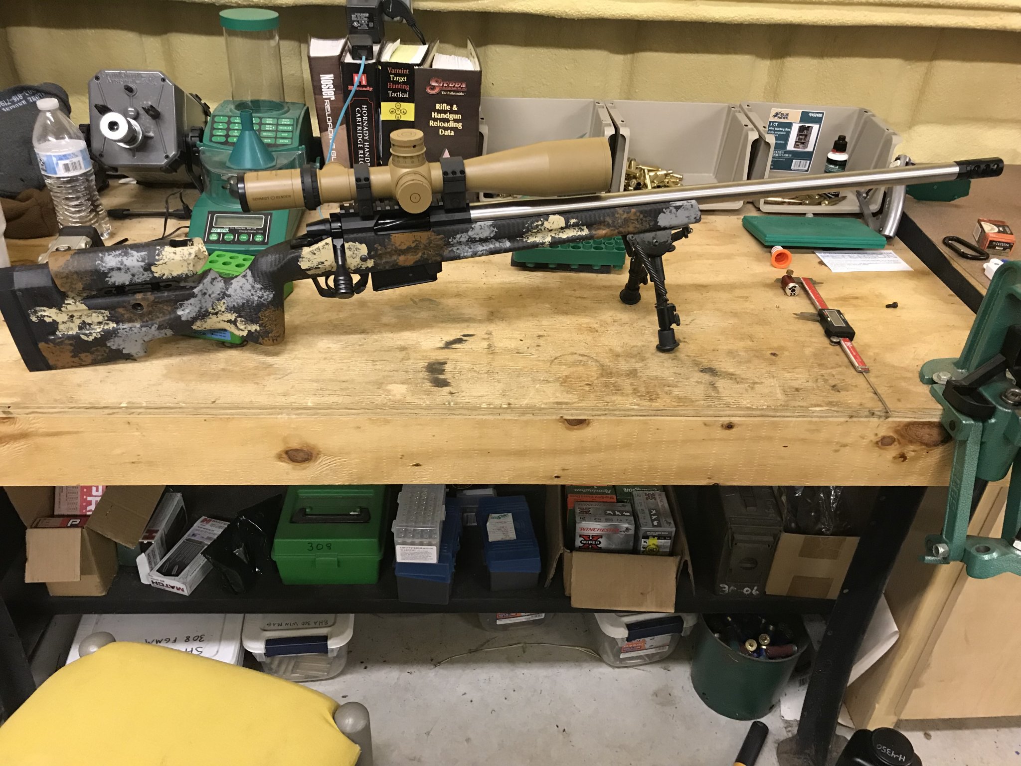

Committed to trying a 25 Creedmoor (more or less).
LMK if I missed anything.
Plan(ed) on working from 6mm SRP brass, so:
Redding FL 6.5 bushing die
-.282 bushing
-tapered .257 expander
Redding 6.5 seater
-257 VLD stem
The 257 VLD stem (which sounds optional and the 6.5 stem might work fine or could use my 6 CM seater) and the tapered expander (similar situation by just getting 6.5 CM brass) are both on back order. Should I just bypass one or both of those items?
For the barrel, I have a Benchmark MTU 7.25tw that’s waiting to be chambered, but haven’t decided on a length yet. Is there any reason to go 27/26” vs say 24/25” if 2950-3000fps is where these bullets want to run anyways? MTU barrels are pretty beast so I’m leaning towards 25”, or even 24 if I’m not going to get much out of the extra length.
Powder wise, I have H4350, 4831sc, H100V, Superformance, and StaBall 6.5 to work with.

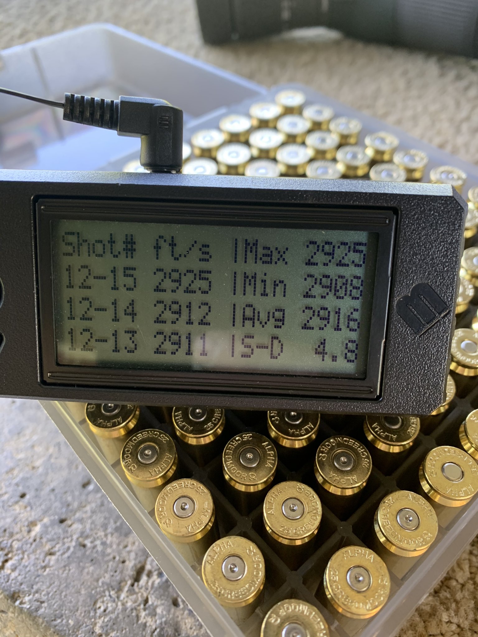

42.3gr of H4350 give me 2905 fps in the first 52 rounds. Then 2925 fps from there and I have not yet shot 100 rounds .

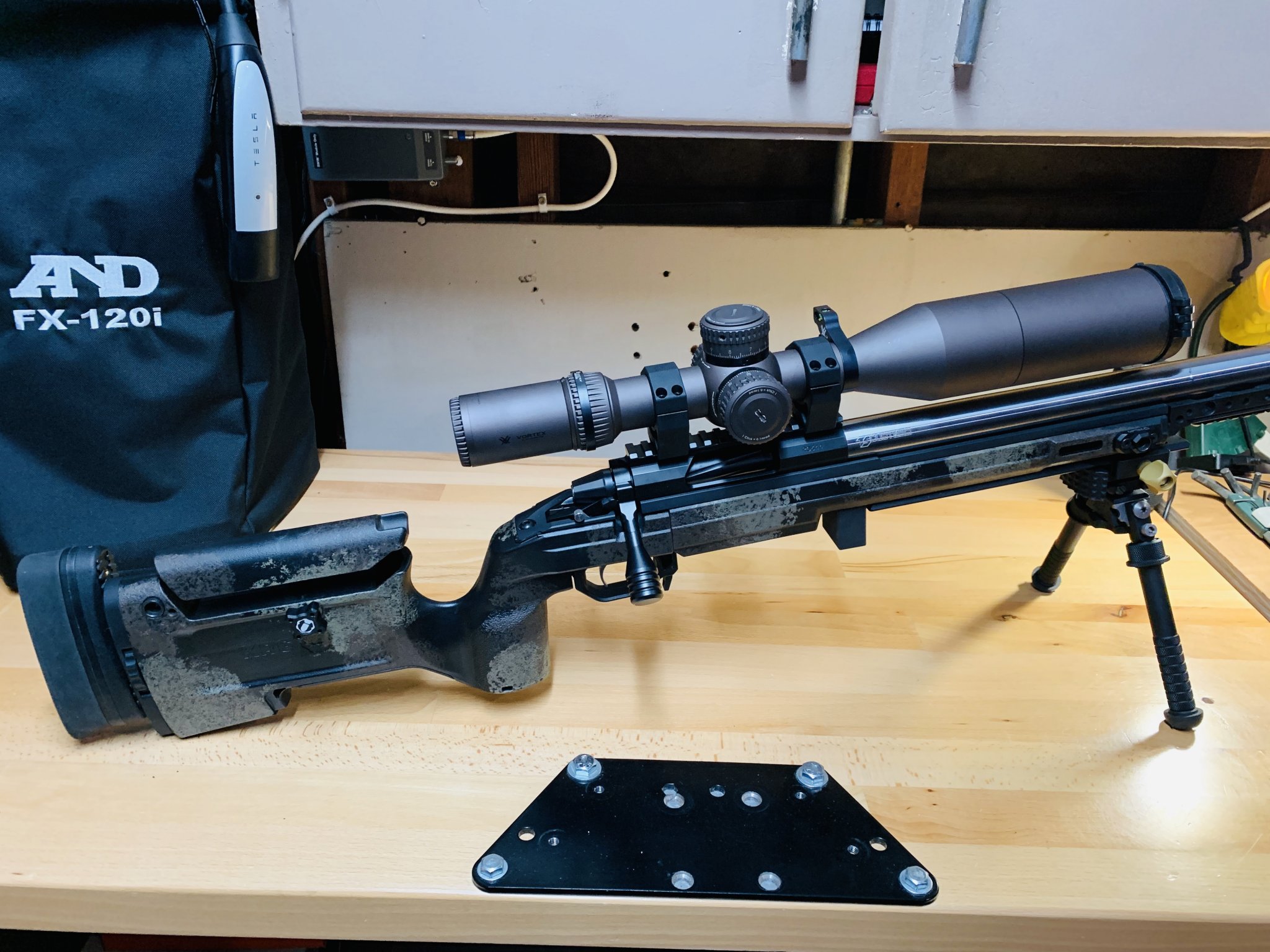

I've been watching this for since prwillard2 first posted it up with much interest. Decided to go with it on my RPR. Just got the barrel installed Sunday, and put the first rounds through it on Monday.
Thought I would post up the results so others could compare with other data listed here. As, I've used a few different components.
Rifle: Ruger Precision
Barrel: Krieger @ 26" 1:7.25
Chambered by Patriot Valley Arms
Brass: Starline 6.5 Creedmoor SRP
Primer: Federal GMM SRP
Powder: H4350
Loaded 0.020 off lands
Chrono: Magneto speed
I used the same powder intervals as originally posted here just for comparison. Only three shot groups to start. Plan on five rounders on the next round as I narrow down a load.
40.9 Avg 2779 SD 31.0
41.2 Avg 2894 SD 29.8
41.5 Avg 2824 SD 39.7
41.8 Avg 2856 SD 5.7
42.1 Avg 2875 SD 10.1
42.4 Avg 2901 SD 3.6
42.7 Avg 2930 SD 1.7
43.0 Avg 2955 SD 10.5
43.3 Avg 2978 SD 22.6
43.6 Avg 3018 SD 15.0
I stopped there. The last load listed had very heavily cratered primers. Almost to the point of piercing them.
Group size pretty much followed the SD numbers with 42.4 and 42.7 turning in about .3-.4" @ 100.
Loaded up 42.4 to 42.9 in one tenth increments to try next.
Many thanks to all of the contributer's here for the inspiration to try this caliber! It definitely seems to be telling what it likes so far (much better than my load development for my 6.5 went with the stock barrel).
