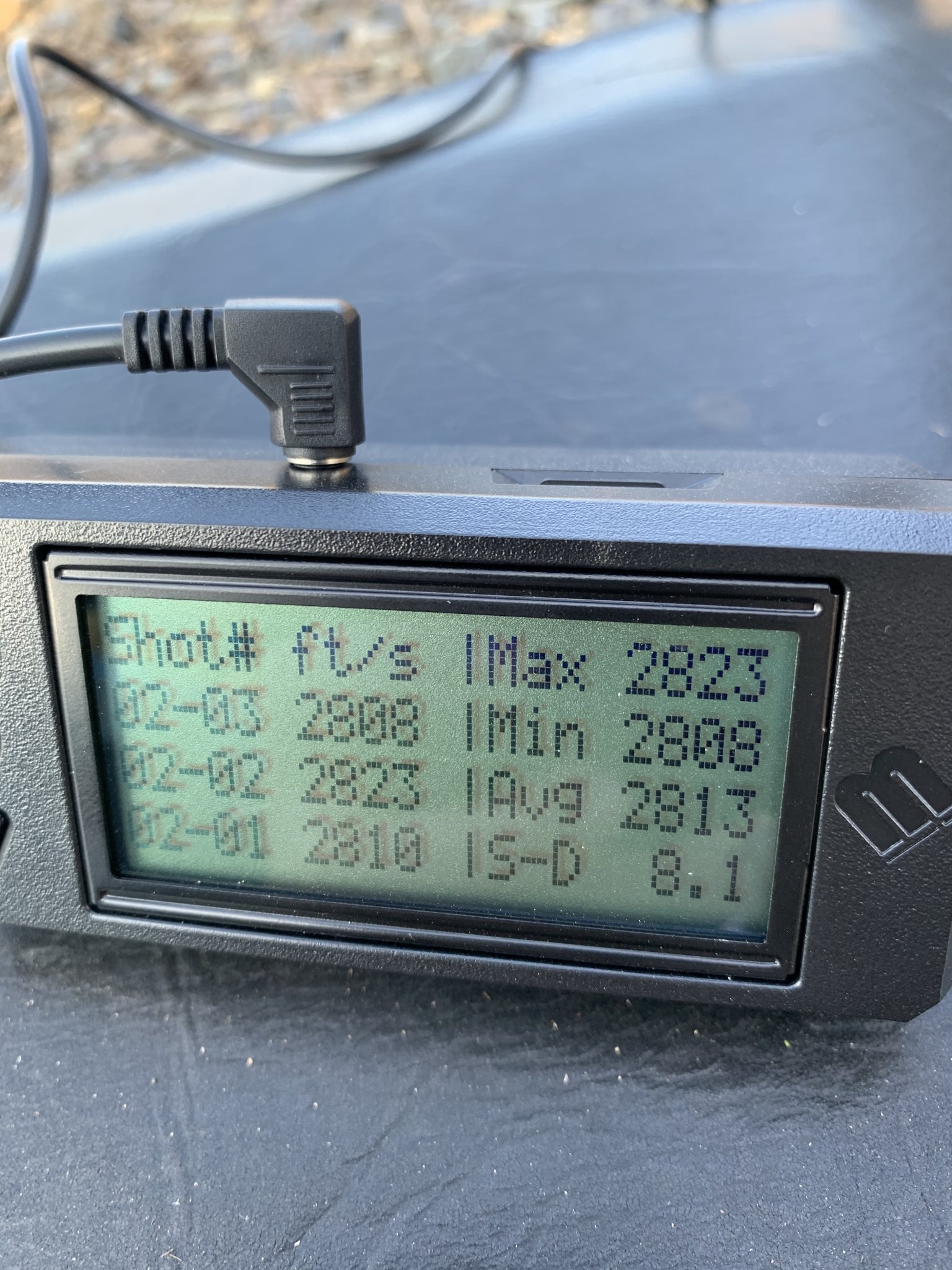

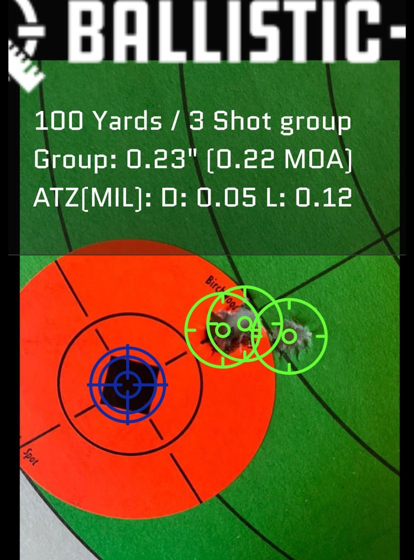

I had a chance to run some tests this weekend. I was a little rushed and my darn chronograph died on me. 57 looks promising. That group was around .23”. The other groups in the 57-58 range were hovering around .55”. I will take another look at the 57 group and see what kind of speeds I am getting. H4831SC is shooting really well for me, but I was hoping to get a bit more speed.

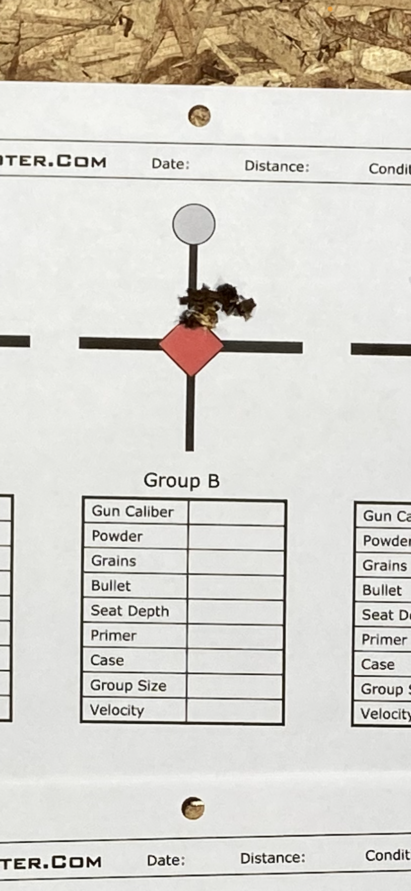

latest load development. I think I found the sweet spots. All done at temps of ~30F
  • 1st pic is 168g Berger VLD, 58.7g RL23, 2969fps. 5shot, 100yd, 0.435"
  • 2nd pic is 180g Berger VLD, 56.8g RL23, 2842fps. 5 shot, 100yd, 0.598"

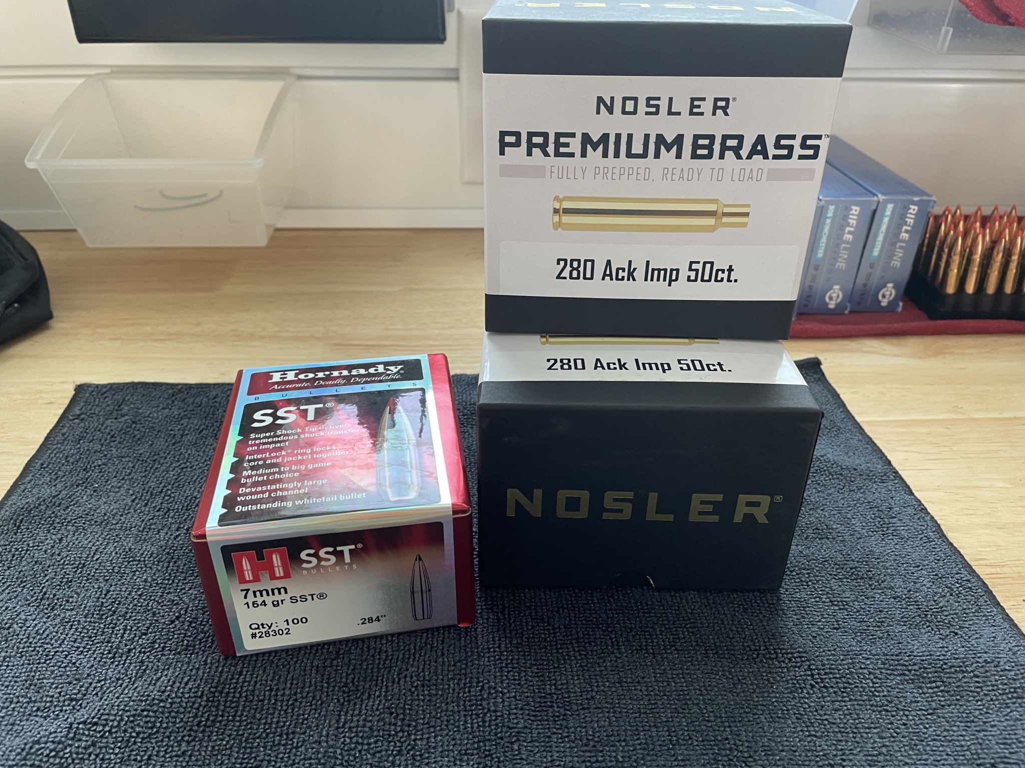

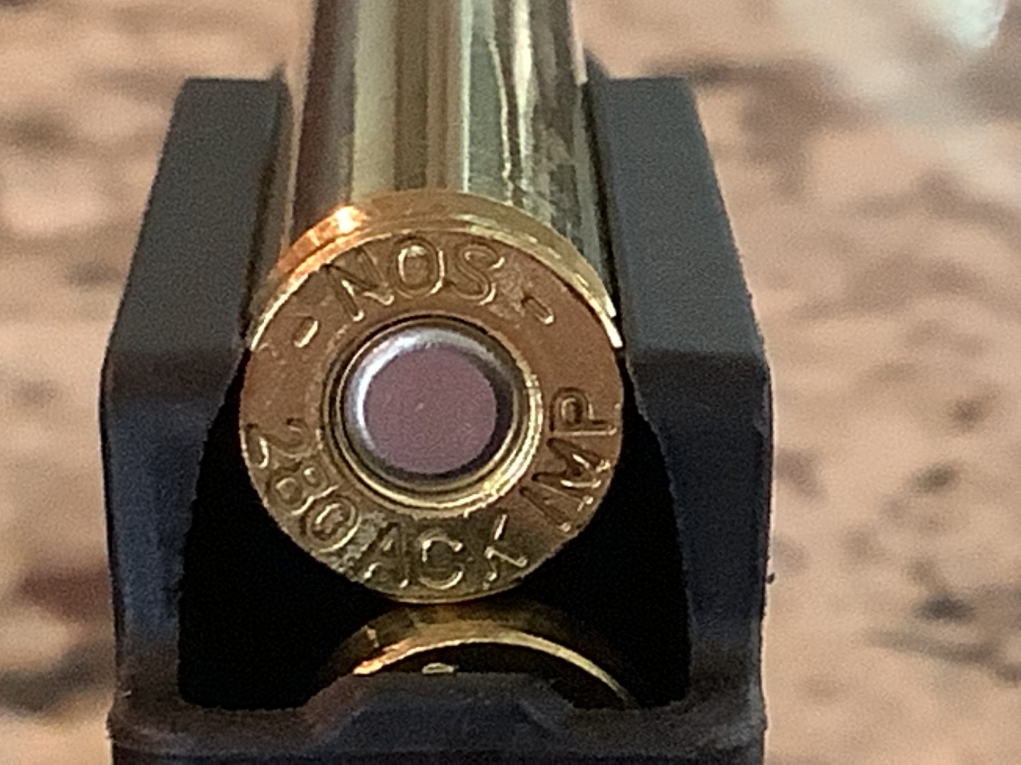

What is the consensus on Nosler 280 ai brass? From what I've read online recent brass has been problematic https://forum.nosler.com/threads/nosler-280-ackley-improved-brass-out-of-stock-no-back-order.40408/
I don't have any reloading gear yet, but want to start collecting components since ammo is so hard to find or is very expensive. Would it be prudent to pass on this and wait for Peterson? Nosler is available at Brownell's now for $109 per 50.
I waited about 4 months for Pederson brass before canceling my order, FWIW.
Out of 4 boxes of Nosler brass, there were 5 or 6 that were unusable due to damaged necks. I don't have any other complaints on them than that.

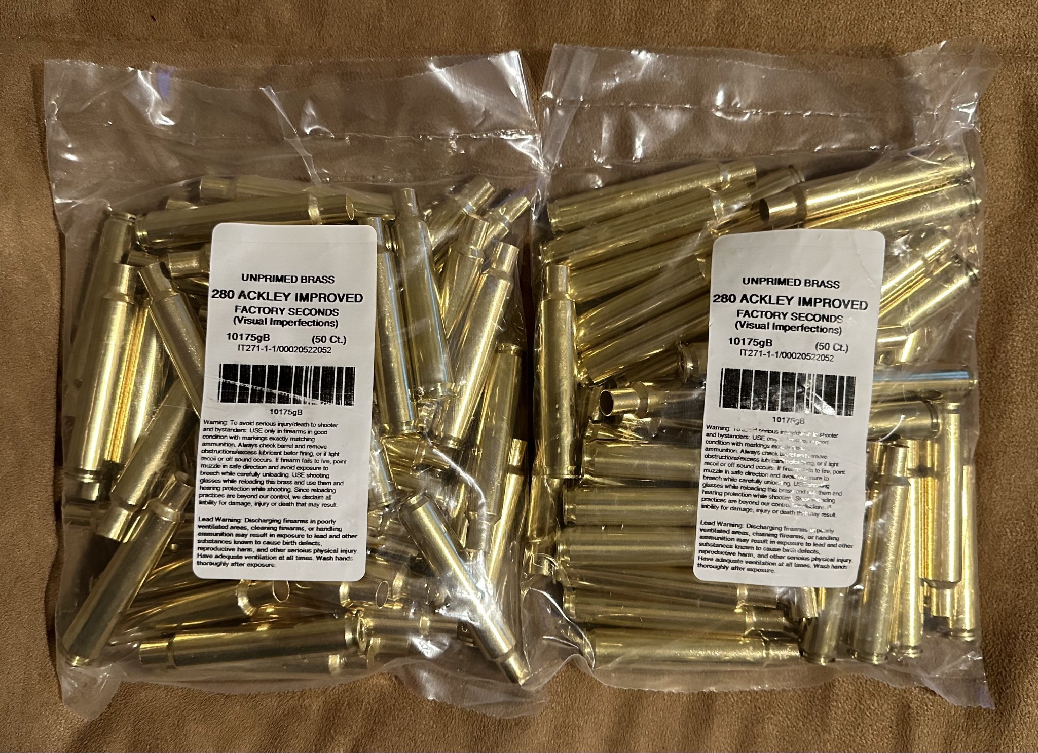

OTOH, did score these at Cabela’s today:
$2 per round for the brass though… 🤮🤮
quoted for my own curiosity as well…. I’m leaning towards the Redding competition dies, but man, they’re not cheap vs plain old Lee pacesetter.

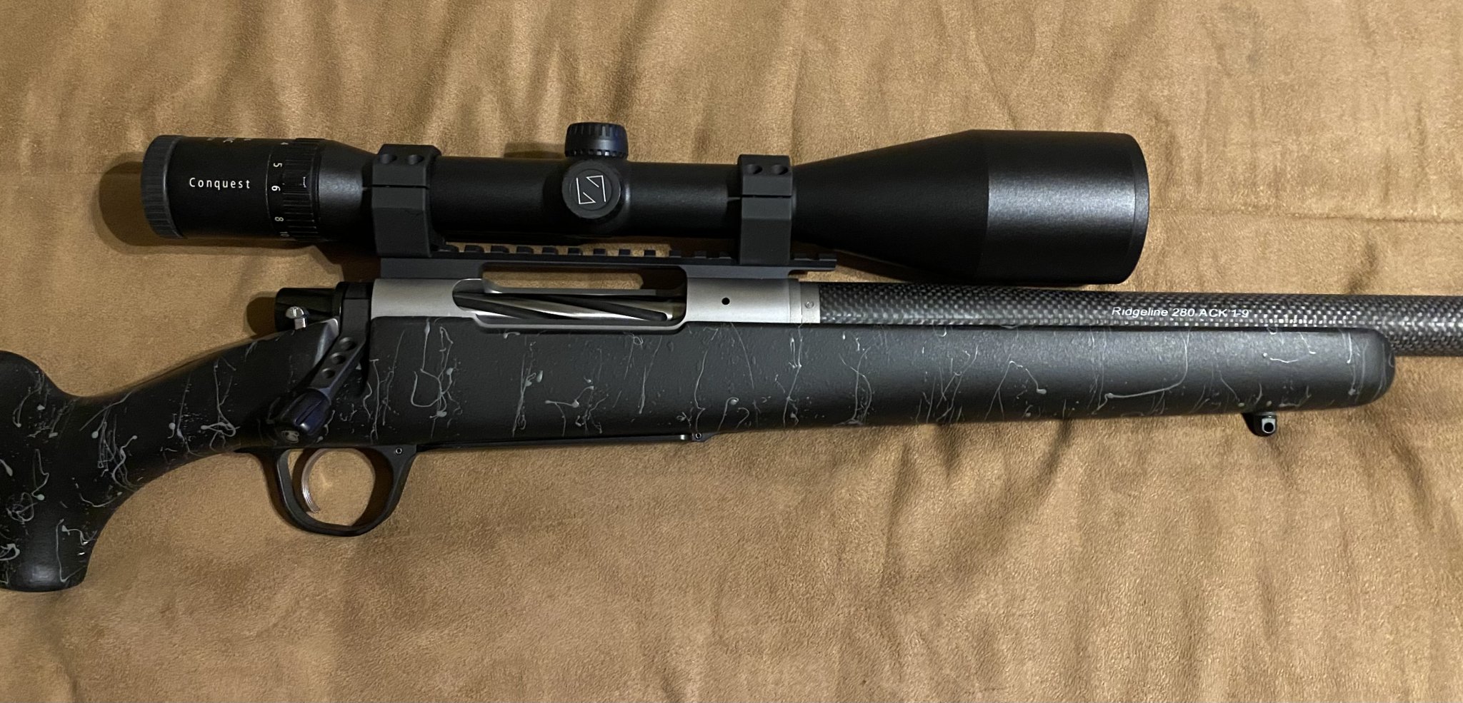

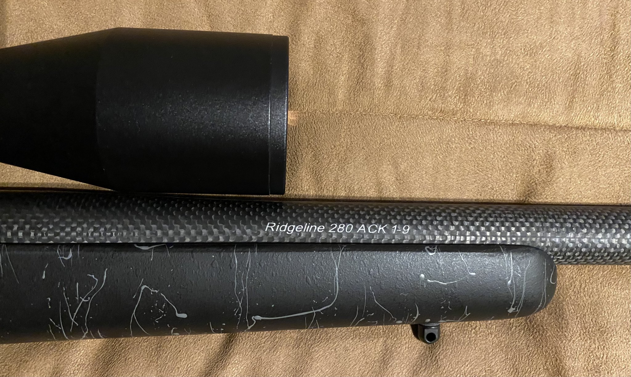

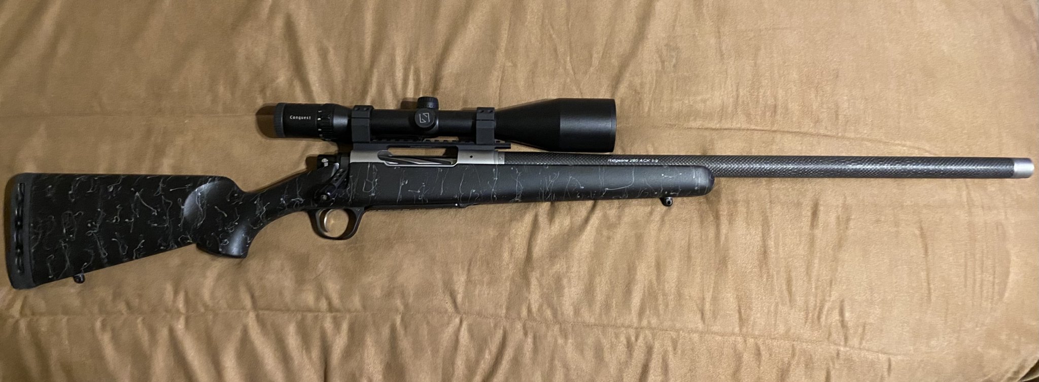

I finally joined the .280 AI club!
Well… You see… My local store had a 24” Christensen Arms Ridgeline in .280 Ackley Improved, and with the $350 rebate ending tomorrow (9/30/22), I couldn’t say no… 😏
I snatched a 20MOA EGW HD base off my custom .30-06 AI that I never shoot, and had this old Austrian/USA Zeiss Conquest 3-12x56 30mm FFP scope in a set of Seekins Precision low rings, just collecting dust, so, for now, this is how she’ll be. In the near future, I hope to put a new Kahles Helia 3.5-18x50i, or maybe something like a Razor or a nice hunting scope with exposed turrets (elevation at minimum).

looks great
