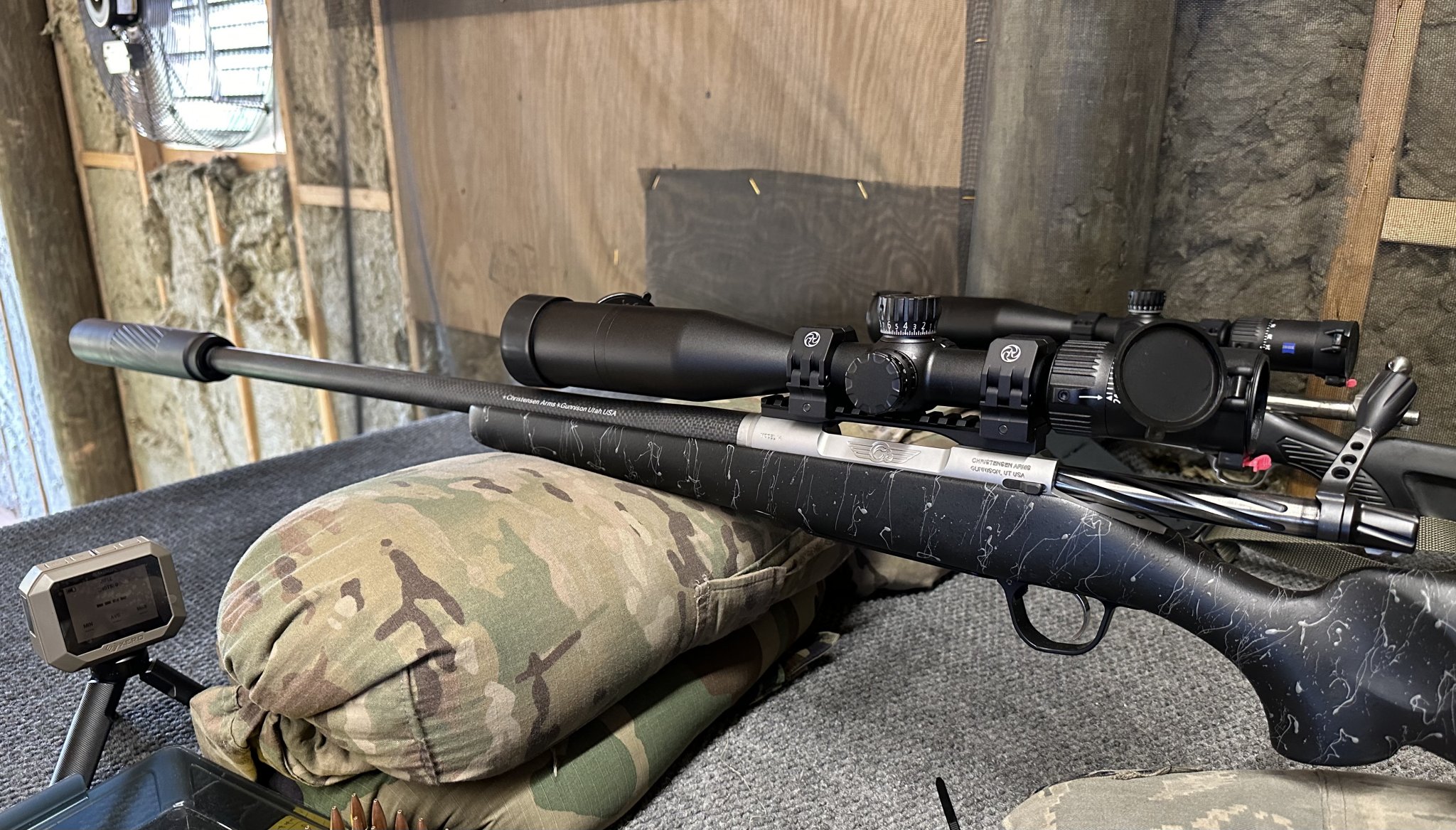

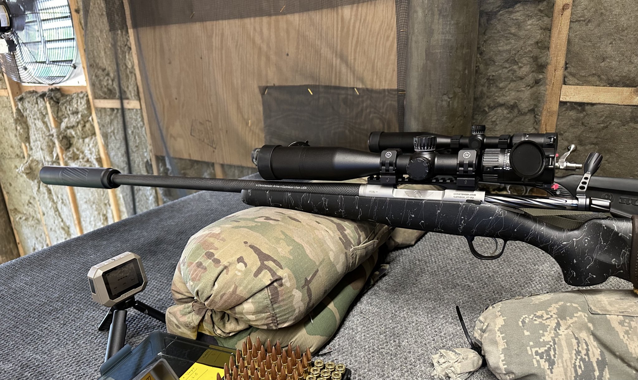

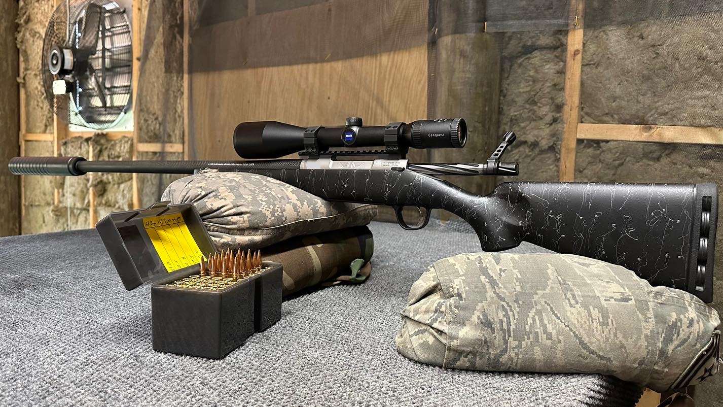

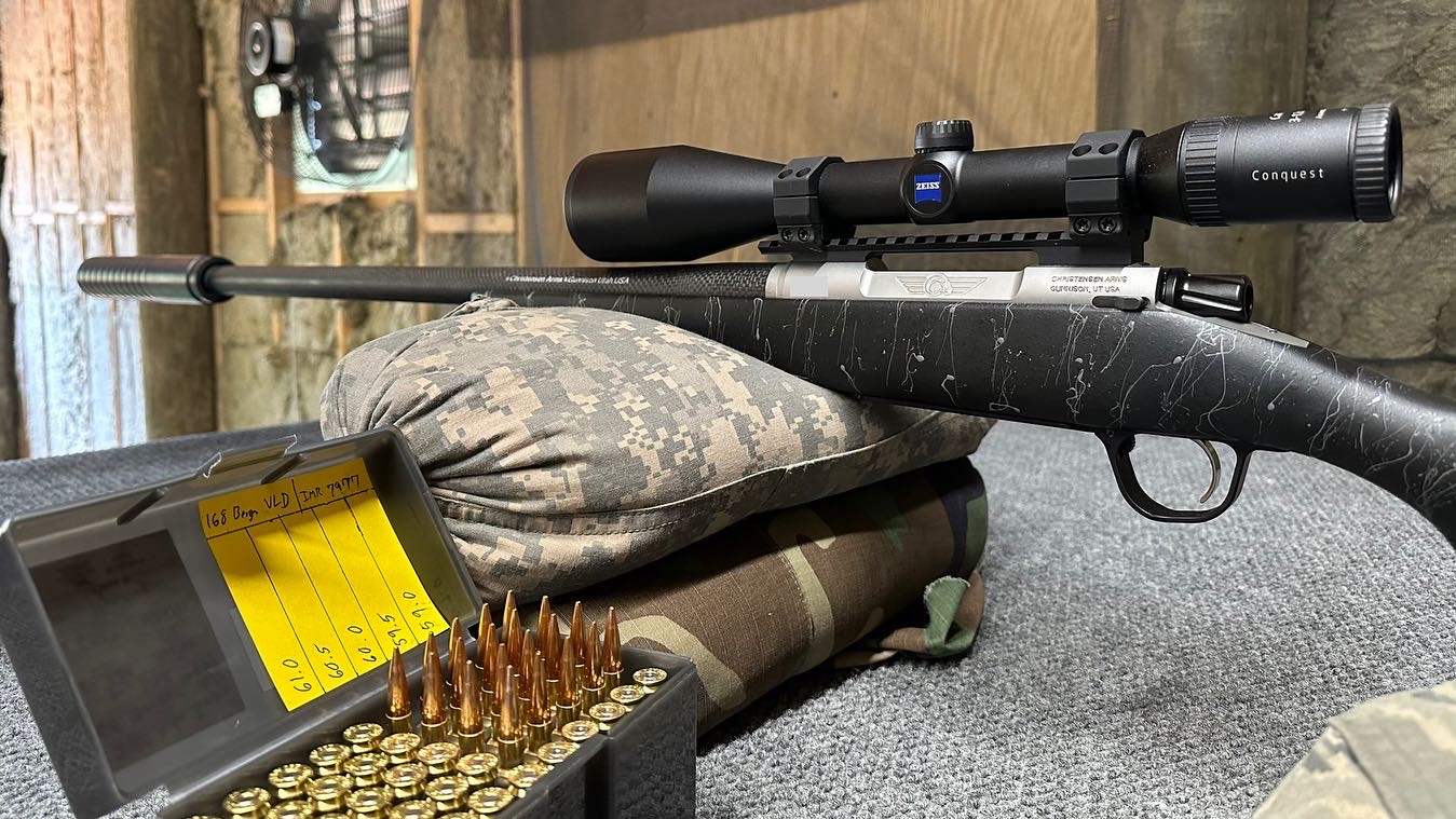

Finally went to the range today, and put the first shots through my new Christensen Arms Ridgeline .280 Ackley. I was shooting through my OCL Hydrogen-L 7.62 suppressor with the new OCL ZR0-DTA 5/8-24 direct thread mount. It’s a ridiculously lightweight setup for a 9” can. You really don’t even notice it on the end, as far as weight goes. It also sounds excellent!
So far still working on load development, so no results to post yet. I did notice that Christensen really cuts the chamber throats short on these. As a handloader, I’m not a fan. They are seated pretty deep into the case neck, even with Berger 168 VLDs. There’s plenty of room left in the magazine well, so I wish they would cut them a little bit longer (more normal). At almost 2 grains less than book load max, I’m already seeing pressure signs and ejector swipes. 😐 I hope it shoots good. But that kind of pissed me off seeing as to how much this rifle costs. I might have to have a gunsmith cut (extend) the throat some, so I can seat the bullets farther out, and they won’t be taking up much needed case capacity to help relieve some chamber pressure.

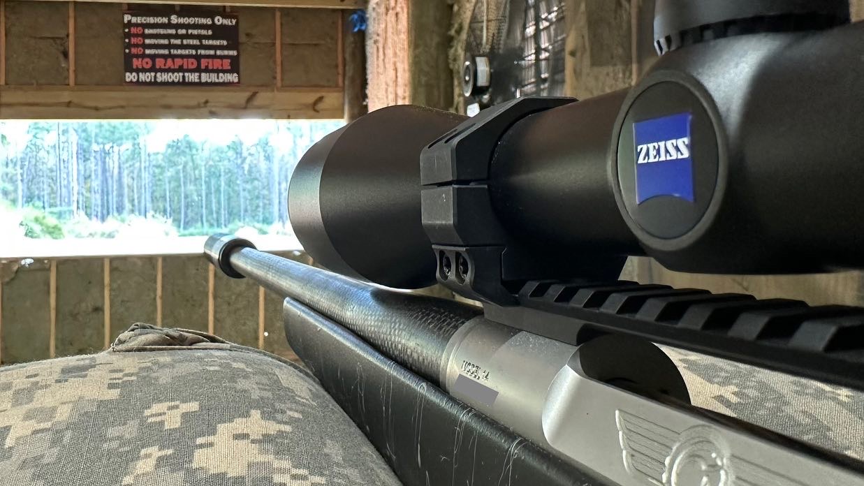

On top sits an older Zeiss Conquest MC 3-12x56 30mm FFP scope. I’ve had this scope for nearly 15 years. It’s been on quite a few different rifles. It’s sitting in a set of Seekins Precision rings, on an EGW HD base.

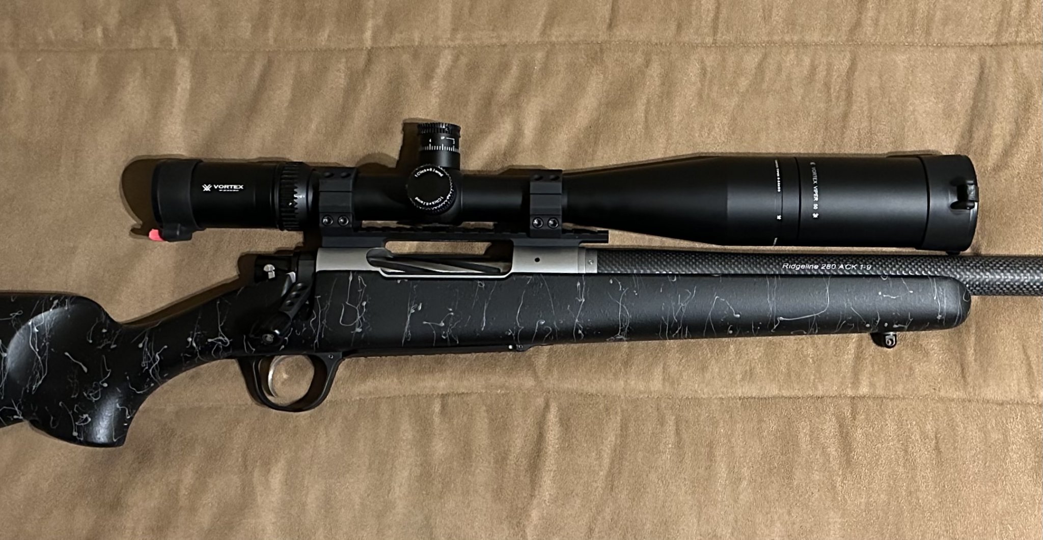

So, I finished up shooting the 25 rounds accepting I was basally just there to fire-form them, and break-in the tube a little bit. And, when I came home, I immediately dug though the safe to find a rifle I don't shoot, and swapped the Zeiss for a Vortex HST 6-24x50 VMR-1 MIL just to use during the load development phase. And once load development is done, I'll put the Zeiss back on for hunting. But for now, a 12x scope with a fat FFP duplex reticle isn't going to cut it. 🤦🏼
It honestly does (IMHO) look better with the Vortex on it, so we’ll see how it goes…I might eventually drop a Zeiss V6 5-30x50 ZBR (w/ target turrets) on it. But, gotta get the fucker shooting first... Still heading uphill for now. Hopefully we'll have some better developments after the 2nd round of 25 (next weekend).

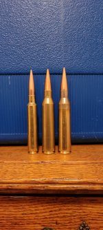

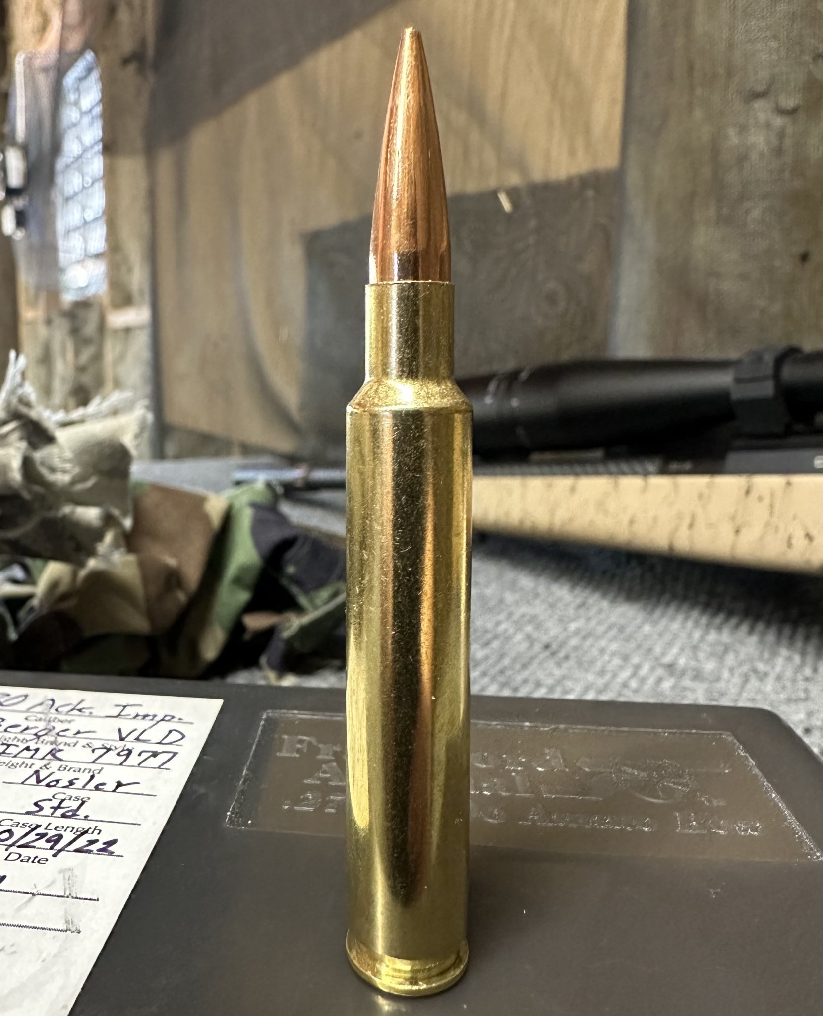

Yeah, but a damn 168 VLD sits so deep into the case…. It’s frustrating. Here’s how deep I have load them, and this is only like 0.007” jump off the lands. 🤦🏼

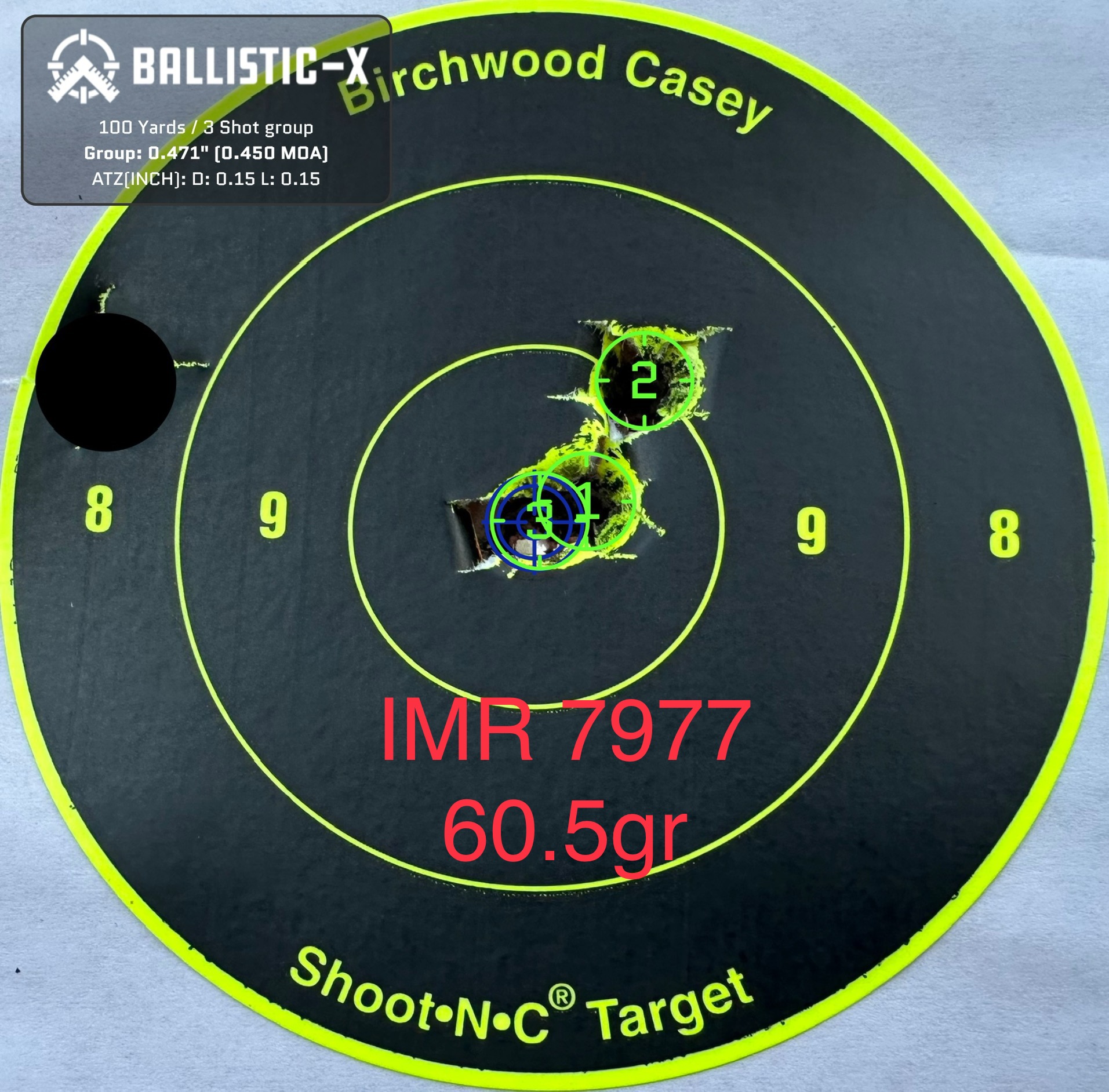

Best group of the day today was 60.5 gr of 7977... Still not where I want it to be, but most folks would call it good. My gripe is that I should be able to get a $2000 rifle shooting better than this with handloads... Seeing as to how I have loaded for factory barreled rifles that shot sub-1/2 MOA at 100.
After swapping the scopes, scrubbing the barrel, now having fire-formed brass to my chamber that I neck-sized for consistent neck tension, re-measuring the chamber for jump distance, and seating them 0.010” off… It’s showing some real promise.

I think 60.0 grains is the sweet-spot. That’s probably what I’ll stick with. Next trip I will be taking the MSv2 for velocity testing and getting my ES and SD for the load so I can build my dope chart.

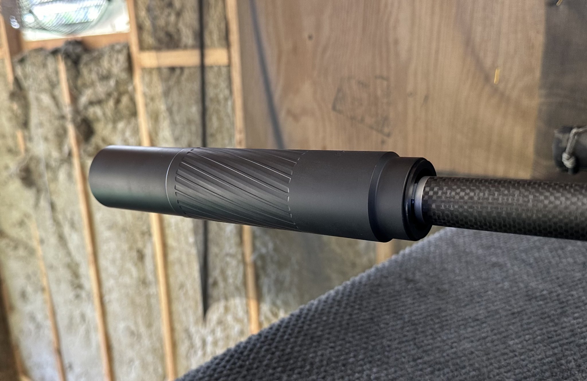

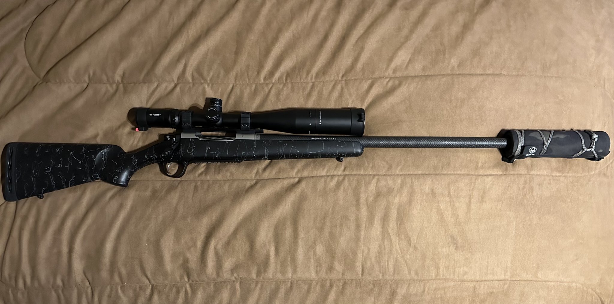

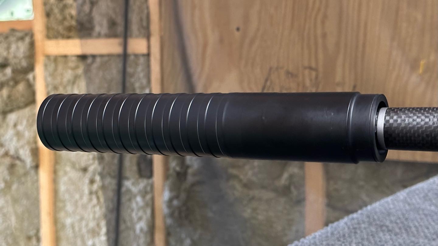

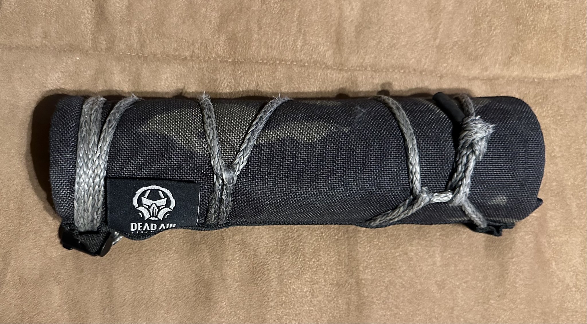

Due to the ATF screwing everyone with eForms right now, pushing them WAAAAY beyond the original 90 day [typical empty government] promise… My new Otter Creek Labs Hydrogen-L, which is going to be my dedicated hunting rifle can, looks like it will be quite a while before It gets approved. Probably after deer season, knowing my luck. 🙄

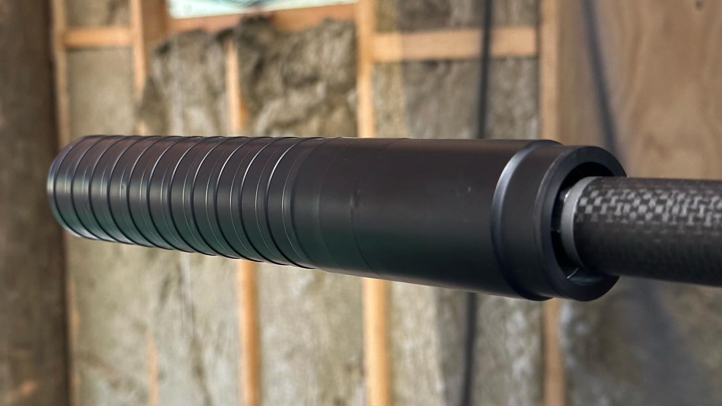

So… I decided to snatch the heavy KeyMo setup off my Nomad-LT, and put my spare ultralight Otter Creek ZR0-DTA titanium DT mount on it, and I’ll probably end up using it this season.

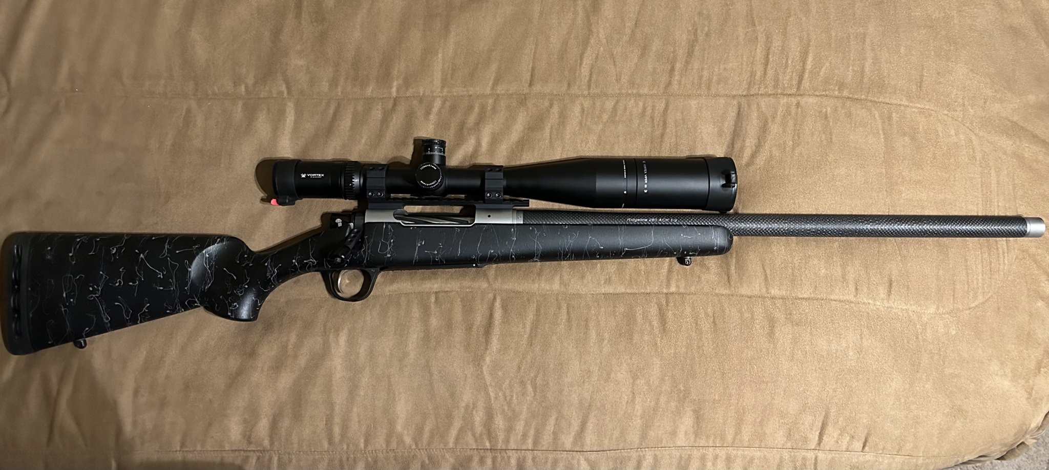

Looks pretty good on the new Ridgeline .280 Ackley… Pretty damn lightweight, too. Definitely packable. OAL with the 24” barrel is 52” from the floor to the end of the can, so it’s a longboi for sure…. But if you needed to, you could just wait to screw the can on once you’re in the stand. The OCL ZR0-DTA mount only adds 1/16” to the length of your suppressor, just enough to have a thick enough flange to mount securely and strongly to the back of the can, and recesses the barrel threads up inside the blast chamber for virtually zero extra length.

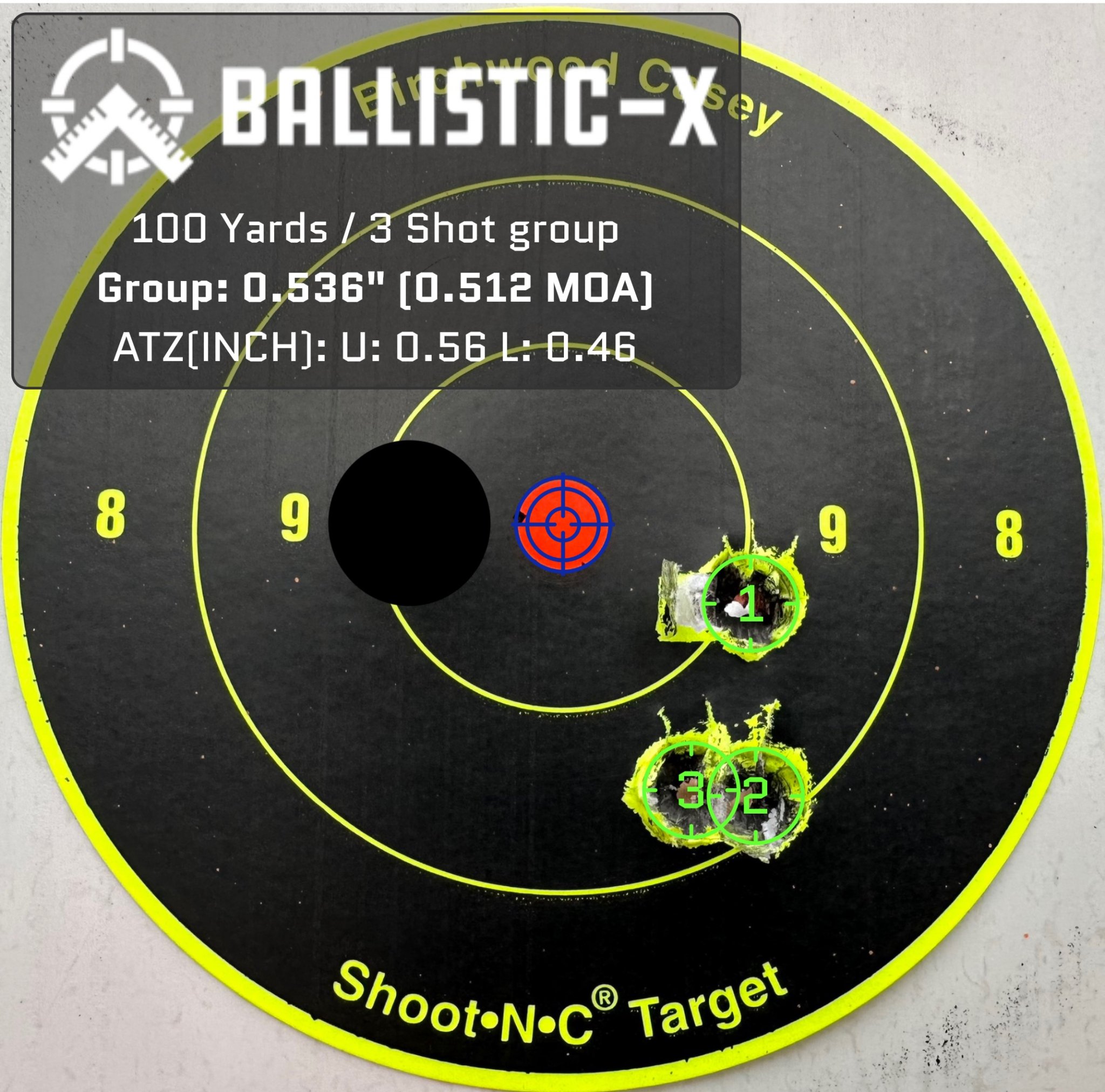

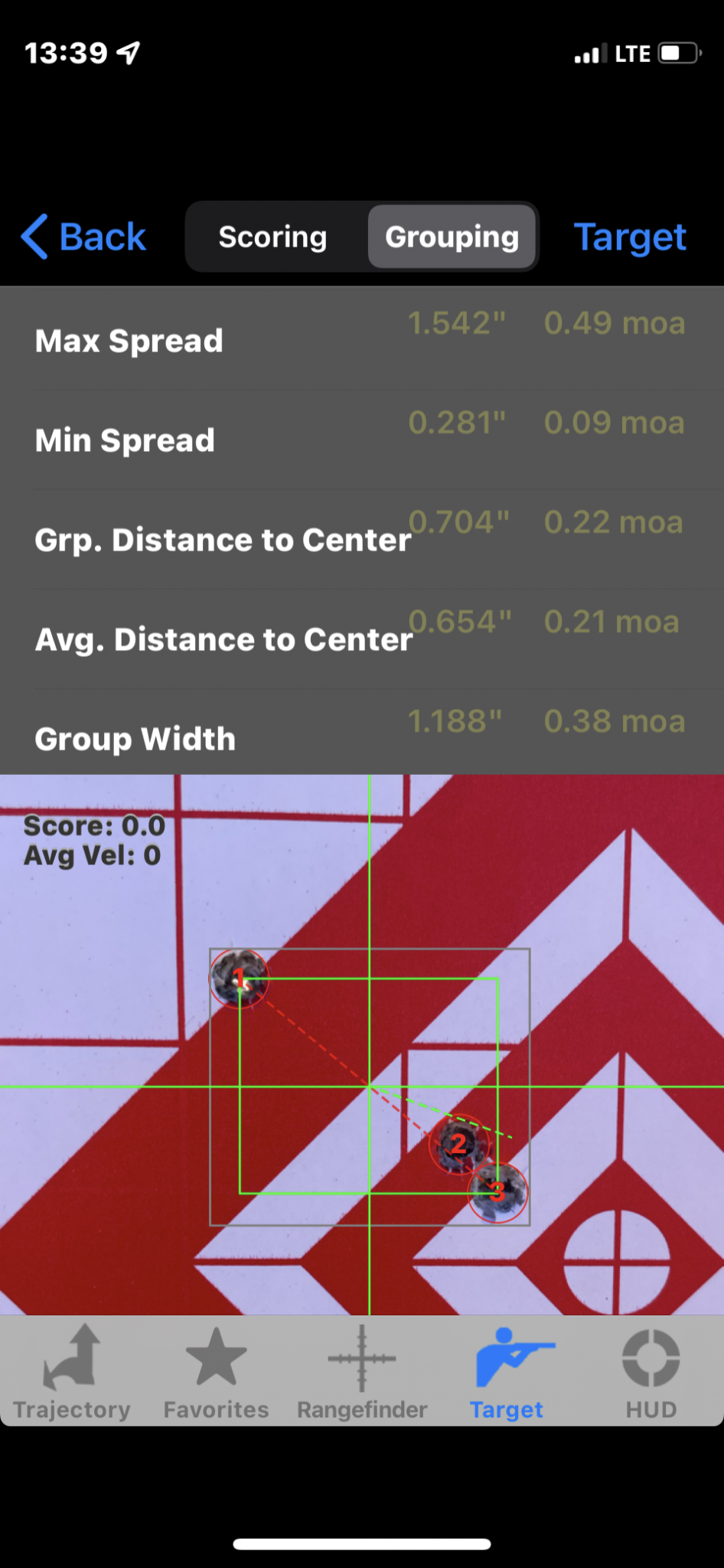

Shot 25 more rounds, and a 3-shot group today with the Nomad-LT on there. POI shift from my previous zero with the Hydro-L and ZR0-DTA, and my Nomad-LT with a ZR0-DTA, was only 0.3 MILs low, and dead-on left & right. So, not bad at all. Kind of impressive, actually.
Here’s the group.
I'm telling ya don't worry about the COL. if it shoots good at .007 off the lands go with it. So many guys get all bent otta shape cause their bullets aren't seated way out. Every stinking one of my Christensens shoot FASTER than book with LESS powder and shoot good hunting size groups (<.5MOA). Whats not to like about less powder and more FPS? Have you checked it with a Labradar or Magneatospeed? all of mine are 100-175 FPS faster than all the books say with given charge. I hate to see you get all messed up over how far they stick out of the brass. Something else to consider is do they cycle from the mag in the "heat of battle" seated way out there? Do they even fit? Most of the time those really long loads don't cycle well in my experence. Id check the speed before I got all upset.
I remeasured using my orange box Hunting VLDs, and it sat them 2.688”, so I’m running them at 2.678”, which is 0.010” off the lands, since I will be using them for hunting. So far, it’s doing ok. I’m averaging anywhere from 0.750” down to 0.350” groups. Which, is acceptable for right now, since I don’t have any shots over 500 yards on deer, so I’d say it’s fine for now. I do need to chrono the load for my dope chart. I will be doing that this upcoming weekend. I’ll report back my velocities. Also, after fire-forming the cases, I was able to fit 60.0 gr of 7977 in there without it being a compressed load. The shoulder area expanded roughly 0.005” at the shoulder/wall junction after the first firing, so I know that helped with capacity a fair bit. 👍🏼

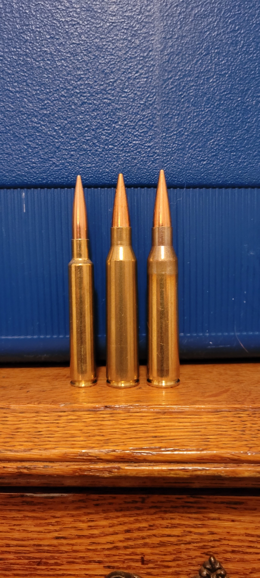

Found 4 more boxes of 7mm Berger 175 Elite Hunters the other day, now they’re on their way to me… So I decided to stop using the 168 VLD’s, and break open the 1 box I already had on-hand to start load development with the Ridgeline .280 AI. 😏
My 280AI RidgeLine likes em. I found 3 more lbs of 8133. That is a good combo in mine. Too bad they quit making it. 7977 wasn’t too bad.

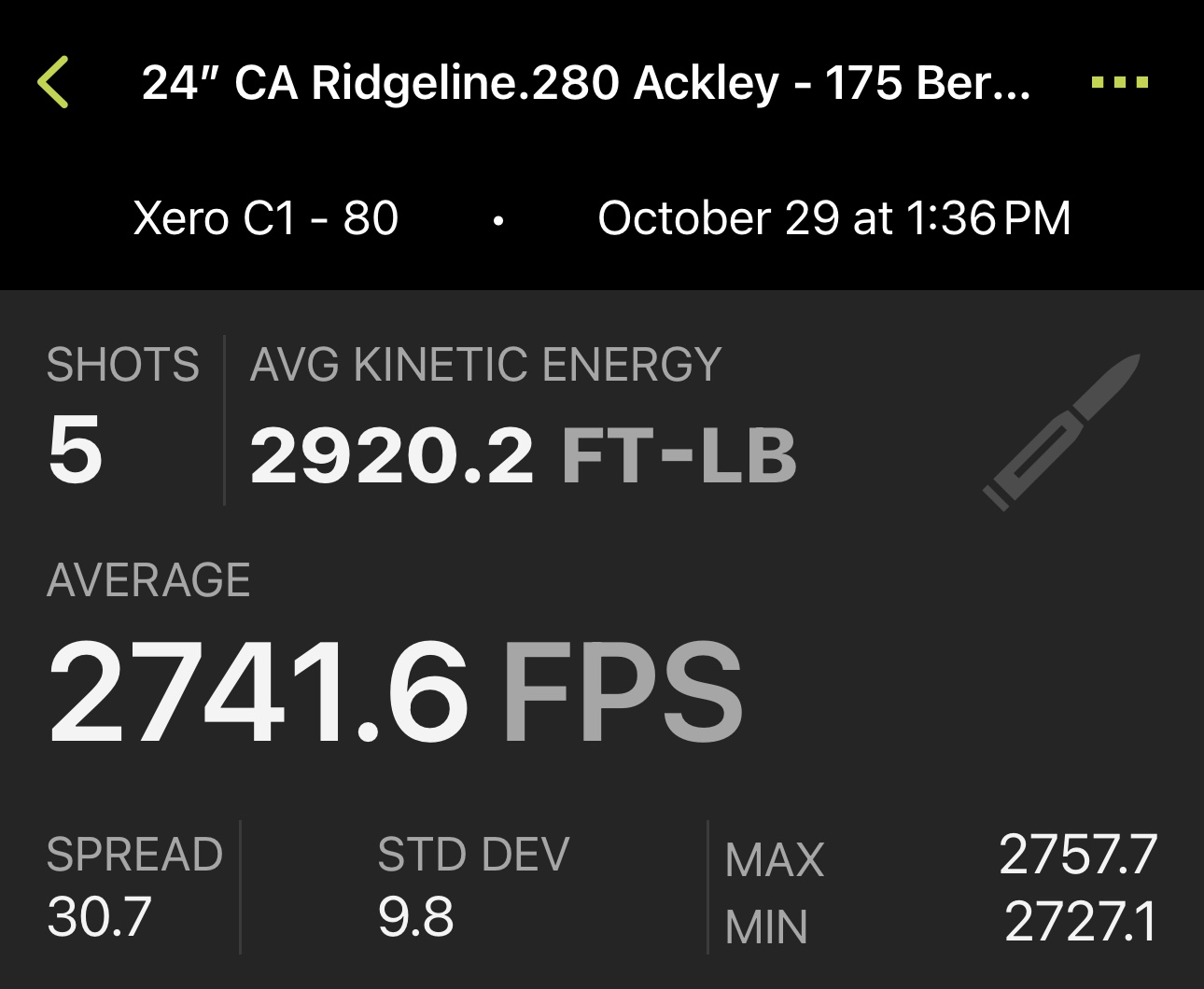

@christensenarms Ridgeline 24" .280 Ackley Improved with Berger 175 Elite Hunters, IMR 7977, Nosler .280 AI brass, and CCI 200 primers... Chrono'ing at a multi-session average today of 2,741.5 FPS muzzle velocity. Quieted down with my newly released from NFA-jail TBAC Magnus-HUB w/ an Otter Creek Labs ZR0-DTA mount.
More powah! You can get those things faster, but with an SD like that, it's hard to argue changing anything. Good looking rig.

If I dropped back to the faster IMR 7828 SSC, I can get more velocity, over the slower 7977 powder. But the 7977 is such a consistent and temp-stable powder, it's hard to argue with the results.
